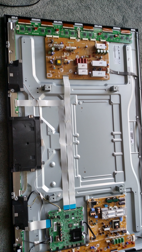

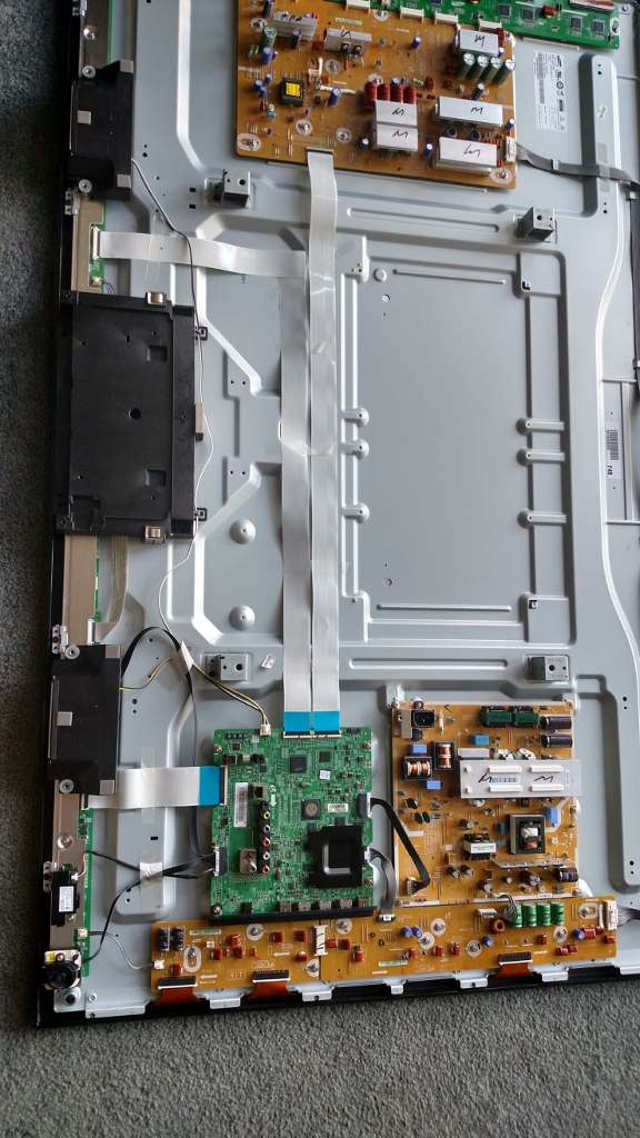

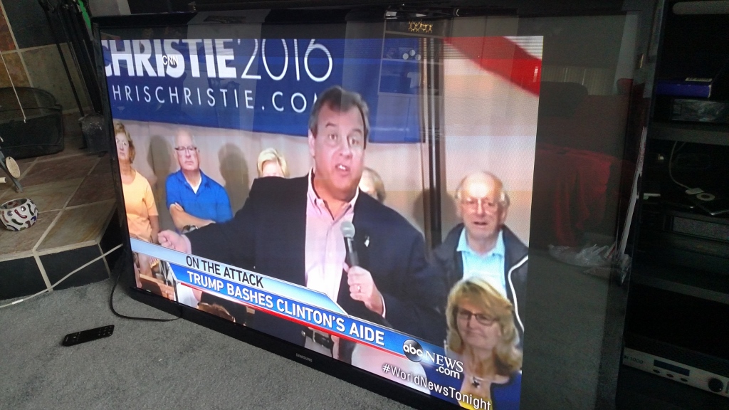

    I am a novice, apologies for my ignorance.
    I had a surge and alI I could get was the red power dot showing per to the TV. Couldn't even pull up a menu.
    I found a full set of boards and wires (guaranteed) and replaced all with some success but still had screen issues and non-working HDMI ports. Seller sent me another set and I replaced the board with HDMI ports and now they work OK. I don't want to sound too lazy but I now have 2 issues, one is the picture is low and to the left and the other is remote doesn't work (other than on/off). Do these two clues tell you which board or wire needs changing now? I hate to have to change all but will if needed.
    Thank you!

    Re: Problems with Samsung PN60F5500 AFX ZA
    Posting pictures of the back of your tv showing the boards with clear pictures may help you more with fixing your problem
      files attached
