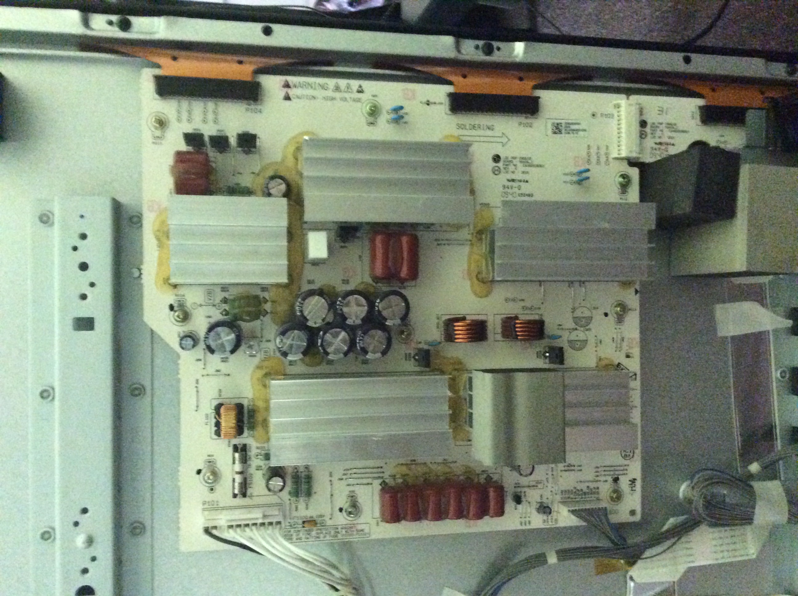

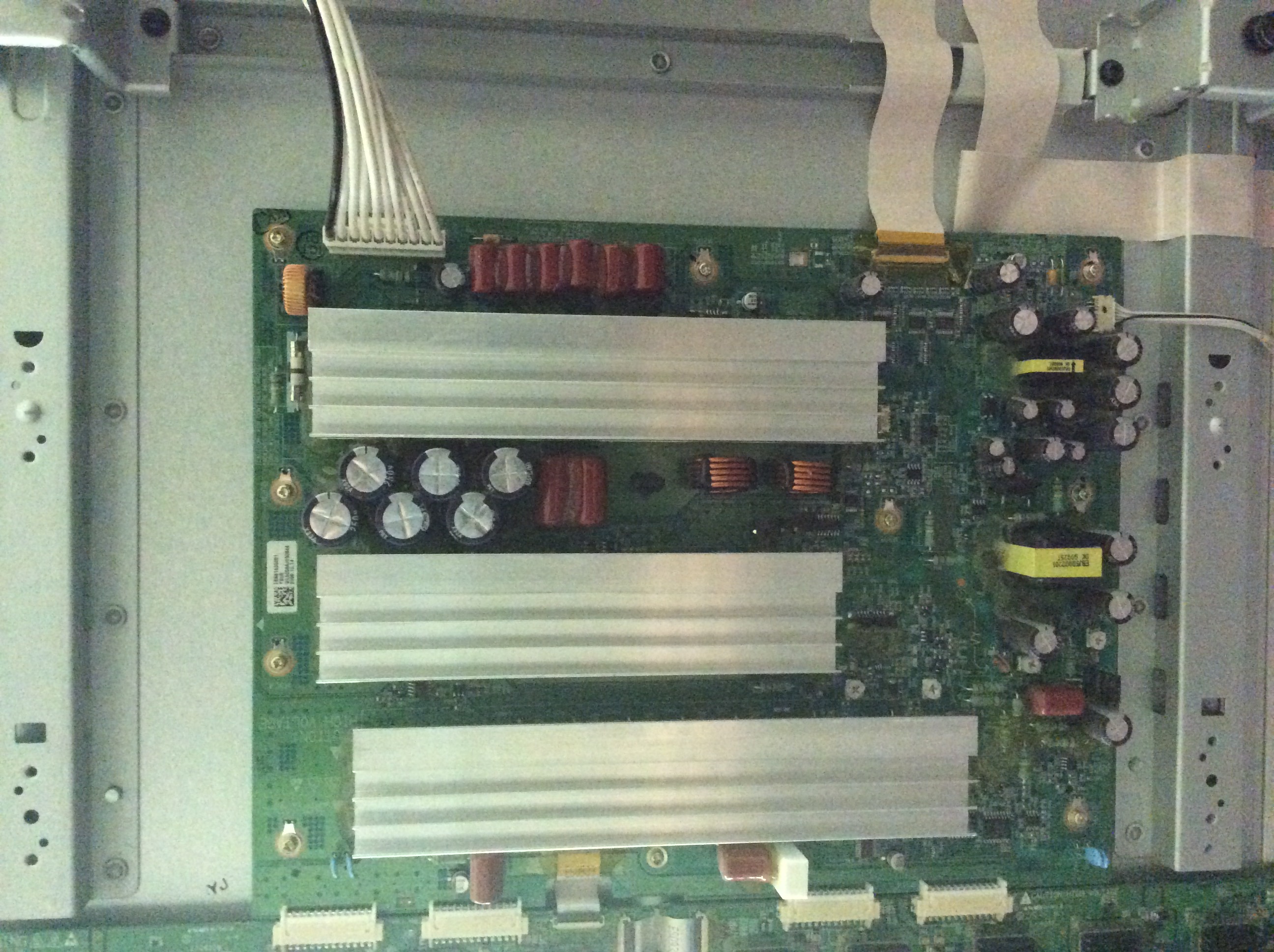

    Re: LG 50" Plasma 50PS30-UB powers on, no picture, no sound
    Pictures needed of y and z sus.
    You'll need to check voltages,
    Vs & va located on power supply.
    Vsc and -vy located on y-sus
    Zbias located on z-sus
    There may be test points etc or they may be measured across a resistor.
      pictures attached, let me know if that helps any.

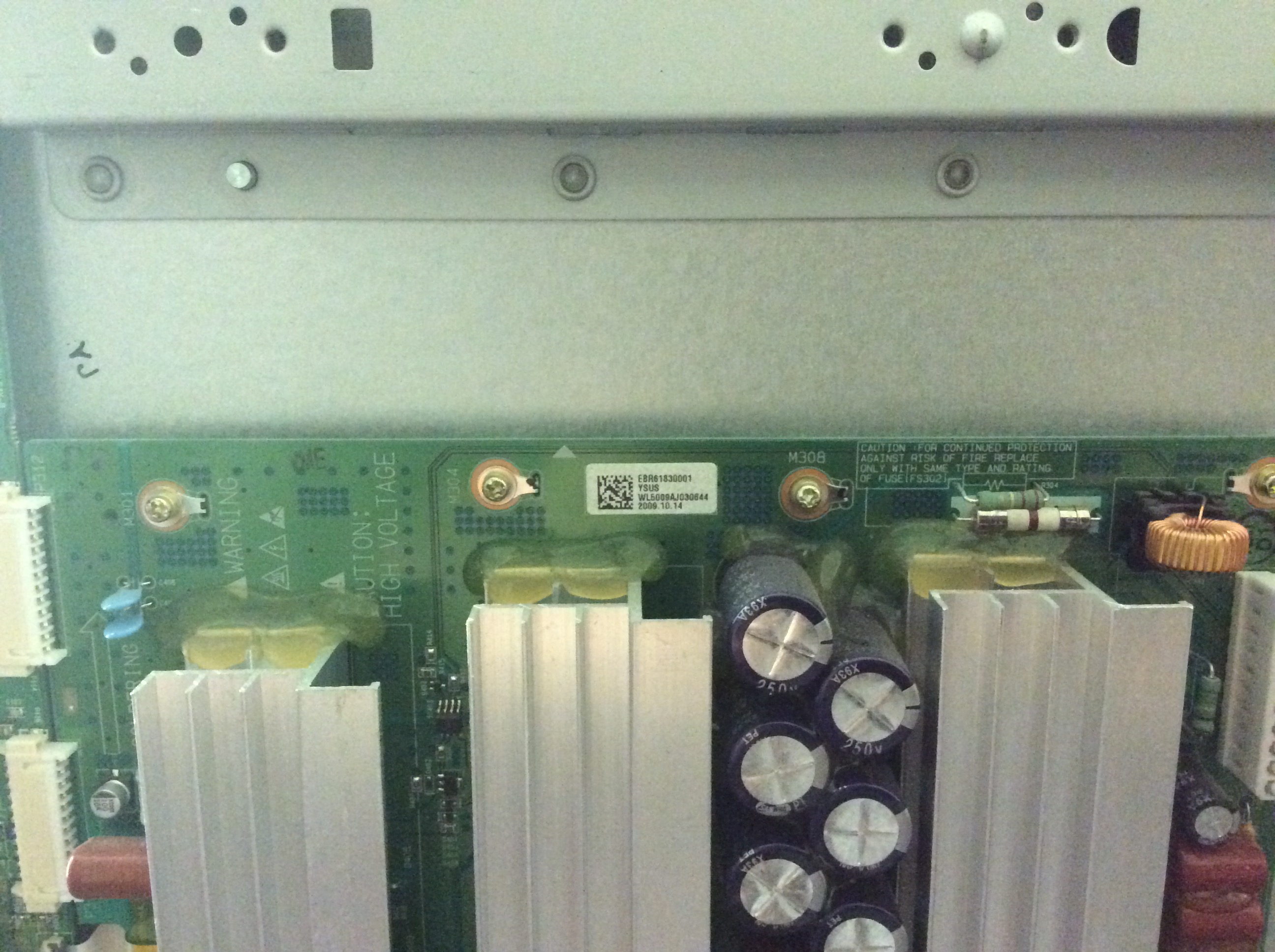

                Plugged tv in and tested voltage on both plugs that go from power supply to y sus and z sus. All voltages are normal on both. Also I get a green power light on the t-con board. Again no visibly blown or burnt parts.
                Anyone else have input for the next step?

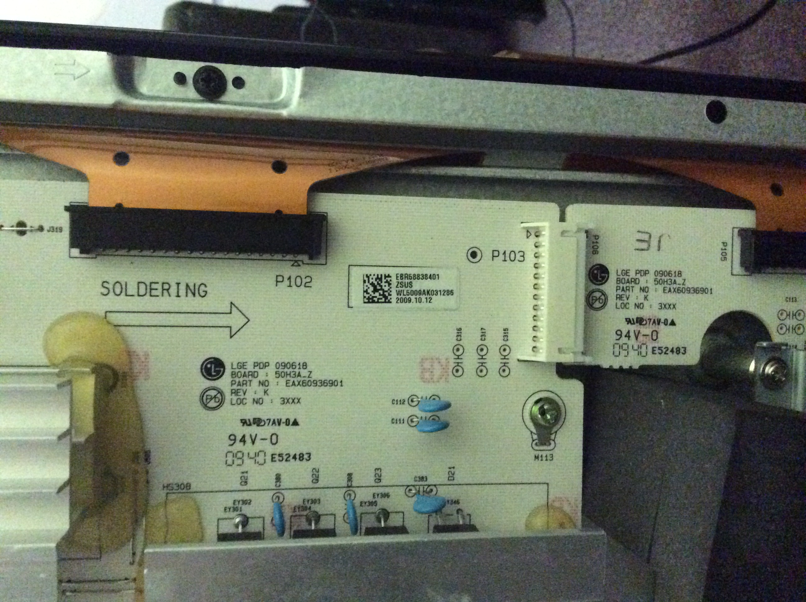

                  As requested by Hamie, check -Vy, Vsc and Vzbias. These are marked on the Y-sustain and Z-sustain. The Y-sus has -Vy and Vsc, the Z-sus has Vzbias. Usually, there are components you have to test across.
                  If you're still unsure give me the "PDP model number", this is the model of the internal display panel assembly and will be something like PDP50K90000, marked on a sticker marked "LG Electronics Korea" or similar and I will get you a guide.
                            Alright vsc and vy are right on. Vzb is 115 and sticker says it should be 105. Does that mean the z board is bad?
                              Thats OK for now.
                              Do you have a faint glow from the screen?

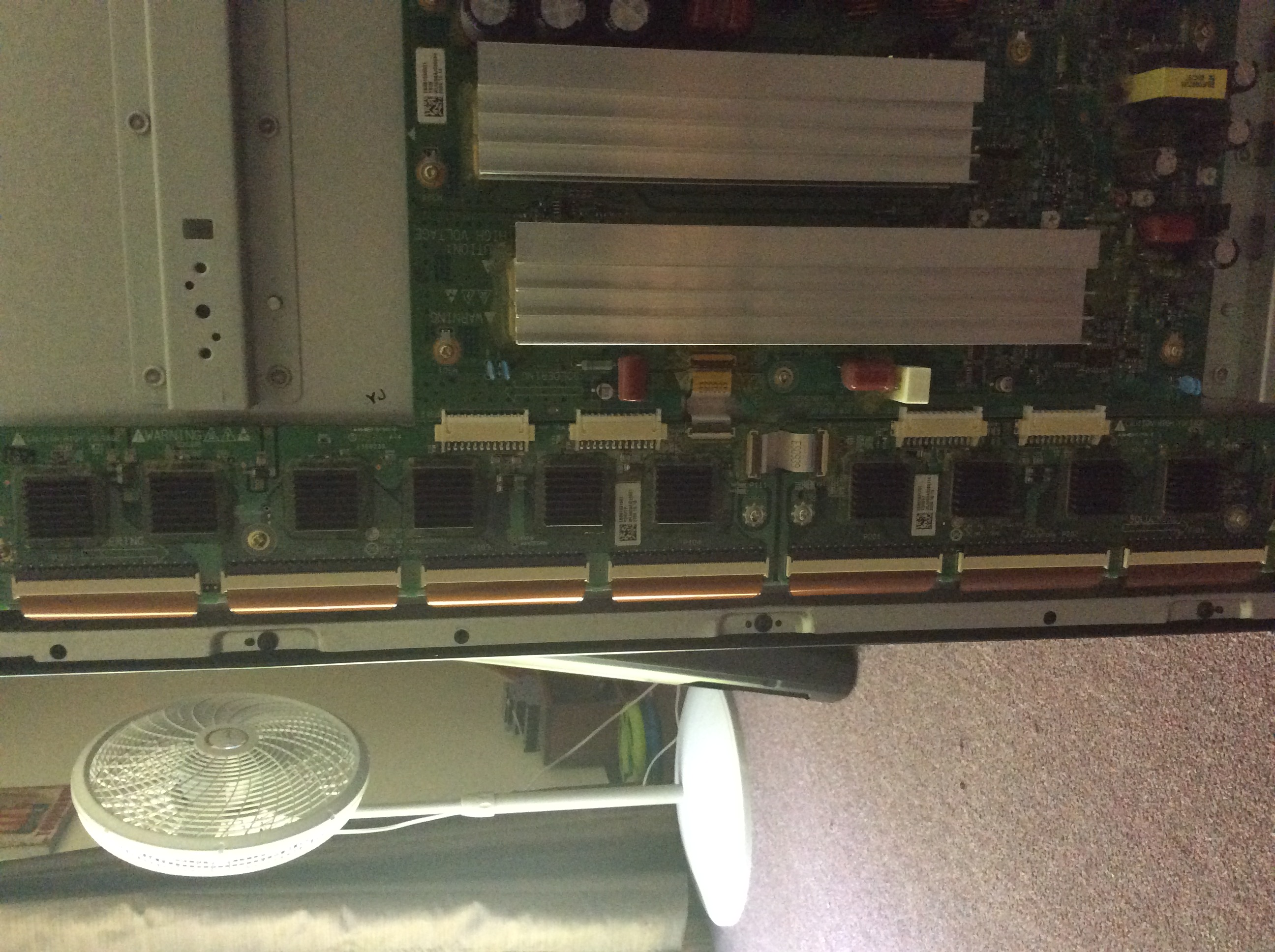

                                    Sorry for late reply. Your-vy is ok.
                                    You positive that the panel isn't glowing. You may need to darken your room to confirm.
                                    • Hamie
                                      • Apr 2014
                                      • 1383
                                      If you unplug the z-sus do you get an image?
                                        No I do not on either of those questions
