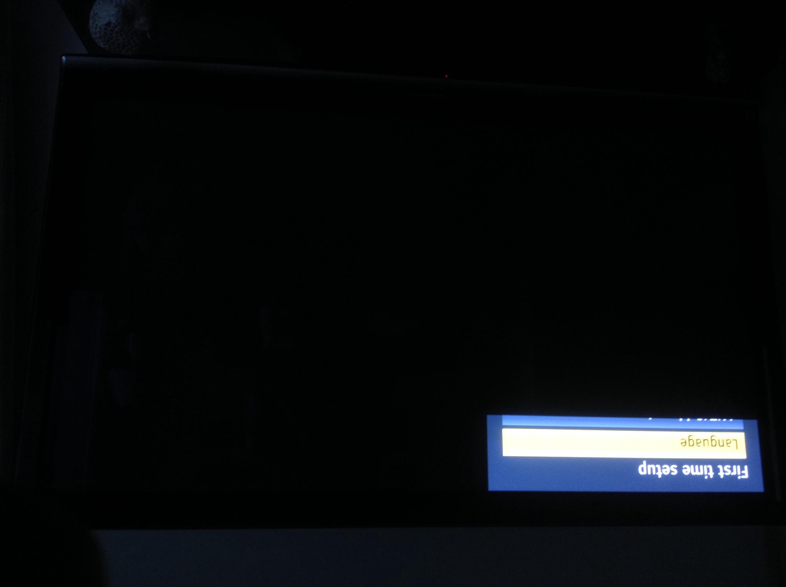

    Hi everyone!
    My Panasonic plasma is over 6 years old and it finally is having some problems.
    Everything works like normal except the picture is mostly missing. If anyone can help I would greatly appreciate it!
    I attached a photo of the screen.
  • Hamie
    • Apr 2014
    • 1383
    Re: 3/4 of picture missing on TC-P50G10
    Probably a buffer board failure.
    • Andrew F. Ali
      • Jan 2014
      • 2450
      • Trinidad & Tobago
      Is that the screen picture upside down or was the camera shot upside down? Anyway, I would check SU, SD, SS2, C1 or C2 boards.
