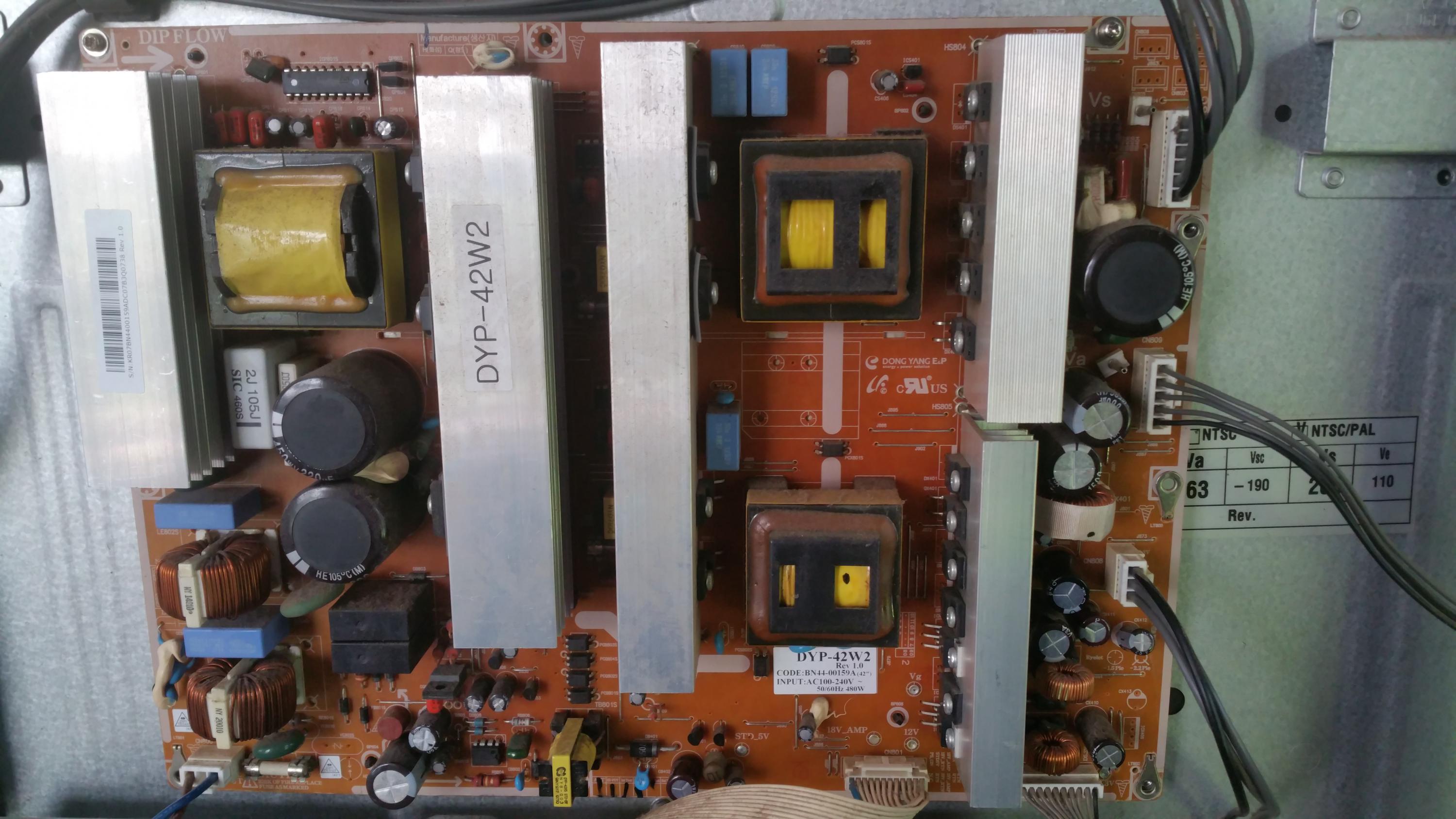

        Screens hot of psu added

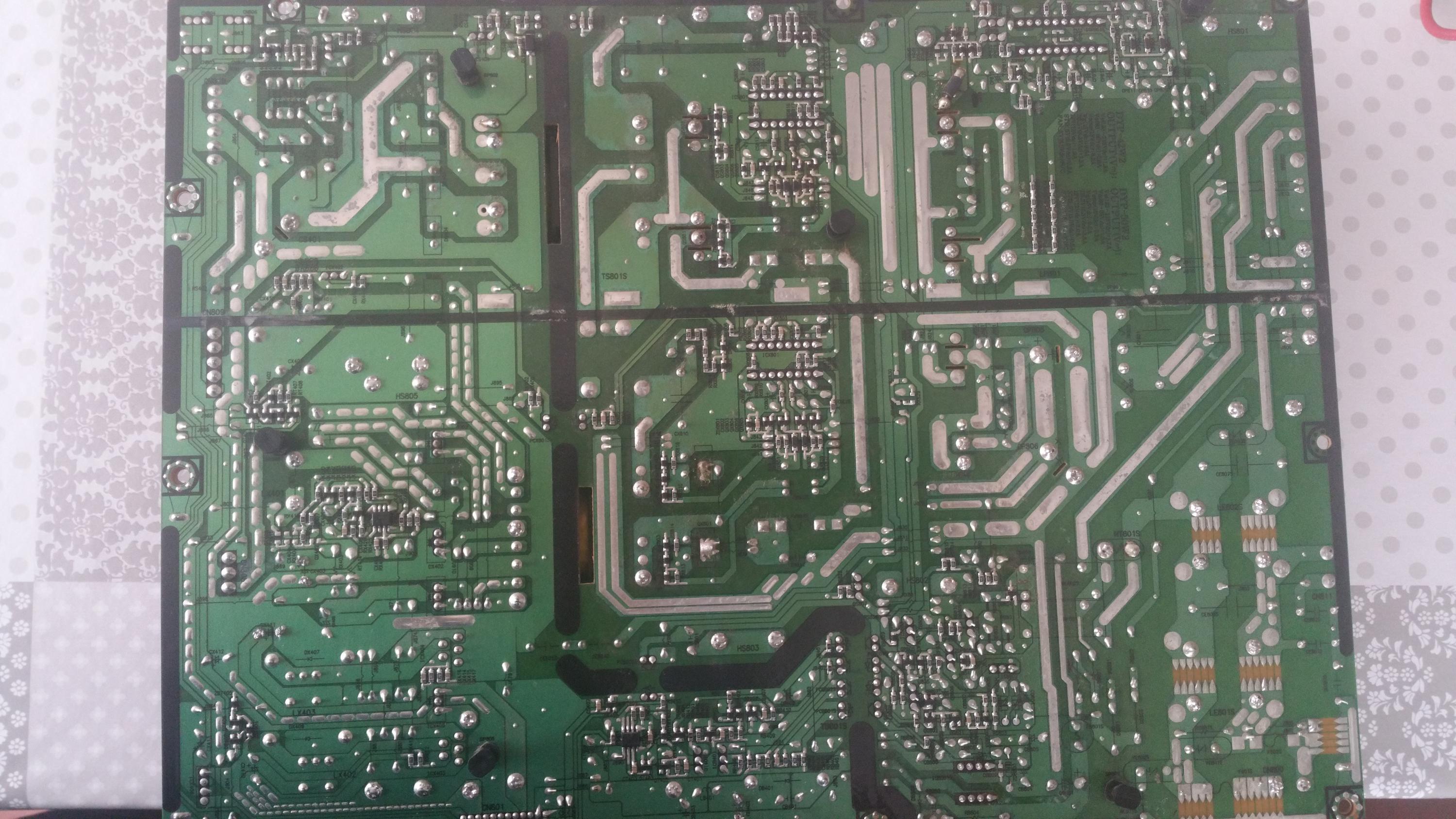

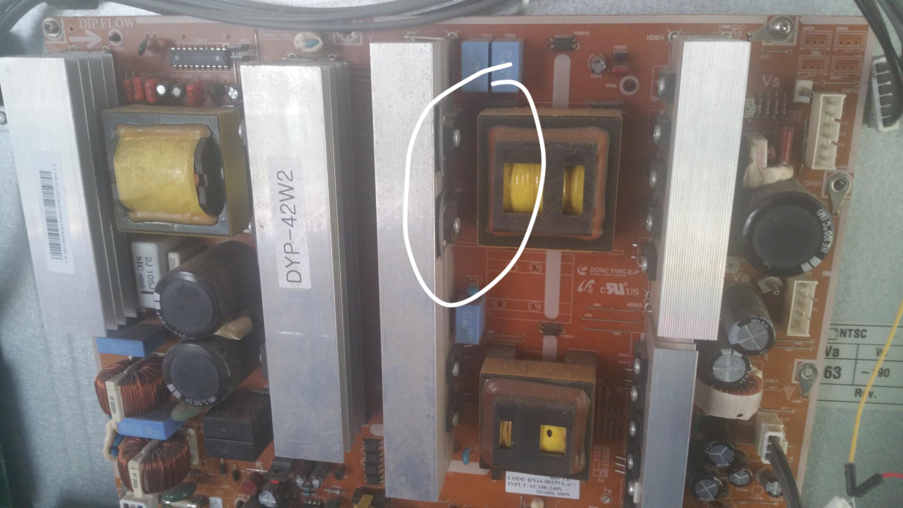

                So just to clear this with the resistor fitted between 5v and VSon pin and PSon to ground you have no VS voltage ? if this is the case your problem is with the Two biggest Fets (top )on the third H/sink from the left and the SMD diodes and resistor under the board you should check the soldering first, lots of bad joints with unleaded solder as it ages

                  You mean these 2 (see pic)? Is there a way to test these?
                  So far no loose connections

                    ALao a picture from the back. Maybe I am not seeing it. Could get a pointer on where to look on the back

                      Parts to test are F801 Fuse ? most likely blown if QS801/2 are shorted but not all ways
                      QS801and QS802 test for shorts to all legs
                      DS803/DS804 diode test (some times hard to test still on the board if buying kit replace anyway)
                      RS812/RS814 check resistors are not open ,but show as value ?(in the kit so replace as with diodes )
                      replace ICS801 if QS801/2 need to be replaced
                      This is the common repair for no VS voltage ,all parts can be bought as a repair kit or on there own , internet search DYP-42W2 repair kit ,but make sure to get the right one there will be two the other being for low voltages side (small FETs )

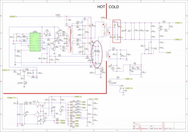

                        Hi, Kennyzwiers! Try repair this SMPS with schematic. Hi, forum! Among the frequent breakdowns in these PSUs is very chip MS33067. Chips in the power supply unit 2, so you can swap them. Also be sure to taste it to replace both the condenser to the new oval circled column in the diagram line. The rest should help scheme. Good luck!
