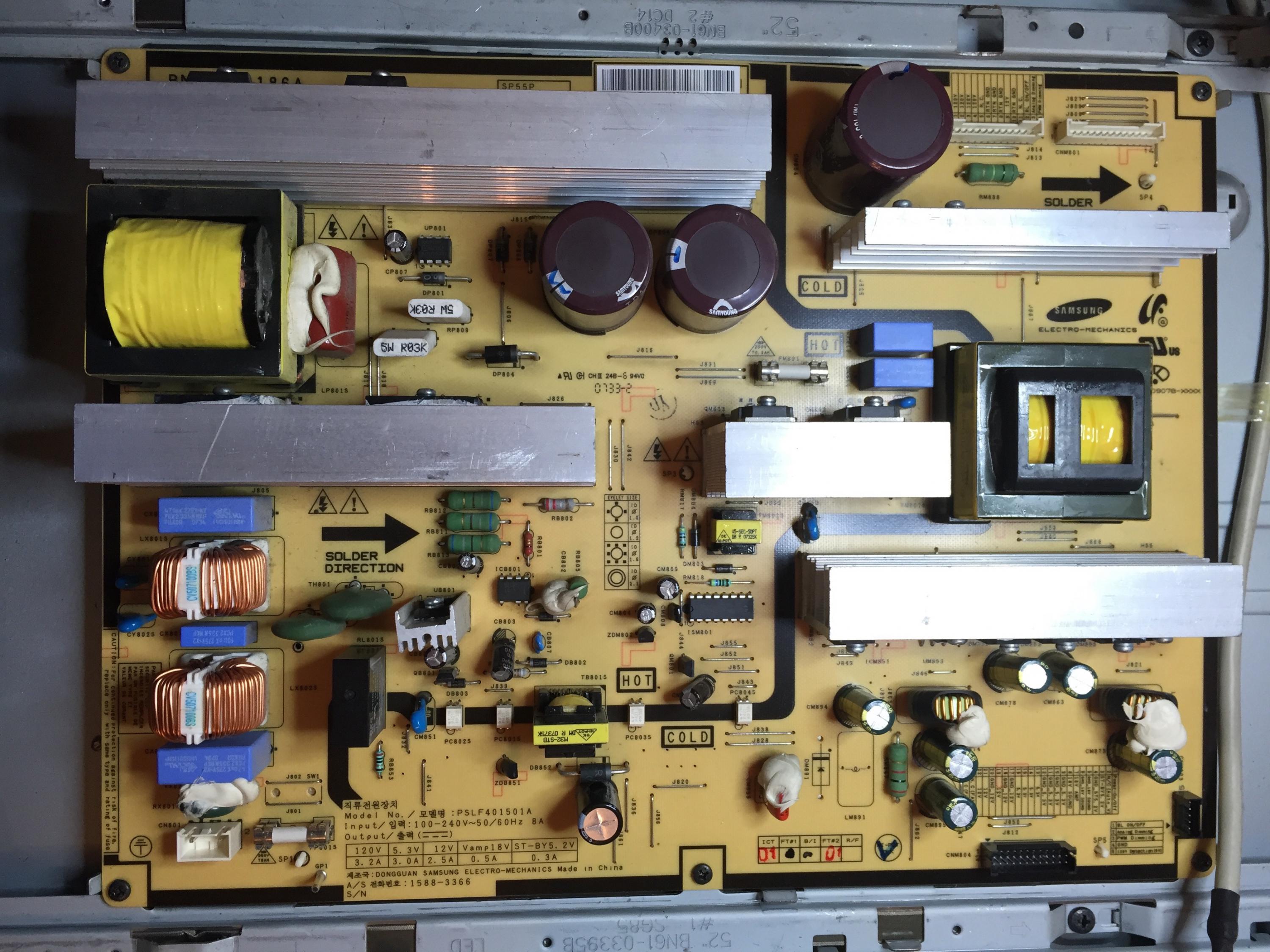

    I wonder if anyone can give me any idea what to do to get this working?

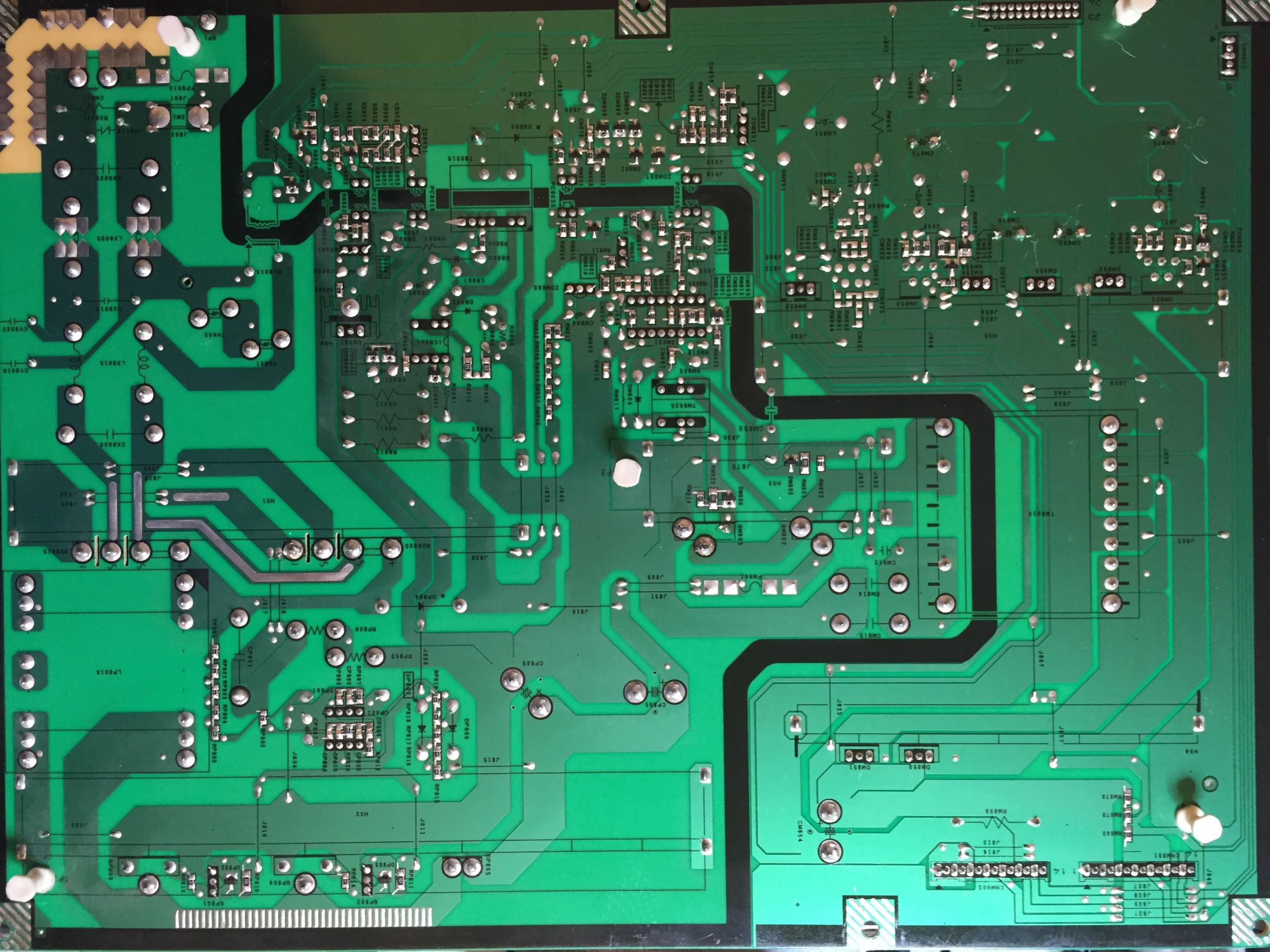

    Has clicking sound coming from power board which seems to be coming from blue 'relay' CX8035. The power board is BN44-00186A.

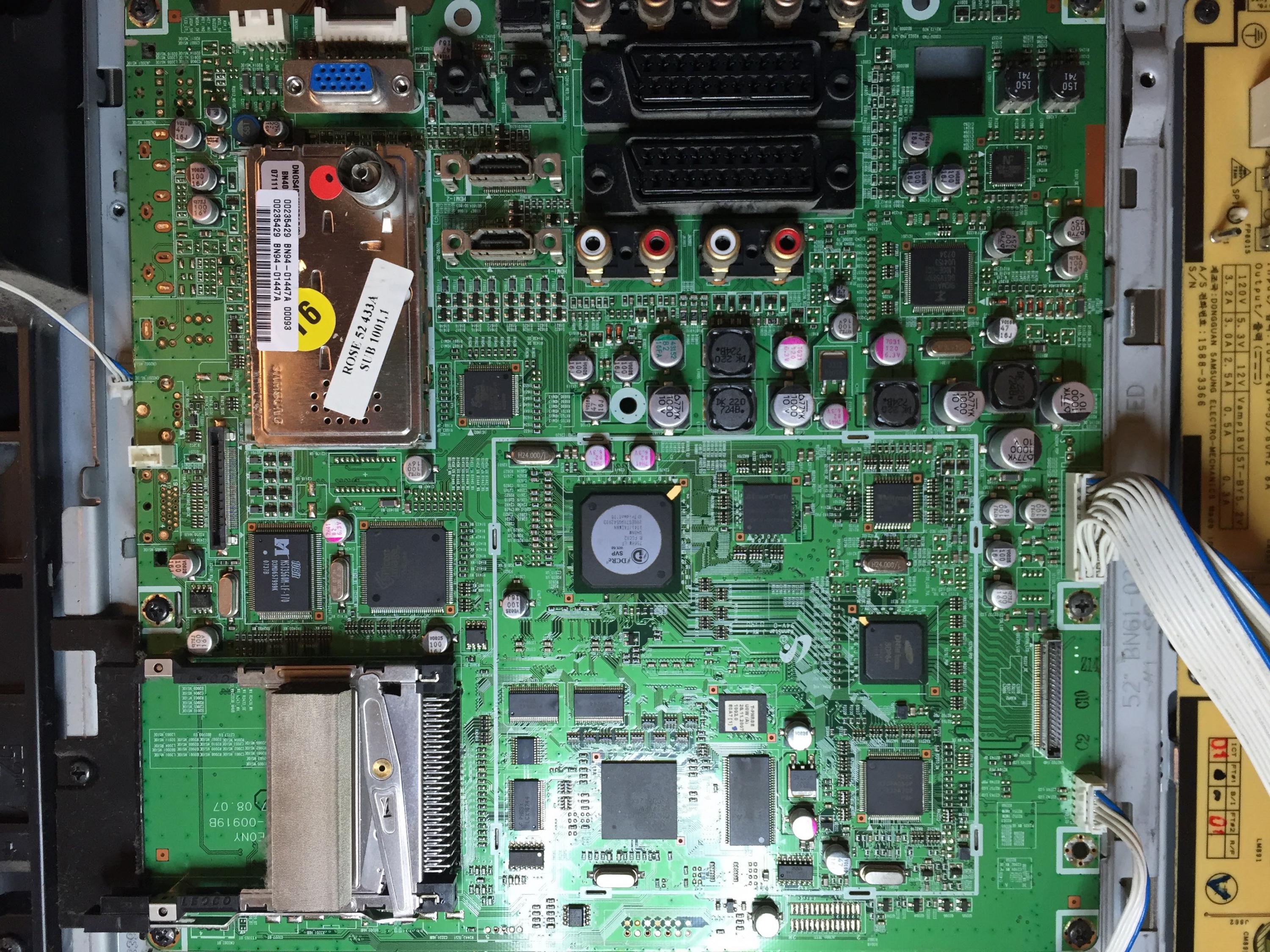

    I thought I had narrowed the problem down to the mainboard BN41-00919B by disconnecting all boards and finding that the clicking only comes back when the mainboard is plugged back in to the power board! Having sourced another mainboard, the click is still continuing once its plugged in again.
    There were a few caps on the psu with high-ish esr readings which were replaced (35V 1000uF) but clicking still continues.
    I have checked the fuses, all are ok. I have taken some readings which I'm sure are ok and are as follows;

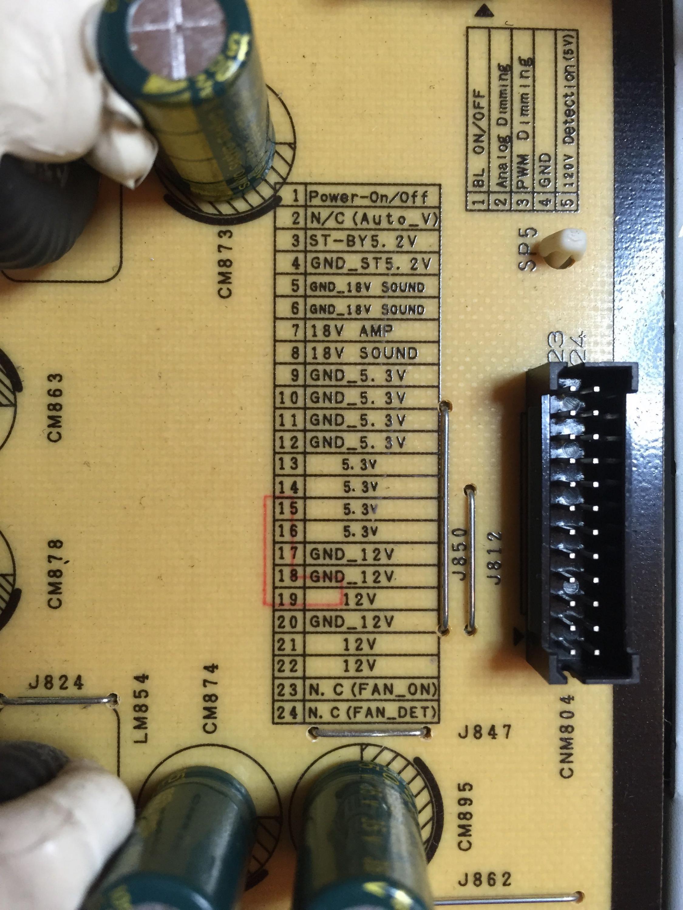

      Oops, sorry, of course. CNM804 pins 1-24 are shown in pic 3. the CNM802 pins are labelled as follows;

        OK, you count the pin wrong because pin 2 is N.C. (NO CONNECTION) and you are getting 5.2VDC.
        Pin 3 id the STBY5.2VDC and you are getting 0.
        Pin 1 is the PS-ON pin which is the turn on command signal from the main board and you are showing 0VDC.
        Please take the readings again and please put the pin names next to the readings so I do not have flip back and forth between your readings and the pictures of the pin names.
        The connector is arranged in ODD and EVEN row.

          Re: Samsung LE52F96BDX Clicking...
          Hi. Thanks budm for your reply.
          I hope this is what is required. Have taken another look and the results are as follows with my readings at end of each line;

          CNM804 to mainboard;
          1 Power on/off 0V
          2 N/C (Auto-V) 15.5mV
          3 St-By 5.2V 5.2V
          4 GND-ST 5.2V 0V
          5 GND-18V Sound 0V
          6 GND-18V Sound 0V
          7 18V Amp 4.9mV
          8 18V Sound 2.1mV
          9 GND 5.3V 0V
          10 GND 5.3V 0V
          11 GND 5.3V 0V
          12 GND 5.3V 0V
          13 5.3V 1.1mV
          14 5.3V 0.6mV
          15 5.3V 0.7mV
          16 5.3V 0.5mV
          17 GND-12V 0V
          18 GND-12V 0V
          19 12V 2.3mV
          20 GND-12V 0V
          21 12V 2.3mV
          22 12V 1.5mV
          23 N.C. (Fan-On) 17.5mV
          24 N.C. (Fan-Det) 21.3mV
