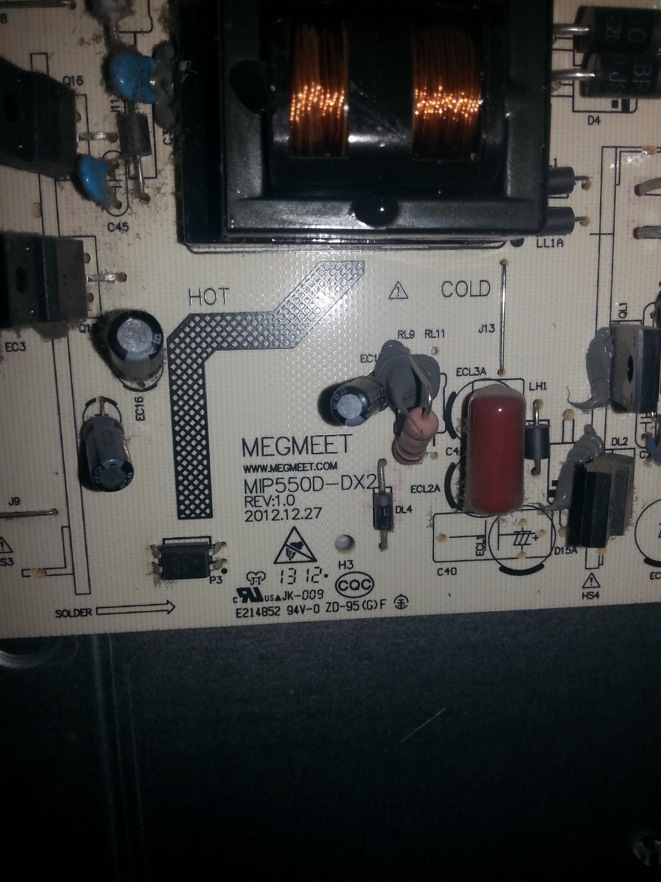

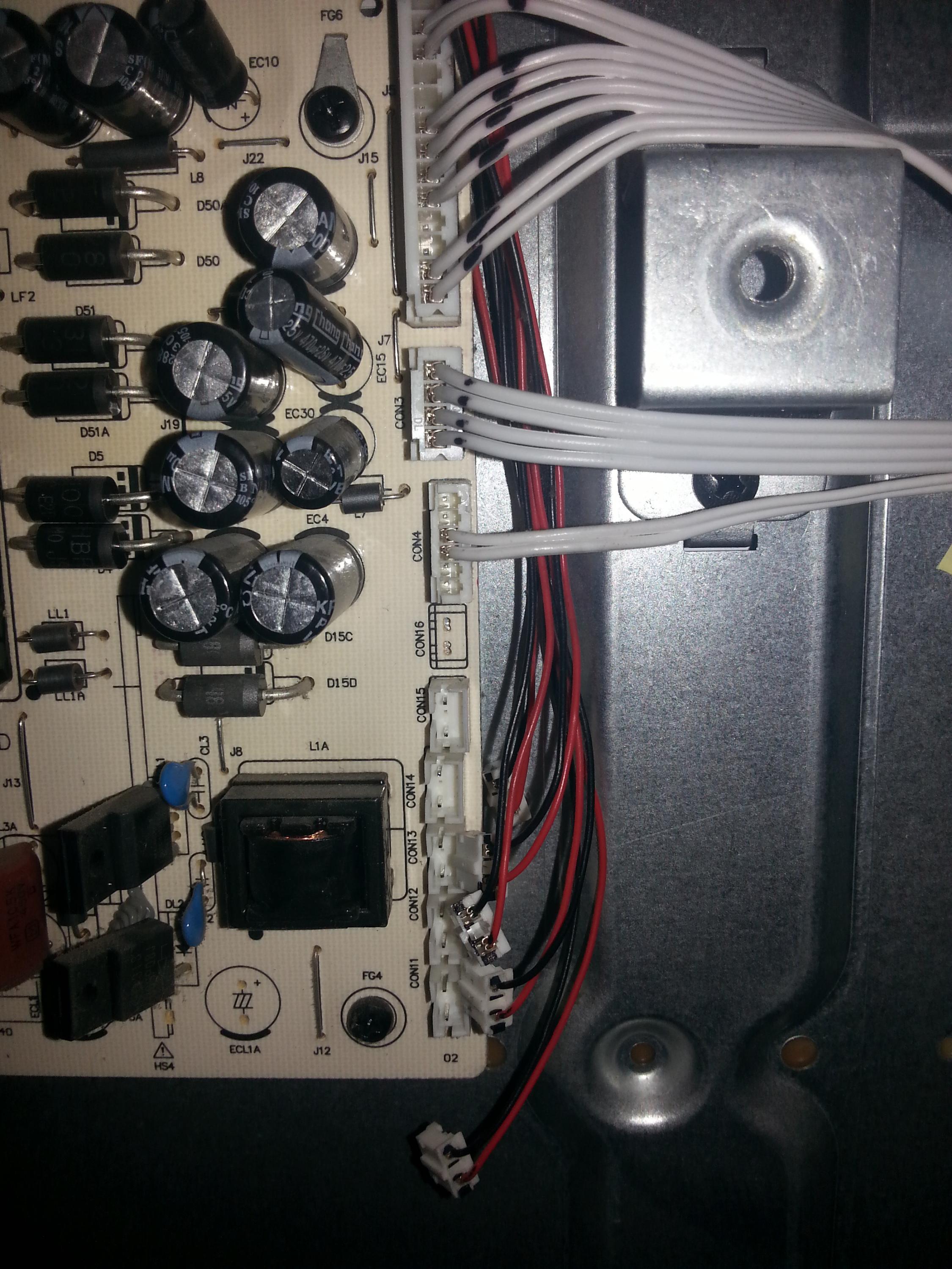

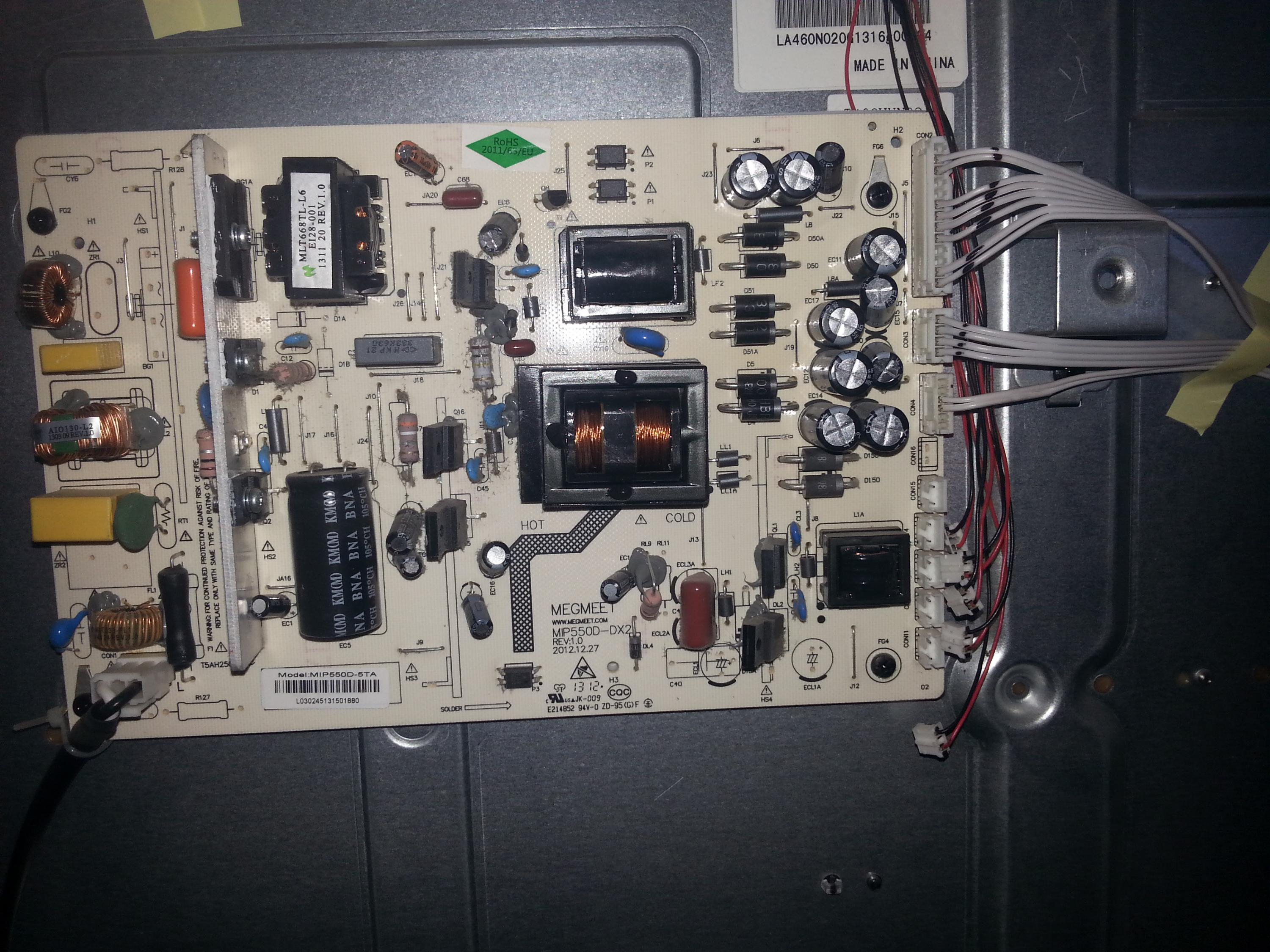

                                    Hi, I have a ELEFT466 with a working picture but no back-lighting. I cannot start a new post, so I was hoping that responding in this one would be OK.
                                    As I have said, I have a ELEFT466 with a working picture but no back-lighting.
                                    I am not sure where to go from here, as I have nearly no voltage ( 300mv) at the back-light header on the power board, and I am not sure if it should be higher. There are a total of 5 connectors for the back lights on the power supply.
                                    I dis-connected each back-light connector one at a time to see if a shorted LED could be the problem.
                                    The result was no back-light ( but I am not sure if this would be a correct way to determine if a shorted LED could be the cause.)
                                    I have tried applying power to the LED strip from a variable power supply (3 to 15 volts DC) but I am not sure if the 15 volts it goes up to is enough.
                                    The 2 wires at Con4 of the power supply come from what I believe is the main board, and the 2 wire connector on the main board says "inverter" I am not sure what type of voltage I should see here AC or DC or how much.
                                    Any additional info would be greatly appreciated.

                                      Re: Element ELEFT466 bad LED, read this before trying to fix!
                                      Disconnecting individual backlight connectors won't work. The LED driver circuit will immediately shut down in cases of overcurrent and undercurrent.
                                      Overcurrent: something's shorted.
                                      Undercurrent: something's open (i.e., connector unplugged).
                                      That's also why you don't see any voltage when you test. It shuts down almost instantly.
                                      15 volts is not enough. You need about 30. I used to use three 9v batteries in series.
                                      In my experience with this model, a bad LED is the most common problem.
                                      If you can apply about 30 volts to each connector, you'll be able to confirm if it's also the problem with yours.
                                        Perfect, I will try that.
                                        And thanks for the clarification on the over/under current.
