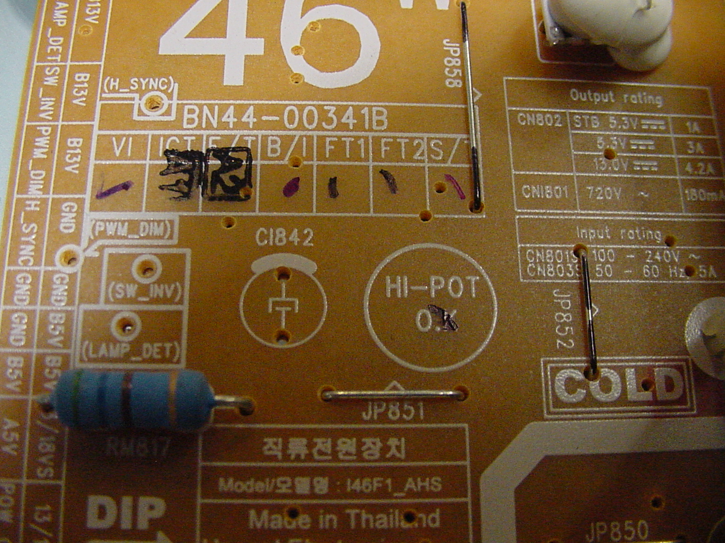

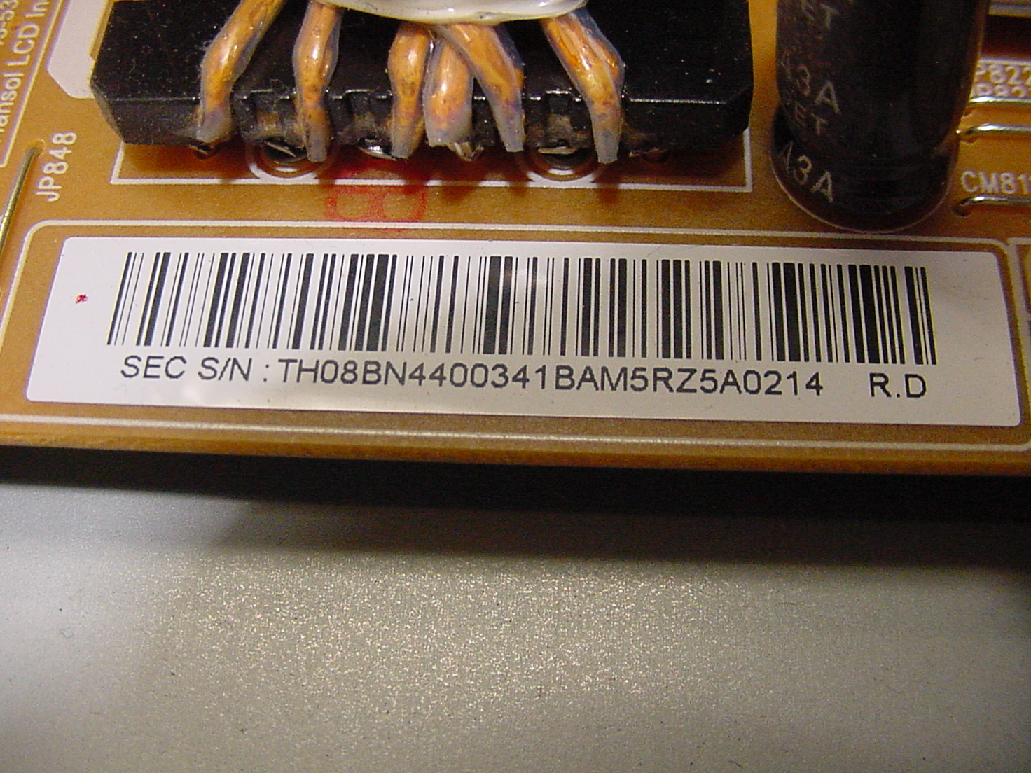

    Power supply/inverter board BN44-00341B, Jumper J852.

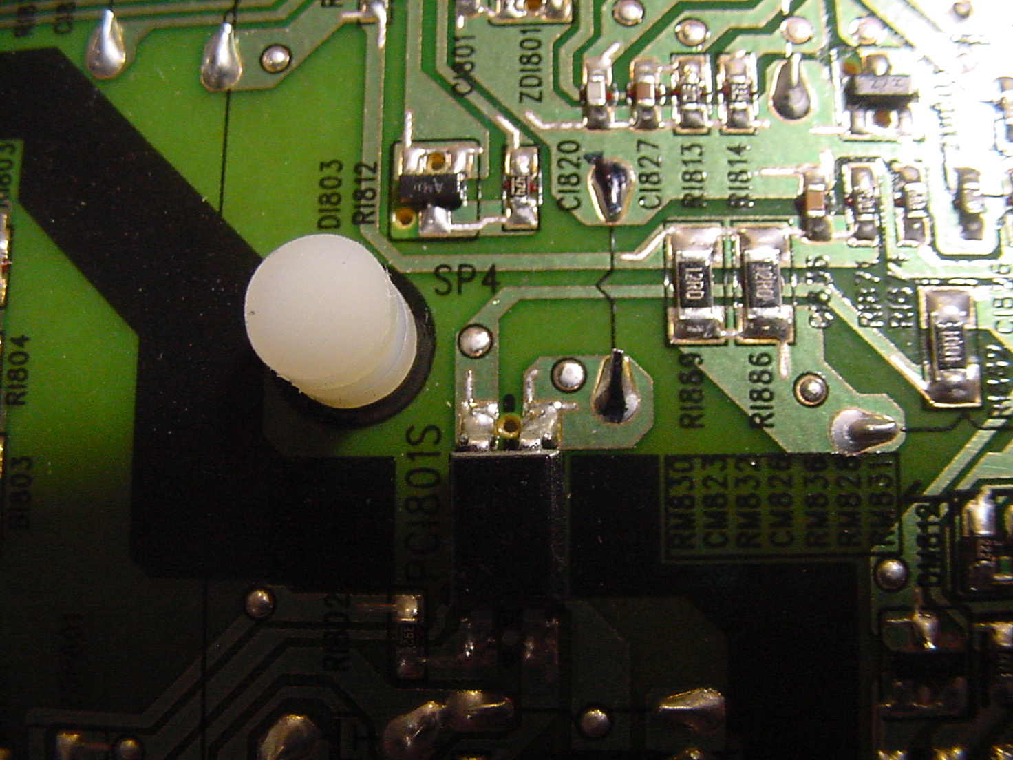

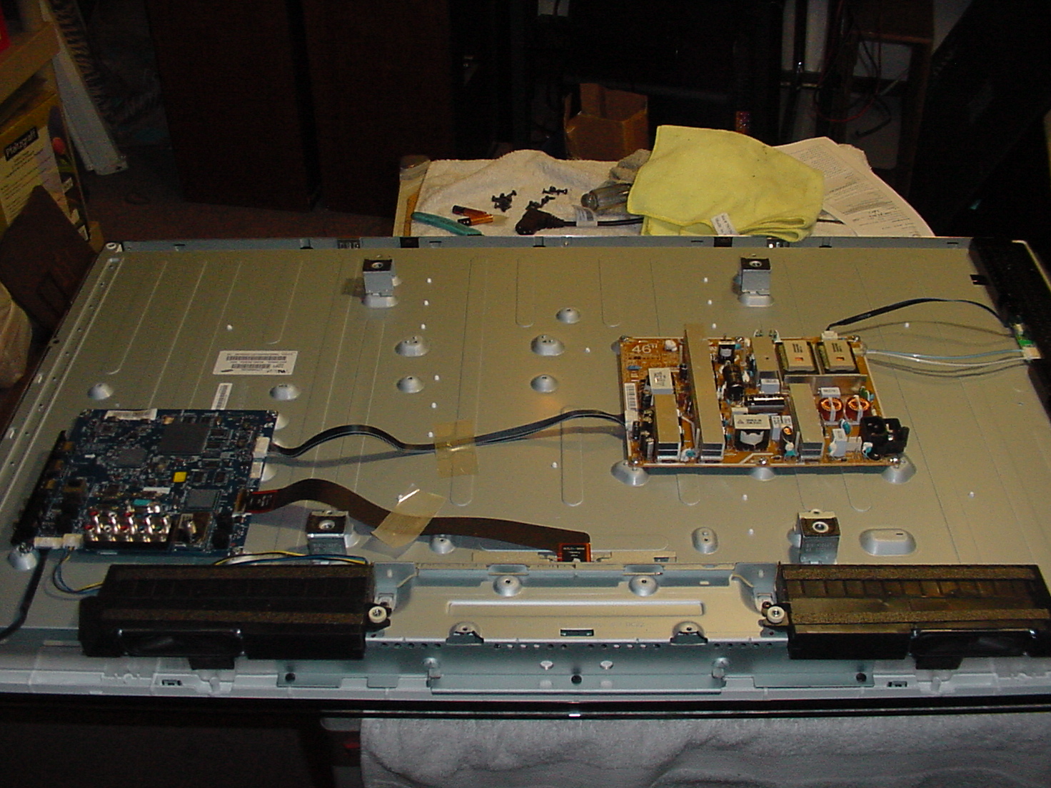

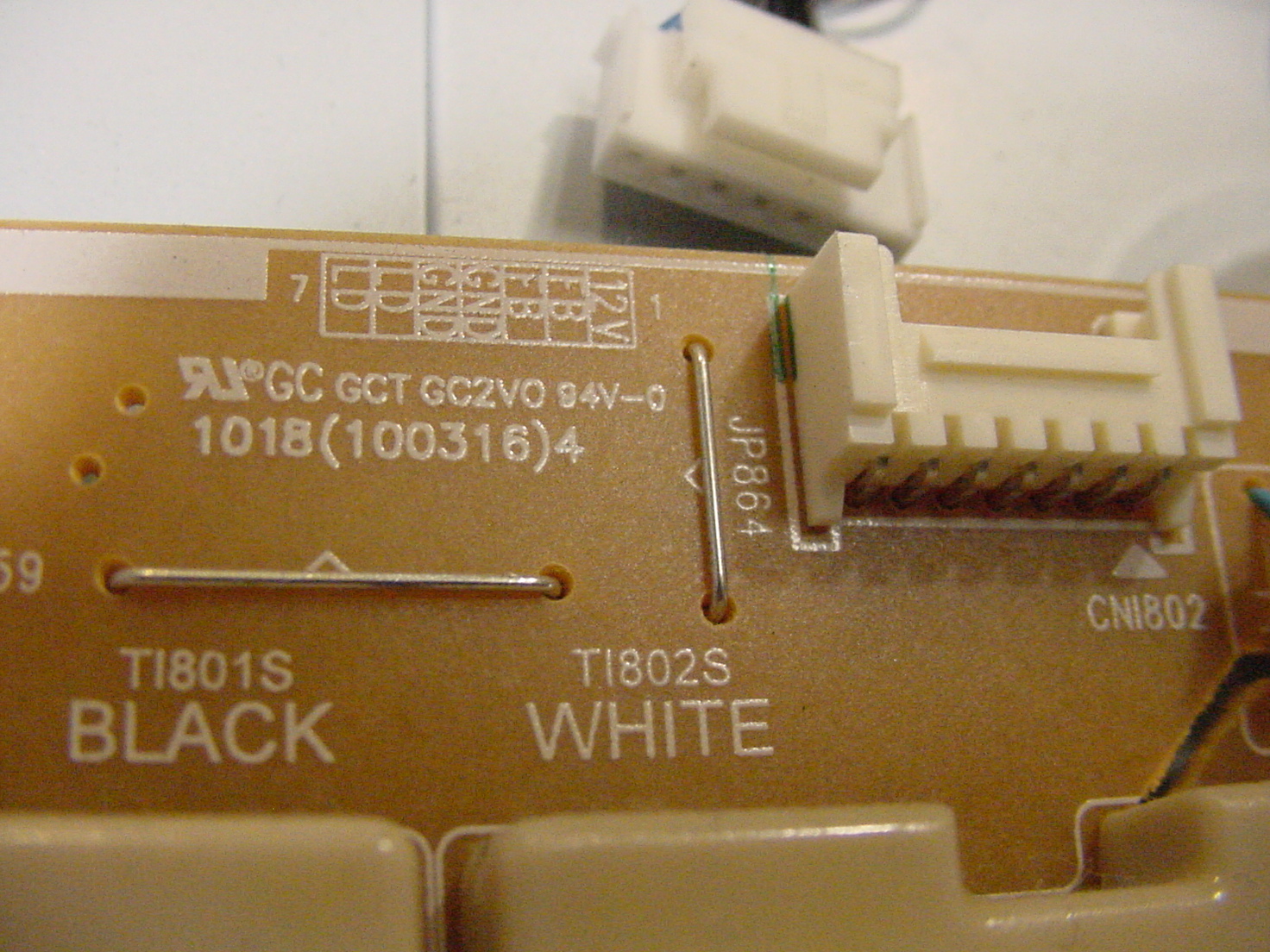

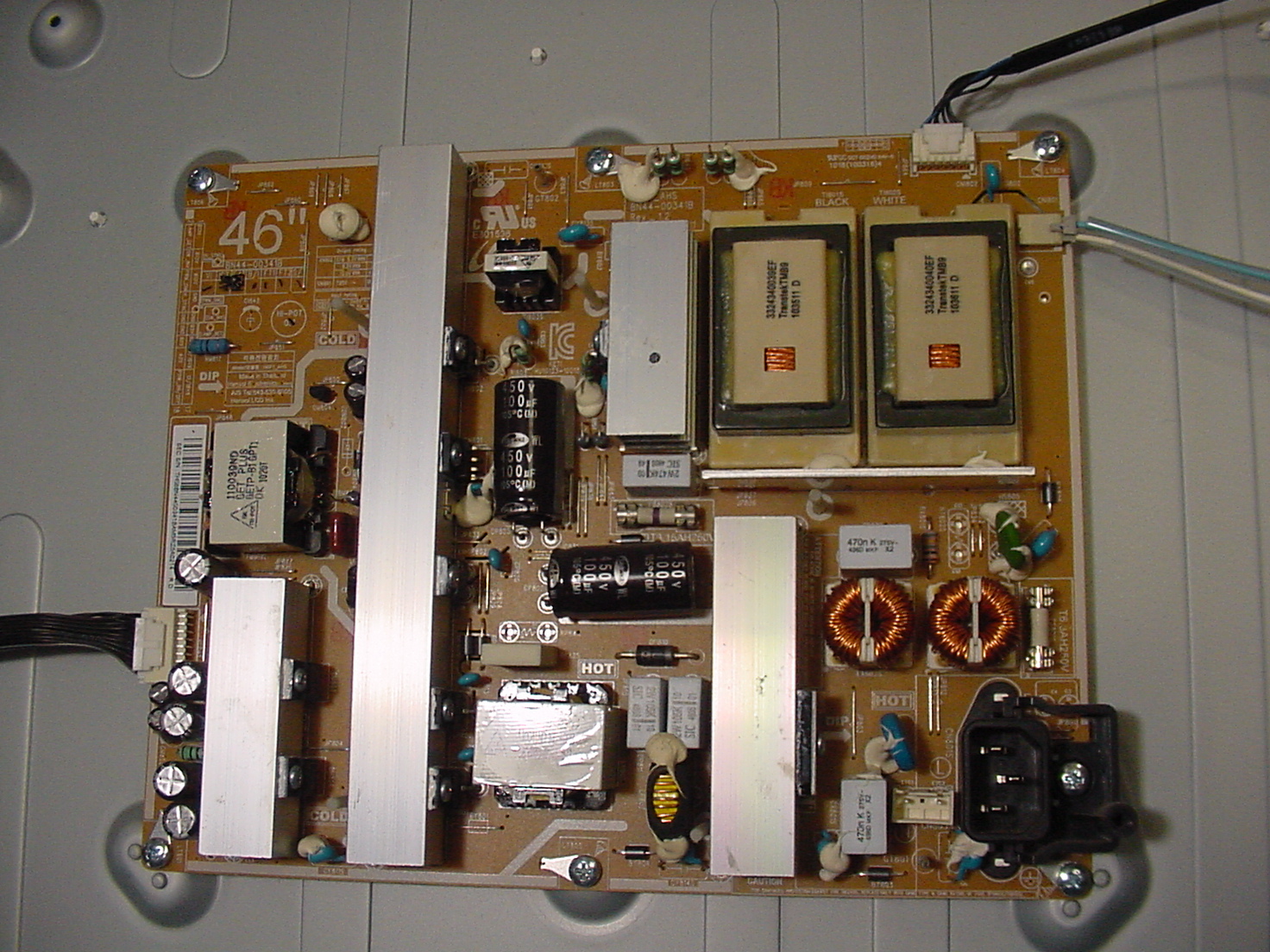

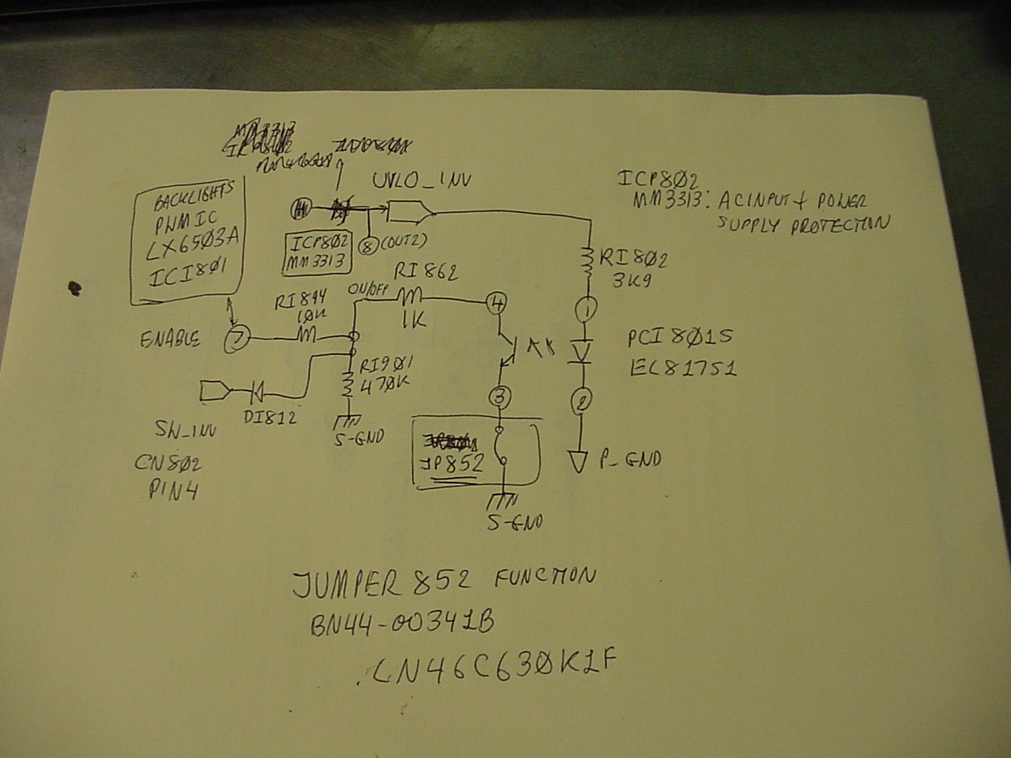

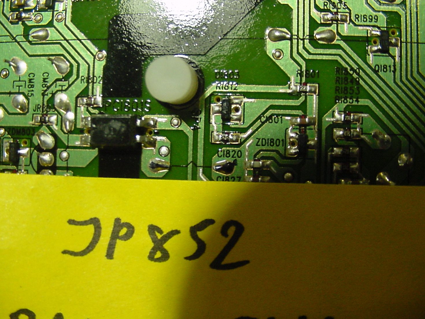

    Got this one in today. The backlights flicker. Looking through the thread and found that if the jumper J852 is cut then the problem will go away, but no one indicate what that jumper is for, so I look at the diagram of the BN44-00341B, it does show the jumper J852 (which is normal for most diagram).

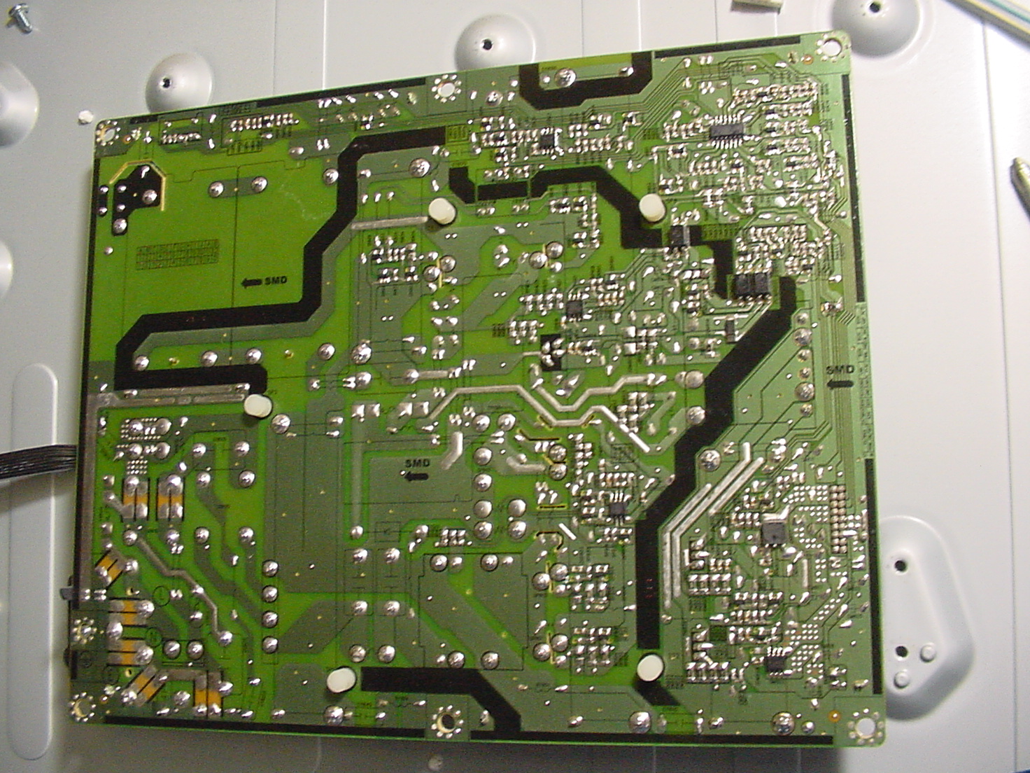

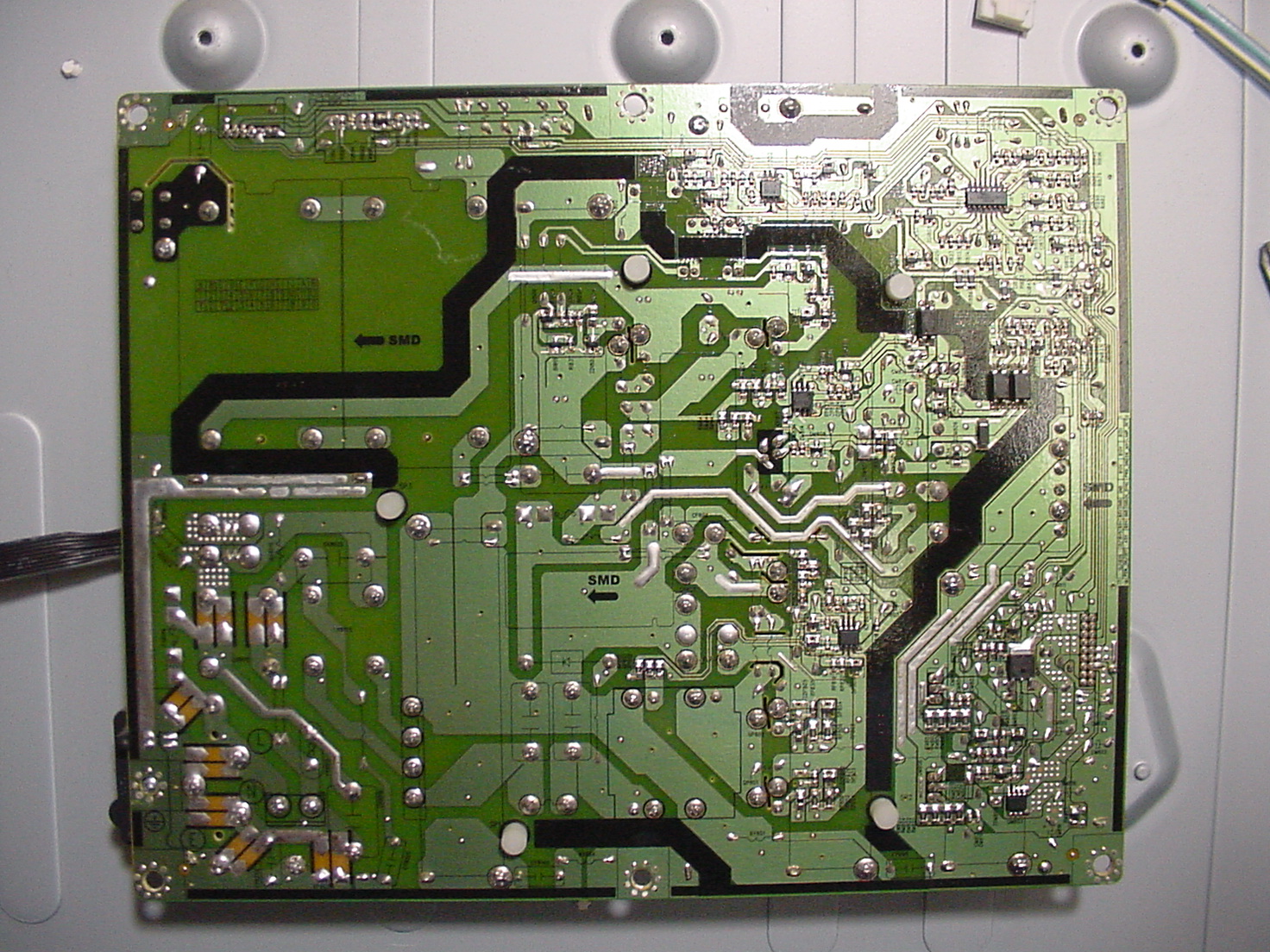

    I trace out the J852, that jumper is for connecting pin 3 (Emitter of the Photo transistor) of the OPTO PCI801S to the secondary side circuit ground. This OPTO is driven by MM3313 (AC Input/power supply protection) PIN 8 (OUT 2, UVLO_INV), DET2 (PIN3) of the MM3313 is the detection of the output Voltage of the PFC output Voltage. So by cutting the jumper, the protection circuit is removed.
    I try searching for the SAMSUNG service bulletin about cutting the jumper wire but did not find any official document from SAMSUNG. It seems to me that this is not really a fix, it is a removal of the protection circuit. The TV was work fine for the owner since 2010, so something must have changed or drift to cause the false protection to cut in and out which cause the flickering of the backlights. If I turn down the backlights level to about 1/4 of the max, then it does not flick. I did not have the times to do more in-depth troubleshooting to find the true cause of the problem yet.
    I noticed that the PFC Voltage booster is about 347VDC which seems low to me, the DET2 (PIN3) of the MM3313 is the detection of the output Voltage of the PFC output Voltage. I think there is problem with the feedback circuit feeding pin 1 of the PFC ICP801.

    PFC does not work well. Check/replace RP802, RP805, RP807, RP810. Check/replace ICP801.

        Re: Samsung ln46c630, bn44-00341b, j852
        "budm i searched but this is the best i can find but apparently that jumper is one they missed at the factory" I doubt that it was missed at the factory sinc eht TV was working fine for 5 years and start having the problem until now, Beside no one on those links never say or explain what the jumper is for that us why I trace out the connection which it turns out to be the protection circuit to detect Low PFC boosted Voltage, so basically, the circuit protection is disconnected.
        So if SAMSUNG actually recommended to cut that wire off for the protection circuit, then that to me it is not a really the proper fix and can be dangerous but hey take the risk and hope that the TV will die long before something bad really happen.
        The OPTO and the protection ICs are installed for reason, it is not like something that the factory can forget.
        It is not like jumper is put in during test and calibration and must be remove after the test is done, that jumper is part of the protection circuit.
        I sure like to see the official SAMSUNG Bulletin.
              Correct way of fixing the problem instead of cutting out the jumper which is part of the protection circuits.
                  Those 4 resistors (1.5M, RP802, 805, 807, 810) and the 39K RP819 form the Voltage divider for the feedback for the PFC circuit to maintain the output Voltage, if the resistance of the top resistor strings goes down then the Voltage on RP819 will go up so it will make the PFC Voltage to go down.
                  If the resistance of RP819 goes up, it will also have the same effect.
