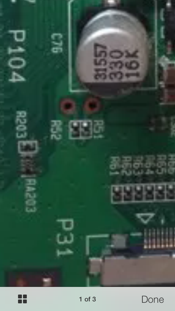

                        Re: LG 50PK590 No Display
                        If like Tom says all the voltages are staying up and not dropping.
                        Connect these 2 holes on the control board and disconnect the LVDS cable to the mainboard.
                        If you get test patterns on screen you have a bad mainboard.
                        • speedypro
                          • Feb 2013
                          • 561
                          • United Kingdom
                          Got test patterns. Well done. Thanks both of you. So main board is at fault. I'll see what's on eBay's.
