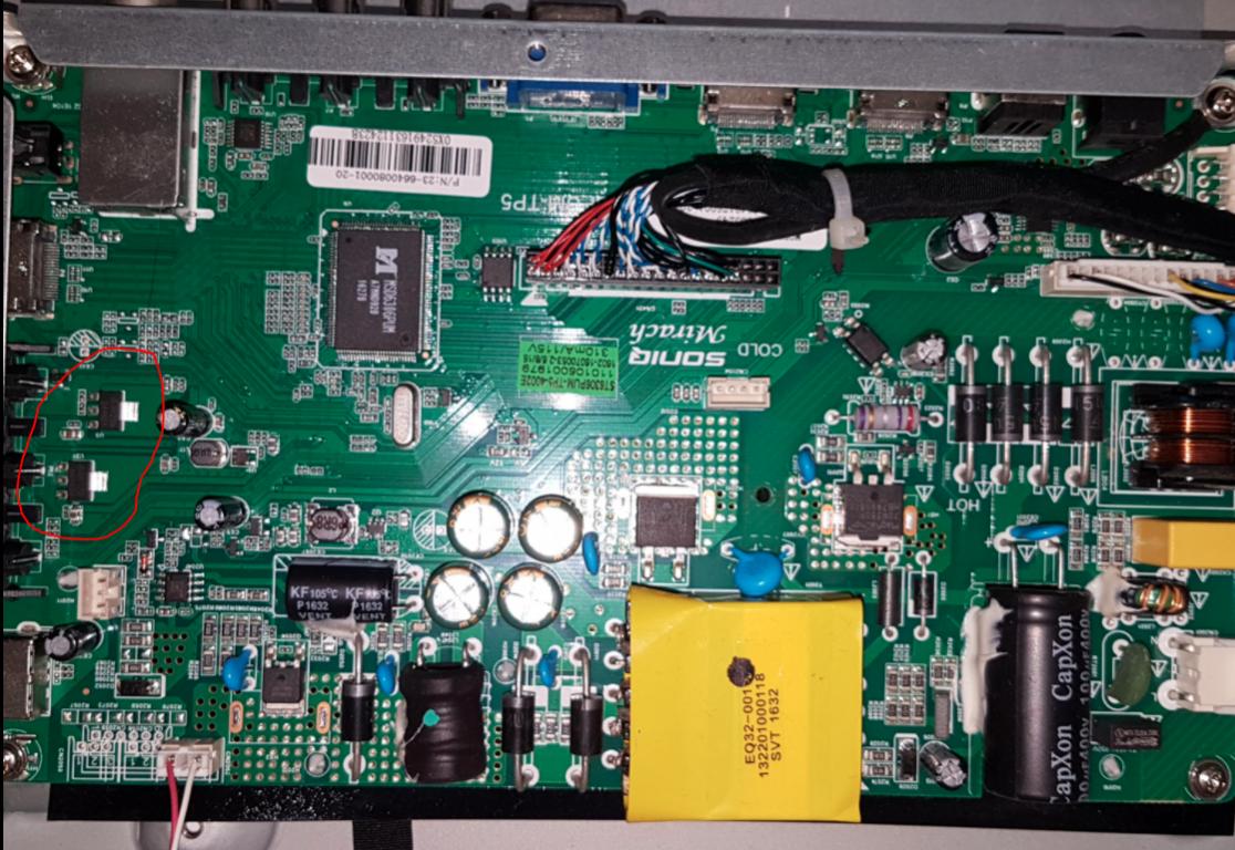

    Re: Soniq E40W13C-AU TV Stuck on standby
    Originally posted by citymorgue2
    Sorry but didn't someone post a picture of the motherboard that showed where
    BM1117-ADJ and ams1117 adj chips go?
    Look at the photo
    • citymorgue2
      • Aug 2021
      • 3
      #42
      Originally posted by lotas
      Look at the photo
      Weird. Last night I could access that picture. Thanks.
      I can't make out the details but I'm assuming the existing chips will be marked and it's an easy swap. Guess I'll find our tonight when I open it up.
      • citymorgue2
        • Aug 2021
        • 3
        #43
        So stupidly I tool my flatmates word for the tv being the right model but it isn't.
        It's a s70uv16A-AU. The board is understandably different so I need the correct chip. All the chips on this board have the same number 117 6H3H
