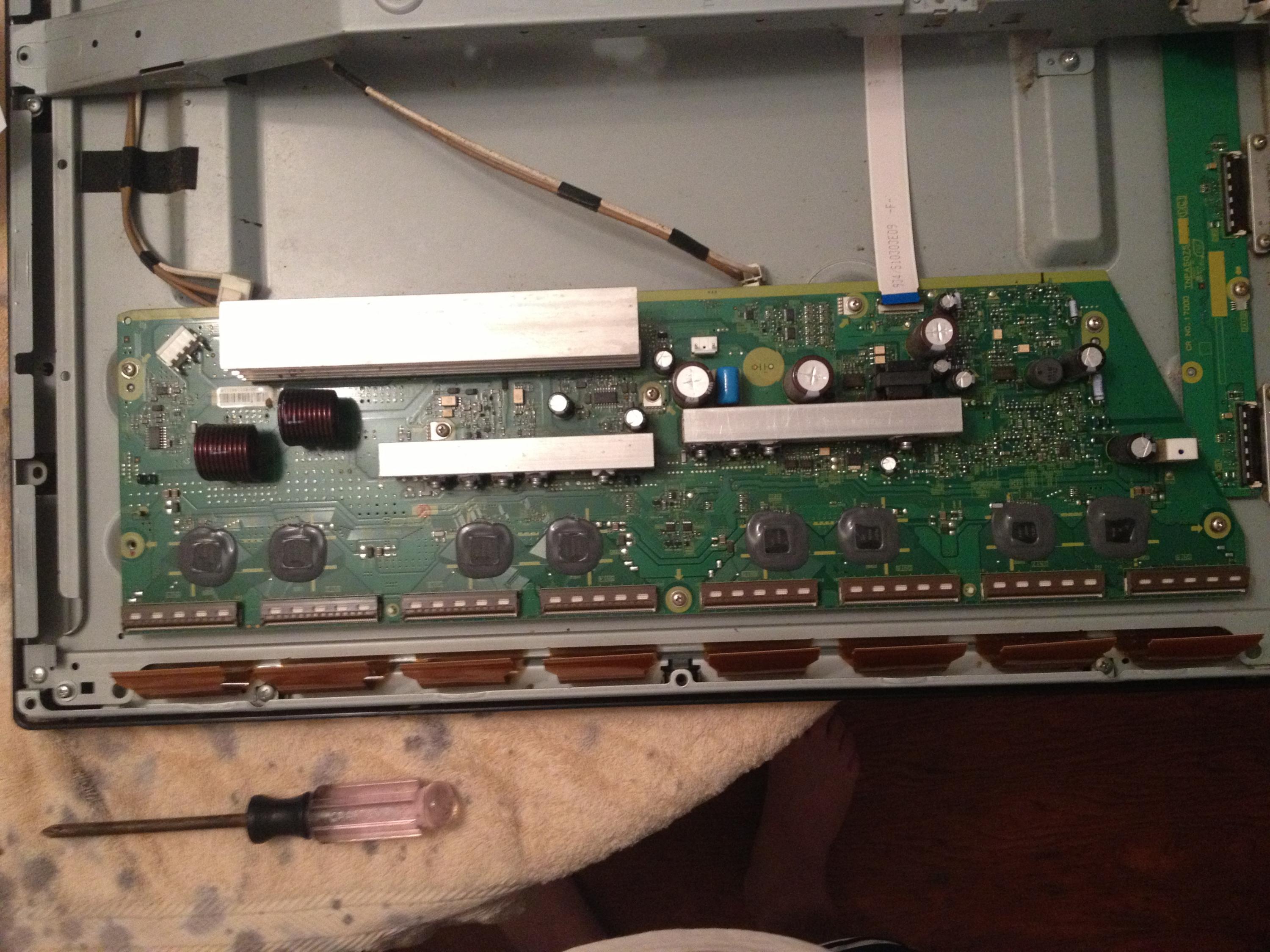

    SOS 7, service manual says SN board *, disconnected 2 connectors and ribbon from SN board and get SOS 10, original SN board TNPA5066 (suffix "OK" stamped) unavailable at shopjimmydotcom they said TNPA5066AC is compatible replacement. Received Part, looks the same, installed and now I get SOS code 10 with new SN board installed, removed cables and ribbon from new board and coded 10 as well.
    The service manual says (checkpoint) "*use SC jig to isolate the board" which I can find no instruction of this jig in the book.
    I am not really a diagnostic guy although I know my basics around a meter but thought id get lucky with the swap-tronics.
    layman's terms please and thank you in advance.
    Scott

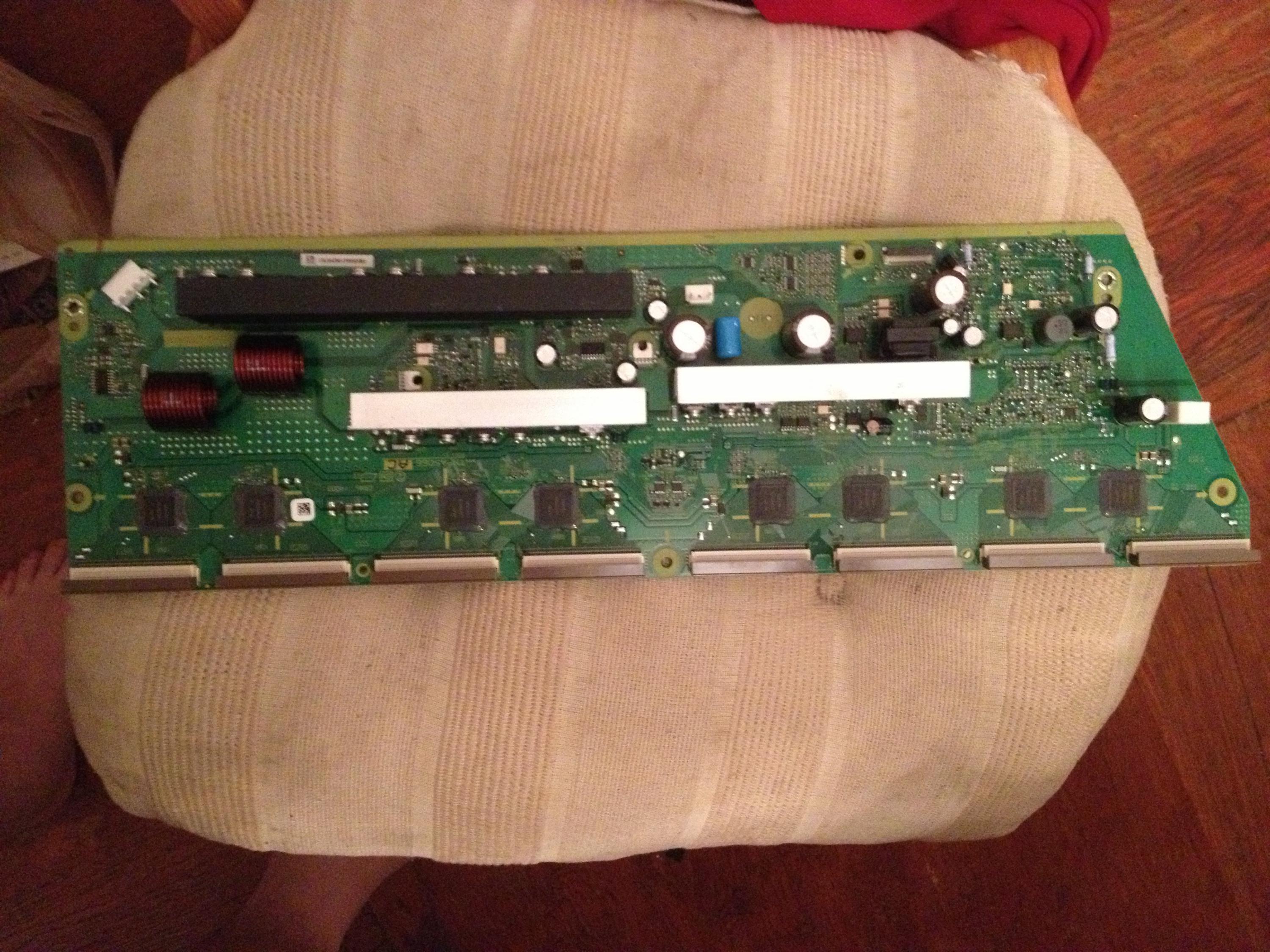

      Re: Tc-p42c2 code 7
      The SC jig is just a jumper that shorts the two pins together.
      Next, please send some whole board pix's of the SC top and bottom.

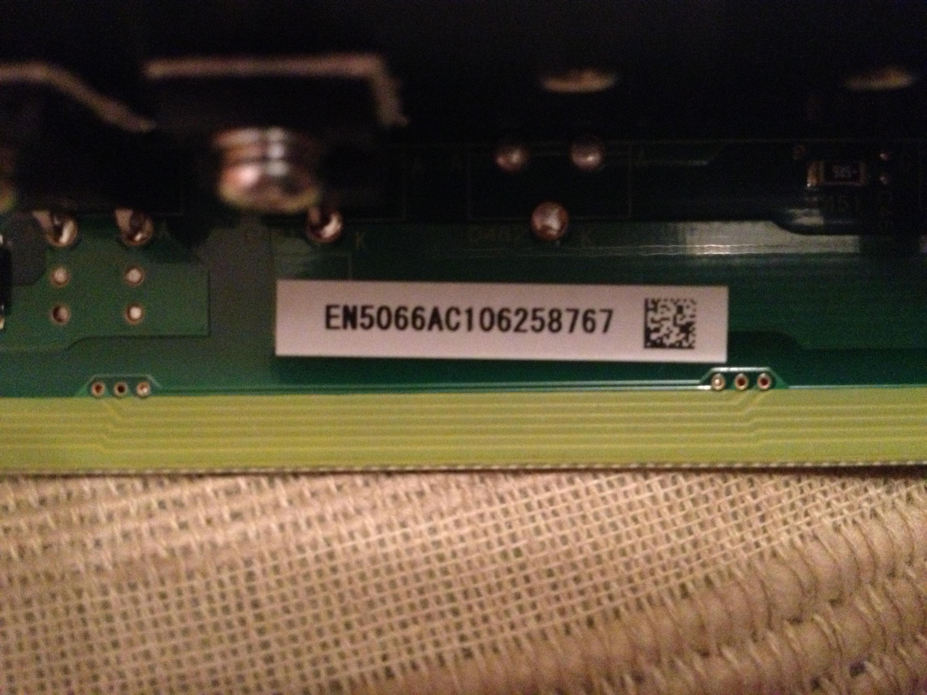

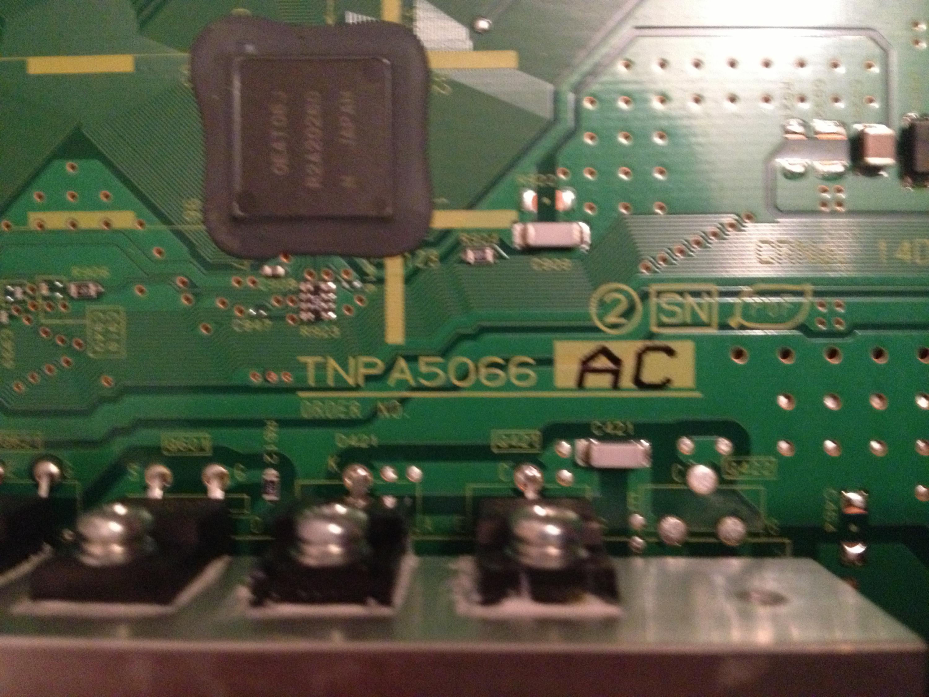

          Re: Tc-p42c2 code 7
          New board

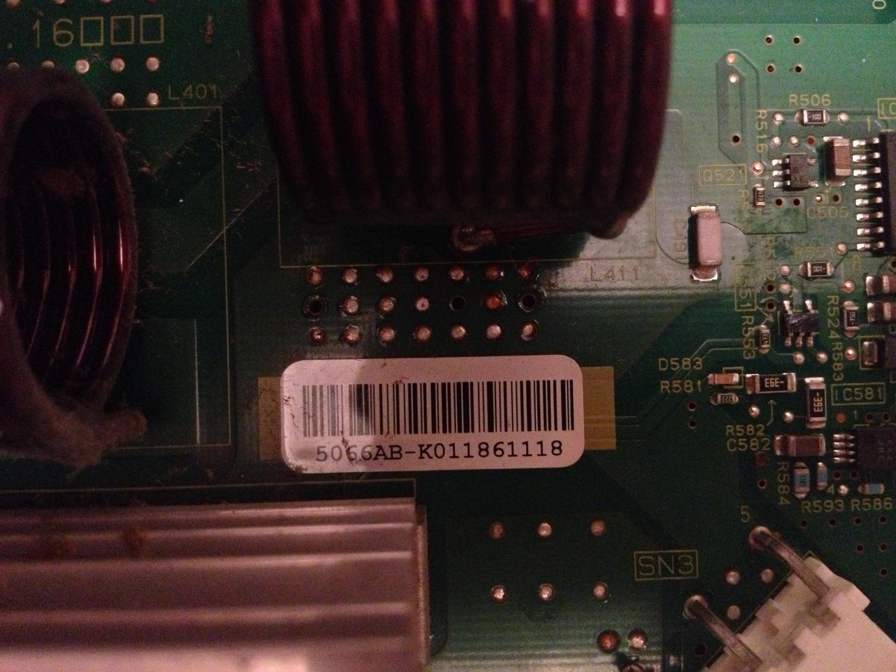

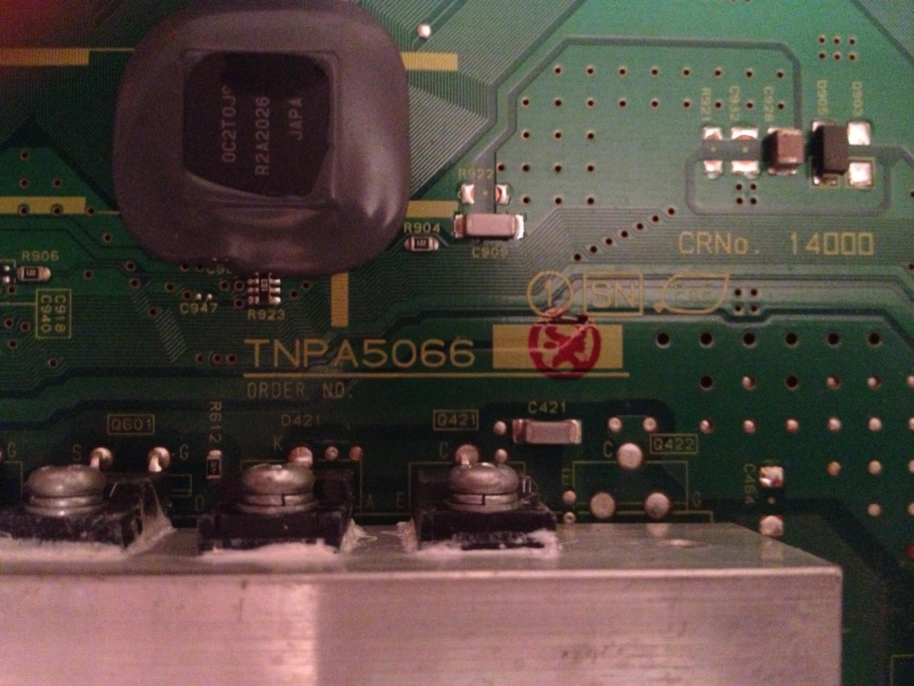

            Re: Tc-p42c2 code 7
            old board

              Re: Tc-p42c2 code 7
              yep, so what you have are TNPA5066 revisions AC & AB, there may be a 3rd version which also will work. Don't get hung up on the fact you have different version, both are suitable.
