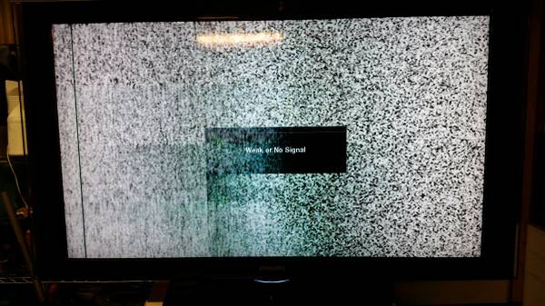

    Samsung LN5271F Snowy Picture
    Does anyone have any idea what's going on here?
  • Hamie
    • Apr 2014
    • 1383
    Re: Samsung LN5271F Snowy Picture
    Bad panel I'm afraid, especially the black line to the left hand side.
    • DoItYourselfer
      • Apr 2015
      • 16
      Thanks! Do you mean bad panel as in power supply or video card?
      • Tfsjake
        • Jul 2015
        • 14
        The panel usually refers to the actual 'screen'.
        • DoItYourselfer
          • Apr 2015
          • 16
          Thanks, that's what I thought he meant. What can go bad on a lcd screen if its not broken or cracked?
          Could the line be tab bonding? I just don't get the snow.
          Thanks!
          • Hamie
            • Apr 2014
            • 1383
            The snow is just the analogue signal.
            Change it to hdmi and it should go away.
            Yes most likely is a tab bond failure. Or Ribbon ICs are failing.
            • DoItYourselfer
              • Apr 2015
              • 16
              Got it! Thanks!
              I'm on it and will let you know how it turns out.
