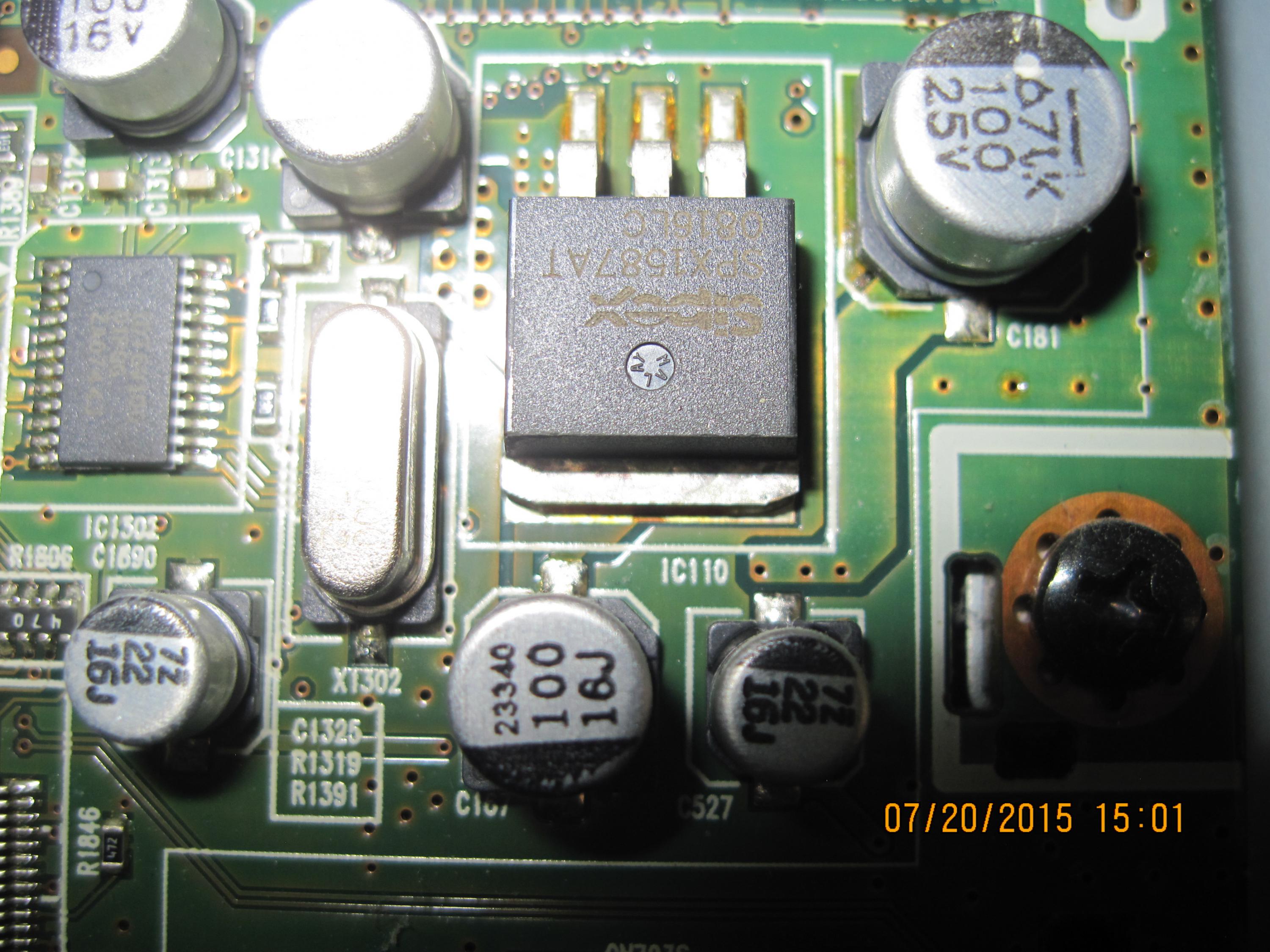

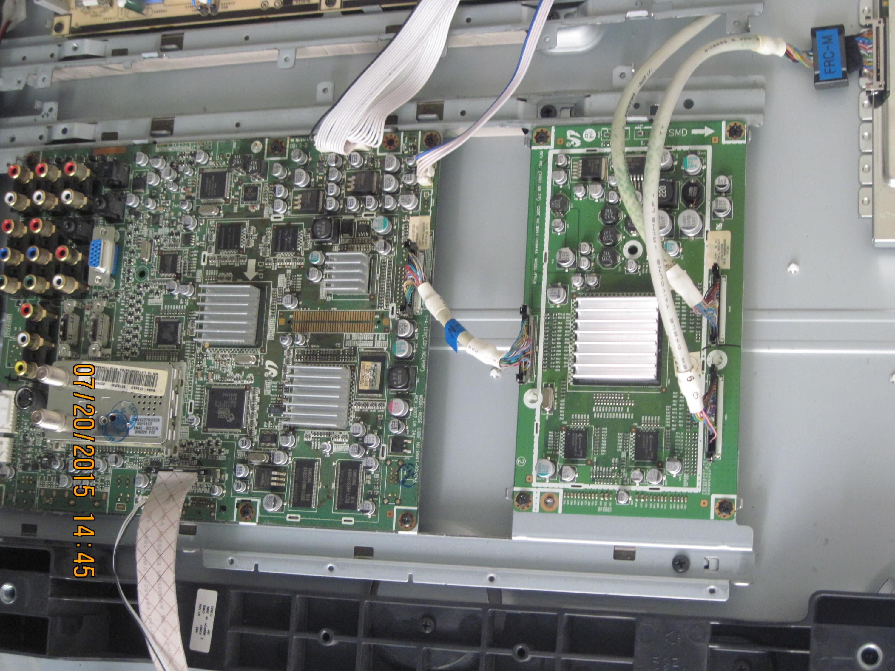

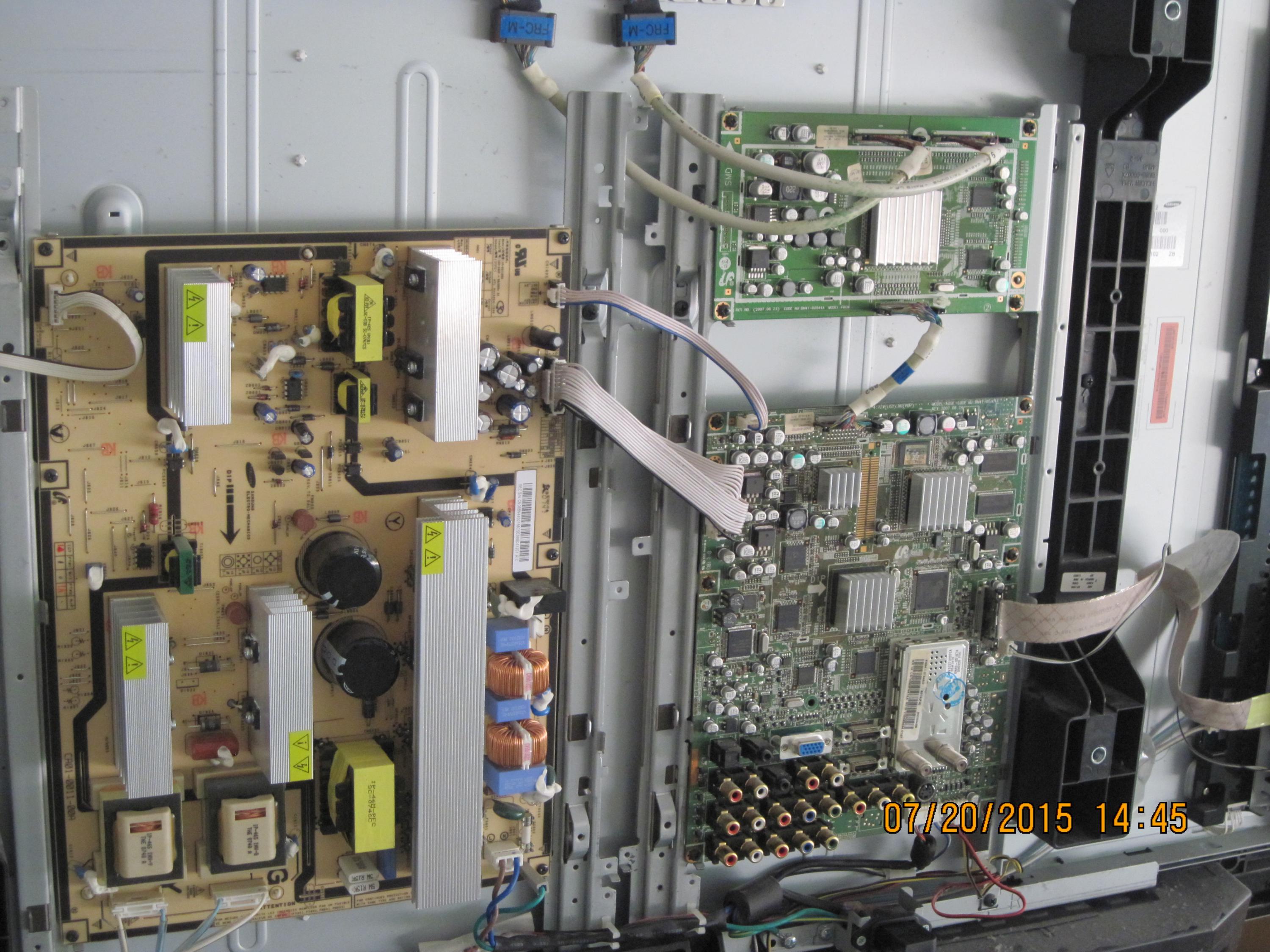

    Trying to save this set from the dump. Blinking stand-by when power on. The backlight does come on and their is sound but no picture.

    Check the T-con board fuse. common fault on this set.

      Re: Samsung ln-t4669f
      .6 ohms
        Any DCV between the fuse terminal and the chassis?
          13.44dcv
            Both sides?
              sorry about but yes both sides
