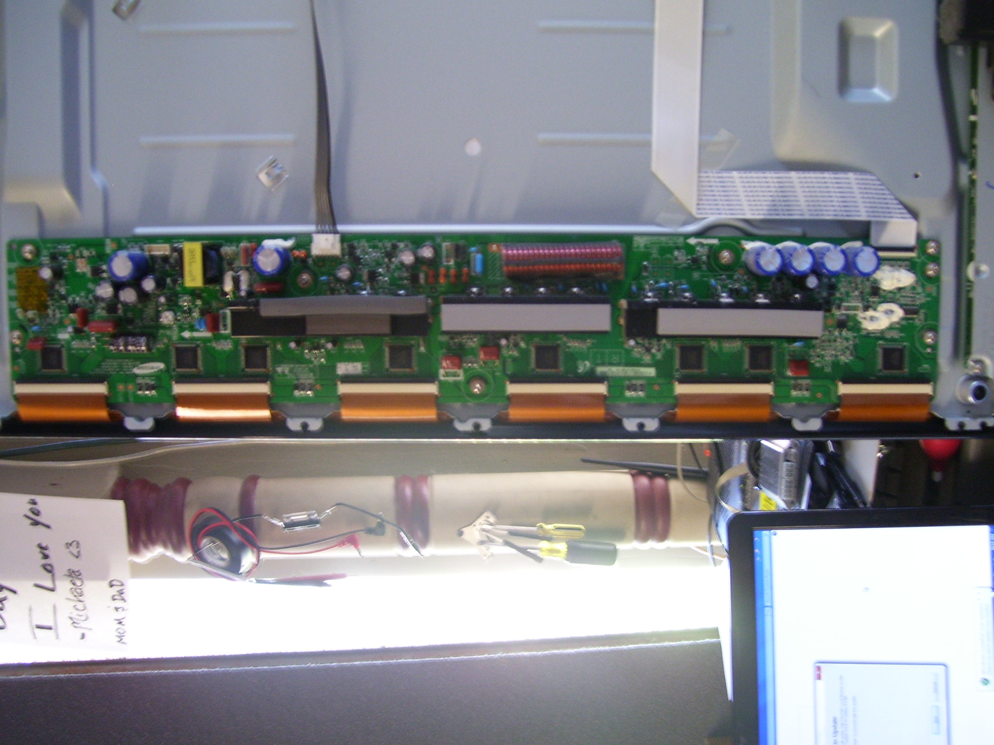

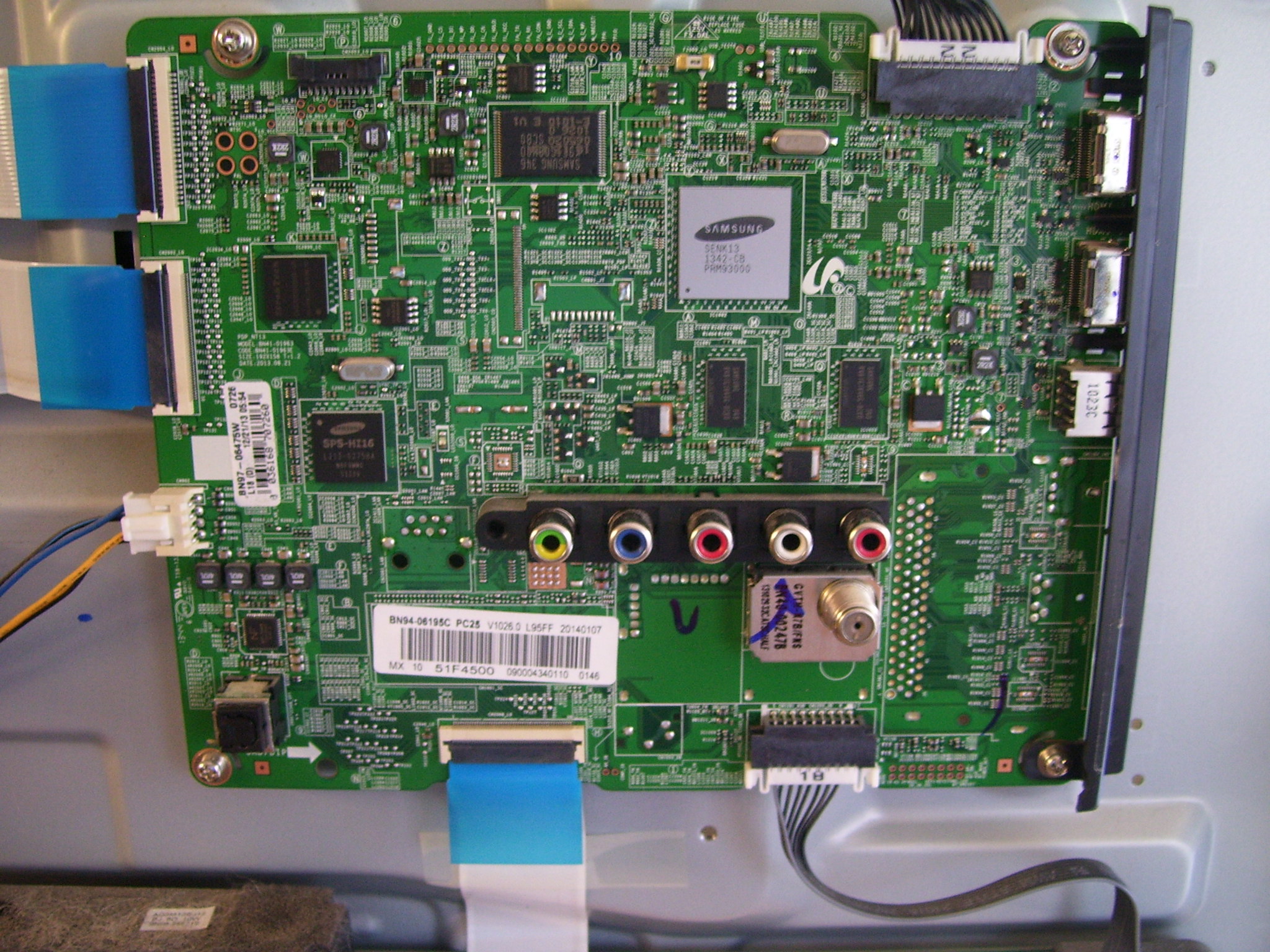

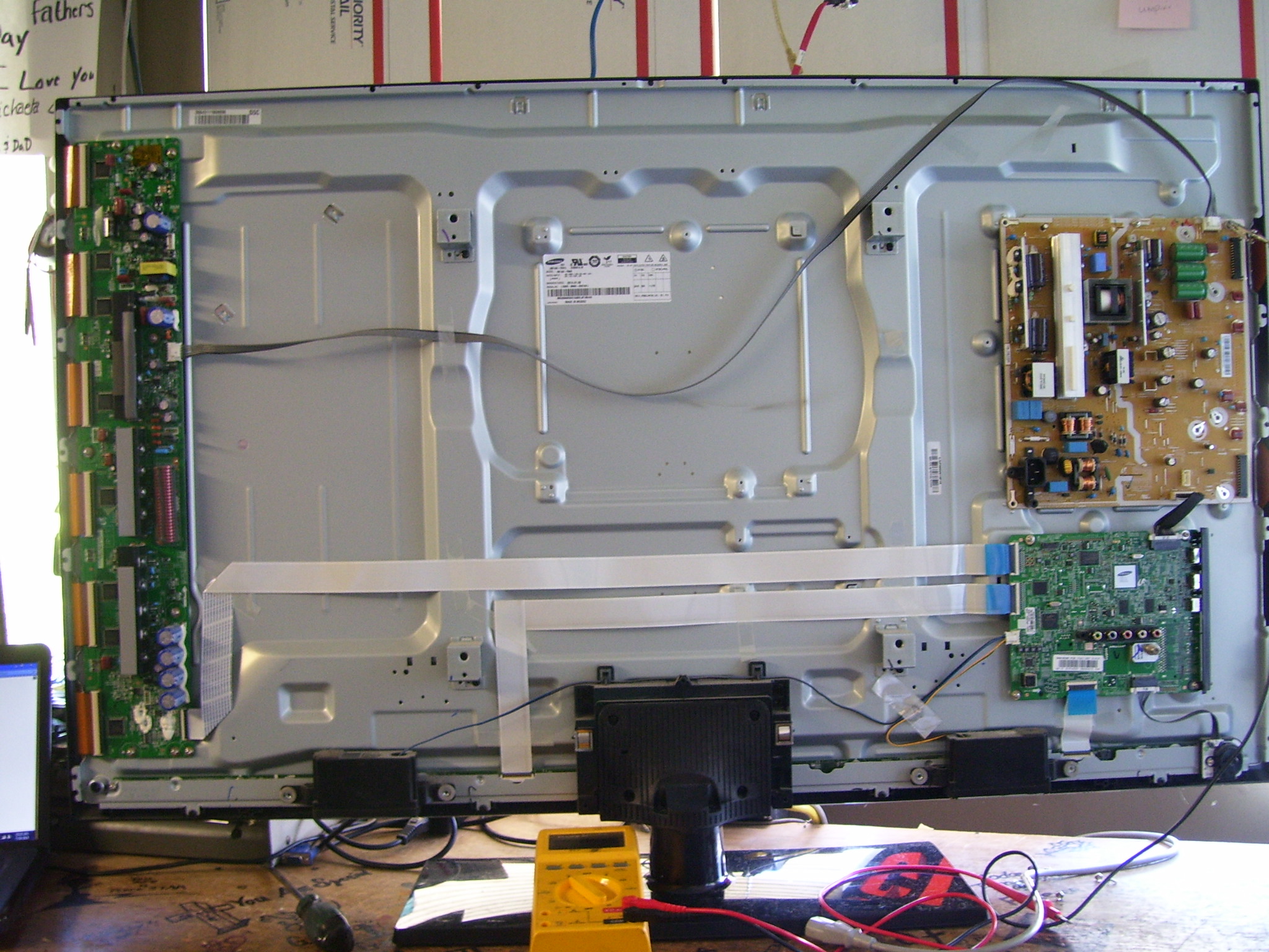

    I have a PN51f4550 , it has a noise coming from inside panel ( no spk's) after power surge, no picture no sound. , I have tv repair experience but this one got me.
    Help

    VS and VA are in spec's

      Does the panel have any cracks or damage on it? Even the smallest crack can stop it working and cause a buzz sound.
        Re: PN51f4550 noise from panel after power surge
        No Sir, no cracks, power suge, lights in house went out , tv came back on , as it is now
        Mike
          Right - could you possibly make a recording of the noise and upload it to YouTube?
          Do you have an oscilloscope you can use to make some PDP waveform tests?
            I can make a recording and upload , will post link, sorry no scope
