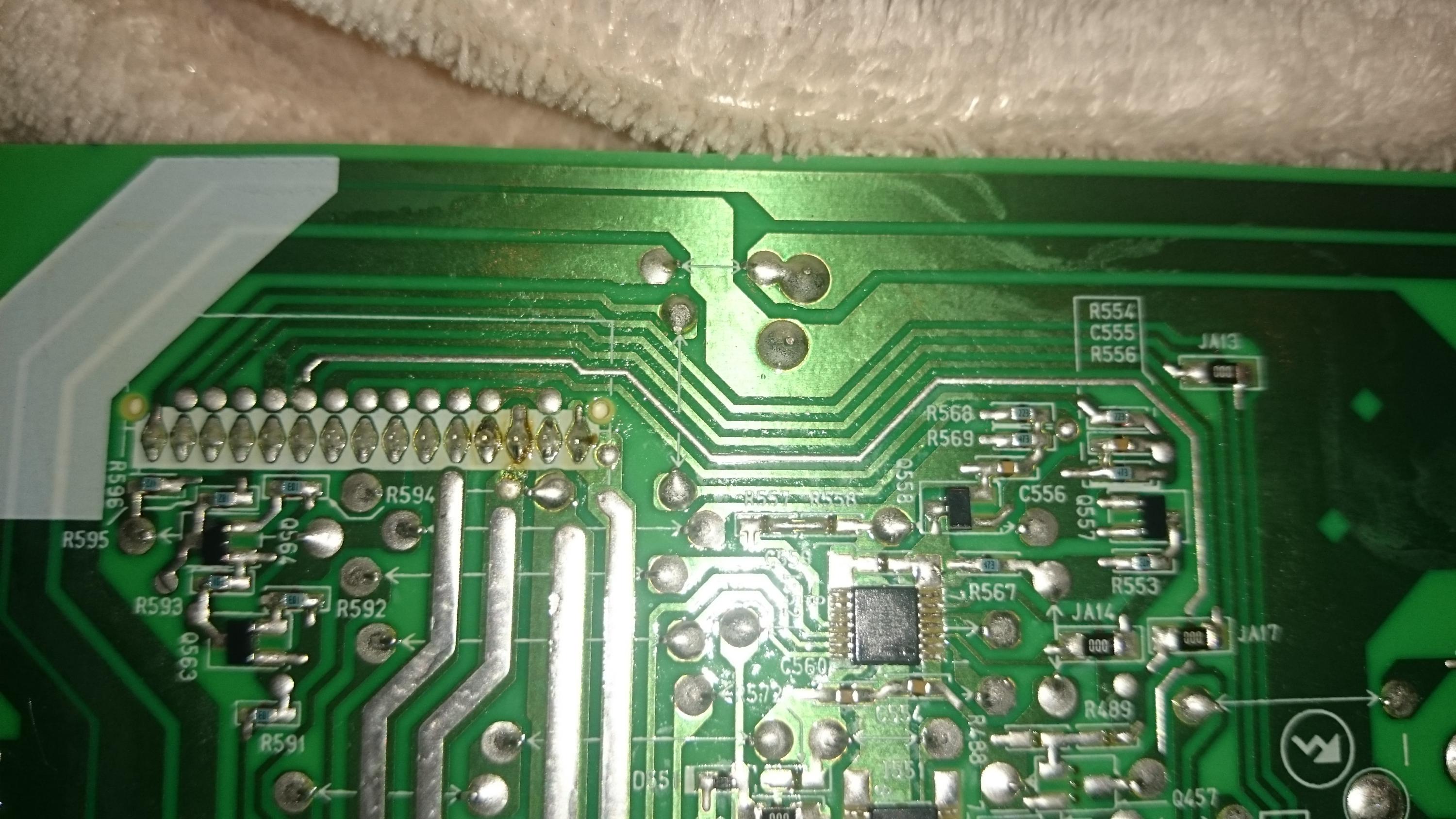

    I took a better picture. The silver line is pin6! If you follow that line you end up on JA17. The line next to the silver line is P5/STB5V wich goes to JA17 ---> R489 --> trace goes under JA14 to pin 6 of I552.
    Thats all i can see.

            Ok , scrubbed the part hard with alcohol and this is the type :
            SLG4K034G K176004BA

                                    Ok , starting to understand the schematics a bit. EV5V is going from pin6/P6 to the mainboard to Q2001 which sends a signal to IC2002 with is a peko switch that turns on the STB5V.
                                    I do have 5V on Q2001 but not on Q2002/2004 which means IC2002 is not working. Need to find the same chip to see if the error goes away or a new board ( or troubleshooting which is hard on a mainboard ).

                                      Oh dear, well that's why I kept asking if you had 5V on that thick trace pin - and to try trace it back. I thought you did not have any standby. I would not have said the power board was bad otherwise.
                                      It is probably a main board fault then, what is the marking of that pin that does have 4.6V on it? is it standby or some switch signal?
