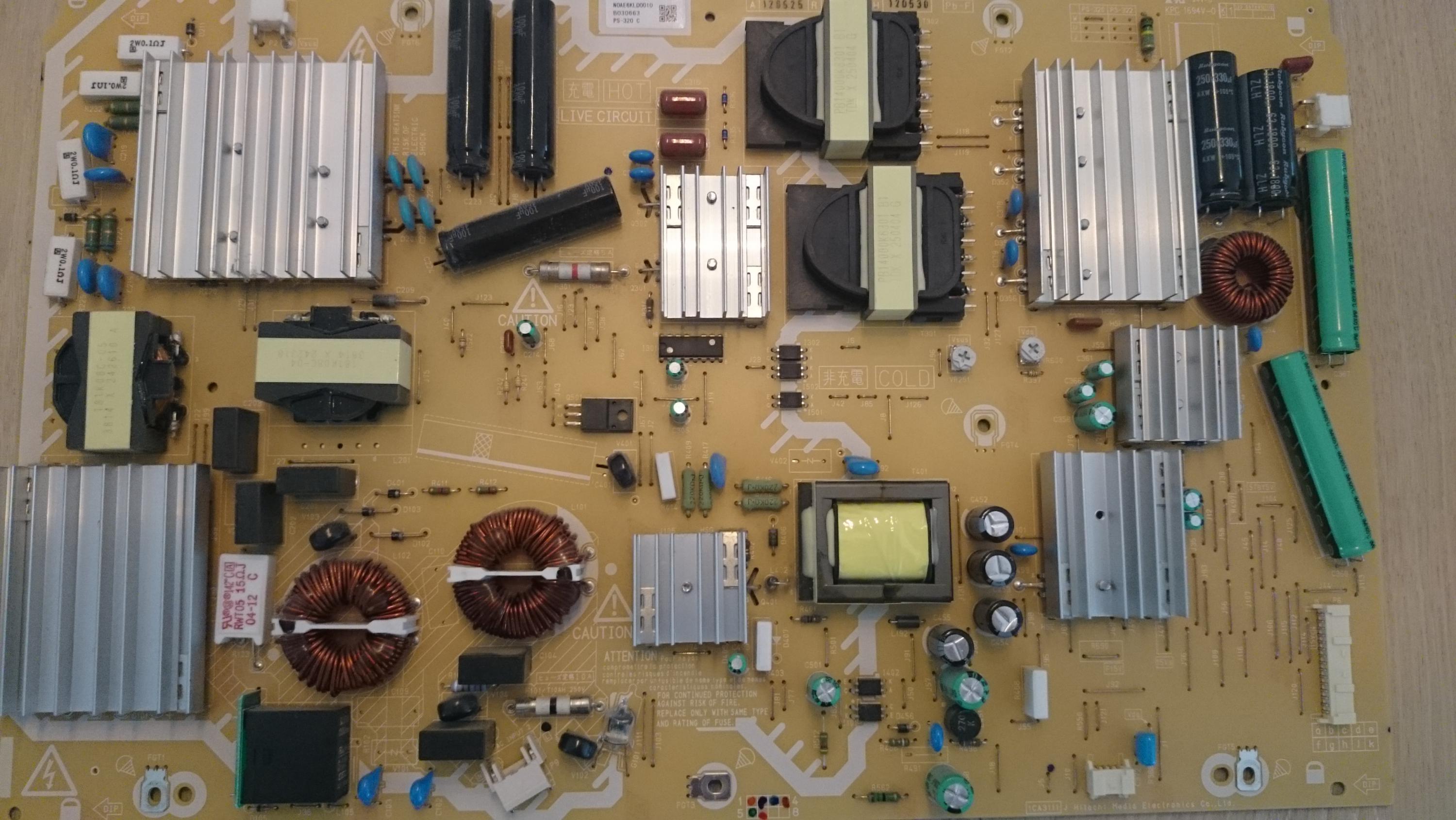

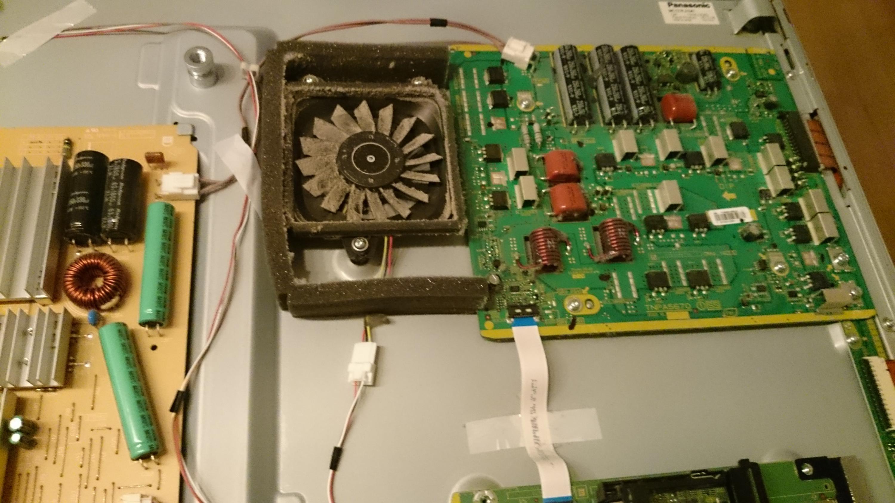

    Hey guys!
    Got this beast right here real cheap ( 130£ ) that wont turn on.
    Symptoms :
    Owner got home after long weekend away from home and tv didnt work.
    Powersurge protector had green led......
    -Wont turn on at all
    -No led is blinking
    -No fans are spinning
    -No relay clicks
    -No voltages on connector P6
    -No voltages on Vsus/Zsus
    Both fuses on PS are ok and voltages are running over it.
    Whole tv is PERFECT , not even a scratch.
    Im suspecting the power supply but have not looked in the service manual yet.
    Going to download the SM and check the voltages but if anyone has any suggestions....let me know!

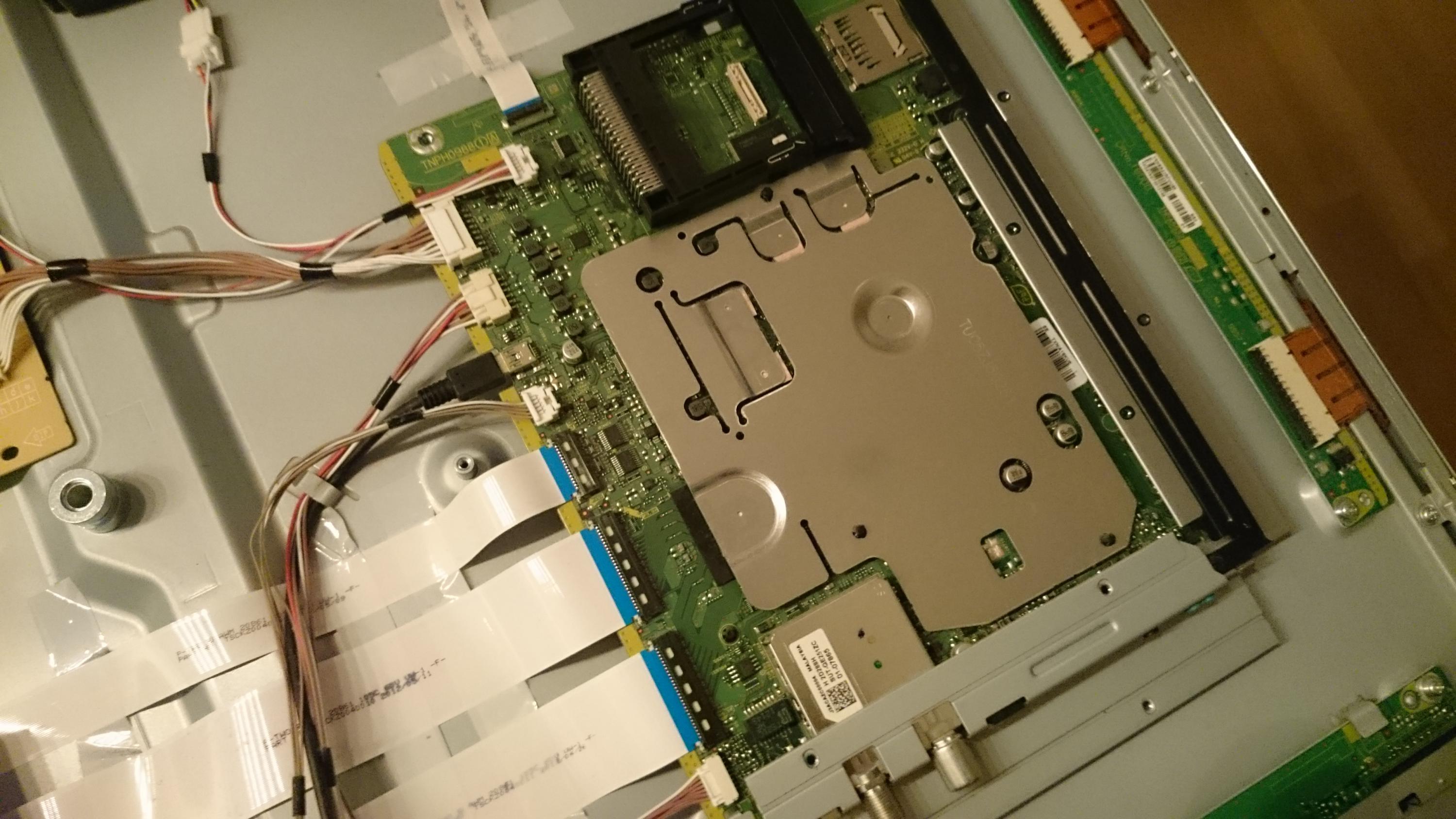

    Re: Panasonic TX-P50VT50E completely dead!
    Forgot the mainboard.
      Check for 5V standby from PSU.
      If it's present, then the A board is most likely the fault.
      If not, then it's probably the power board -- good chance you can fix it too.
      If the 5V is missing, then pull the A board to P board power connectors and re-check, to eliminate a possible shorted A board. If 5V comes back after the connectors pulled the A board may be bad.
      Also check the main on/off switch - it's usually just a signal to the PSU - it could go bad, which will cause the PSU to act dead.

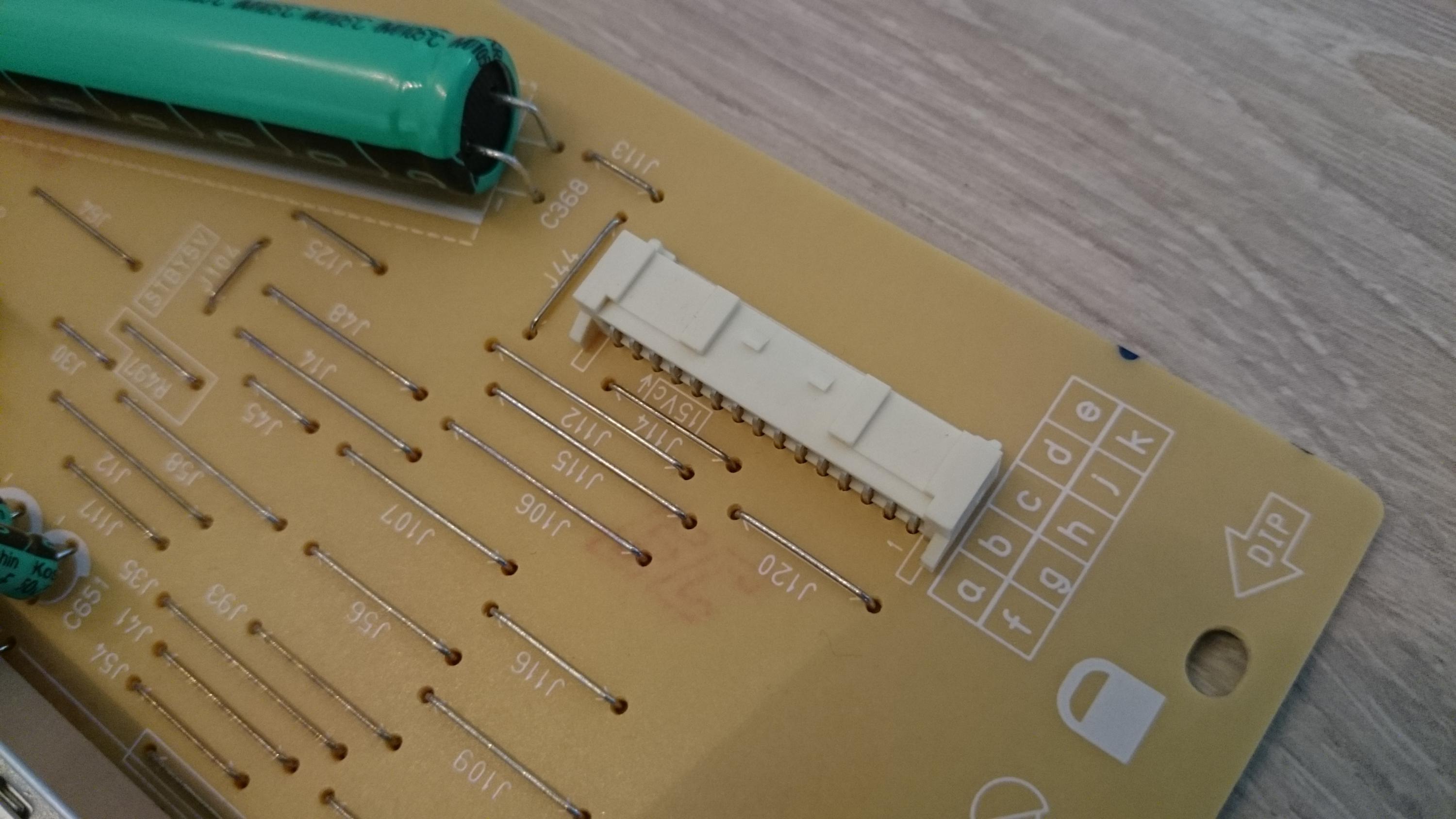

                        Haha sorry , wanna fix this amazing tv! Will try to slow down!
                        Well , i don't have STBY5V on pin 5 from connector P6. According to the service manual i must measure 5v there. There are absolutely no voltages present on P6 so thats bad.
                        Reading through the threads about the U203 ic the symptoms are exactly the same but mine is a different ic from a later ps.
                        I will try and trace back the 5v voltage and see if i can find something , it can be a bad cap right?
                        The power button line runs though the bottom boards to the PS and not mainboard , not seen that before.....
                        Will try and search for any faults , if you have any tips please tell me

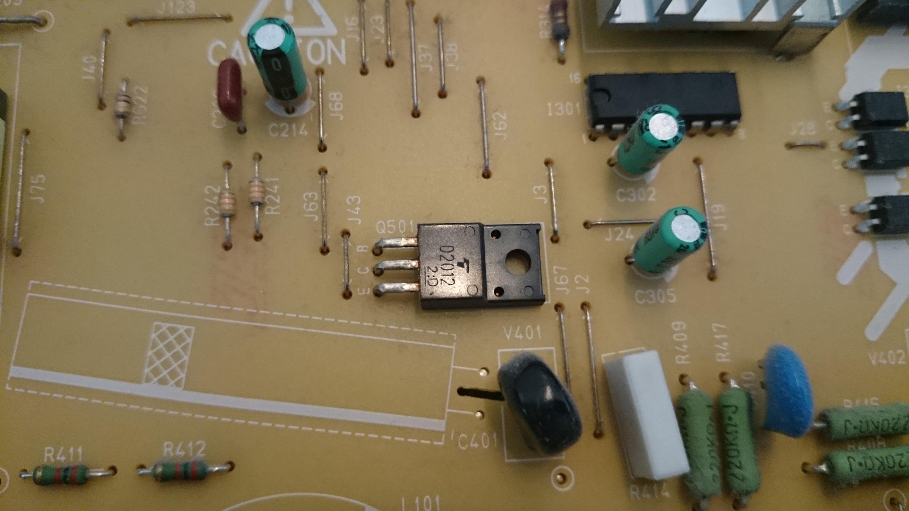

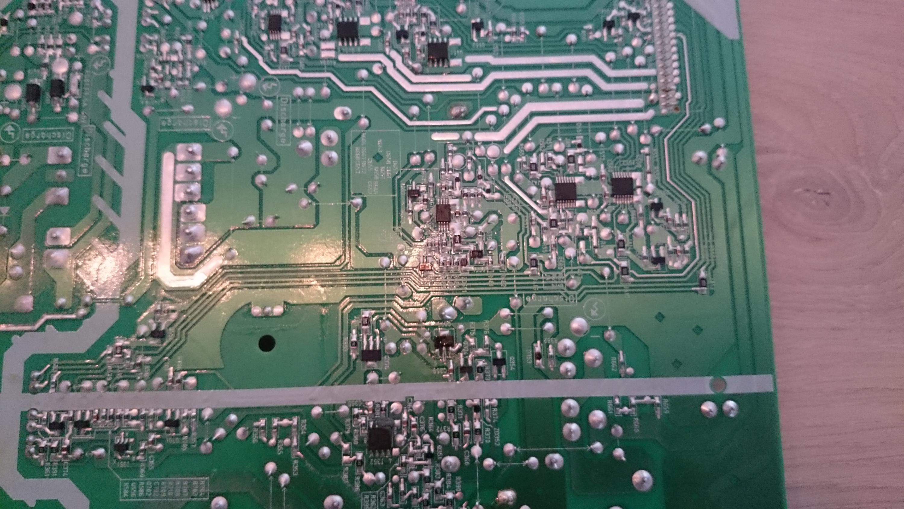

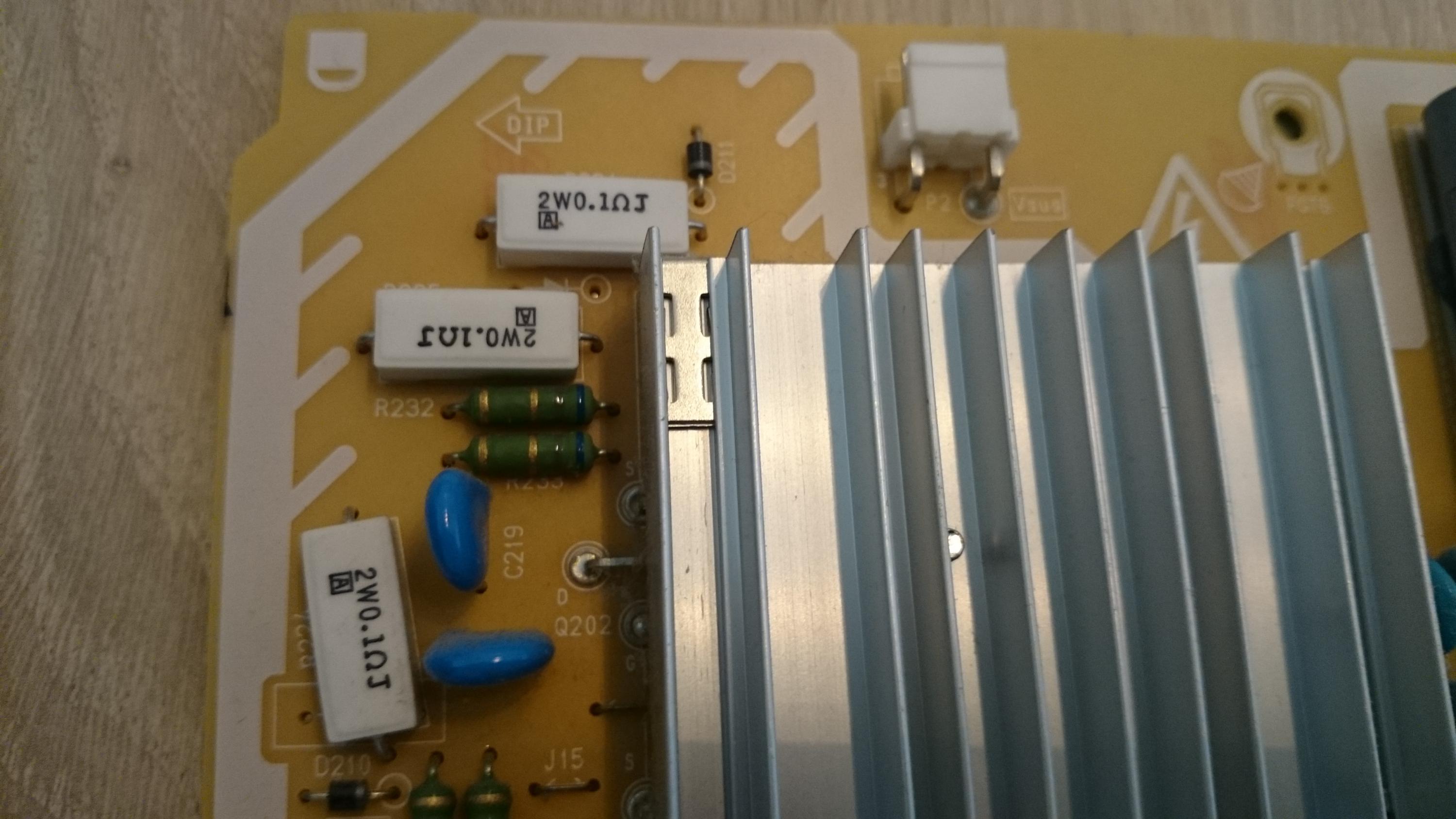

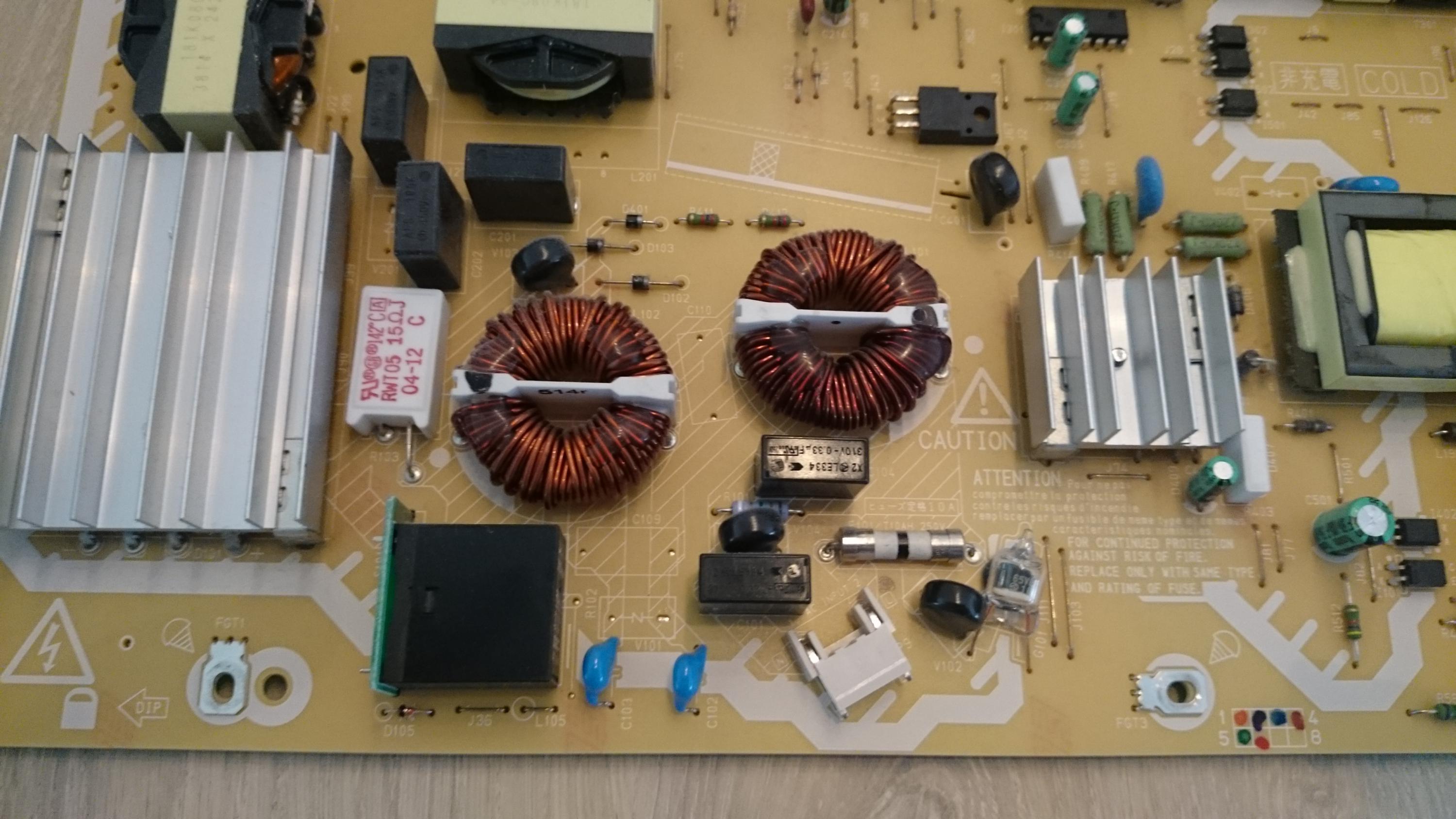

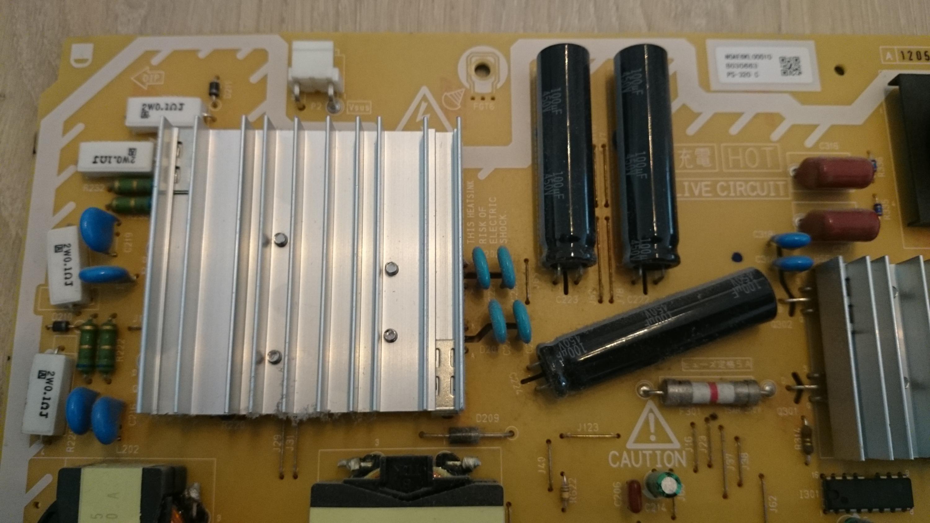

                              OK - get a CLEAR and DETAILED picture of the top (component side) and bottom (green/foil side) of the power board.
                              • Moreno83
                                • Jun 2014
                                • 2008
                                • The Netherlands
                                Here you go!

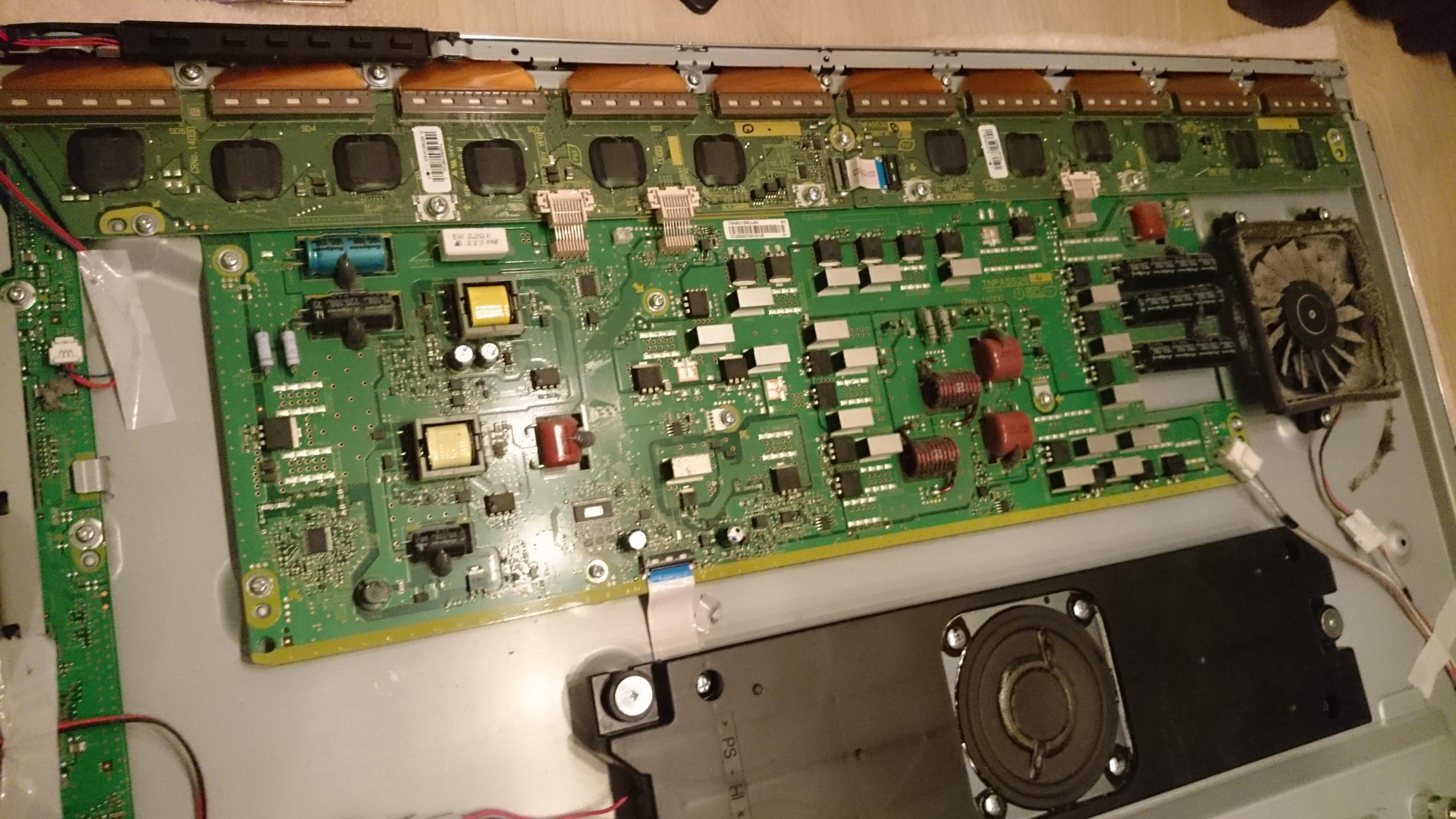

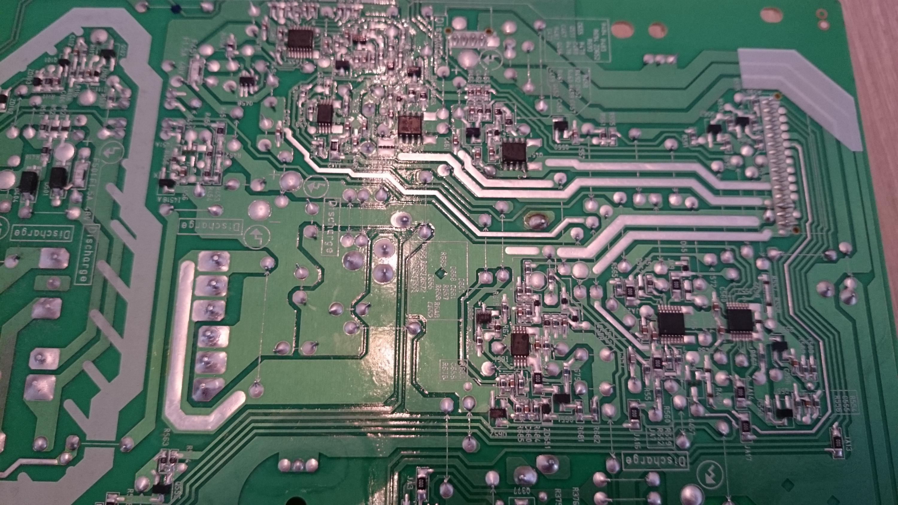

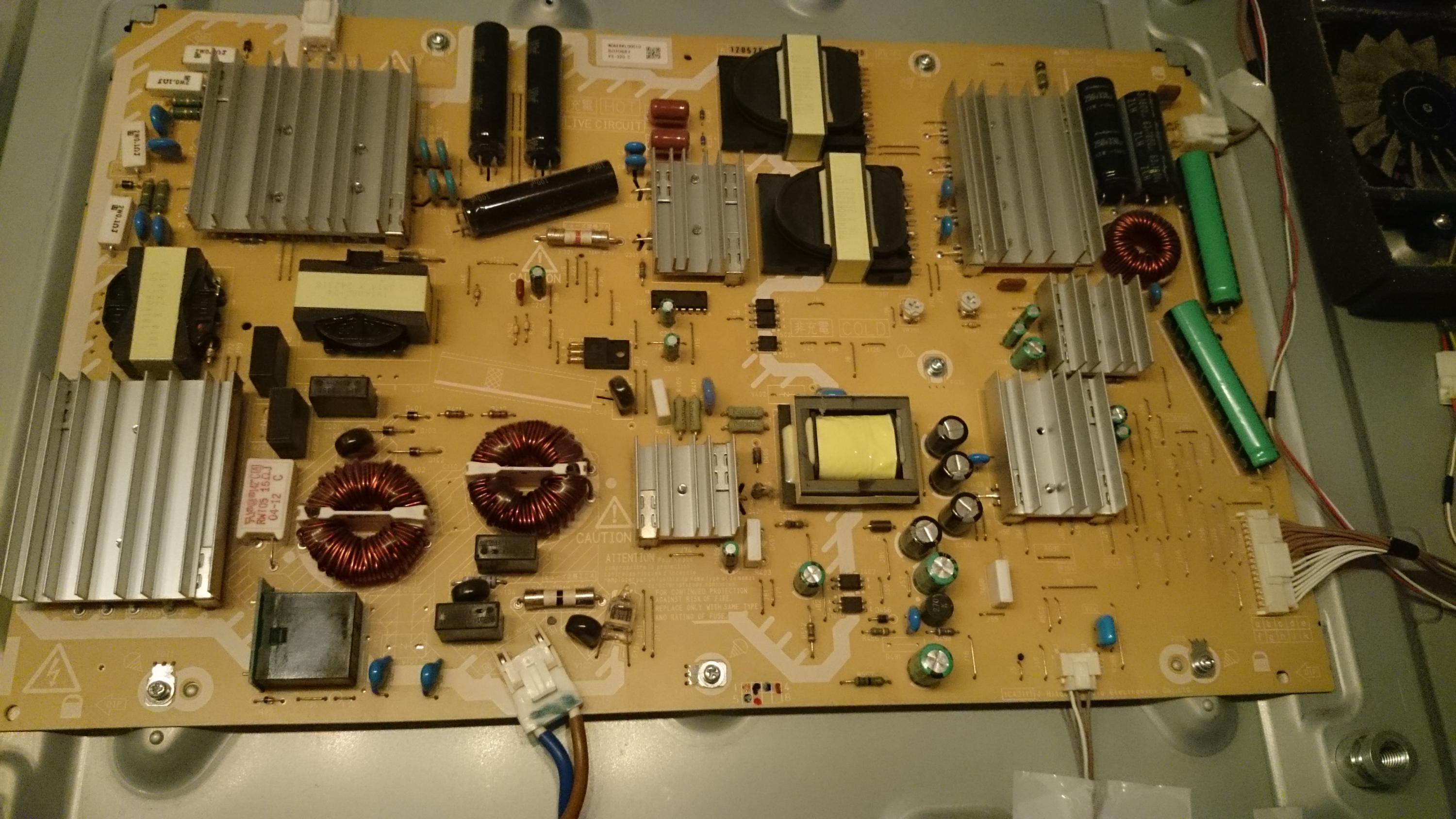

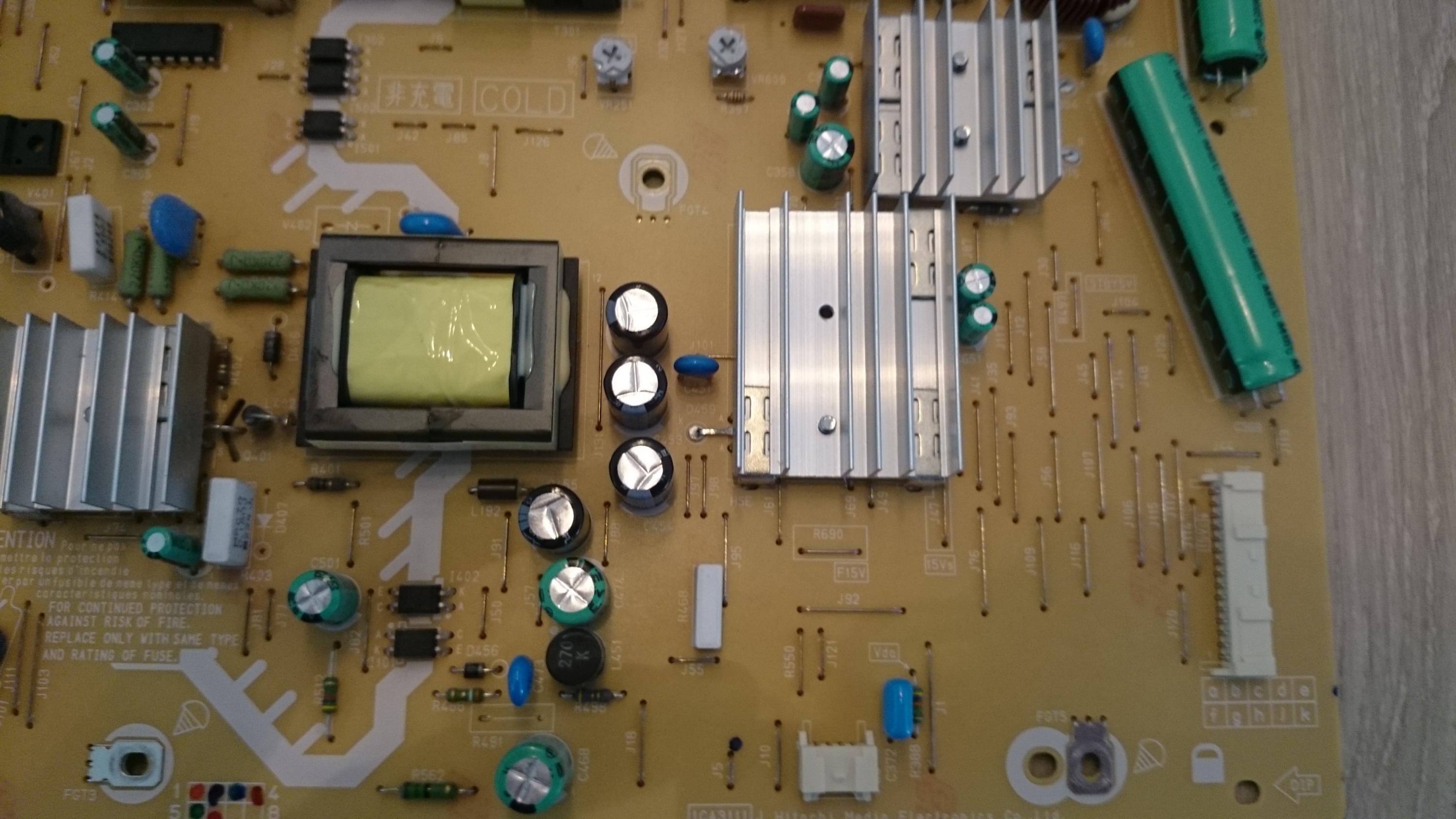

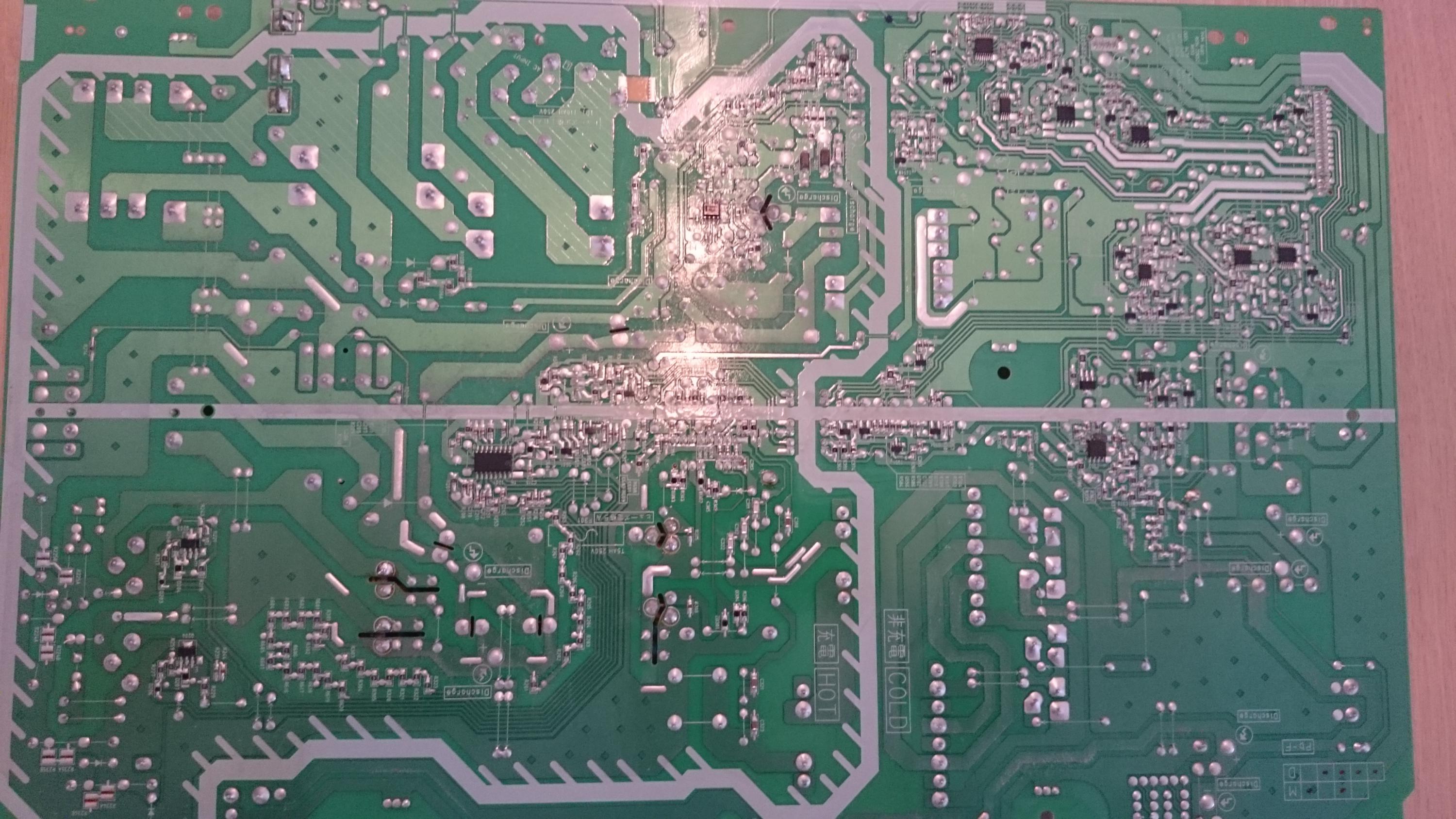

                                  A whole picture of the top and bottom would be useful
                                  • Moreno83
                                    • Jun 2014
                                    • 2008
                                    • The Netherlands
                                    Sorry , thought detailed picture. Hope this is ok.

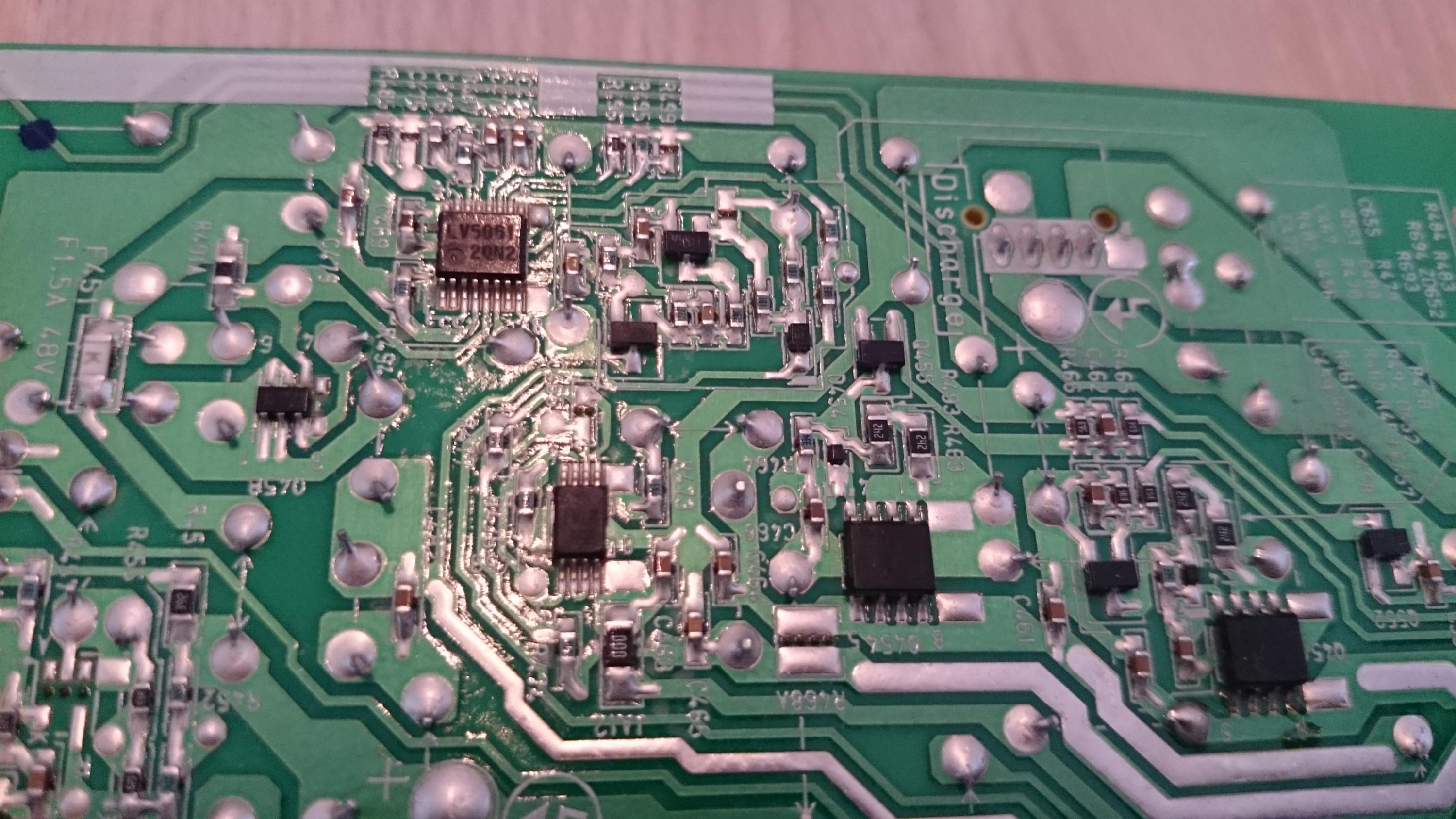

                                      Both types are useful. It's just necessary to get the bigger picture and understand the layout.

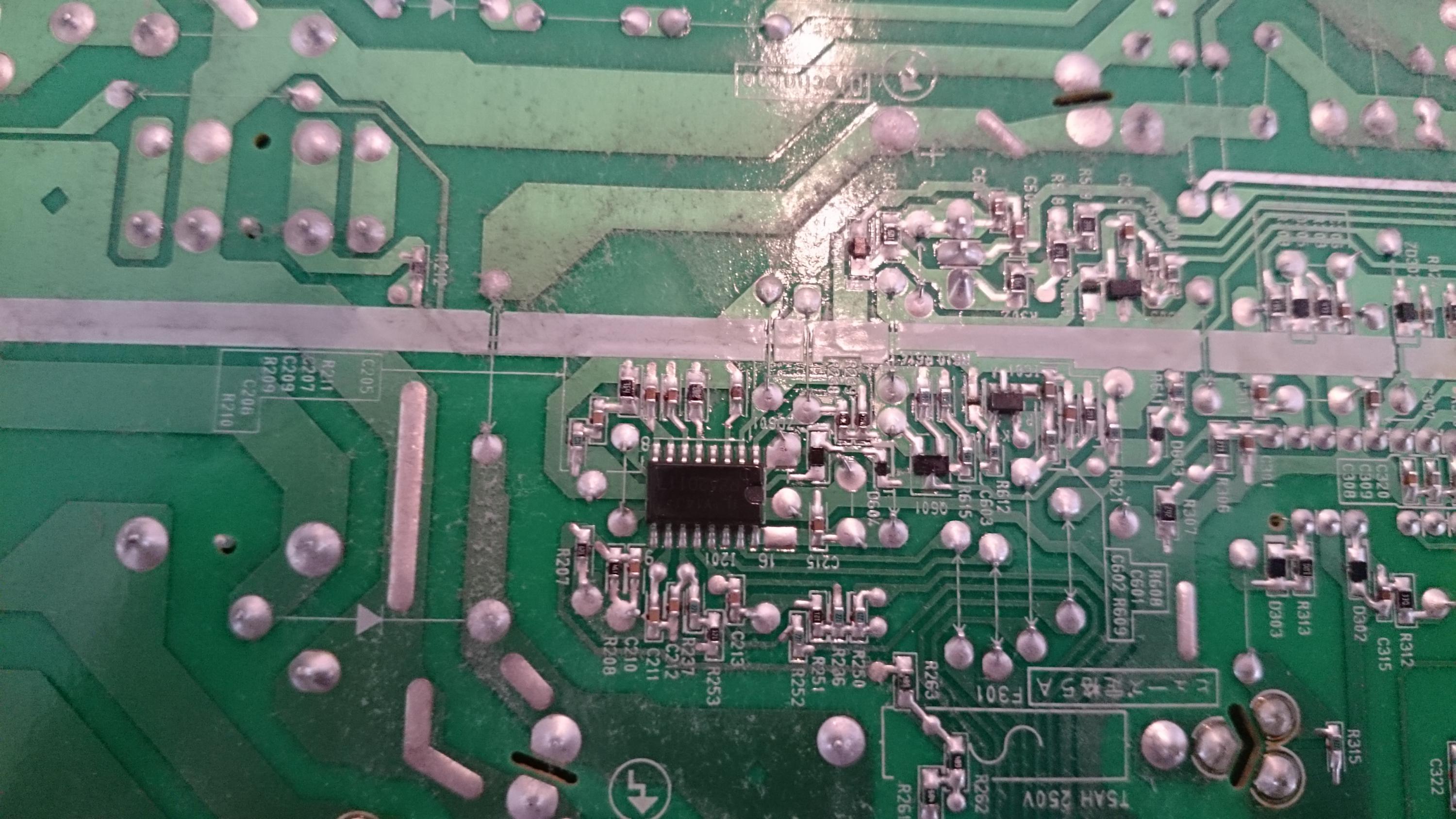

                                      I can't see the trace clearly enough so you will have to trace the 5V back and point out where it goes.

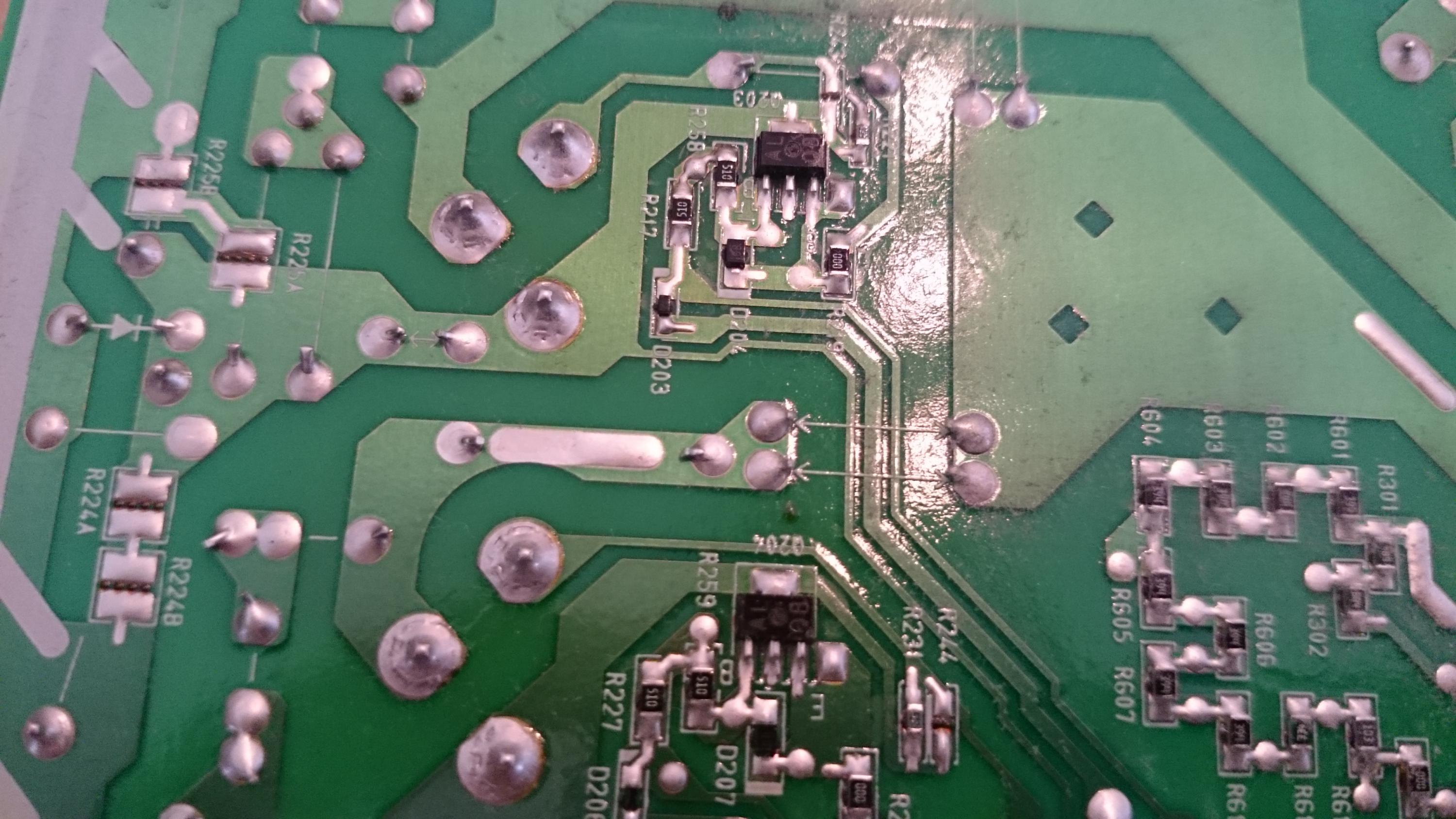

                                      • Moreno83
                                        • Jun 2014
                                        • 2008
                                        • The Netherlands

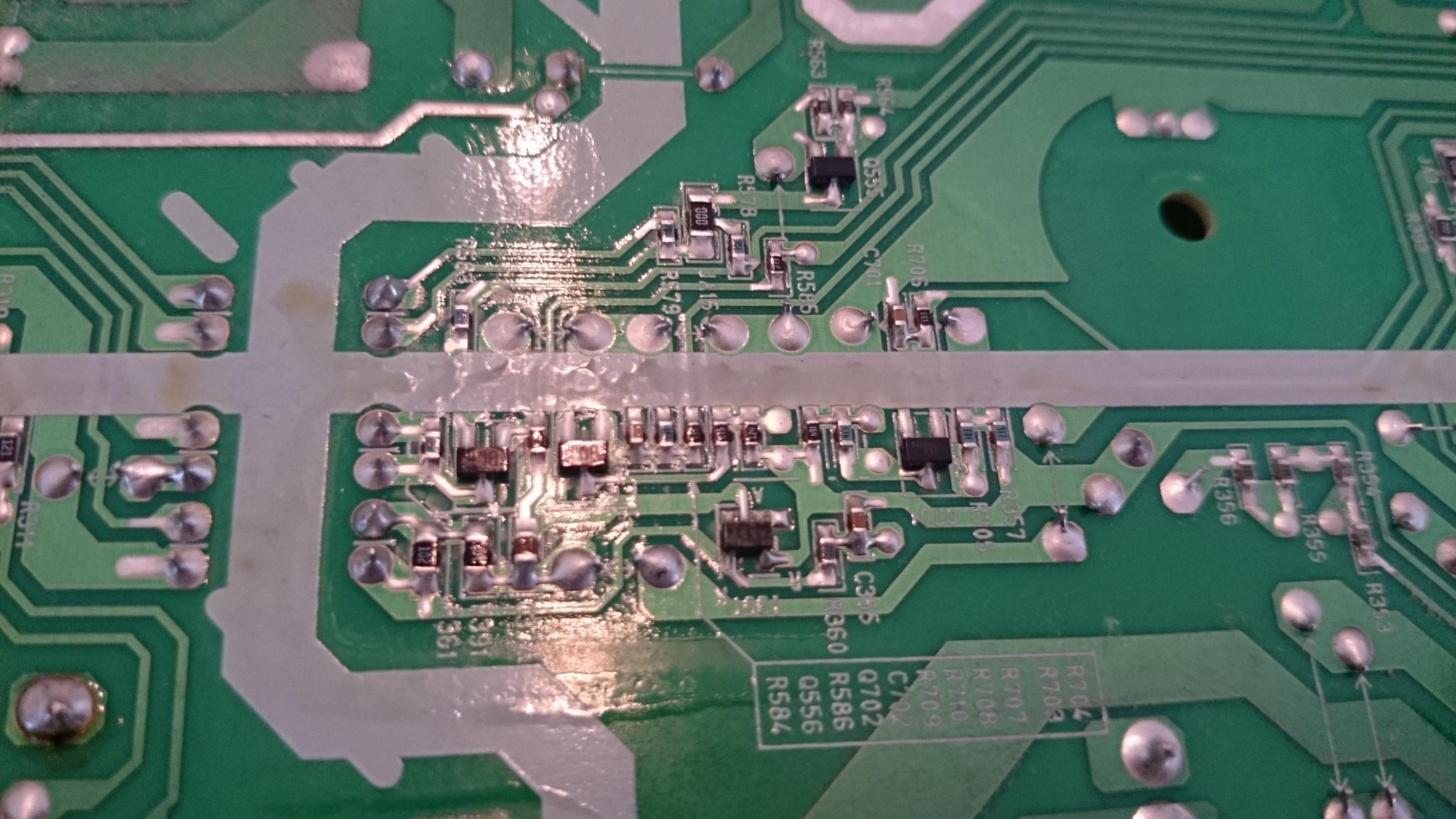

                                        I tried to take a better picture from the trace.
                                        Pin5 from P6 ( STBY5V ) trace goes to "JA17" and from there to "R489" to pin 6 from "I552" , this is the trace looking on the back of the power supply.
                                        Service manual says 230v goes into P9 --> rectifier --> P51/P52 --> Standby converter wich outputs 5v standby.
                                        As you can see I'm not good in reading schematics but I'm willing to learn! So forgive my ignorance.
