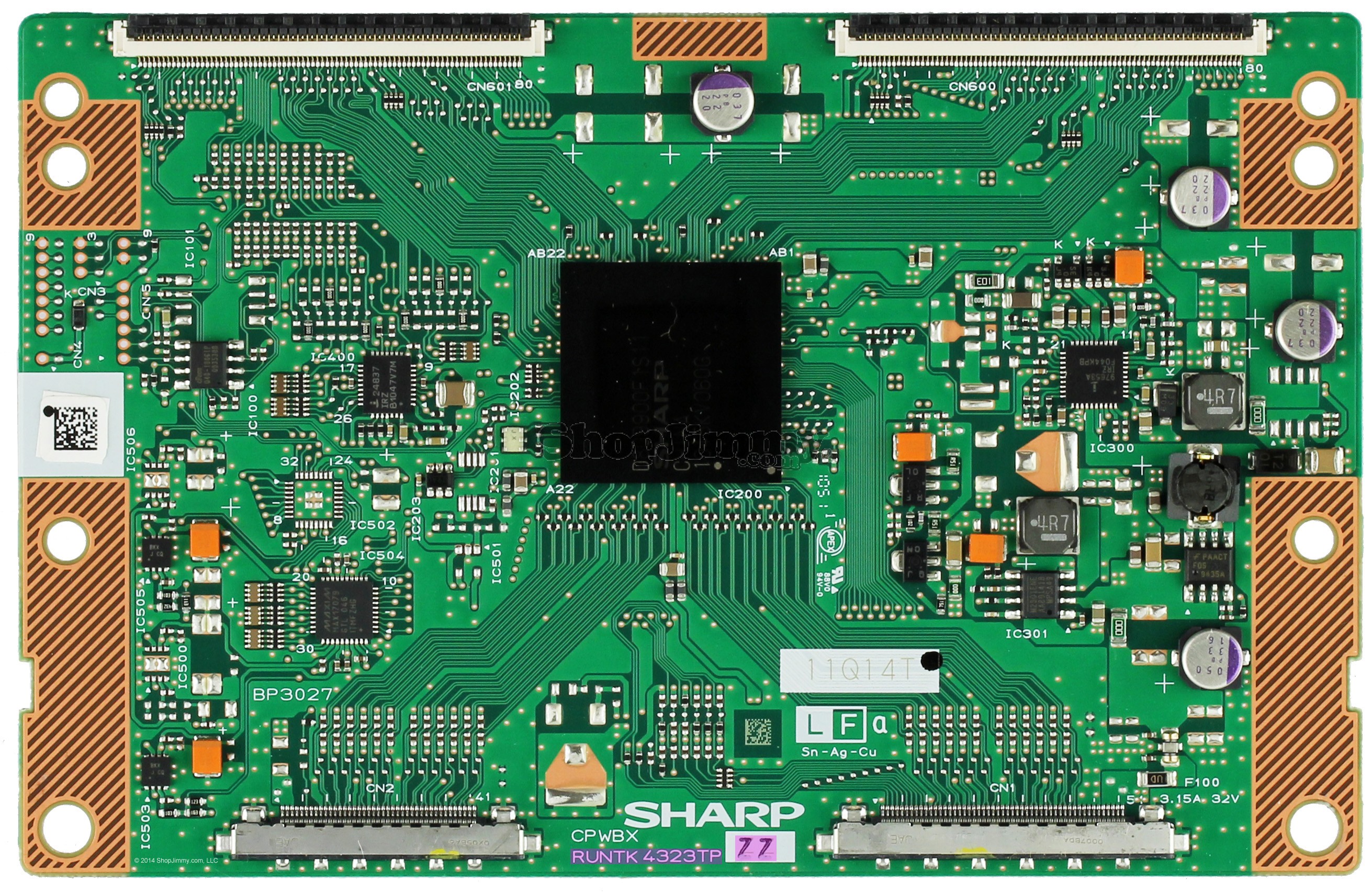

            Ok, I finally have the TV in hand. Pulled the back off. Found the T-CON PCB. Appears to be 6 total PCB's. Found the SMT fuse near the LVDS connector on the bottom of the TCON PCB. Measured 3.3V on both sides of the fuse. Also rang out fuse with my meter. I inspected the main PCB and T-CON CAPS and I see none which are bubbled/leaking etc. Should I pull the metal shields off the other two PCB's and inspect them as well? My mom said the screen is blue, but it's actually dimly lit black. I can see that all of the back lights are ON. Again, sound but no video and no menus show up either when the menu button is pressed.
            Should I still suspect the T-CON PCB? There's another PCB that is between the T-CON and the HDMI port PCB. It is BA01P2G0404 1_A and it's called an frc CBA PCB. I guess maybe it could also be the LCD? If there's any other diagnostic steps I can take before throwing parts at this I would appreciate the help.

              Re: Philips LCD TV - audio / no video
              3.3V for running T-CON is way too low, never run into one with that low of the Voltage. Are you sure it is not an error in measurement? You measure it using chassis as the GND ref and check the Voltage on each end of the fuse?
              Pictures of the board and the fuse?
                  That is not the fuse, that looks like some kind of the ferrite bead inductor, the fuse is right there inline with the fuse designator F100 printing, and one end of the fuse is connected to large copper pad that is connected to five pins of the LVDS connector, the large pad has 51 printing on it.
                  BTW, the resistance of the fuse and the ferrite bead inductor should have <1 Ohm.
                  If you do have 3.3V at the fuse, it is more likely there is problem on the main board that is not supplying the correct VDC to run the board.
                    Ok so one side has 12vdc and the other has 3vdc. One side is connected to that ferrite bead. 12v is on the LVDS connector side of the fuse.
                    Do you know the rating of this fuse or what a good rating would be to replace it with? Is this fuse slightly undersized from the factory or should I suspect a problem elsewhere in the TV has caused the fuse to blow? I have access to SMD fuses at work.
                      Are you talking about the correct fuse now, not the one you pointed to, right?
                      The rating of the fuse is printed right on the board next to the fuse, 3.15A 32V minimum Voltage rating. You can try using regular 3A fuse with leads on each end just for testing, 3A car fuse will do.
                            so I didn't have the correct SMD fuse, but I got a pico on there. Video came right up, menus work etc. So the problem was the fuse/T-CON PCB. want to order the right fuse tonight. Now should I consider replacing any other components? Should I move the fuse up slightly in amperage?
                              So was the old fuse tested as open circuit or it shows some resistance > 1 Ohm? I would stay to the same rating, it can be just bad fuse that failed due to surge current when power is applied. If you look at the spec of the LCD panel it will give you the surge current and the running current of the T-CON.
