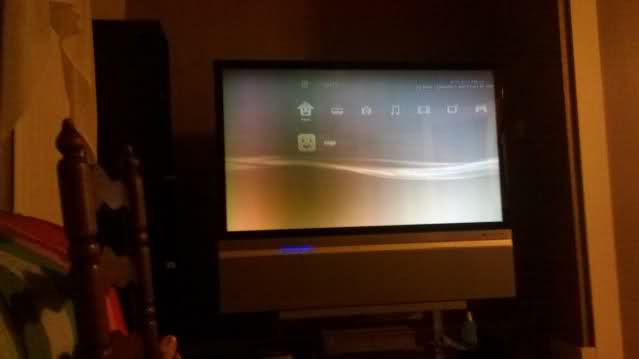

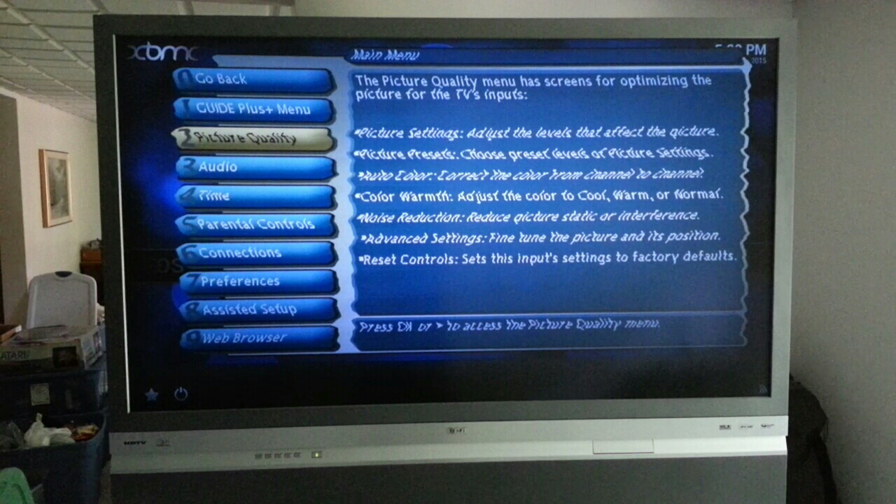

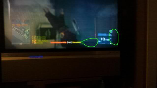

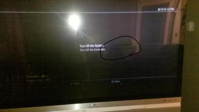

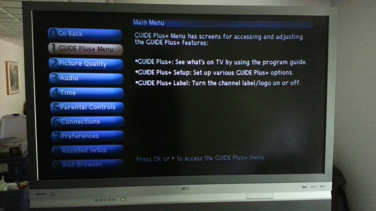

    I've been working on this early RCA DLP television (circa 2003) and trying to bring it back to operational spec. It was sitting in a garage for a while and upon initial examination, the lamp was apparently broken. Upon replacing the lamp, the set fired right up! Everything seemed fine at first, but closer examination revealed some ghosting and minor distortion (green and pinkish, mostly on the left side) in the picture (although it does show up in the menus too), as shown here:
    With no video source hooked up, the menus look okay aside from the ghosting (which is present, but hardly visible in this picture):

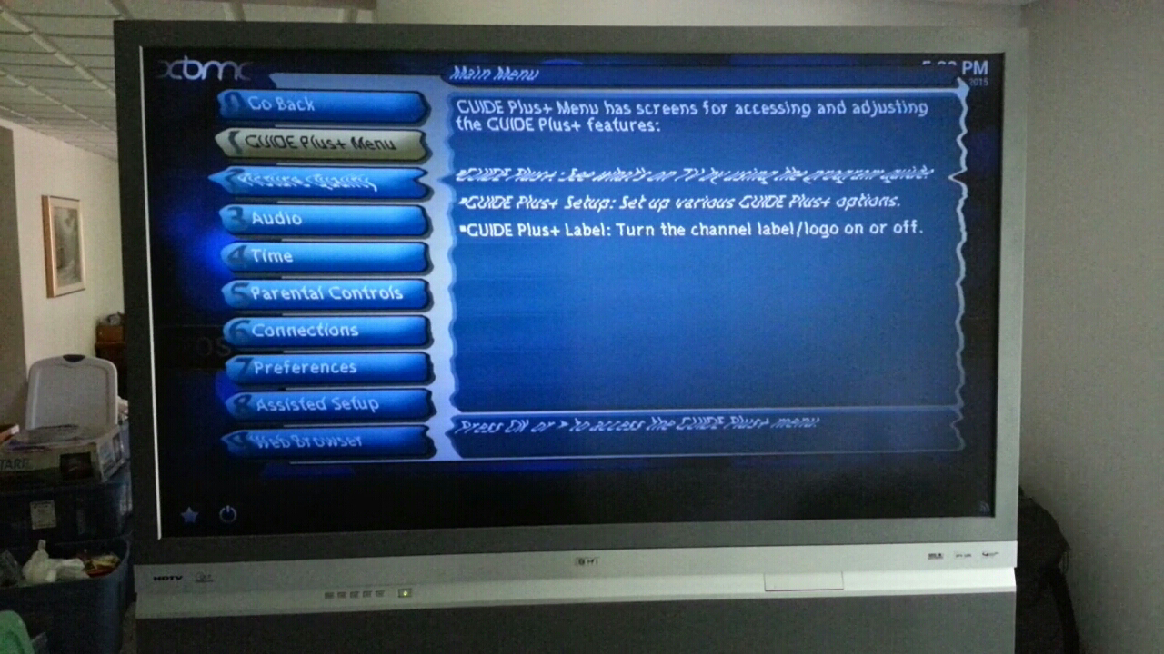

    When you add a video source however, things get really weird! The menu becomes distorted and the distortions be changed by navigating the menu or displaying moving pictures through the video input.
    Now, on to the troubleshooting. To begin with, I entered the service menu and displayed the test patterns, which according to the service guide are generated by the light engine itself, and as such did not exhibit any ghosting or distortions at all, narrowing down the suspects to one of the four boards in the chassis side of the set (the power supply, DM2CR digital module, input board, audio board (not pictured), or formatter board (also not pictured)) -
    (see the attachments section for full resolution pictures)

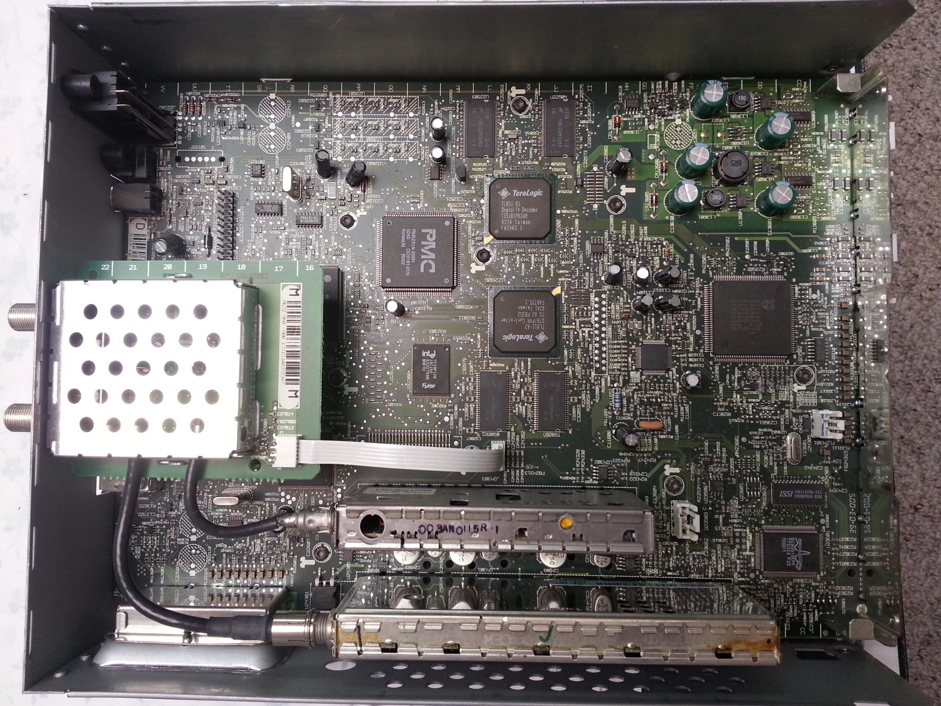

    A visual inspection revealed no puffed up capacitors or obviously damaged components. Any ideas as to where to look next?
    TL;DR? Distorted menus, minor PQ problems, and ghosting as pictured above, light engine not the culprit, no puffed capacitors in any of the usual places. What should I check next?

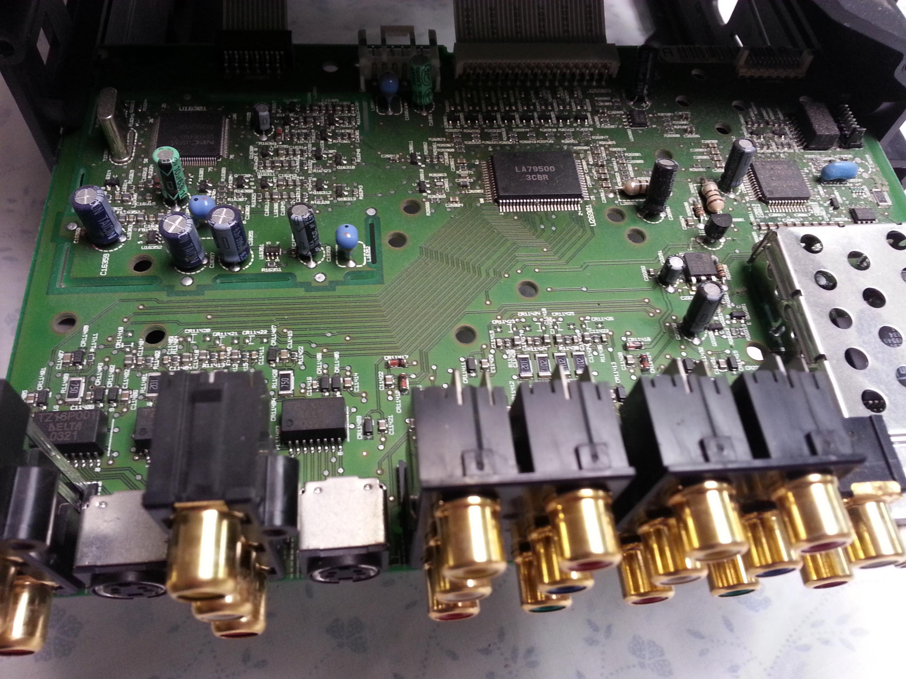

    I would say by looking at the picture there are a couple bad caps, most likely one of the small ones in the video circuit. They won't show as bulged or even leak they just dry up and don't do their job. A scope would track it down quickly, or cap checker/esr meter would help. When a video signal is applied it is upsetting a circuit somewhere, most likely a low value decoupling cap somwhere.

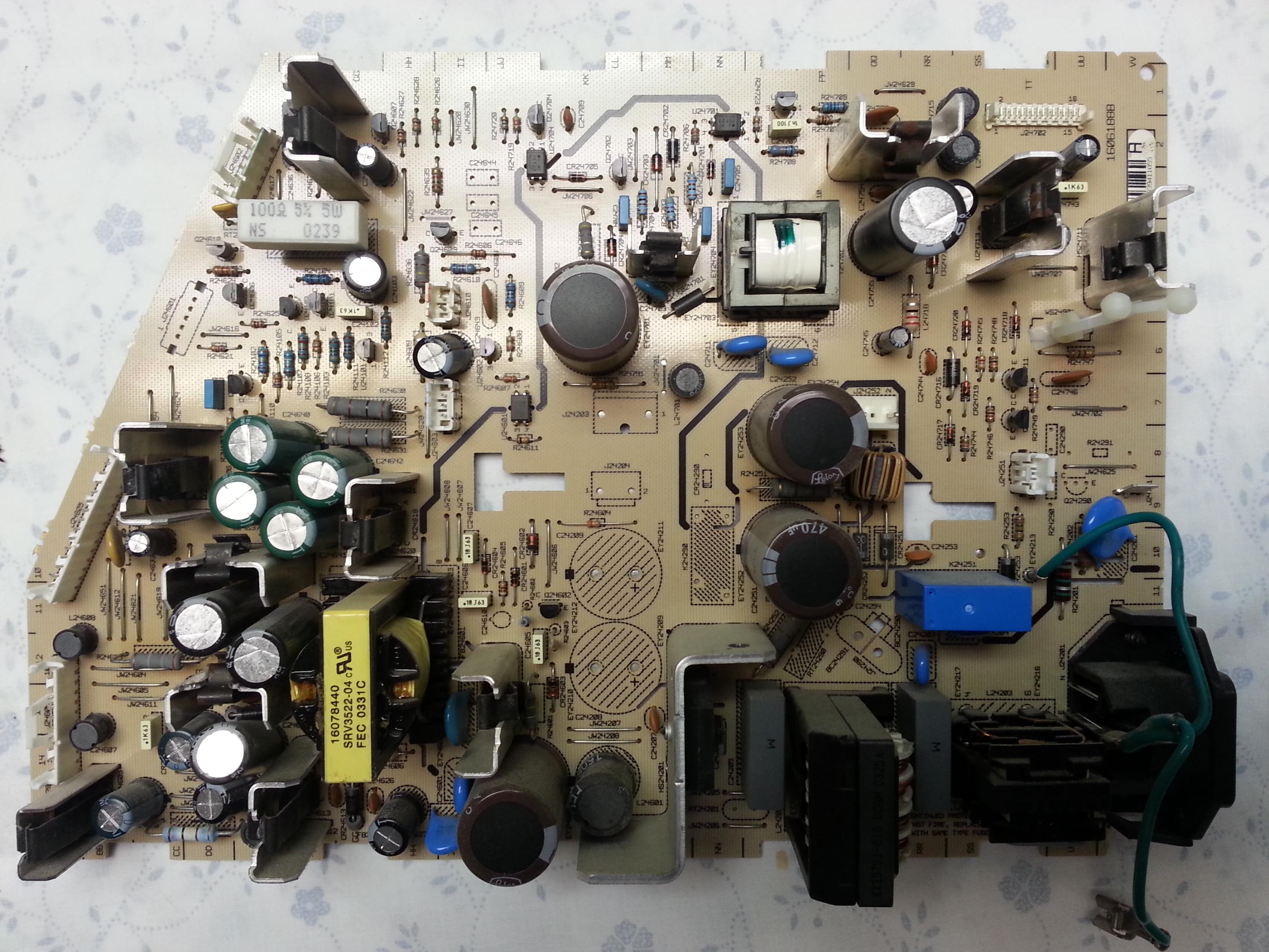

    or it could be a bad cap in the low voltage supply around u1360h u13609 etc.

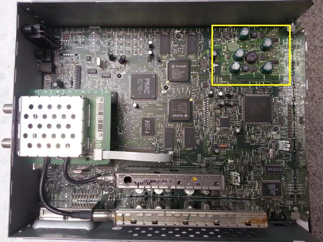

      I see. Now when you talk about the low voltage supply and u1360h and u13609, are you referring to those four green capacitors in the DM2CR module shown in the second to last picture? I ask because I'm having a bit of a tough time reading some of the labels in the picture .
      When you talk about the small caps in the video circuit, are you talking about the small green ones toward the back of the input board or the blue ones (or both)?

        I was refering to these outlined in yellow, or maybe one of the small caps on the last picture could be causing it.
        These are just guess's but I have seen the fault before on other tv's and its usually a bad cap.

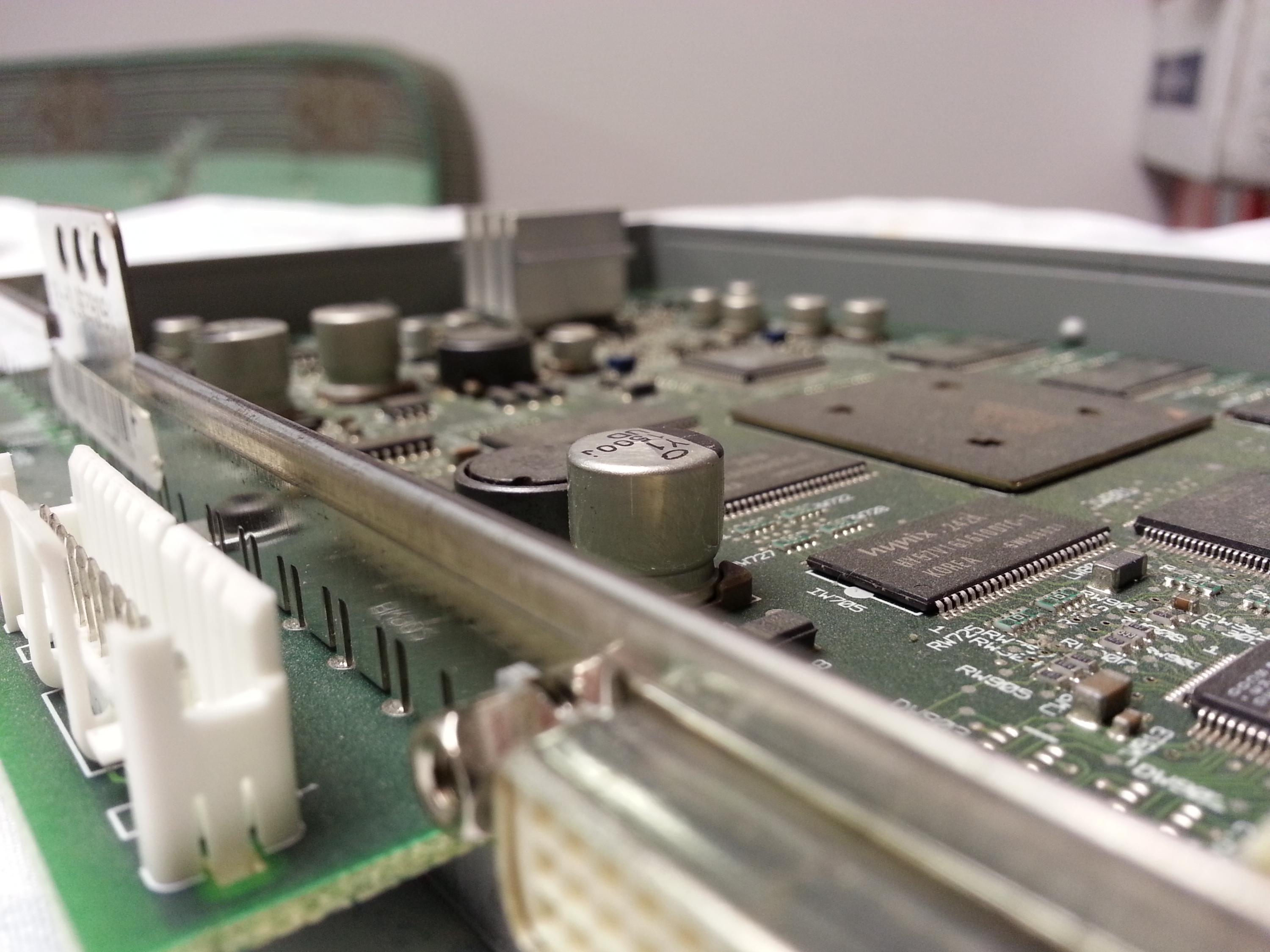

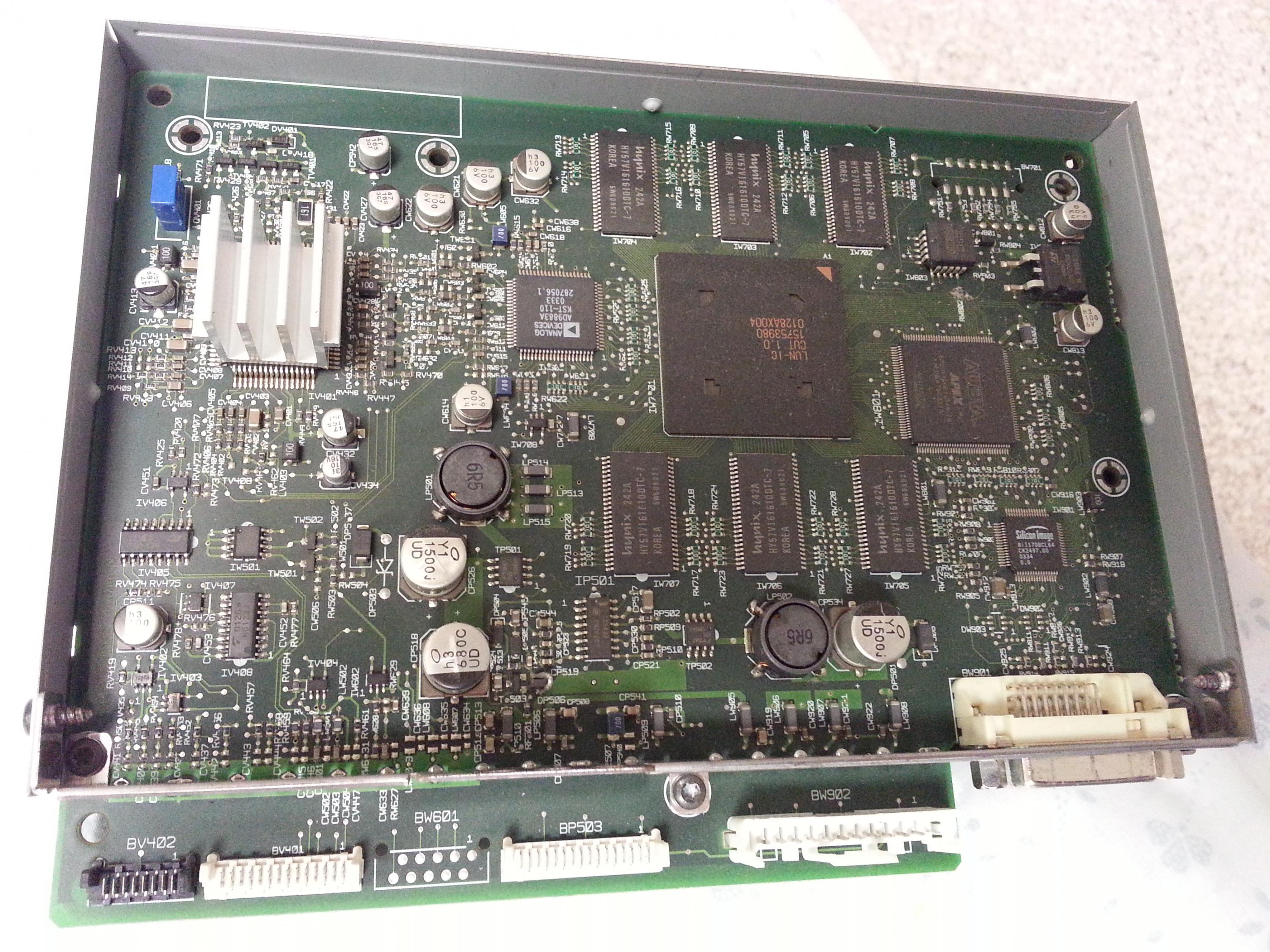

          Format

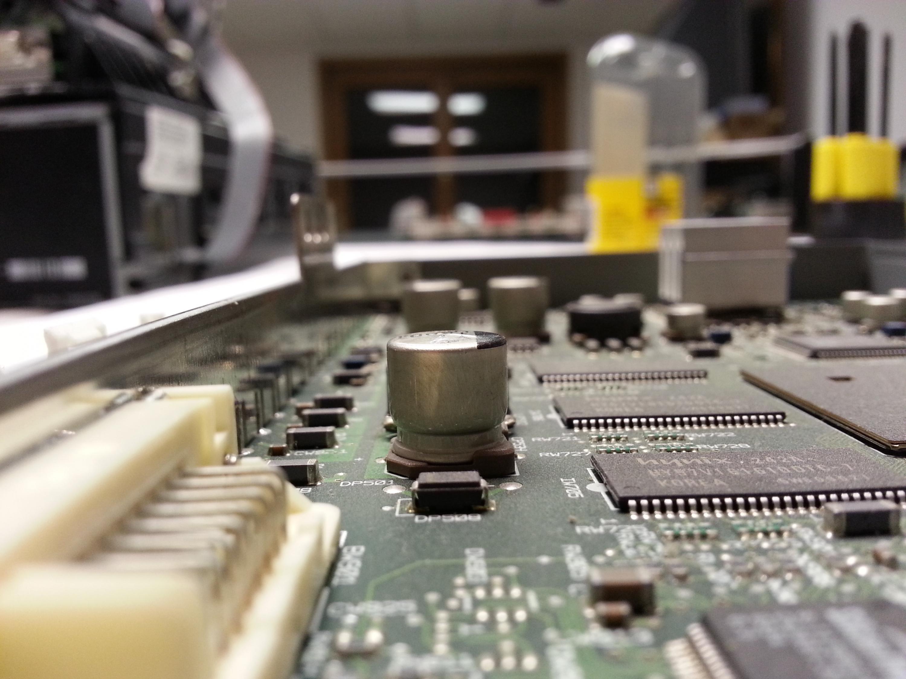

          I finally got a look at the previously unseen formatter board and there isn't too much going on with it. The three larger surface mount capacitors on there did catch my eye though. Do those look like they might be cause for concern (bulged) or is that normal for those?

            must be something else
            (TL;DWR? skip to the bottom of the post)

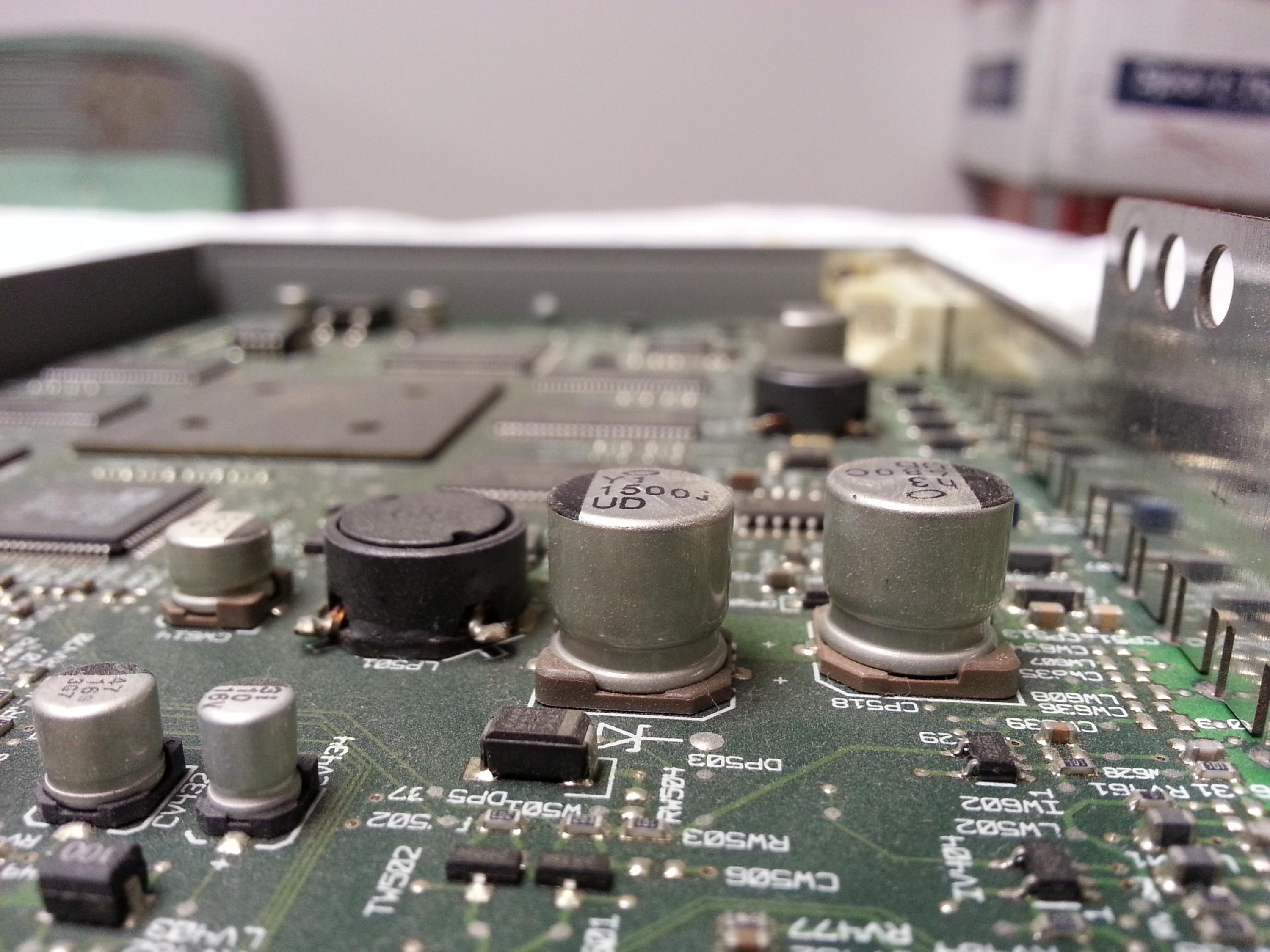

            I ended up replacing the most probable suspects (the four 680μF capacitors) on the DM2CR digital module, and while it didn't end up solving the problem, I didn't make it any worse, and I learned a few tricks for removing old, crusty, "un-meltable" solder with the help of a heat gun.
            From here, I've taken a closer look at the service guide and discovered contrary to what I posted earlier that most of the test patterns are actually generated by the formatter board and only one is generated by the light engine, meaning I can pretty much rule out the formatter as a possible cause of the problem after all.
            Back to the repair action: According to the service guide, "Any 2H component (YPrPb) that is input to the A/V In/Out CBA is routed directly to the formatter.". This tells me that if the DM2CR is the cause of the problem, said problem should vanish when displaying 2H (480p) content and be present for everything else, but this is not the case, as the ghosting and color distortion is present at all resolutions. If this is true, I can only assume that the DM2CR is fine and that the input board was at fault all along. This makes sense until we consider the distorted menus, which if generated by a functional DM2CR and sent straight to the formatter, wouldn't be distorted, unless of course they take a stop at the defective video input board first. Could there possibly be a power supply issue?
            TL;DR? Capacitor replacement on DM2CR successful, but no change. Found possibly helpful information in the service guide, but still unsure. I'll move on to capacitors on the video input board unless someone thinks it could possibly be a power supply issue.

              progress
              After further testing, deliberation, and perusal of the service guide, I am officially taking back what I said before about the formatter board being fine. As a matter of fact, I now believe it may be suspect. If video from the input board that bypasses the DM2CR digital module exhibits artifacts as well as video straight from the DM2CR that bypasses the input module, a common problem on the formatter would seem more likely than a compound problem on both the input board as well as the DM2CR.
              I will further examine the formatter for repair or replacement.

                Re: Ghosting and wavy menus on RCA DLP Projection TV (HD61LPW42)
                I bet they are bad. I've repaired these modules before. You will know when you go to unsolder them, you usually get a very fishy smell.
                You can use regular radial lead caps to replace them if you don't have the same surface mount ones.
                and use care when removing them so you don't take a trace with them, a lot of times when they leak the solder pad also becomes loose from the board.

                • SurrealMustard

                  The capacitors on the formatter? It makes sense and I've already got some 16 volt 680μF tankers leftover from my attempted repair of the DM2CR, so all I'd need are a couple 6.3volt 1500μF ones (according to the informational sheet for those surface mount capacitors, the number in the middle represents the capacitance and the letter represents the voltage - "j" is 6.3 and "c" is 16). I'll look into getting some of those and report back.
