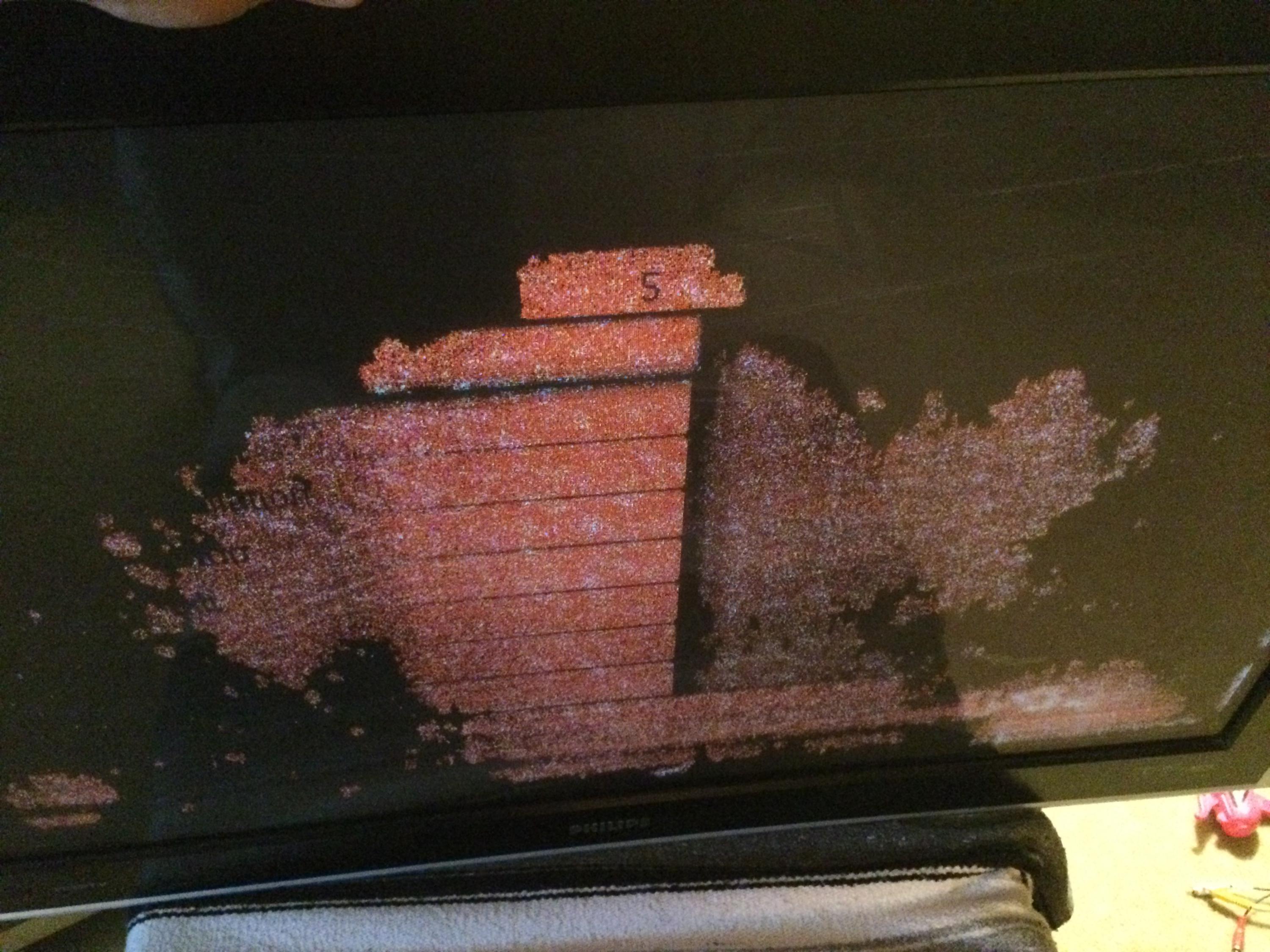

I changed out the filter caps that were suggested in another post (set was completely dead). Changed them and the set came alive. Well sort of. I have attached an image.
Is this a sign of a bad philips plasma panel?
Re: Is this a sign of a bad philips plasma panel?
Definitely Z-sustain to me.Please do not PM me with questions! Questions via PM will not be answered. Post on the forums instead!

Sorry guys. Was kinda in a hurry when i posted. Model number is 42pf9630a/37. Ill look around for a z sustain. Thanks for the help.Doing this on the side to make some extra money for my daughters dance competition.Comment
