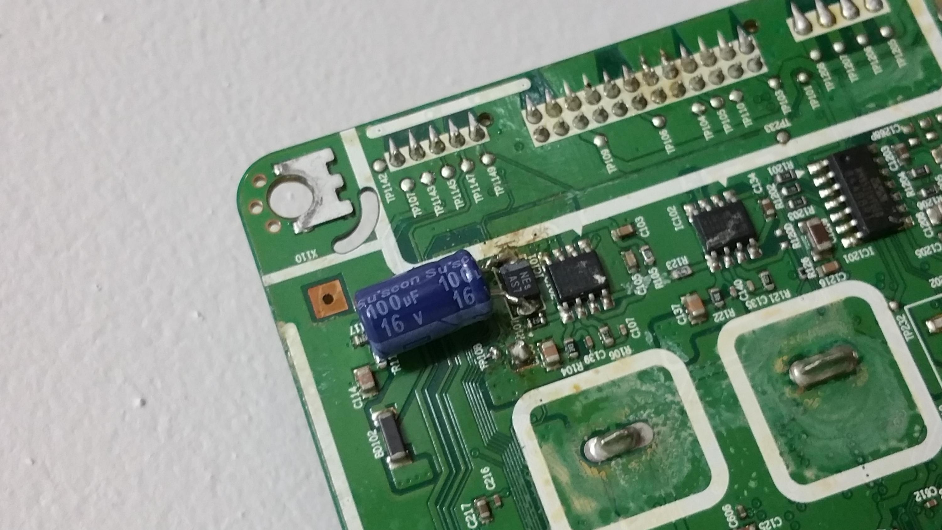

      Where do I scrape off and solder in the new capacitor?

        So do I just hook the negative side of the cap to the negative of c131 and then the positive to the positive?
          Re: Samsung LN46A550 Power Cycling
          Yes, isn't that what you did to C102? the band of the Tantalum cap is POSITIVE.

            I scraped off some green stuff down to the copper on either side of c102 and soldered it to that haha

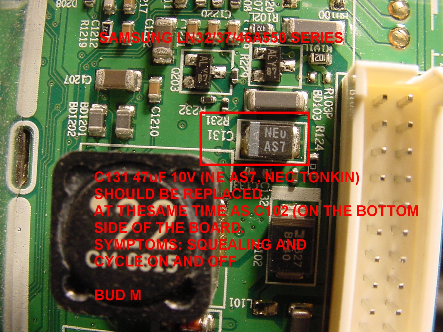

              The c131 will be tougher due to not much pads for soldering.

                The electrolyte in C131 is probably crystalline and when it is heated it turns liquid again and the capacitor start to work.

                  So can I just take the surface mount one off and put a 47uf 10v or 16v on there?

                    Replaced both of them and still no dice... replaced with can 47uf caps... still turns on when I put hair dryer in the area...

                          PS, I did not screw up the board by removing the tantalum SMD caps. I just took them off with my solder gun, very carefully, and replaced them with 47UF 25V Can shaped capacitors from various boards I have laying around.

                            Cap replacement is most reliable with 47@16v TANTALUM type !
                            Jumping,paralleling or bridging the bad cap adds capacitance but
                            still allows the AS7 on the board to cause a problem. So,the best
                            repair is to replace both.

                              The Su'scon you tried could well be bad with high ESR, or just be too high ESR for this application. Heating the area would drop the ESR which might be why it fixes the problem again - you may have replaced one heat-sensitive capacitor with another!
                              Try a brand new, low ESR, good brand capacitor instead of a used and possibly defective Su'scon.
