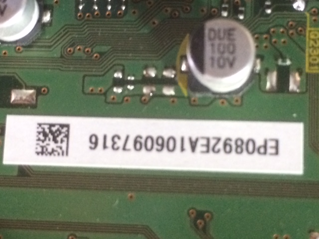

    On the large FLASH IC there should be a small white sticker with the software loaded. What is it? will be 3 numbers and 2 letters i suspect
      Re: Panansonic TH-P54V20A, 13-blink SOS

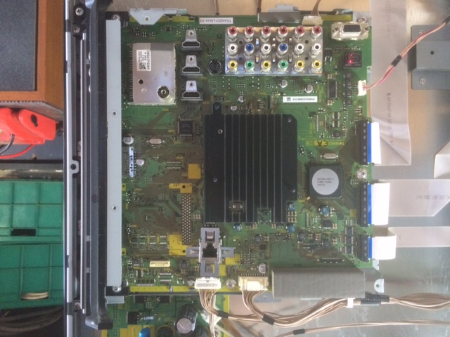

      Oh, when you put pictures up, edit them / rotate and save , then post up. I'm not going to stand on my head to read upside down(jokes)
        Ok, I just realised I made a wrong assumption, and a little surpised but looks like the 54 A board is TNPH0892, 50" is TNPH0845 but I'm looking at yours and it looks the same so not sure what differences there are
          That flash could have TVRR xxx, 48 pin on underside

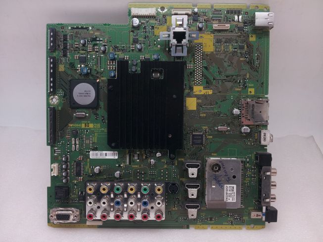

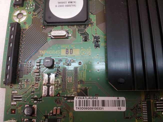

              I've been asking/looking around for an A-board for my SOS-13 TH-P54V20A.
              Question:- From a TH-P60ST50A, will its TNPH0989 A-board be a workable substitute for TNHP0982?
              Roj.

                no, but with those broken Tvs sometimes it's worth asking if they'll strip the TV down , box the parts and ship. I've been lucky a couple of times doing this for the 50V20 models. postage if you can convince them to use 2 x 5kg satchels and pack them well that's the cheapest way. But there appears to be nothing around at the moment

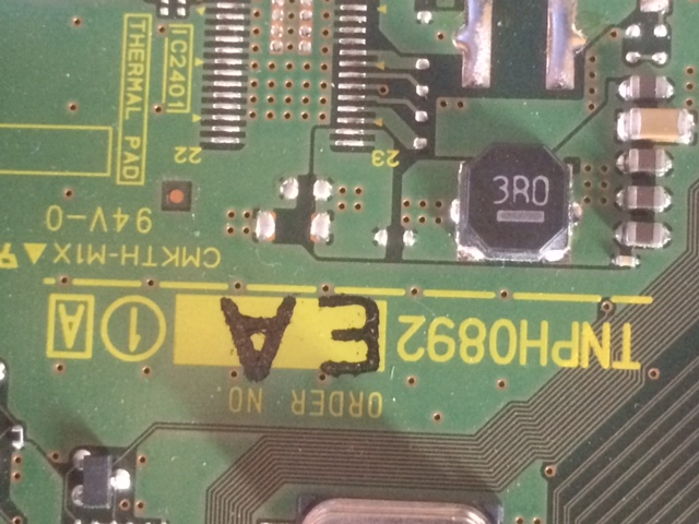

                        The closest so far to A-Board for TH-P54V20A (THNP0892AE, EP0892EA106097316) is for TH-P46V20Z (TNHP0845BD, TXN/A1LAUD42, TK0D08G09100331)
                        What hope exists to convert this A-Board ?
                        Roj.

                          maybe, that was my thought in the start but without schematics not sure. In the US they use the same board excepting revisions for all sizes up to 54" so it may turmn out ok. why don't you trace the outline of the board and also mark the bolt locations and post it to me and I can at least compare that to the 0845 boards i have. full shot of your board top and bottom may be handy to see if there is anything obvious different. Still would like to know what label is on IC8921 TVRRxxx? If that is the same across the range including NZ that will make the task easier.
                          Do you have an EEPROM reader/programmer?
