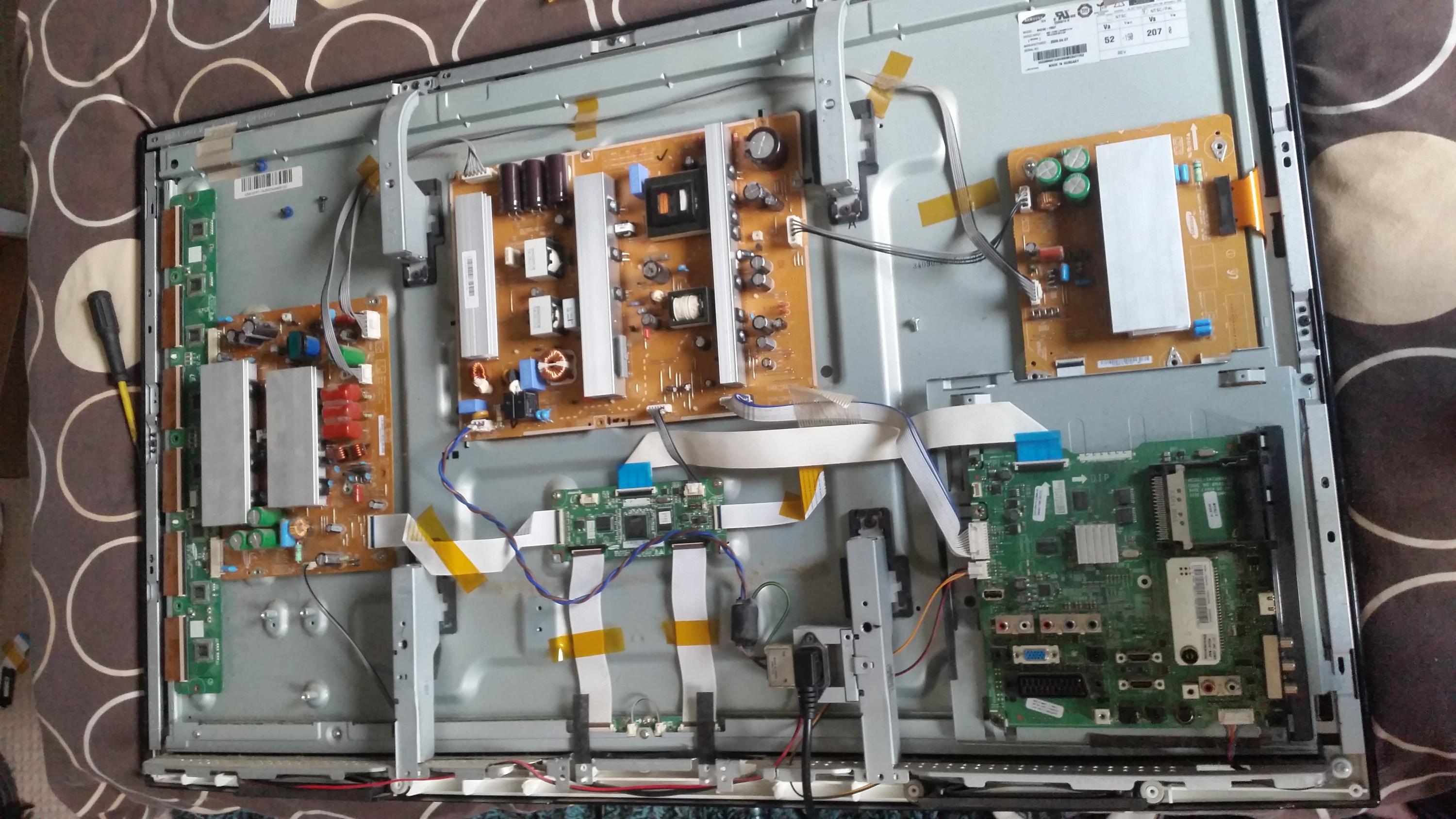

Samsung ps42b451
  • adamp91gvm
    • Jan 2014
    • 706
    • uk
    Samsung ps42b451
    It will not turn on just clicks over and over but when the t con is disconnected it makes the power up sound
  • adamp91gvm
    • Jan 2014
    • 706
    • uk
    Re: Samsung ps42b451
    When t con is disconnected the vs and va are correct
    • munja
      • Apr 2015
      • 5
      • Serbia
      which have voltages on control board?
      • adamp91gvm
        • Jan 2014
        • 706
        • uk
        I have tried it with another control board and still the same
        • adamp91gvm
          • Jan 2014
          • 706
          • uk
          Anyone had the same issue with this tv
          • sordids999
            • May 2013
            • 2161
            • uk
            not sure if this helps but have you tested the x-main for shorts plus the Y-sus/buffer board ?
            i recently fixed the ps42c450 im wondering if its the same where a faulty x-main can take out the ybuffer and y-main as well
