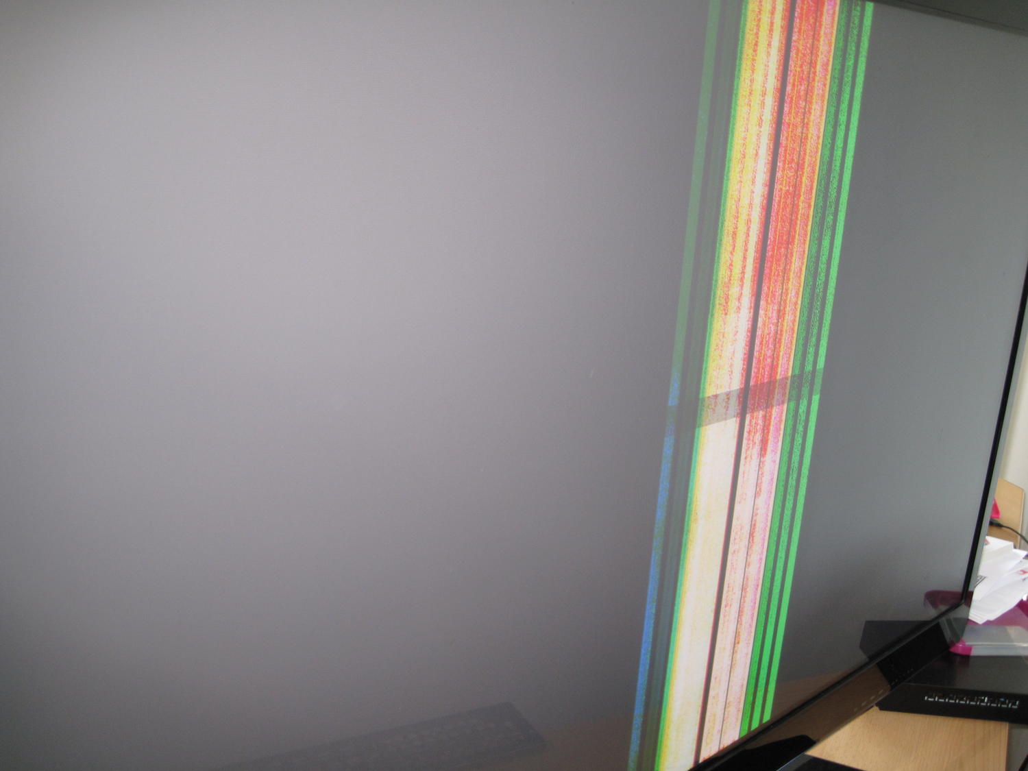

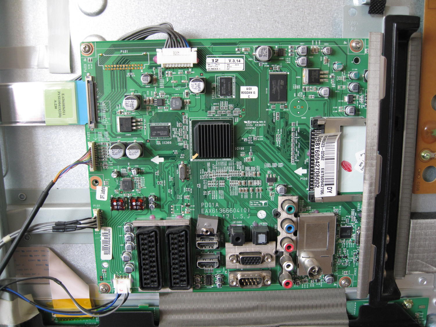

    a friend of mine brought me his LG tv which has no picture anymore.
    In his words, the tv went from working to blank without any prior signs of error.
    When powered up, there is no glow on the pannel, but the remote and sound are working.

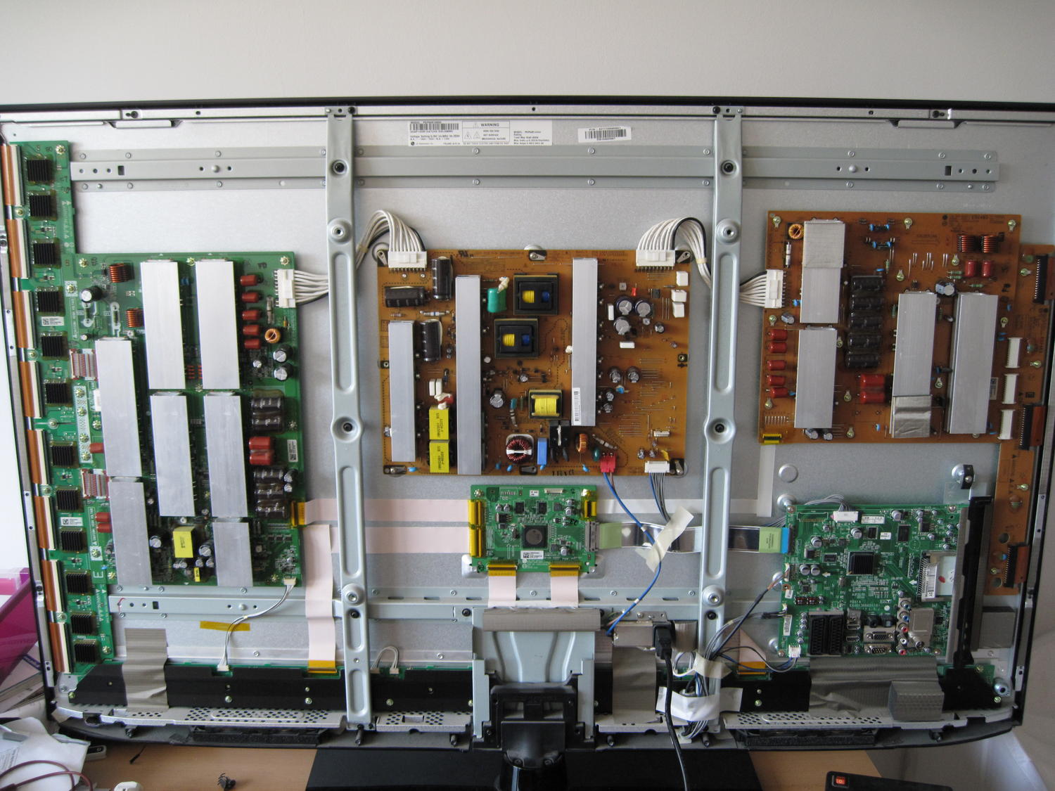

    So i opened it up and started to follow the guides i found here.

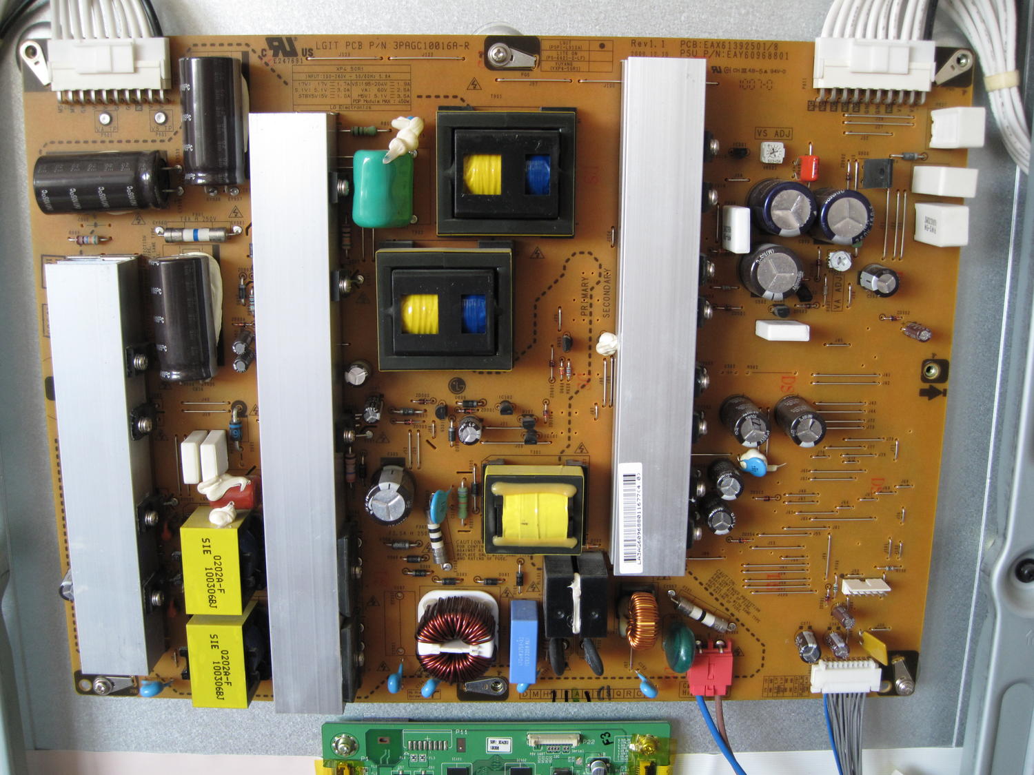

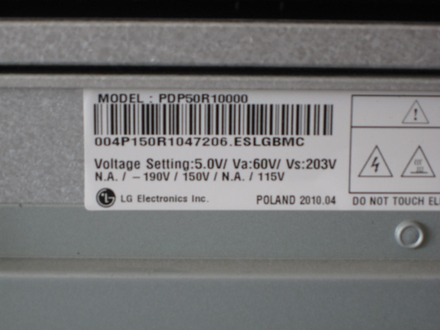

    The fuses seem ok, and the resistors at the top right corner of the PSU are all at 10 Ohms.
    Voltages are:
    Vs on P812: 203,1 volts
    Vs on P811: 202,9 volts
    Va on P812: 60,1 volts
    Va on P811: not connected
    5 Volts on P812: 5,04 volts
    5 Volts on P811: 5,09 volts

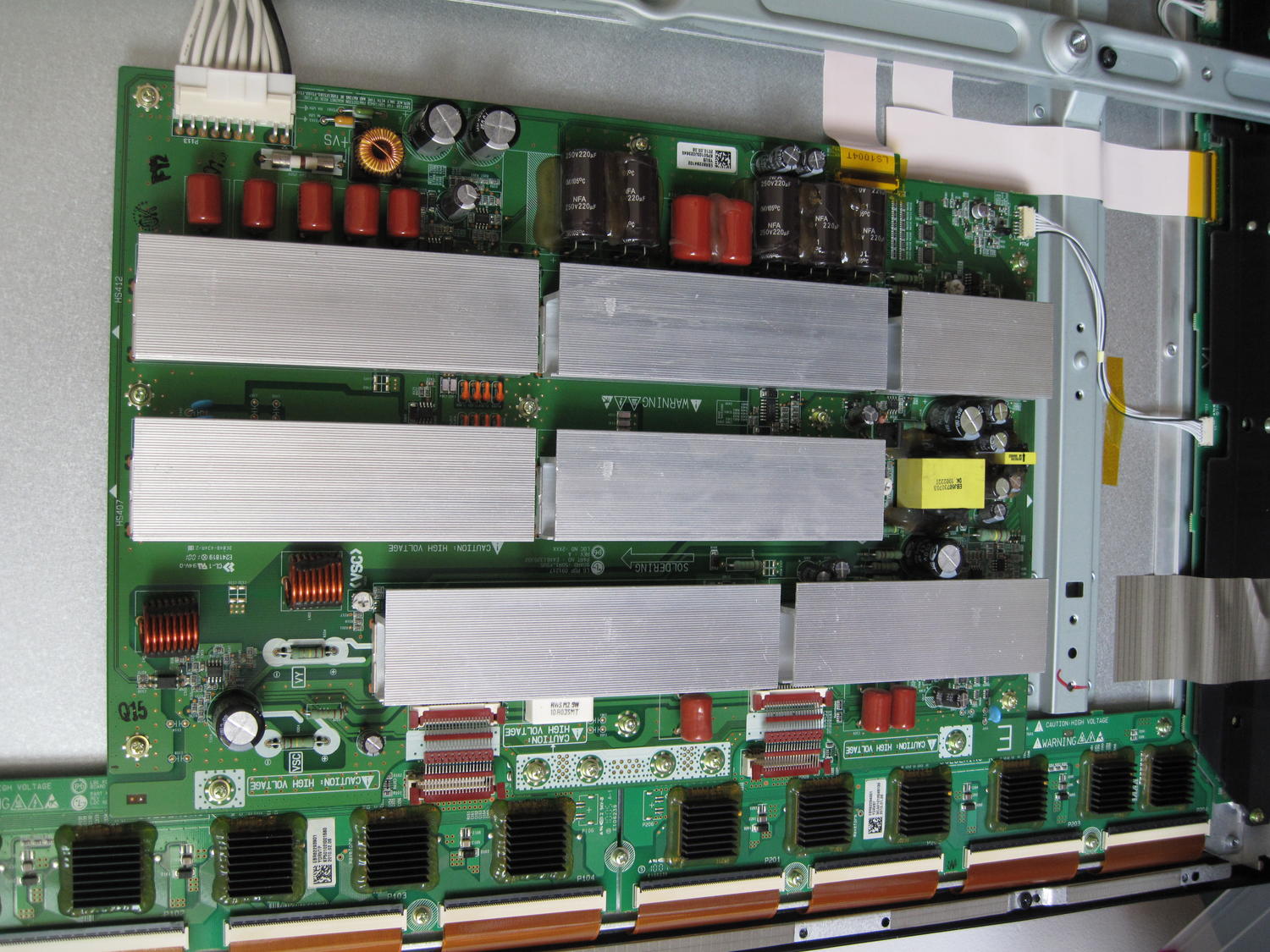

    VSC with Y-Drive boards connected: 0,4 jumping to about 2,6 volts
    VSC with Y-Drive boards unplugged: 150,6 volts
    -Vy with Y-Drive boards connected: -4,7 jumping to -30 volts
    -Vy with Y-Drive boards unplugged: -189,5 volts
    VZB: 114,7 volts
    LED on mainboard is blinking

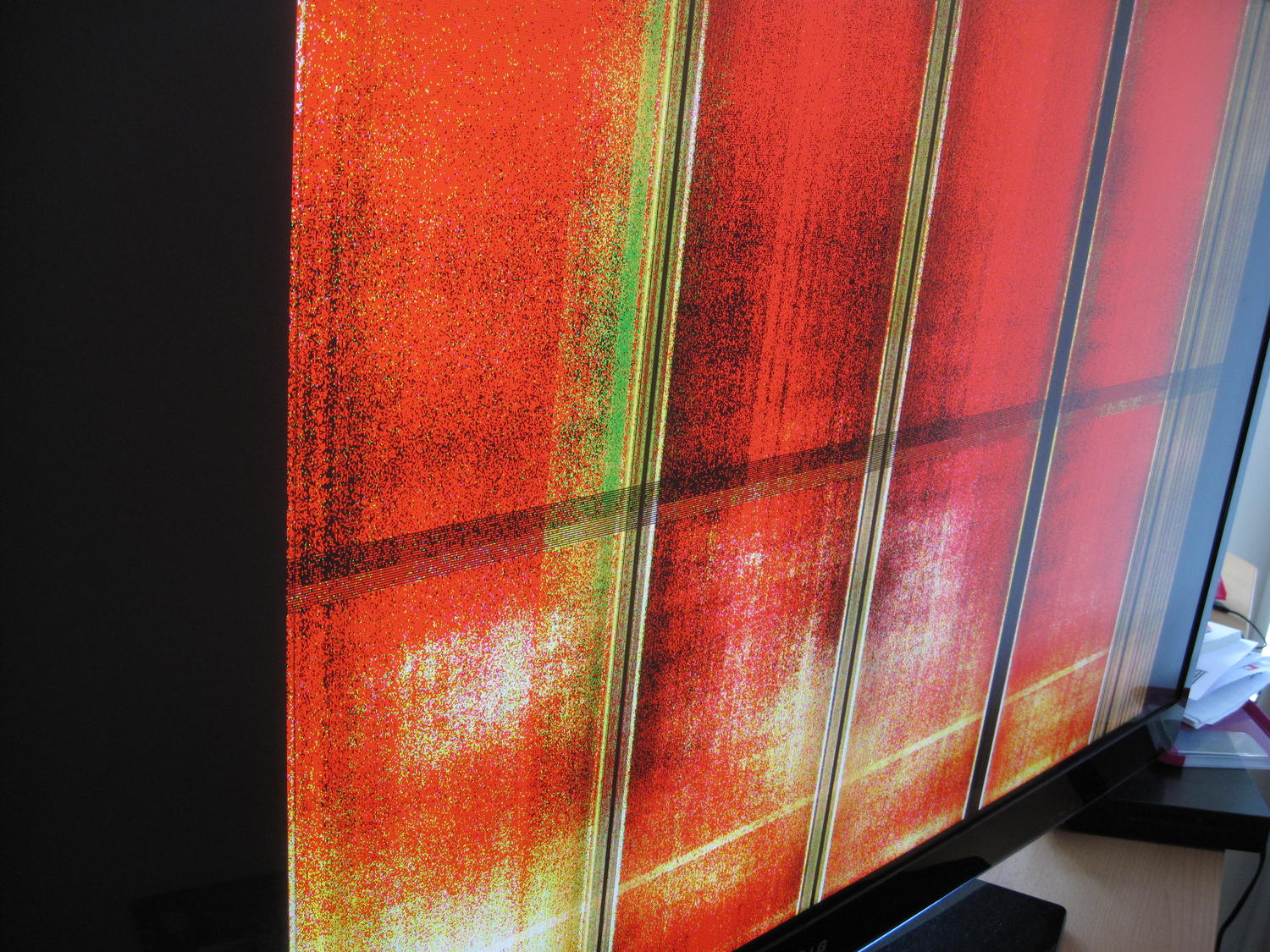

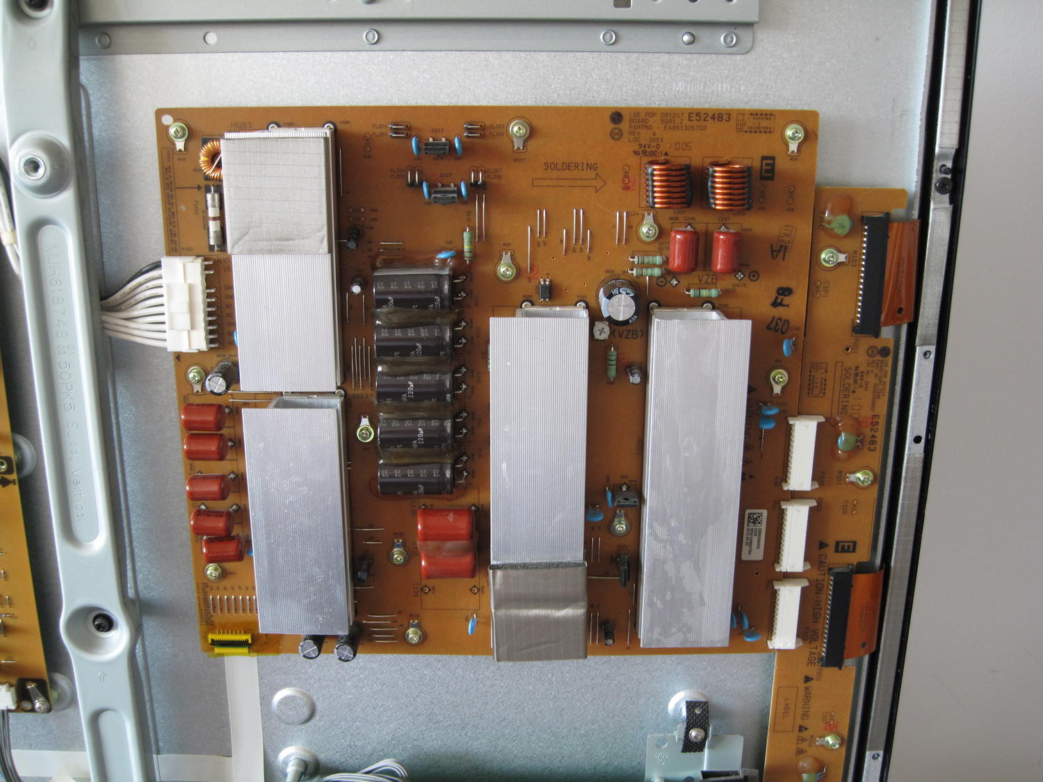

    The strange thing is, when the tv is powered up with the two Y-Drive boards unplugged, VSC and -Vy voltages are stable and the pannel shows a picture like this:
    Does anyone know, what to do here and how to investigate this problem further?
    Many thanks in advance .. Holger
