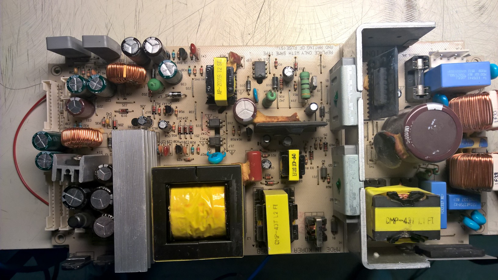

    Fujitsu Siemens Myrica VQ40-2 PSU bad
    Hello
    it seems this Myrica has a bad powersupply.
    Only STBY +5V is alive and does not come on when jumping PS_ON.
    Advice? Schematics?

    Re: Fujitsu Siemens Myrica VQ40-2 PSU bad
    P/N of PSU?
      Pa-2005b
        I noticed the black epoxy incapsulated PWM module gets very varm directly after start up. So this will be a module swap if I can found one.
            Are you sure its the PWM, have you checked the caps on esr I noticed that there are green samxon gf caps which are known to fail with out bulging ?
              The CMP-PWM module gets warm (more than I would expect) directly after power on. It also drop too much voltage across the 47ohm series resistor feeding it.
              I can't think of anything else than a CMP-PWM failure really.
