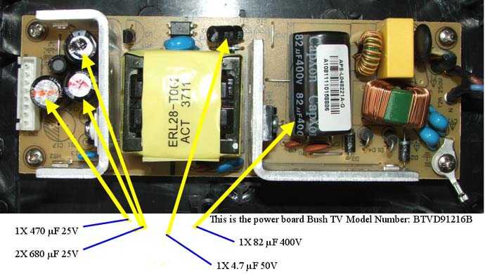

        Re: 22" HDTV with strange behavior
        I had exactly the same problem with same tv etc and had to recap heres the ones I changed with the picture I found on the web
            Might be the same TV but my power board is totally different than yours.
                  ok sorry
                  • Reddoguk
                    • May 2015
                    • 12
                    ok sorry
                    No need to say sorry m8 you tried to help me and that's all that counts.
                    You have done this already to the same TV so you're input might be valuable to me even if the board is different.

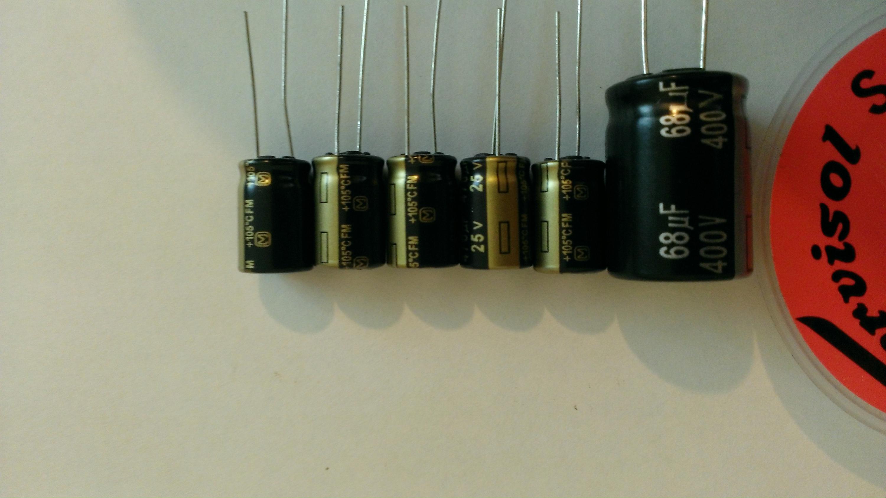

                      This is my TVs power board with the 4 bad caps removed.
                      If diif or anyone could link me a replacement for the big cap i would be very grateful.
                      I have seen some on the RS site that diif linked for me but i'm not sure which one it is, some say DC and some aren't. So which one do i order to replace this bigger one.
                      The details can be seen in the photo but on it it says xunda 68uf 400V RK1128 105C (M).
                      Also it has to be a through keyhole type and not the snap in ones as there's a small part that would block it.
                      Again a huge thank you to those that are helping me.

                              New shiny Panasonic capacitors just arrived from the store. Time to get the iron out and hope for the best.
                              • Reddoguk
                                • May 2015
                                • 12
                                Omg guys i can't believe that it actually worked.
                                Not sure if it's placebo or not but the TV looks even better, brighter and more crisp.
                                Thanks for the replies and help.
