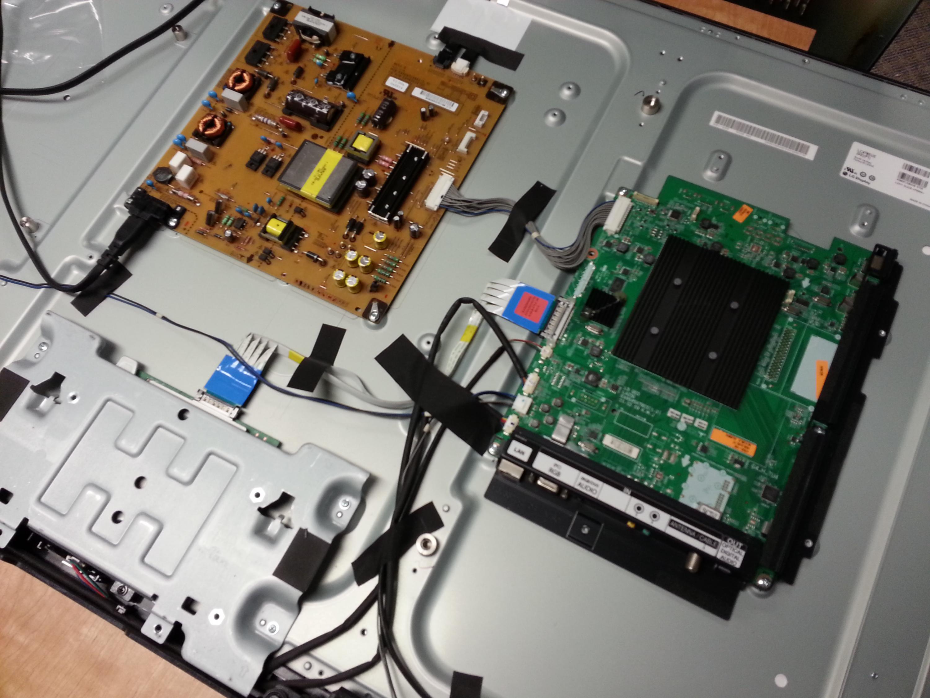

    I've been working on this LG 47G2 LCD television that powers up and lights up the backlight, but doesn't actually put anything on the screen. I have tried replacing the T CON board already, but it still does the same thing.
    Any ideas?

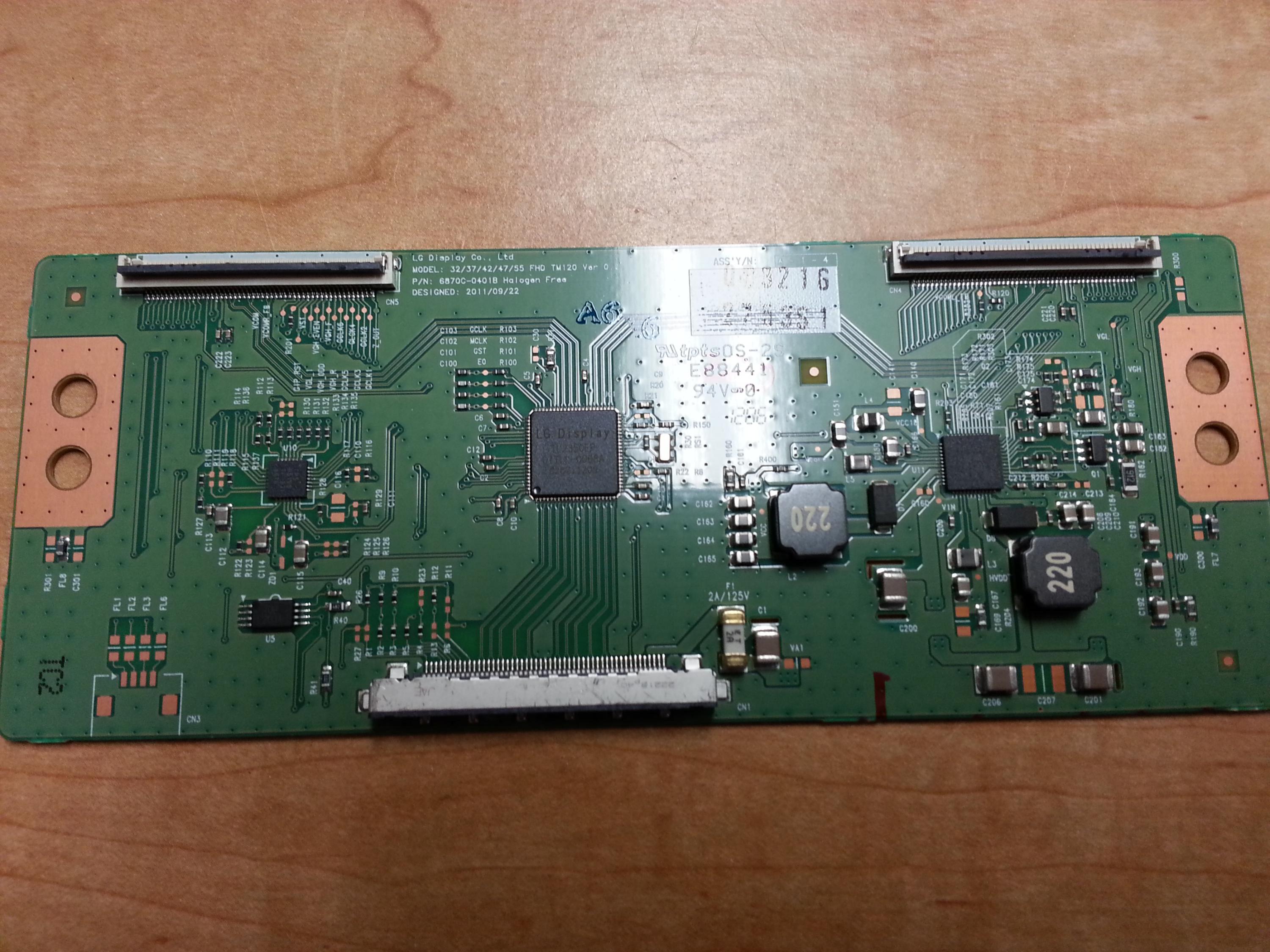

    Also you should get 12v going to the tcon, check both ends of the pico fuse to ensure that 12v is present.
    If you've bought a tcon from eBay then it's certainly not guaranteed to be working

        Okay. I have attached some photos of the boards to this post and double checked the fuse on the T CON; it appears to be okay on both the original and replacement units. As far as checking for power on the T CON goes, is there any good points on there to test that? The pins on that connector look really close together and easy to accidentally short out.

            Need to check the fuse and make sure it's getting 12v
            You shouldn't be in danger of shorting anything out.
            Put black probe on chassis (ground)
            Then red probe to one first end of the fuse.
            Then change to the other side and check the other end.
            You should get 12 volts going in, and 12v going out the fuse.
            If you don't get 12v going in, suspect mainboard or LVDS cable.
            If you get 12v going in but nothing going out, bad tcon.

              With the new T CON, I'm getting voltage on the bottom of the fuse while the set is running, no voltage on the top of the fuse. With the old T CON, I'm getting voltage on both sides of the fuse, which is how it should be. I know I didn't get them mixed up, in case you were wondering .

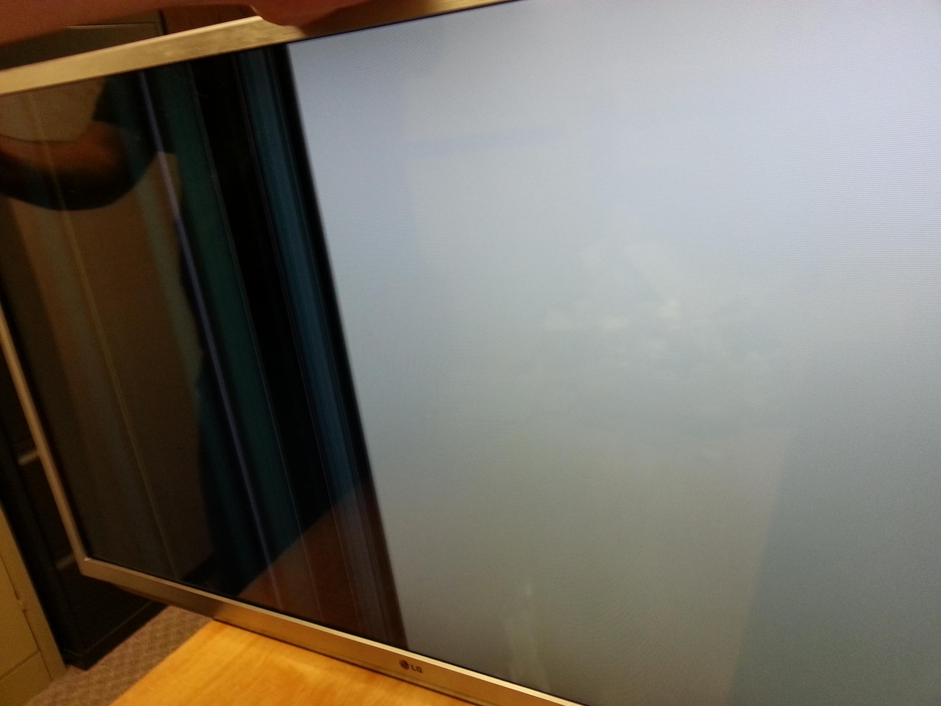

                      With the left ribbon unplugged, I'm getting vertical bars on the left side of the screen, solid gray on the right. With the right ribbon unplugged, I'm getting nothing on screen, but I'll check this a bit more thoroughly when I can move this thing to a position where I can see the screen more easily while the unit is face down.
                        Follow-up and picture
                        Further testing revealed little more than what was discovered earlier. With the left ribbon connected and the right ribbon disconnected, I'm getting nothing at all. With the right ribbon connected and the left ribbon disconnected, I'm getting what is seen in the picture.
                        Am I looking at a bad panel here or should I try another T Con board (or something else altogether)?

                          That still looks like a T-Con fault to me, it is not unlikely that you have two bad T-Cons. I'd say the panel is most likely okay.

                            Installed a new T Con, getting the exact same symptoms as before. Fuse is good and proper voltage is present on both sides. Any ideas?

                                        The lines on screen one sided says panel fault to me
