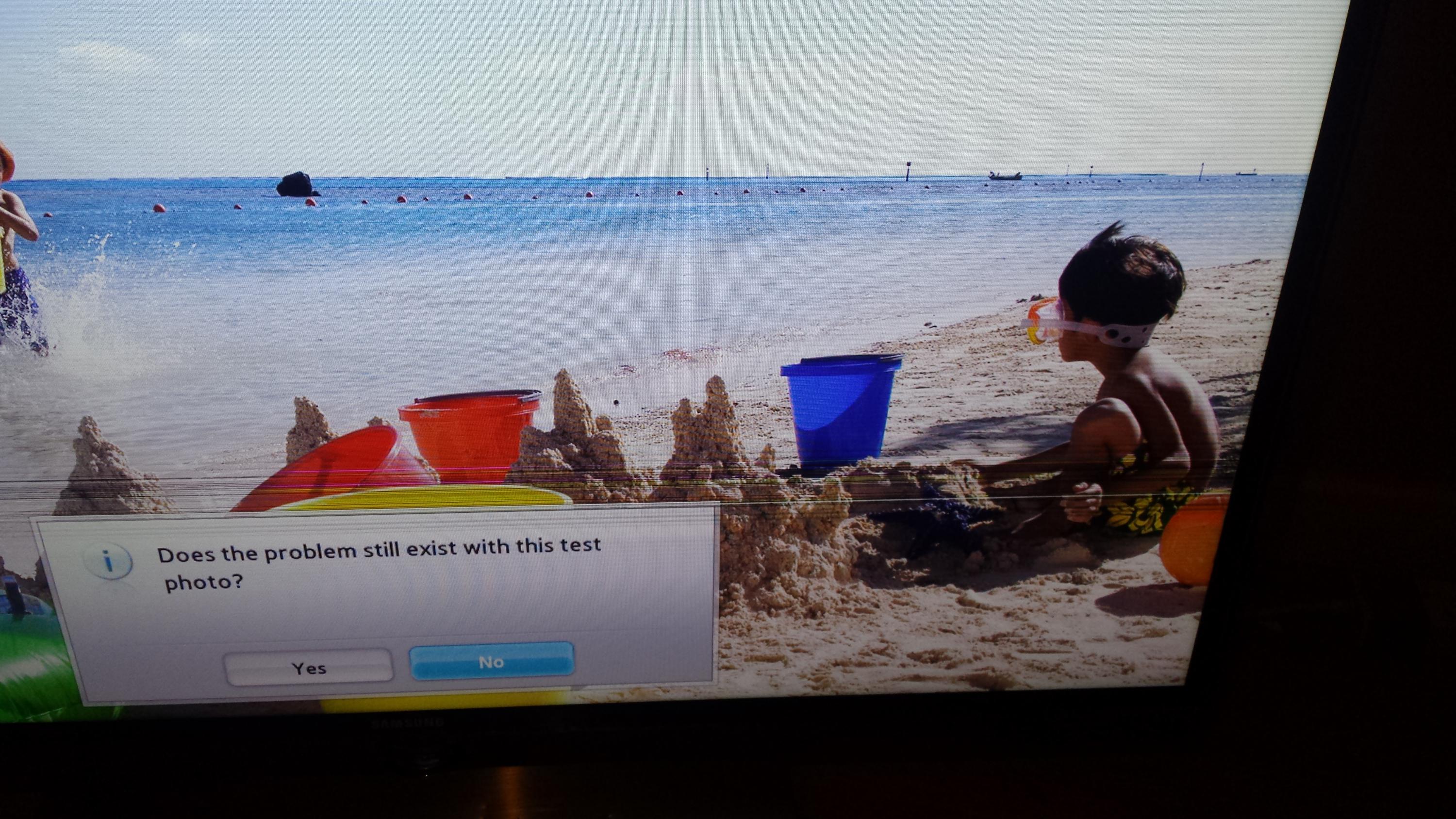

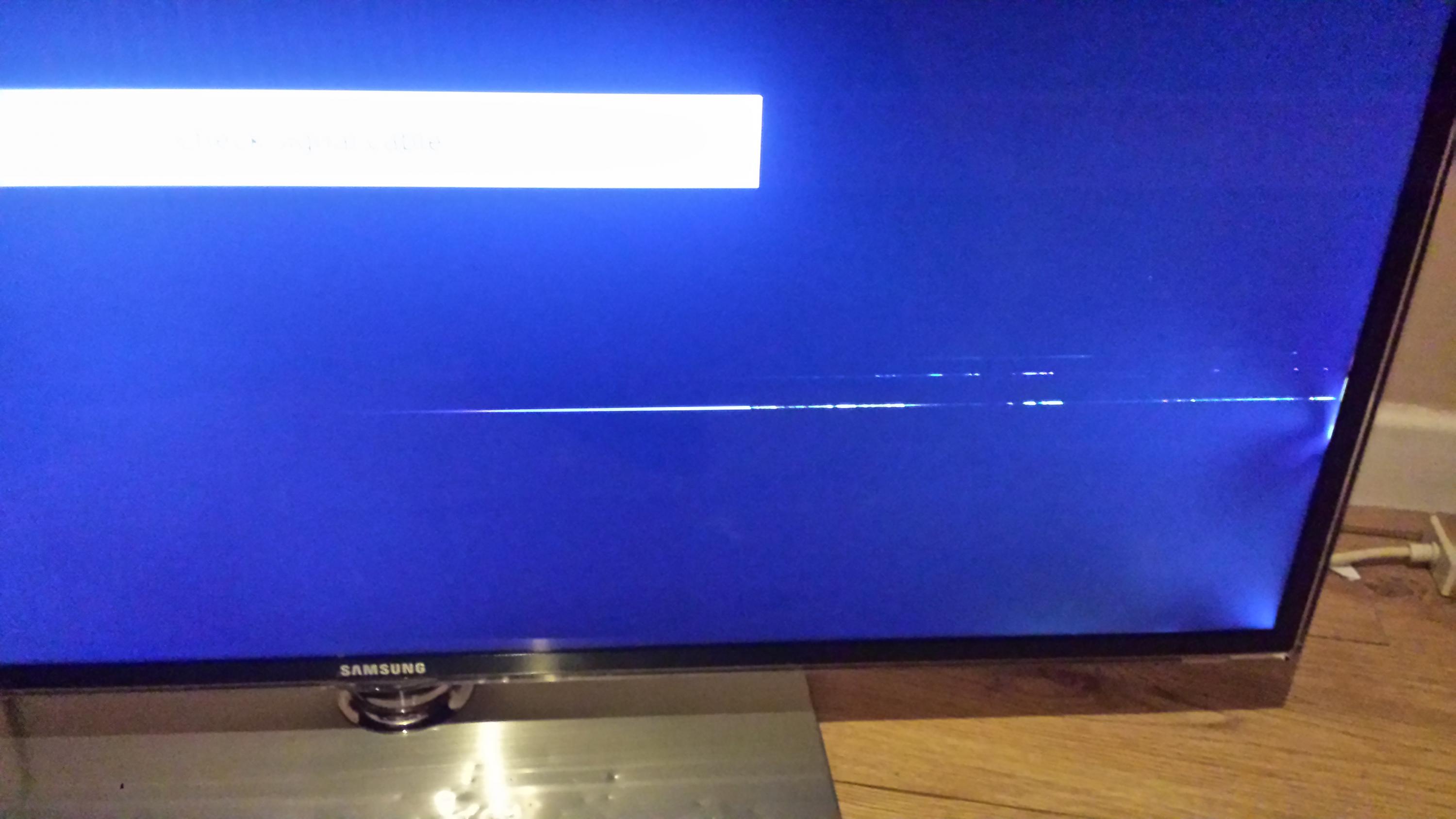

    Hi guys I have the above tv that I've had for over a year now and it's starting to have a few lines running across the screen from the right
    Anybody know if this is fixable ?
    I've also noticed that the area with the problem is getting way too hot to the touch could this be the cause ?
    Any help is appreciated

    Re: samsung ue46d6530 problem
    Panel Failure.
    Not repairable sorry

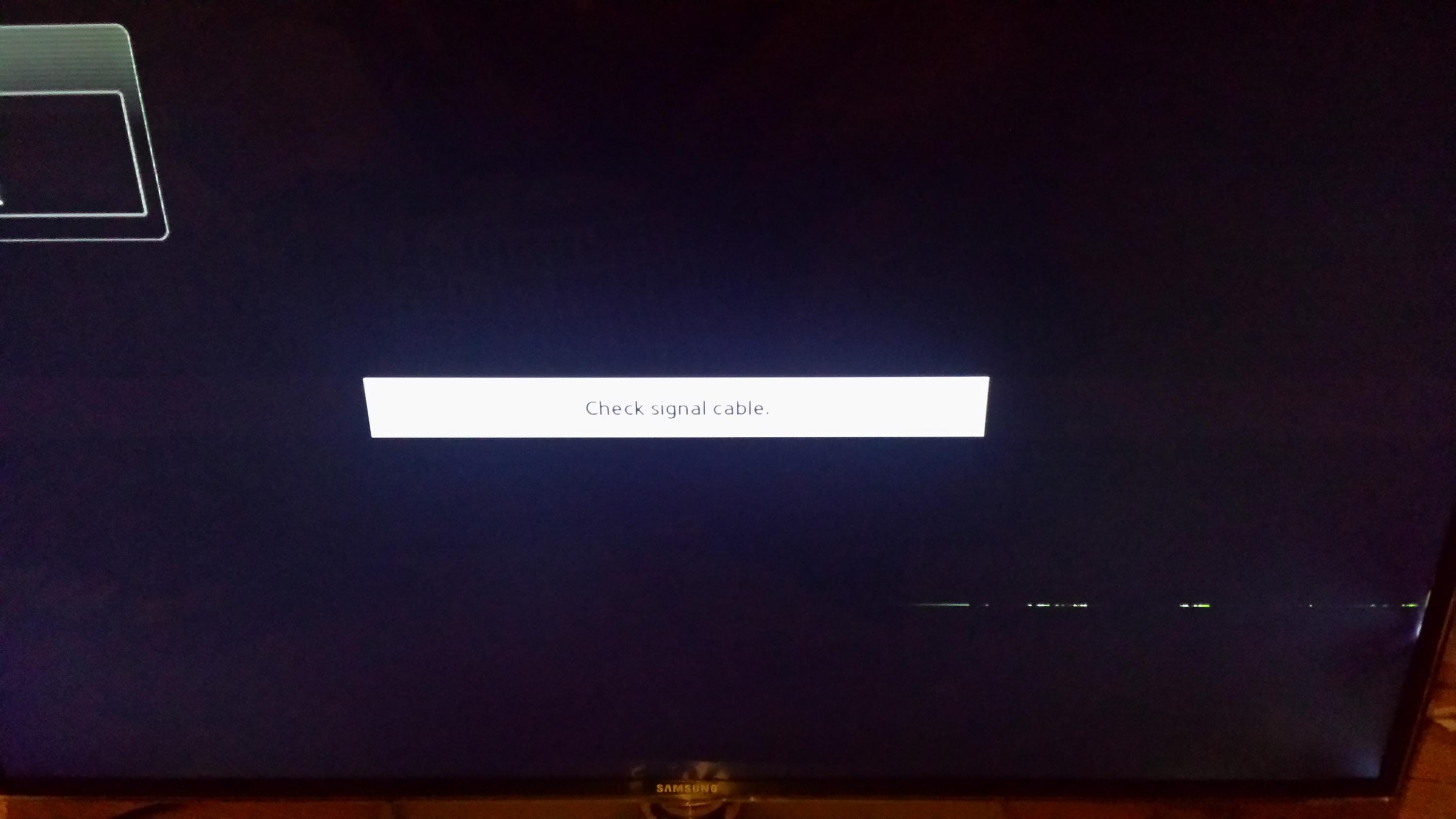

          It's the second samsung to go bad on me now after a short time the only concern I have with it right now is how hot the right side is getting down where the power buttons are if u touch it it actually will burn u when on could this be a led issue ? And has caused the screen to go faulty ?
            The LEDs look OK -- but it must have got real hot, because the panel backlight film is warping underneath.
            Maybe it would be safest to leave it off.

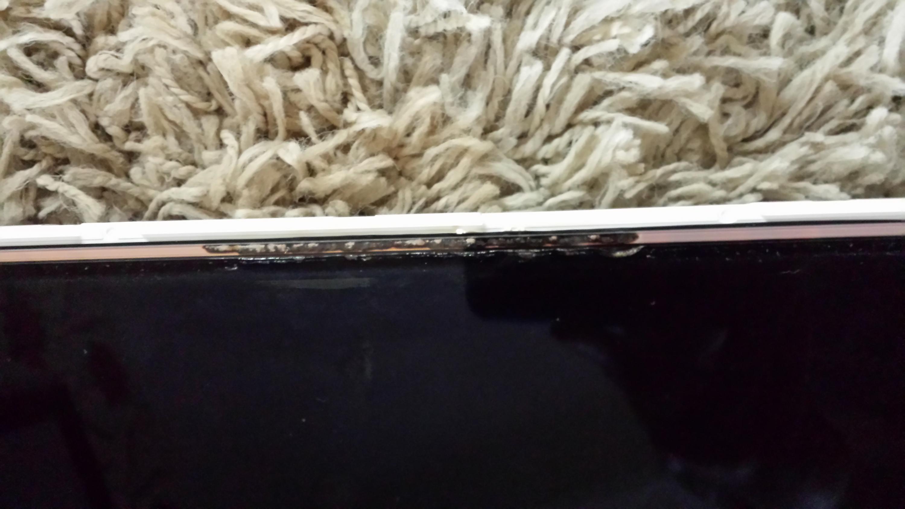

                  Hi guys an update removed black bezel around screen powered the tv on to try and see if the side bonds was the cause and anyway smoke came from the area with the bad lines
                  Now the screen looks like this anybody want to have a guess at what's caused it to burn ??
                    The LED system has caused this problem.
                    This TV uses only 2 strips of LEDs, located on the left and right hand side of the TV. Right where those tab bonds are.
                    Each strip consists of more than 80 LEDs all tightly compacted.
                    It's a design flaw and Samsung sould be recalling all these sets imo.
                    The LEDs also are not covered by plastic domes that you see in other LED TVs.
                    Terribly designed TV and destined to fail early.
                    On a brighter side, the TVs boards are worth a decent amount, and the LED strips are easier to remove as they are screwed in rather than the God forsaken double sided tape used in some other sets.
                        Yeah it's got really hot and it's melted the tabs on the side of the TV.
                        You see these models all the time now same problem. Horizontal lines.
                        I've dismantled one of these in the last month with a cracked screen, but even then the guy i got From said that before he cracked the screen he was getting intermittent green horizontal lines.
                        Ticking time bomb, if you hadn't gotten a new TV through your insurance id have went to watchdog or suchlike, it's only a matter of time before Samsung get called out on this set.
                              The formerly bonded ICs are integrated into the panel. Gate in Panel design.
                              This should actually make the panel more reliable... unfortunately Samsung seem to have somehow made these panels even less reliable (or is it AUO?)
                                I'm pretty sure this panel does have side tab bonds.
                                You'd have to remove the White plastic to see them.
                                I think this is part of the problem, usually to remove the panel of an older LCD you would remove the metal frame, and the panel would flop out, on this set the you remove the metal frame but the panel is held in place also by the white plastic that you need to unclip. The side tabs are also under the plastic, whereas before they were ontop. Also the benefit of them being ontop meant that some of the heat would be absorbed by the metal frame.
