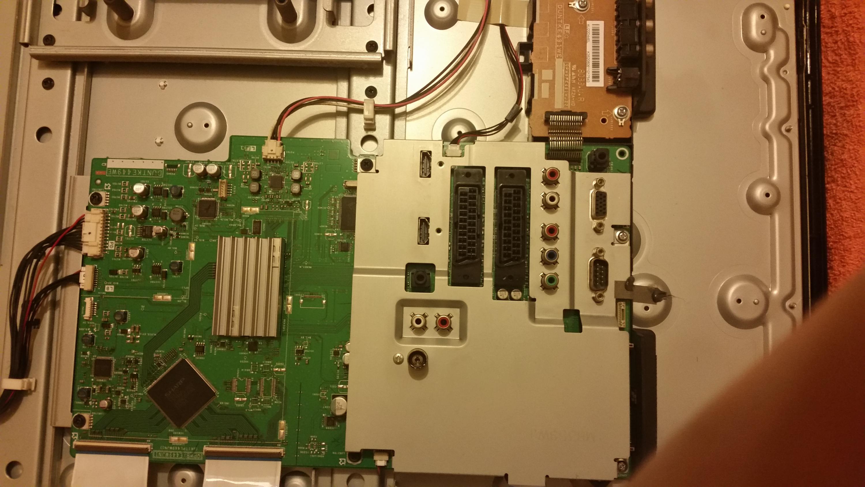

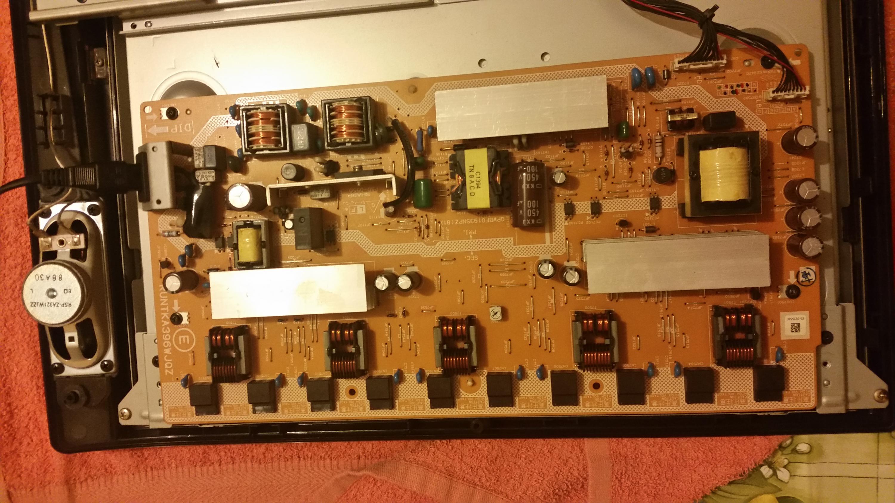

    I currently facing a problem with my sharp lc-32d44e-bk.This week all of a sudden my tv was shutting down showing red red orange flashing lights and then you must unplug it and switch it ON again for it to work again.All of a sudden today it not working at all when I switch it ON it is immediately turning off no picture no sound nothing.I have opened the back of the LCD for me the power board looks fine in terms of capacitors..they are not bulging.What could be the problem and how to solve it? thank you very much

            I have found what was causing the problem.The CCFL tubes was causing the tv to go to safe mode/powering off.Thank you
