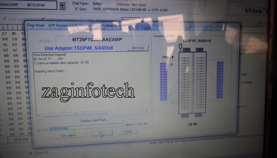

            Re: Toshiba 40L1333B blinking red/green power indicator
            try this topic
            toshiba 24w1333g firmware Dump + Nand flash
            https://www.zaginfotech.click/2022/0...dump-nand.html
