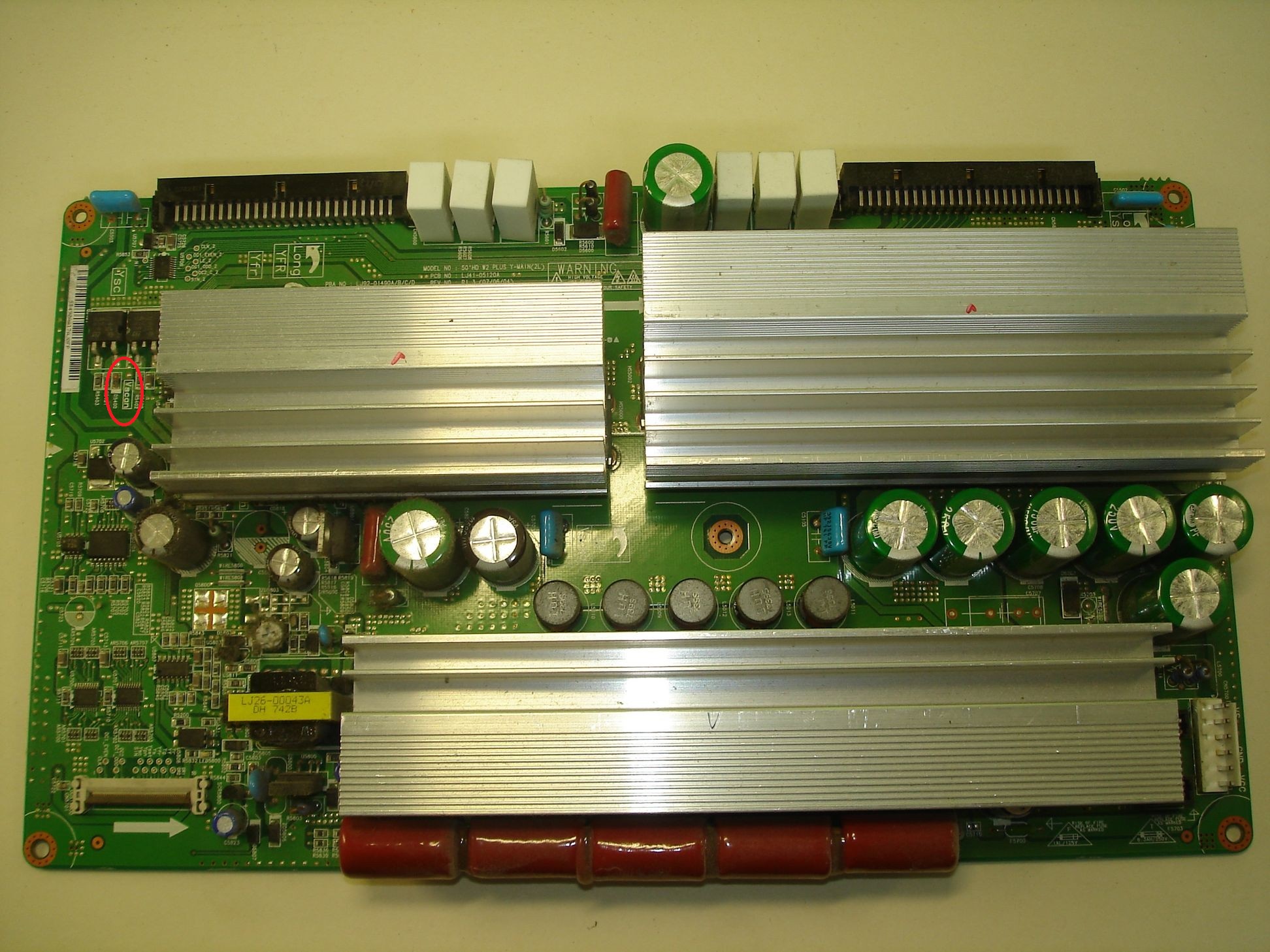

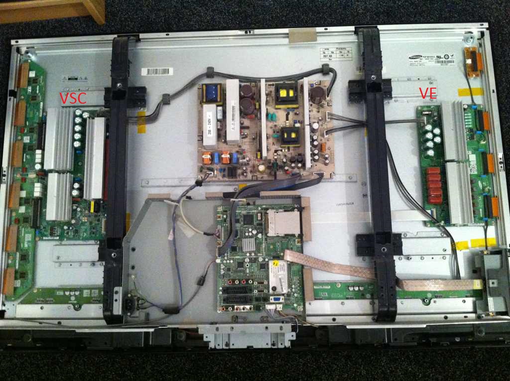

                    Right I have just measured VE at 94V and i have not been able to fine VSC are you able to send a more detailed picture? if not its fine a description will be as good

                      Re: Samsung 50" TV PS-50Q97HD wont turn on
                      Picture uploaded but i would also check for Q801 & Q802 on the underside of the power supply which if i remember its a common fault on these models

                          Right I have just measured the VSC and it starts at 170+V and slowly decreases voltage i am just waiting for the bored to discharge so that i can check the q801 and q802

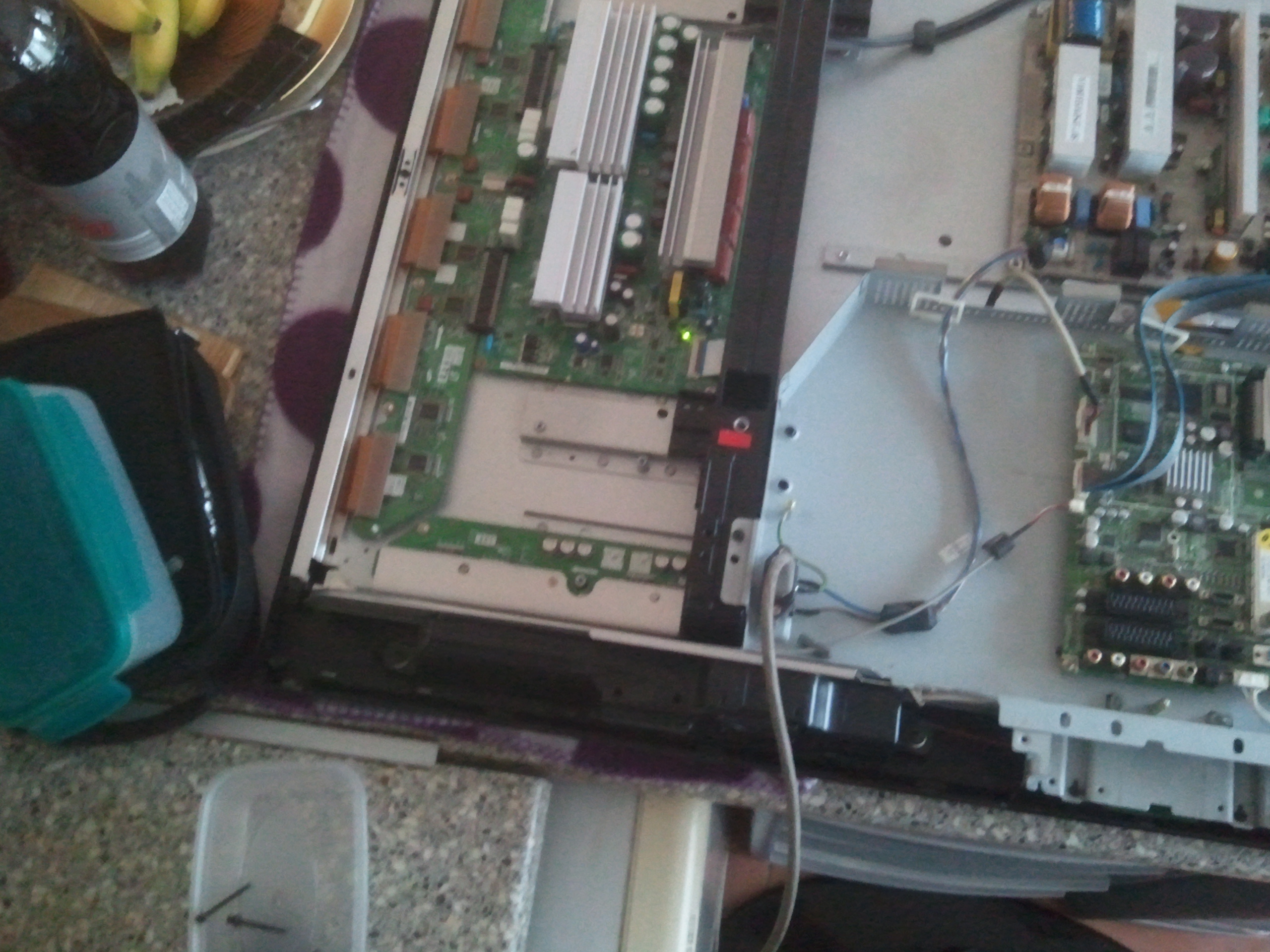

                              Is there a tiny green LED lit on the Y-SUS board, (in bottom right hand part) when the set is turned on....?
                                Is this the light you are talking about?
                                    LED lit = fault on Y-main
                                        The Y-SUS is in 'Protection-Mode' hence that LED.
                                        The protection circuit monitors three things. The ERC circuit, the VSCC and summit else that I cant recall...
                                        I have one exactly the same--and same fault. Spent probably 50 or 60 hours on it, and no progress. Many parts replaced, no obvious faults. I'm suspecting one of the ERC or other MOSFETS/IGBT's is O/C....
                                        This fault (If the same fault as mine--and Ive seen two Y-SUS with this fault)--Unless you stumble on it is NO quickie.
                                        Replacement Y-SUS (05120A) are expensive and in short supply.
                                        First off for yours--Check for shorts on all the silicon power-devices of the Y-SUS, also check the small fuses on the supplies to the DC/DC converter stage--Thats the part the protection circuit shuts down via a quad-comparator....
