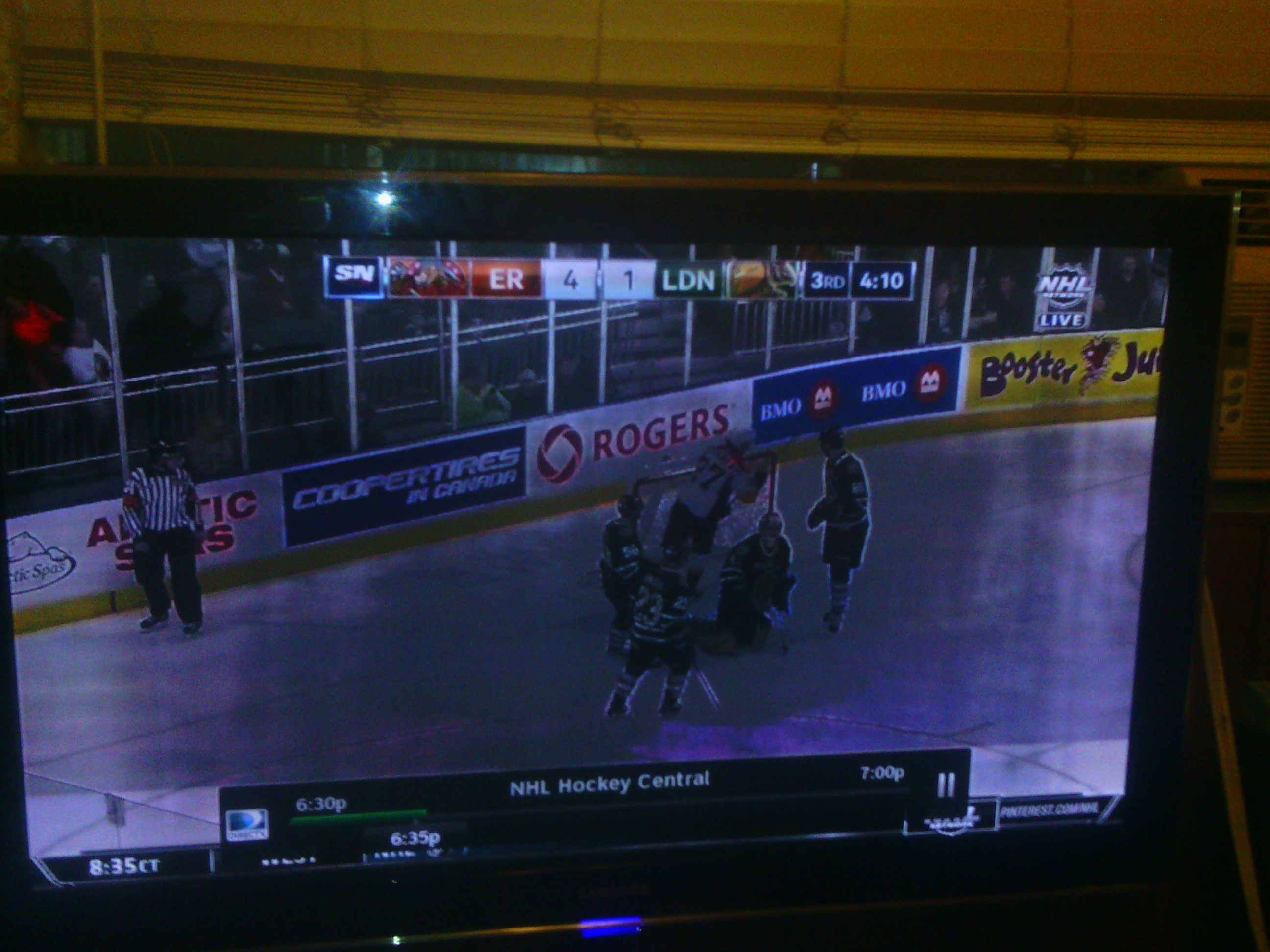

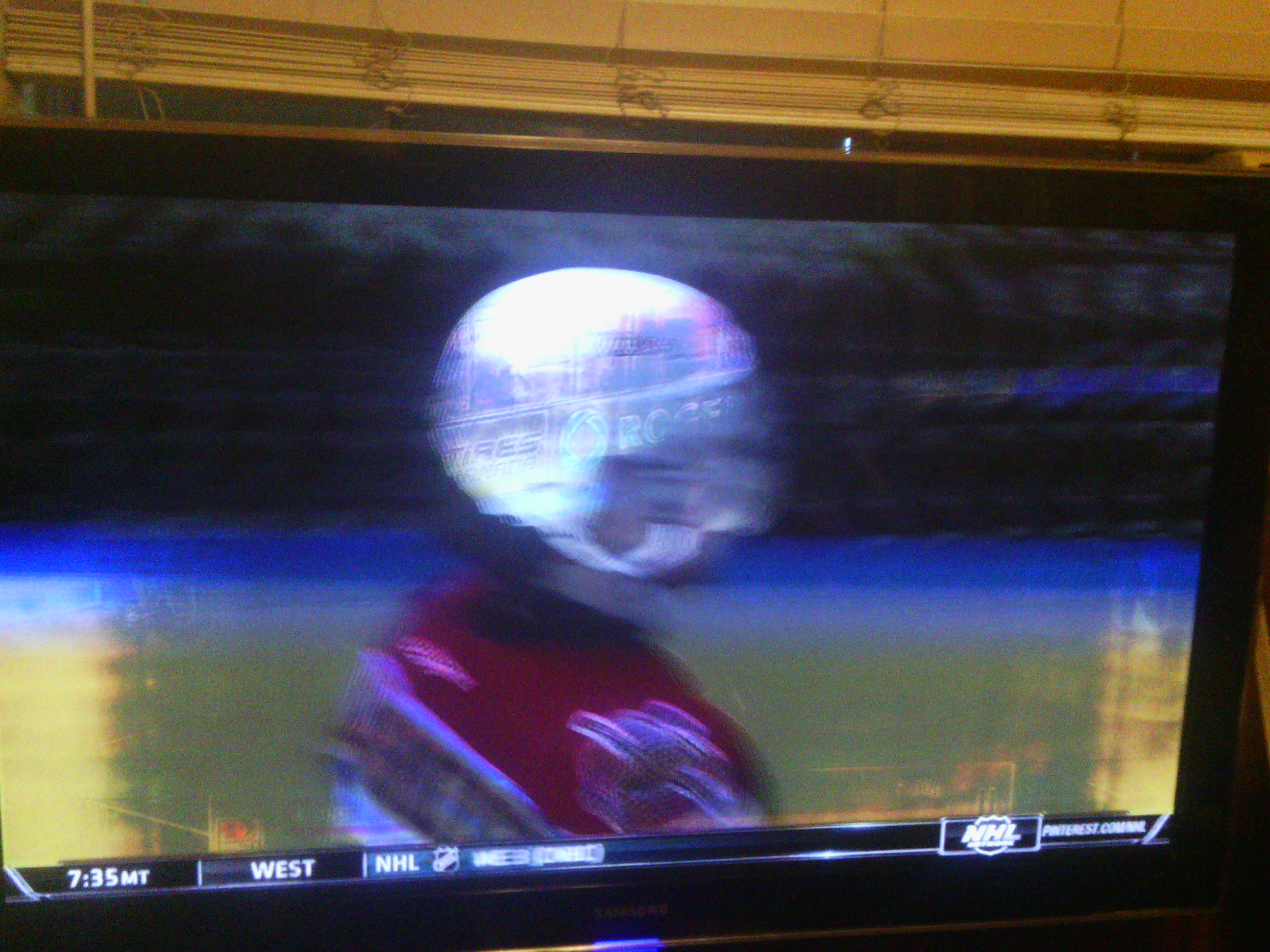

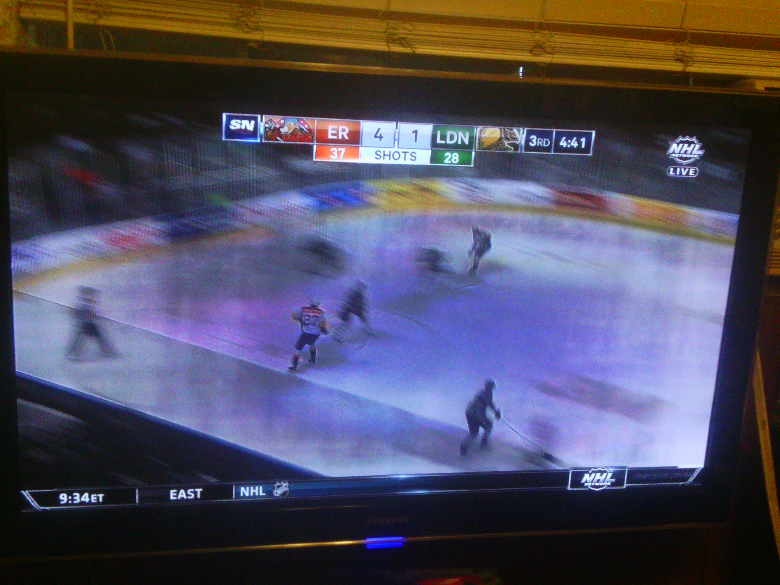

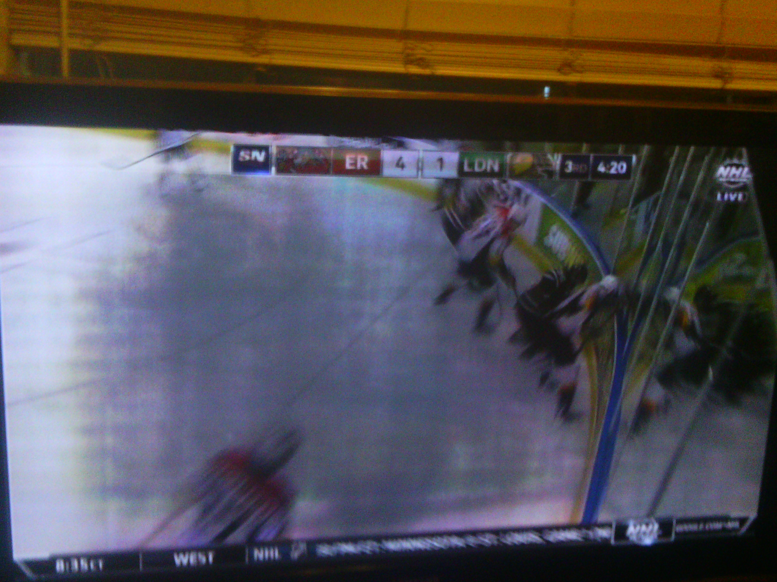

              I finally got the time to test the power board. After finding two bad MOSFETs, I decided to just swap out the board. I adjusted the VS and VA voltages as per the sticker inside the TV. The picture looks great for about five minutes and then becomes awful. I've attached images showing the screen. I also noticed the va an vs voltages drop after the TV is on for a few minutes . Not sure if this is normal behavior

                Re: Samsung pn50b860y2f plasma TV blows A/C line in fuses on power board bn44-00277a
                Dropping Vs will cause this fault, and it's not normal for Vs to drop.
                Does the picture get better if only a dim image is displayed? (For example, only the "No Signal" box)
                  Hmm--Thats a shame. Looks like the new PSU is faulty if both Va and Vs are dropping like that. Can you return it to where you bought it?
                  They should be stable to within a volt or so--no matter what happens while the sets running....
                    The picture does get better at the no signal screen. It looks like a normal no signal screen. As soon as I feed it a signal, it gets bad again.
                      It's taken a while for me to get and install new X, Y, and their buffer boards. Picture is great until tv has warmed up (30 minutes or so). If I open a menu from any source I get a ghost of the menu after exiting. Picture looks fine other than the ghost image of static menu. Any ideas?
