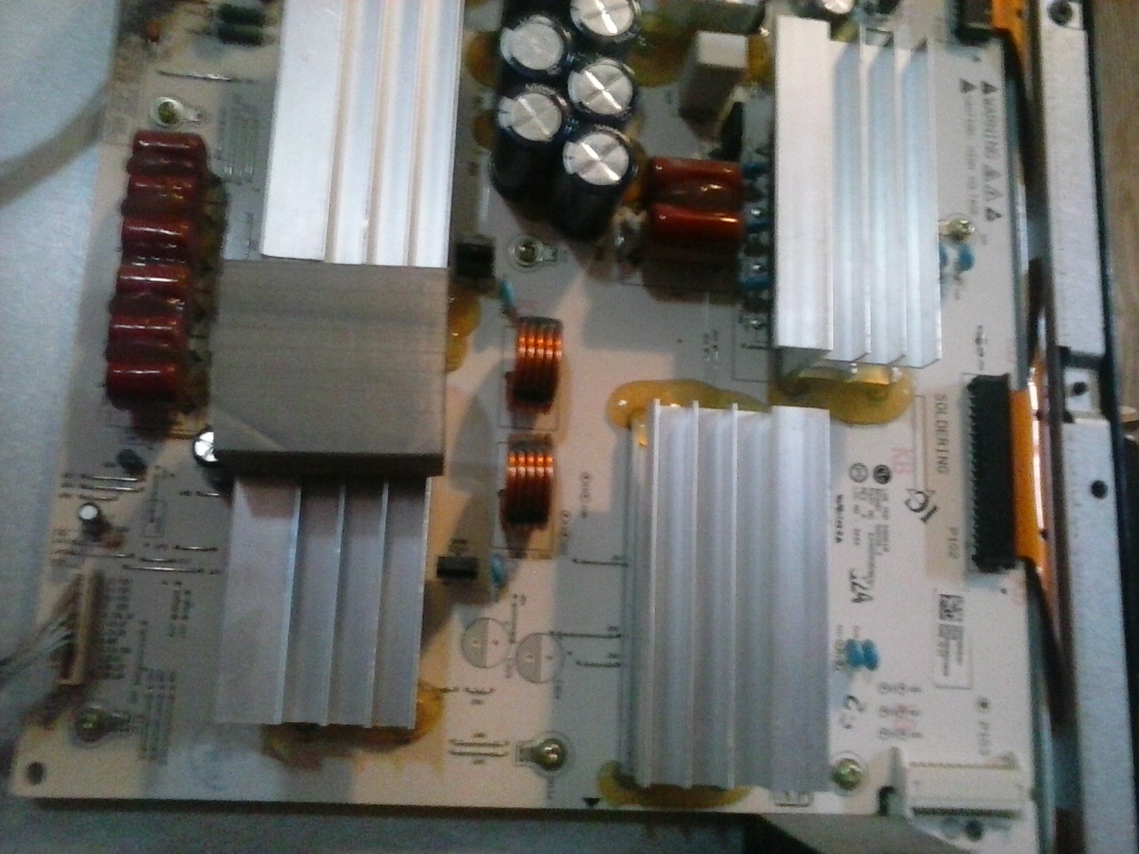

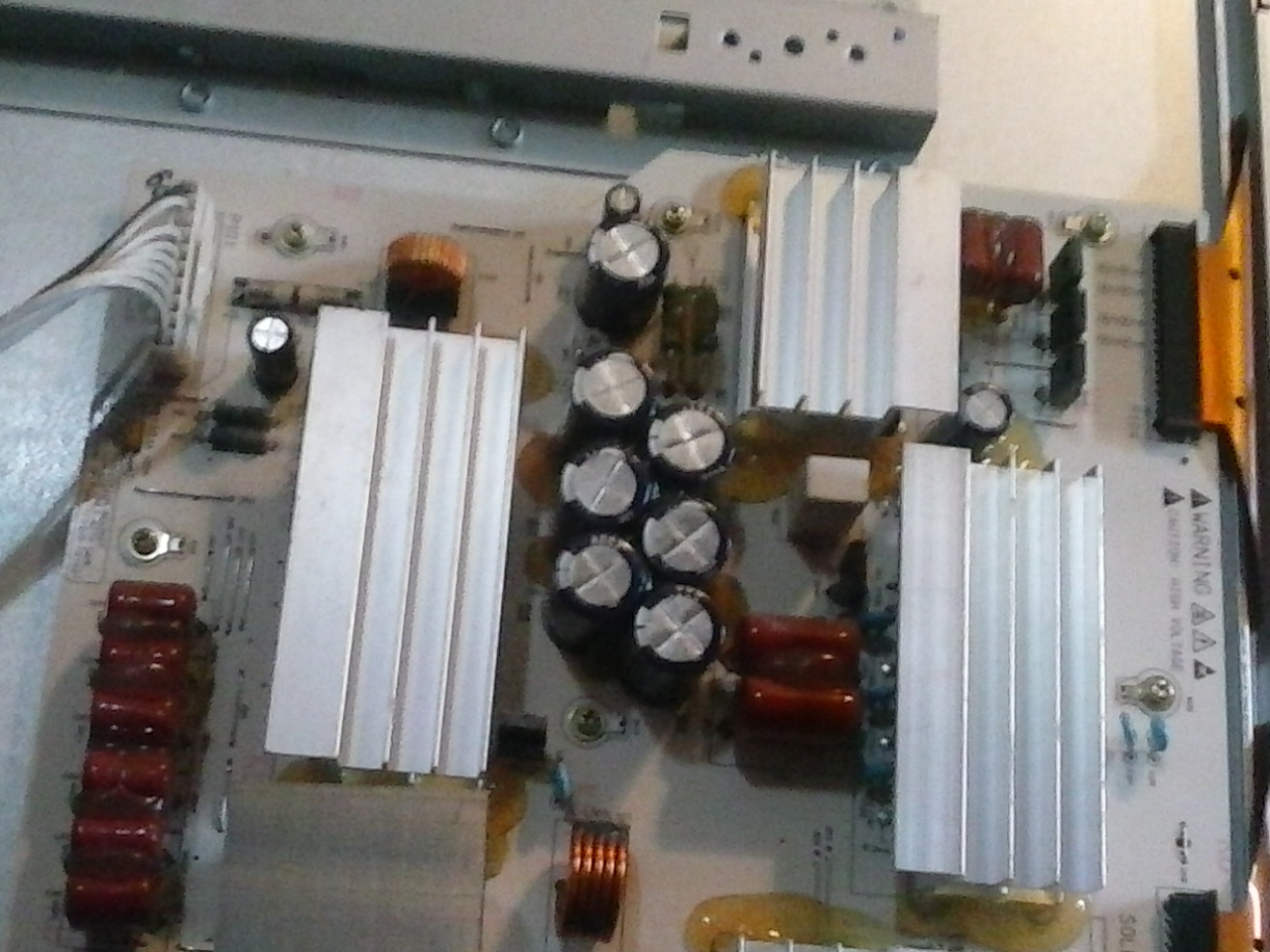

    I think your Z-sustain may be bad. If you run the set for some time, then turn it off, see if the heatsinks on the Z-sustain feel noticeably cooler than the Y-sustain. I am confused though - I thought you had the vertical lines issue which was the Y-sus/buffers. And then the Z-sustain goes bad. It's very odd. Definitely not an easy first project!

        Well, as luck would have it, my television has been on since I checked the Z-bias earlier. Both the Y-Sus and the Z-Sus heat sinks are hot, but I don't think either one is hotter than the other.
        izzy
          #44

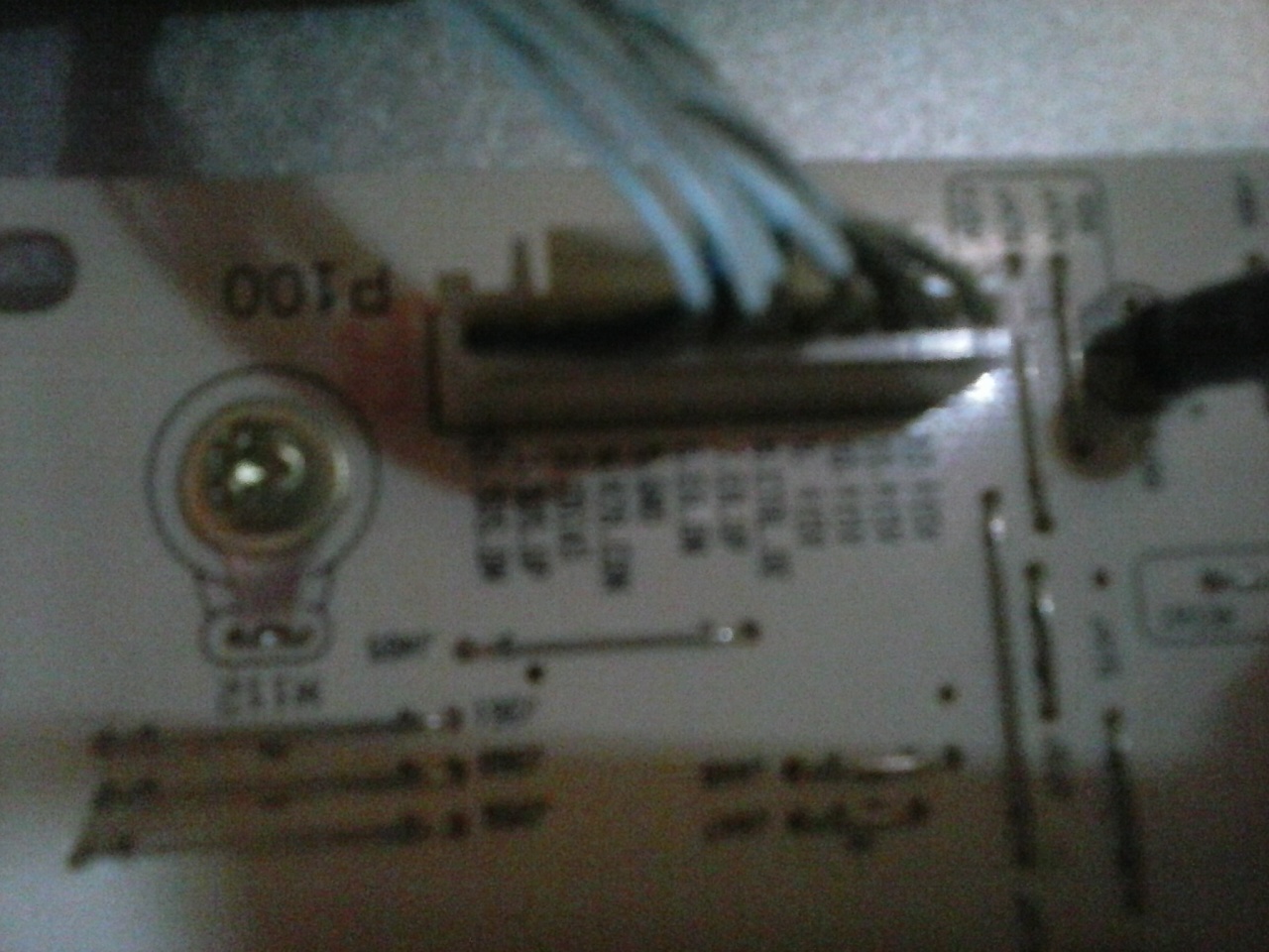

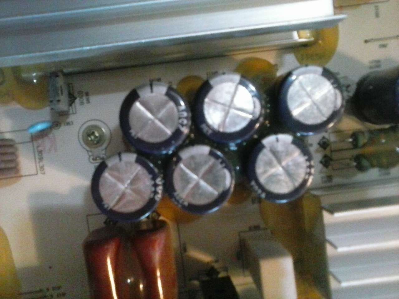

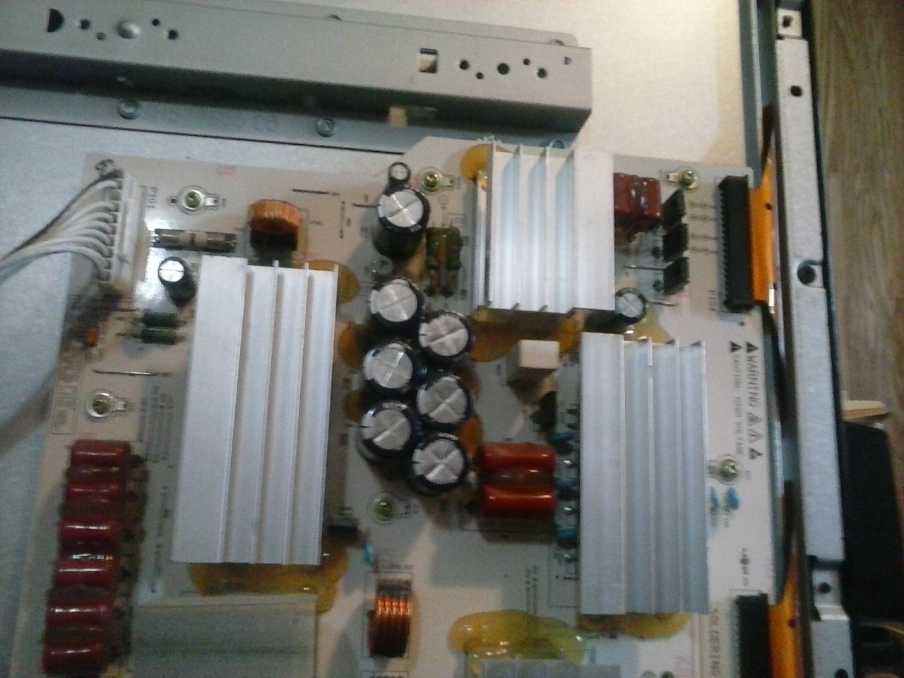

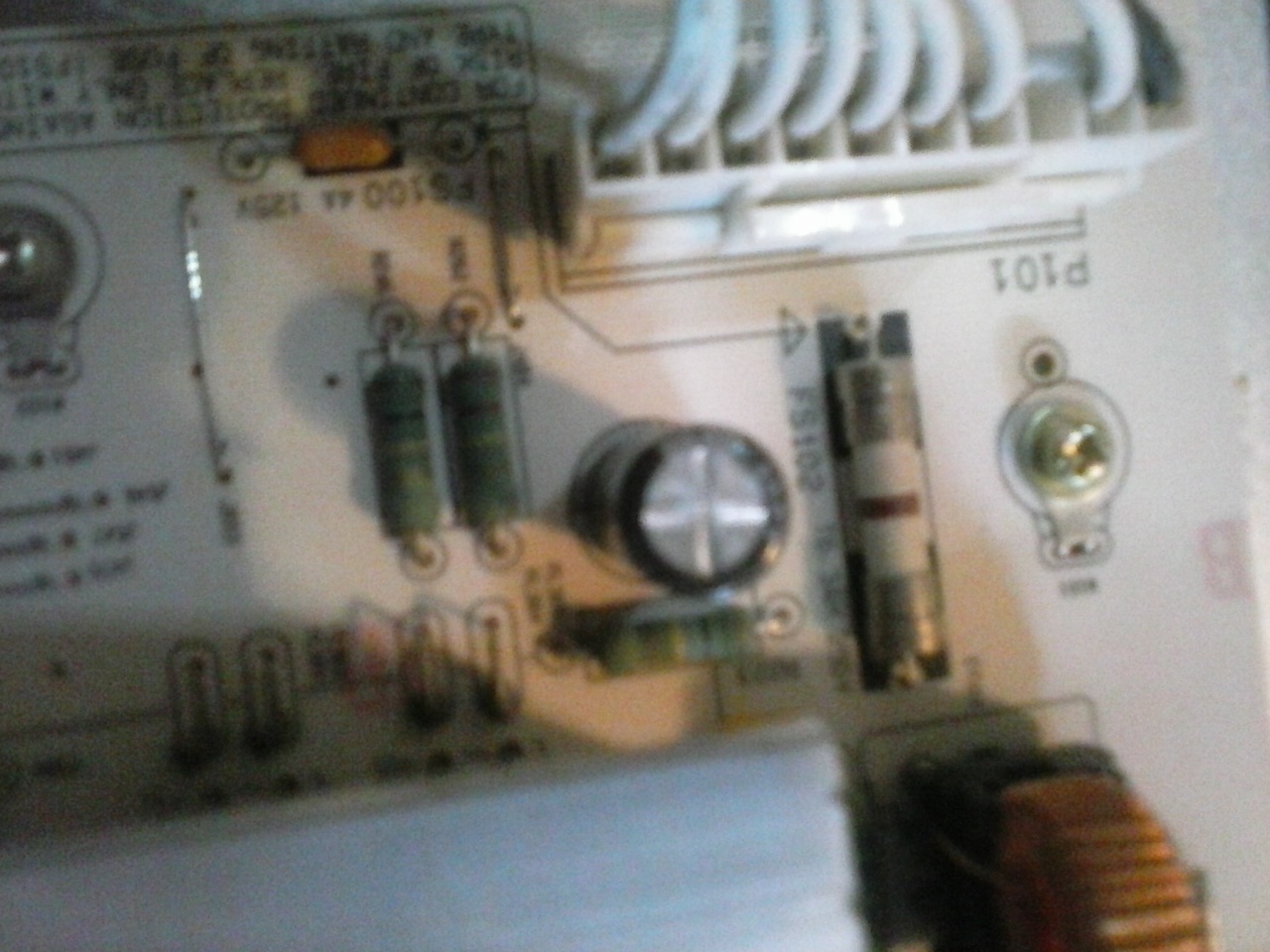

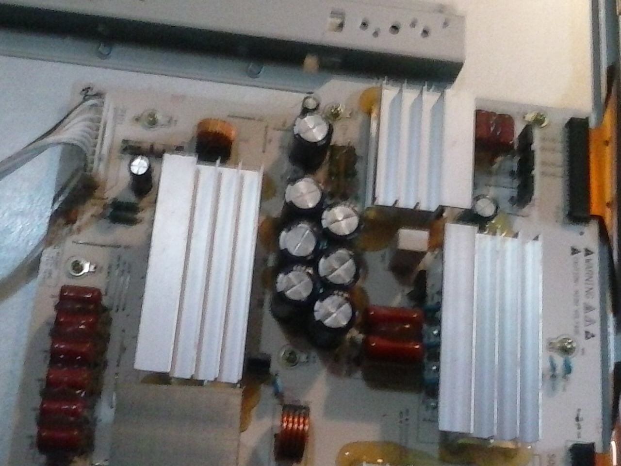

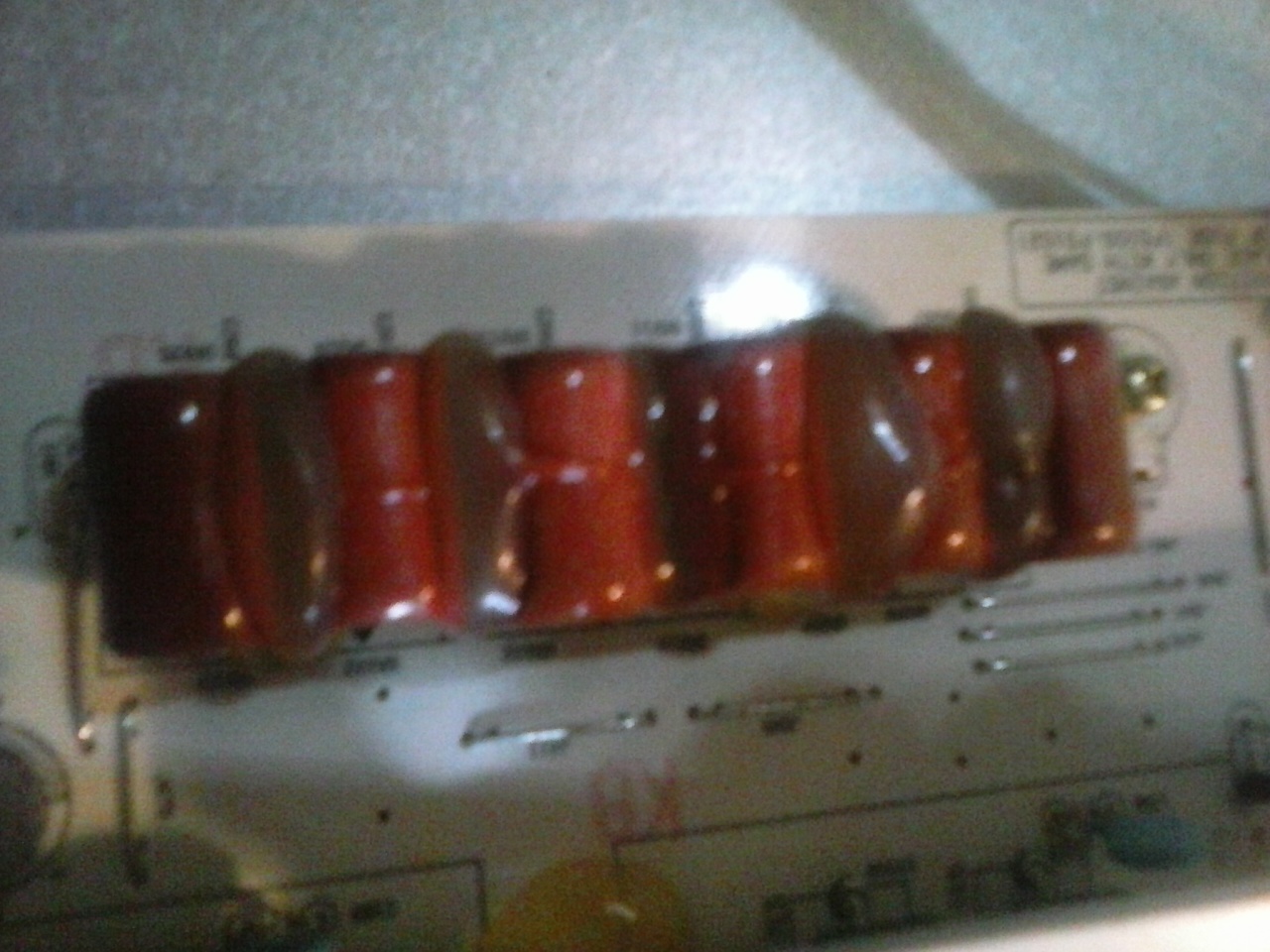

          Re: LG 50PS60 UA Plasma
          Can you supply a clear picture of your Z-sustain board?
          • Izzy_Reak
            • Mar 2015
            • 34
            #45
            I will do my best, sir! My phone is AWFUL!

                #47
                I'm planning to order the Z-Sustain today. Keep your fingers crossed.
                • Izzy_Reak
                  • Mar 2015
                  • 34
                  #48
                  Goood afternoon!
                  It's been a few months since I updated this thread, school has had me busy this past semester.
                  I replaced the Z-Sustain board in this display, and the fault didn't go away. After school was out, I ordered a Y-Sustain board and installed it.
                  I'm happy to report the television has a perfect display. The fault is gone.
                  Is there any tuning I should do? I'm afraid to attempt anything without consulting with you first!
                  Have an amazing day!
                  izzy
