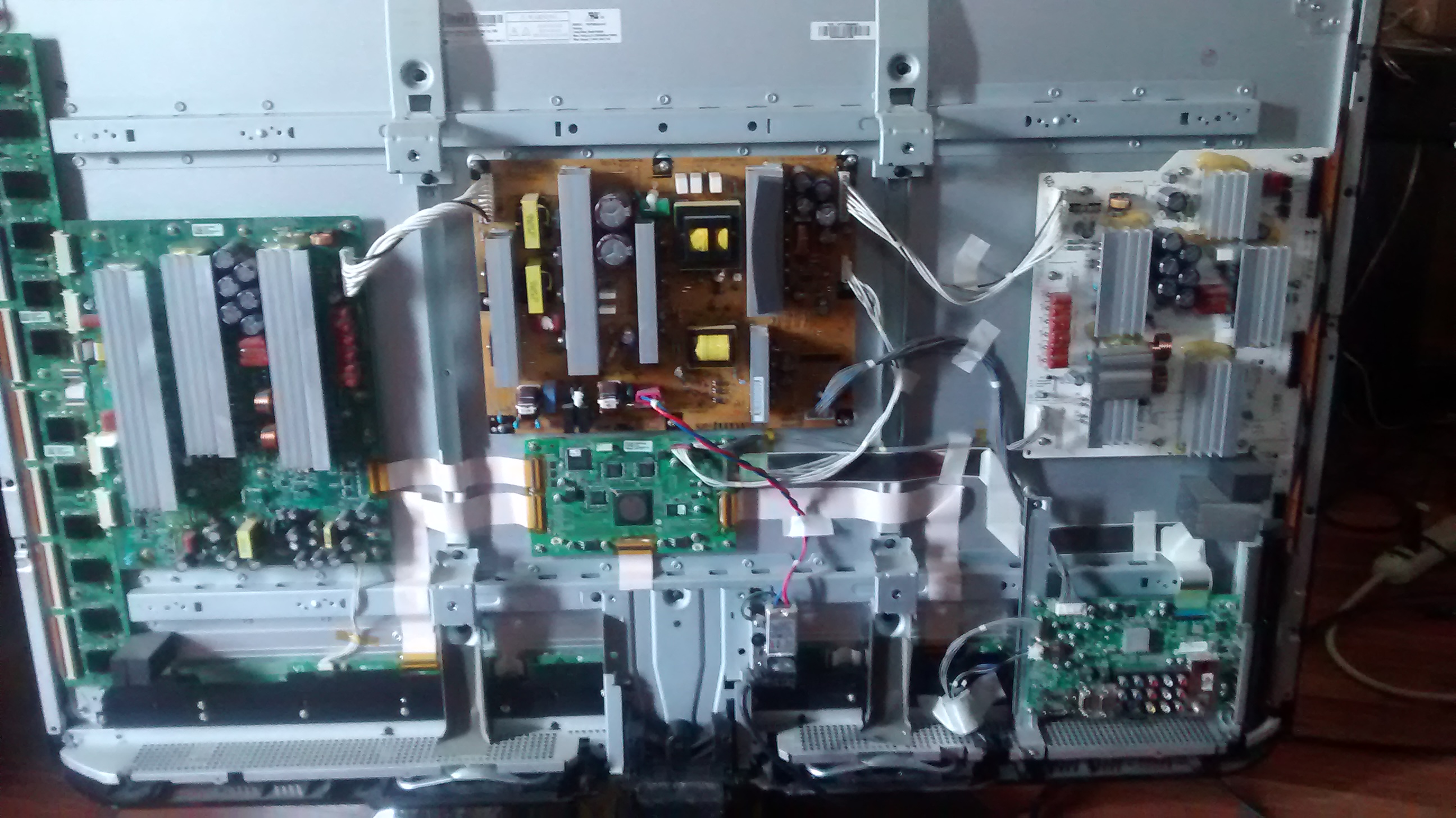

    I have an LG 50PS60 UA Plasma, manufactured 11/2009. I turned it on this past Thursday, and as it powered up, it played video and audio from my cable receiver, but after about two minutes of play, the display went black, and when it came back up, the screen had blue/green/speckles all over it.
    I powered it off, turned on the Blu Ray player, and the display was still the same. I unplugged the power for two hours, and when I plugged it back in, sans blu ray player, the display booted up with the Blu Ray screen, still jumbled of course, but as previously mentioned, no blu ray was connected to the LG.
    I hope to inspect it further, but honestly, I'm not sure where to start. I've scoured the internet to no avail. I've added a quick video to YouTube to show the display I'm seeing.

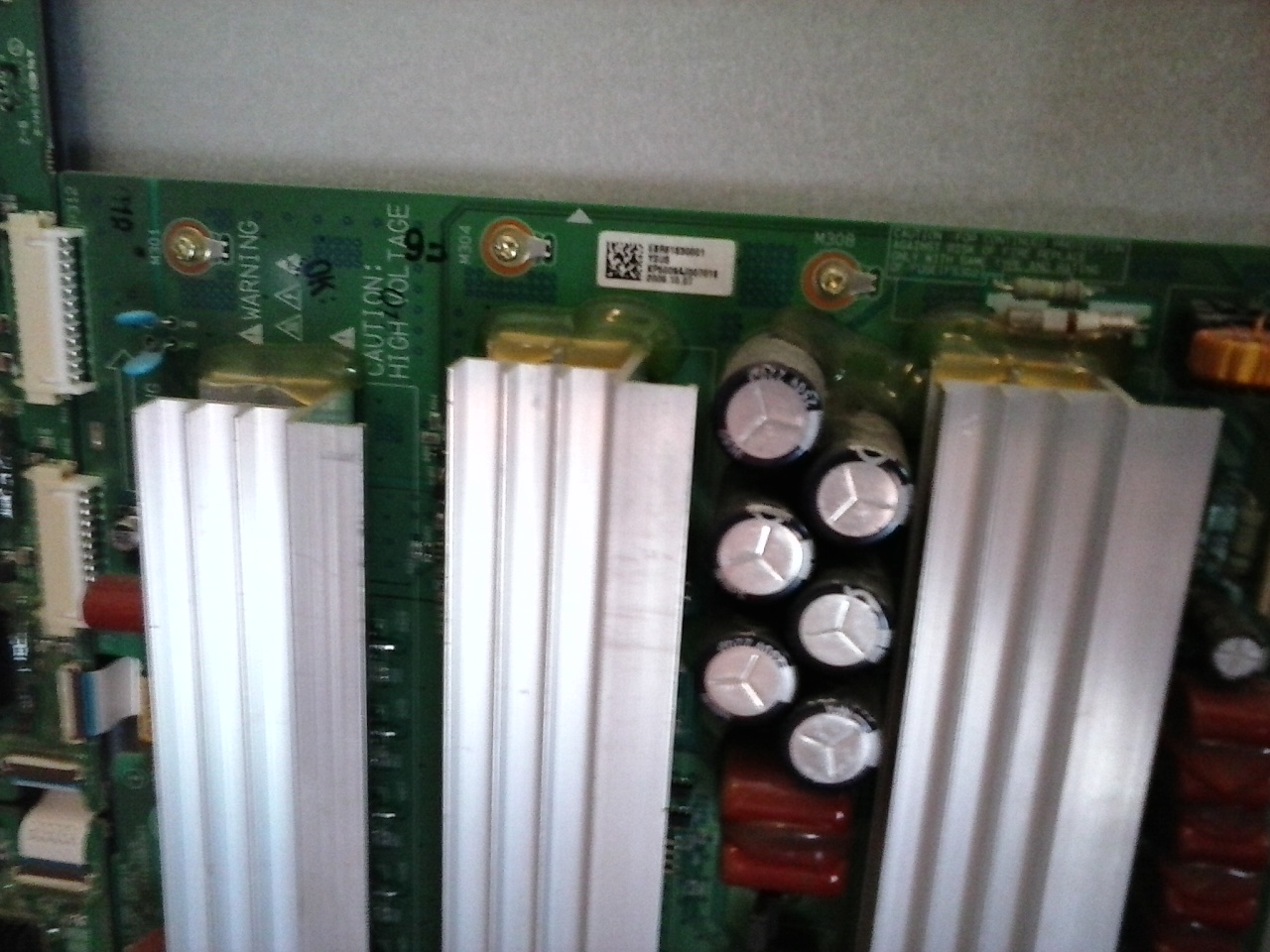

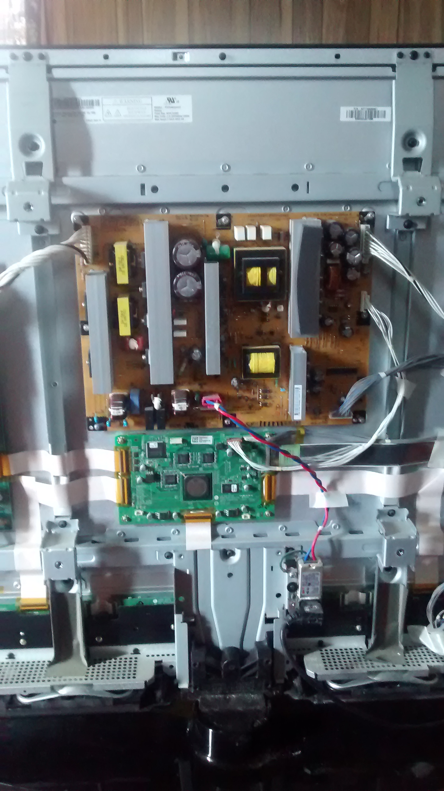

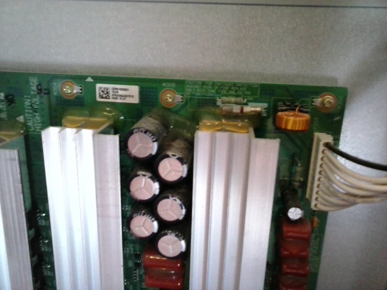

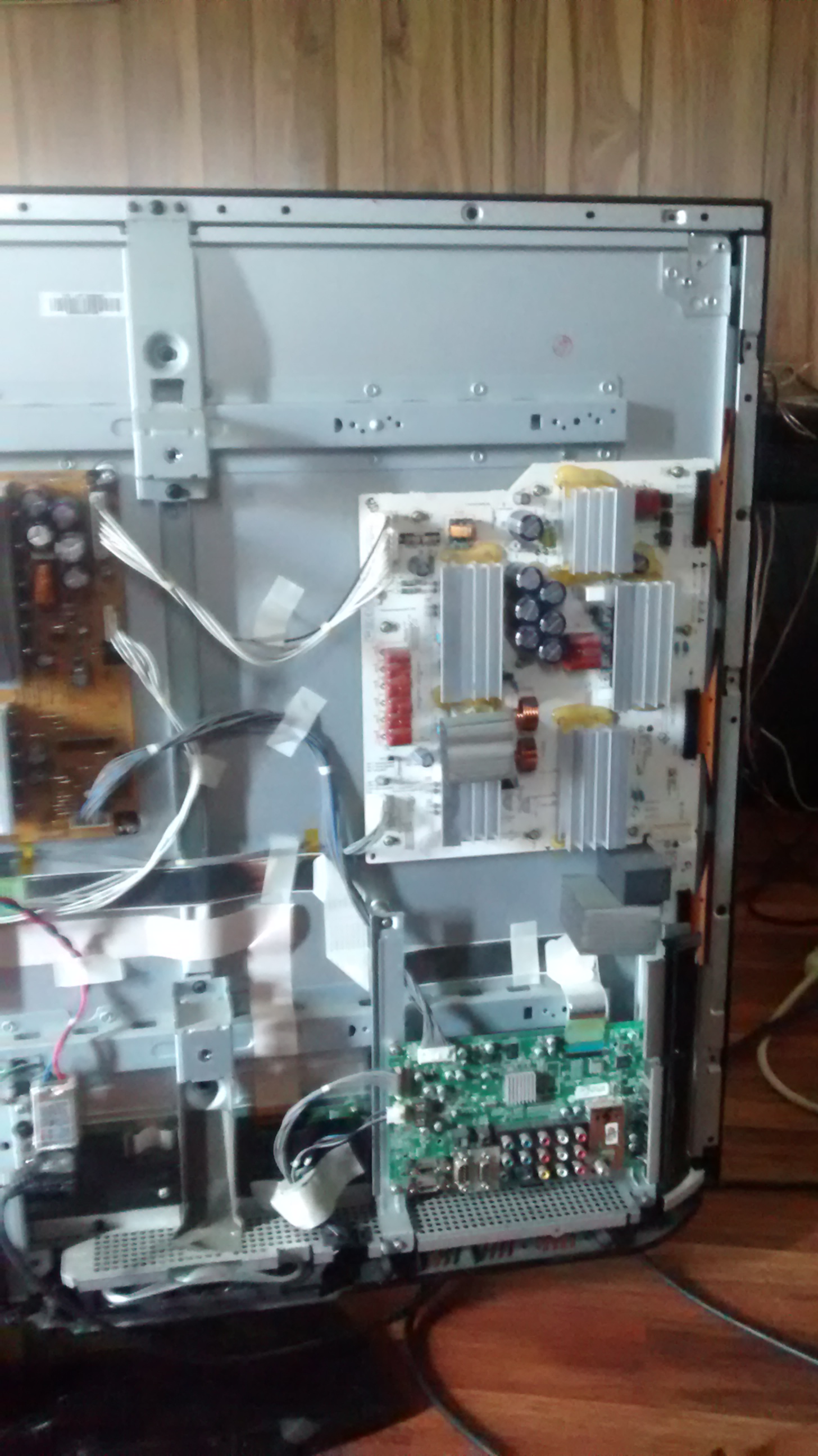

    Looks like summit amiss with the Y-SUS and the Buffer-boards depending on what Chassis that set uses.
    Remove the back and take pictures of all the boards inside, post here....

            I just checked the AC IN Connector (AC INPUT FILTER) that attaches to the Power Supply (SMPS) PWB board, and the red wire is reading 122 VAC, and the blue wire is reading 1.6 VAC, the label on the AC IN Connector says it should output approx. 240VAC.
            I hope I'm helping!

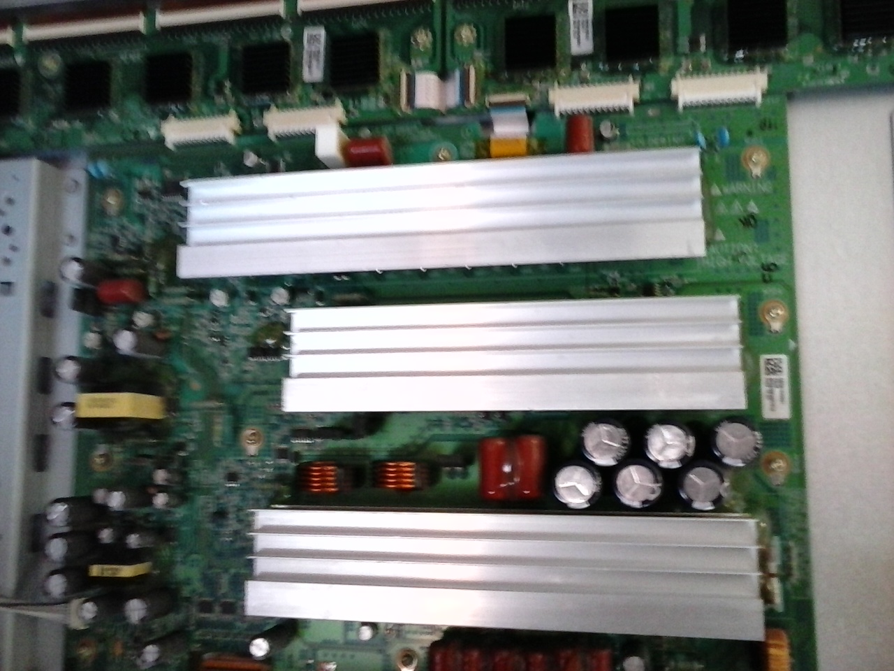

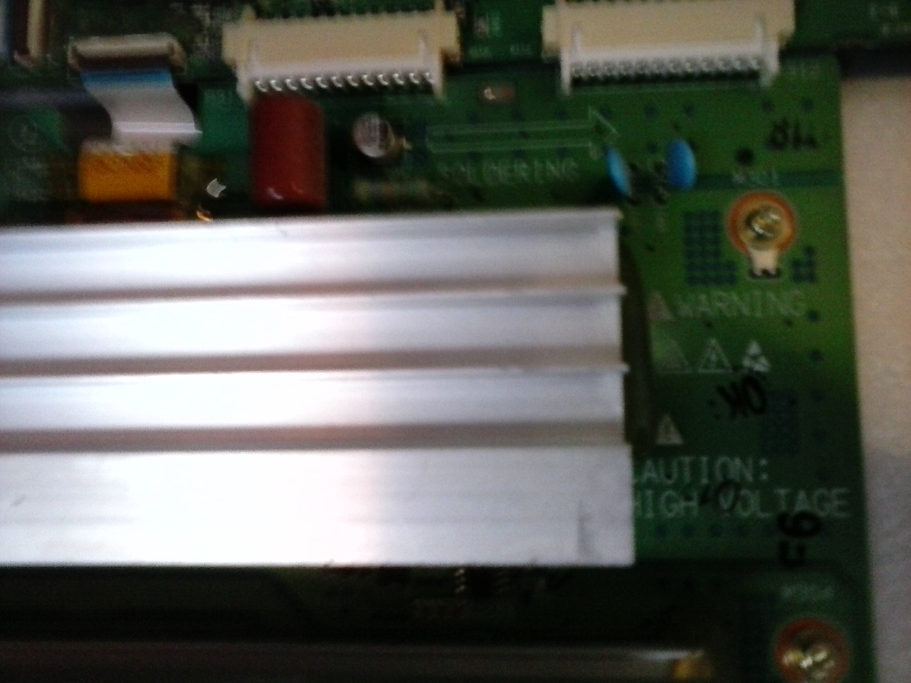

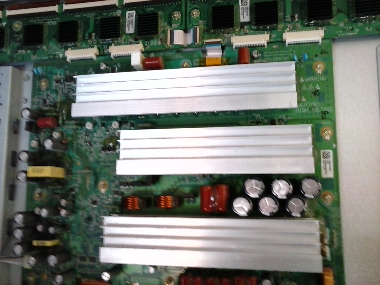

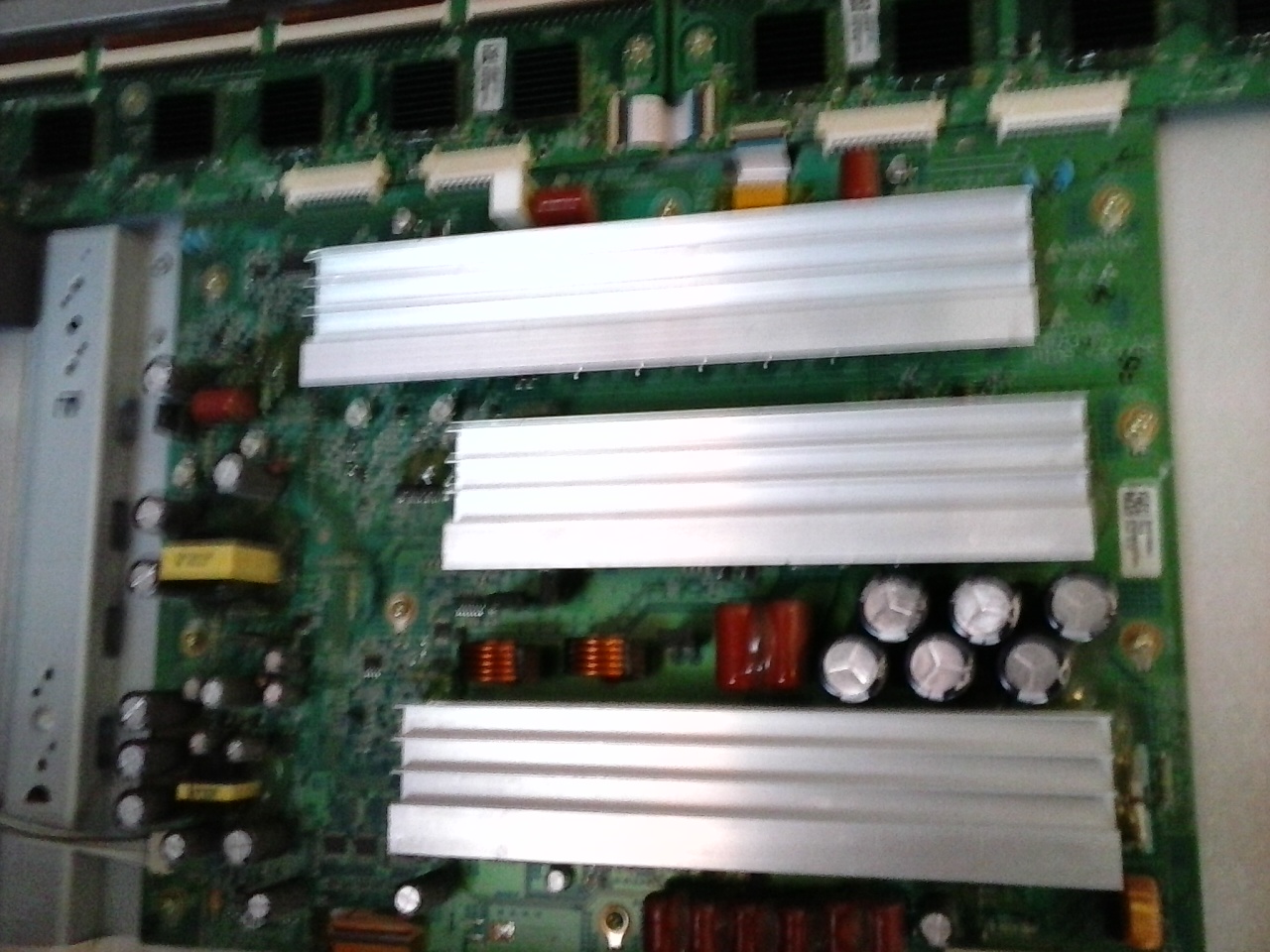

              We know the TV is receiving AC power or it would not work at all. So for now no need to test the AC filter.
              Let's focus on the large left-hand board right now. It's the Y-sustain (Y-sus) board and it's connected to a pair of Y-buffer boards, the Y-buffer top and Y-buffer bottom.
              https://www.badcaps.net/forum/attach...7&d=1426972439
              Try and get a clearer photo of the Y-sustain - we need to be able to see some of the finer detail on it if possible.

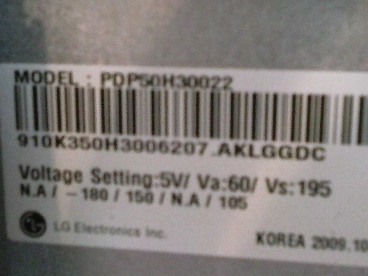

              At the top of the chassis there's a sticker listing a variety of voltages, and the panel model number. It'll be marked something like "LG Electronics PDP60H9###### Made in Mexico"... I *suspect* your set has a 50H3 panel, but I'm not sure, as I last worked on one of these over 3 months ago.
              Can you get a clear picture of this sticker?

                  Re: LG 50PS60 UA Plasma
                  You're going to yell at me because my camera has been found wanting in performance. BUT I did the next best thing. I took the pictures you requested, then wrote down all the data for you.
                  Thank you so much for having this information available.
                  The information on the chassis label is:
                  Model: PDP50H30022
                  910K35OH3006207.AKLGGDC
                  Voltage Setting: 5V/Va: 60/ Vs:195
                  N.A. - 180/150/N.A. 105
                  Korea 2009.10
                  Total Max Watt: 500W
                  Max Volt: 5.25V/68Va/198Vs
                  Max Amps: 7.5A/2.5A/2.5A
                  There's a part number stick on the Chassis that's separate:
                  AFT72909801
                  K5009A007455
                  The YSUS board has this sticker:
                  E8R818300001
                  YSUS
                  KP5009AJ007018
                  2009.10.07

                    We need to check the various voltages the set runs on. Voltages such as Vs, Va, -Vy VSC and VZ-Bias etc....
                    --These are the main voltages the panel itself needs to run correctly, I'm just guessing one is absent or very wrong, as you have a condition of severe 'Mal-Discharge'....
                    The Vs, Va are on the PSU, the VSC, and -Vy is on the Y-SUS and VZ-Bias will be on the Z-SUS....

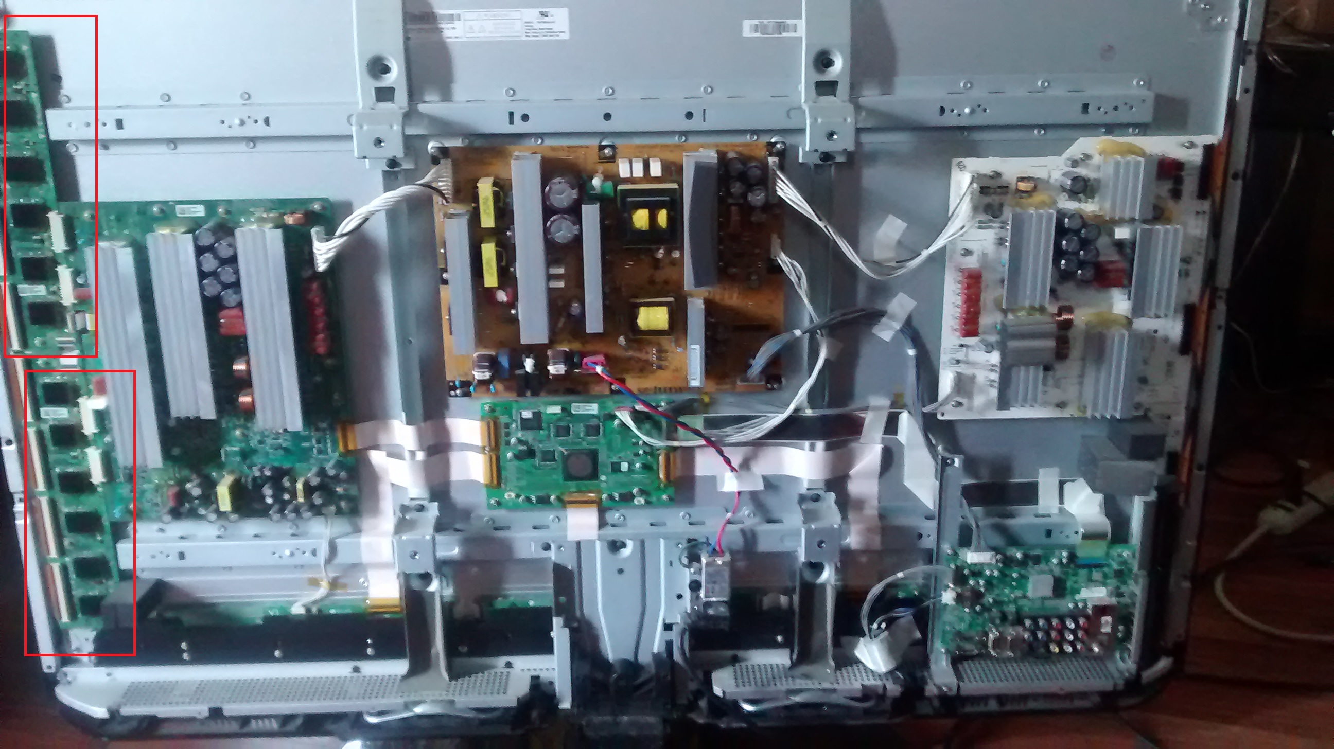

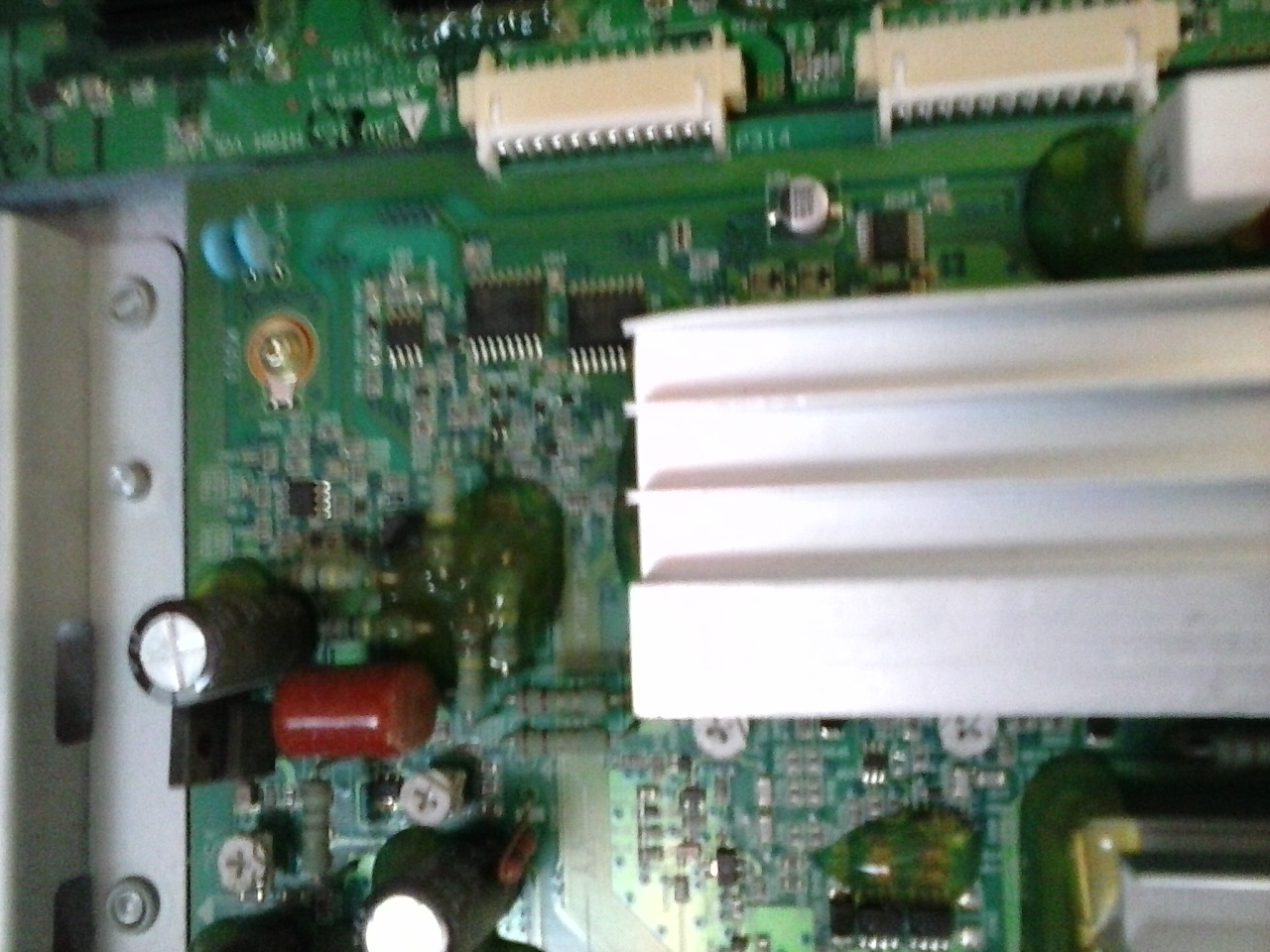

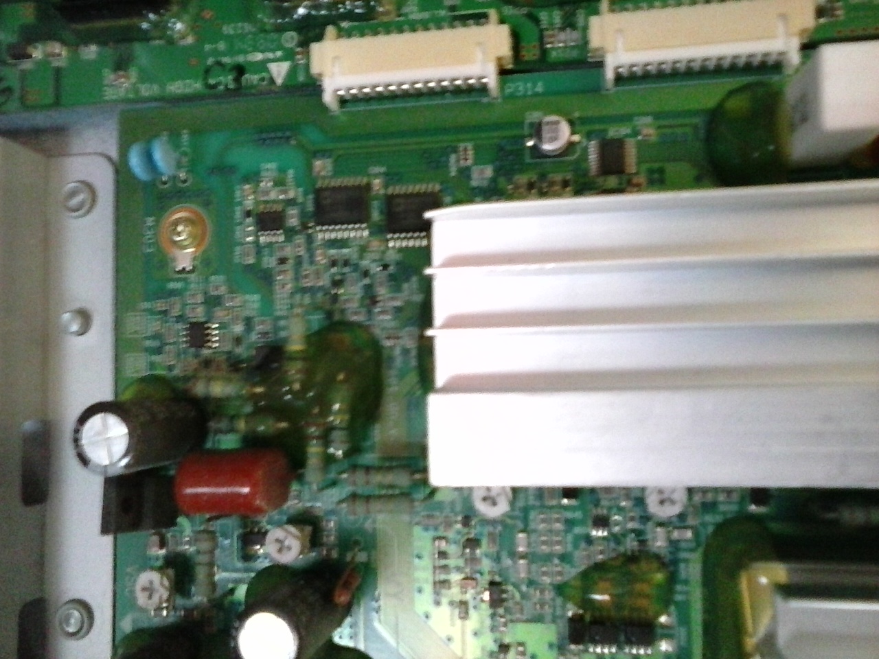

                                  Ok, I am suspecting bad Y-buffer boards. I've highlighted these boards - they'll probably be marked YDRVTP and YDRVBT or something like that.
                                  For this test, you should disconnect the buffer boards from the Y-sustain board. To do this, you'll first have to unscrew the boards and disconnect the link cable between the two boards, and the top board and Y-sustain. Then, gradually slide the boards left until they loosen.
                                  Leave the orange ribbons attached and connected to the board - they are not important for now. The ribbons are difficult to line up again so removing them should be avoided unless necessary. Simply fold each board over the chassis, being careful not to flex the ribbons too much, and tape them down to hold them out of place. The end result is the buffers should be connected to the plasma display panel itself via the orange ribbons but disconnected from everything else.
                                  Then power the set up. I'm not expecting anything on the screen but I'd like you to check -Vy and Vsc again. If the voltages measure close to what they should and if they are stable, start by reconnecting the TOP board. You'll have to connect the little ribbon cable between the top buffer and Y-sustain board. At this point you -may- get an image on the screen (it depends.) Please check -Vy and Vsc in this condition too.
                                  • If the voltages do not come back with the buffers disconnected your Y-sustain is bad.
                                  • If the voltages do come back with only the top connected your bottom buffer is bad.
                                  • If the voltages do come back with the buffers disconnected but go away when they are connected (which you tested previously), your top and possibly bottom buffer boards are bad.
                                  Don't connect the bottom board yet as it cannot be connected without the top being connected.
                                  The boards are pretty cheap (about $40 for the pair), so it's probably worth ordering both to fix this fault if they are determined to be faulty.

                                        Are you measuring -Vy/Vsc across those resistors directly? i.e. red probe one end black the other?
