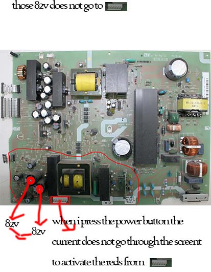

    Hello am trying to fix this sharp LC46XD1E it have the problem of motherboard of PSC10189dm PKG1 which does not release the current to the screen and the lights does not light up. Am not able to upload the picture because am new on this forum but if you know something plz reply thank you.

          When you connect the circuit the relay will pup without stooping and then the current Which goes to the red of the screen will not start, is there any replacement tools needed for this board so that the current goes to the screen?

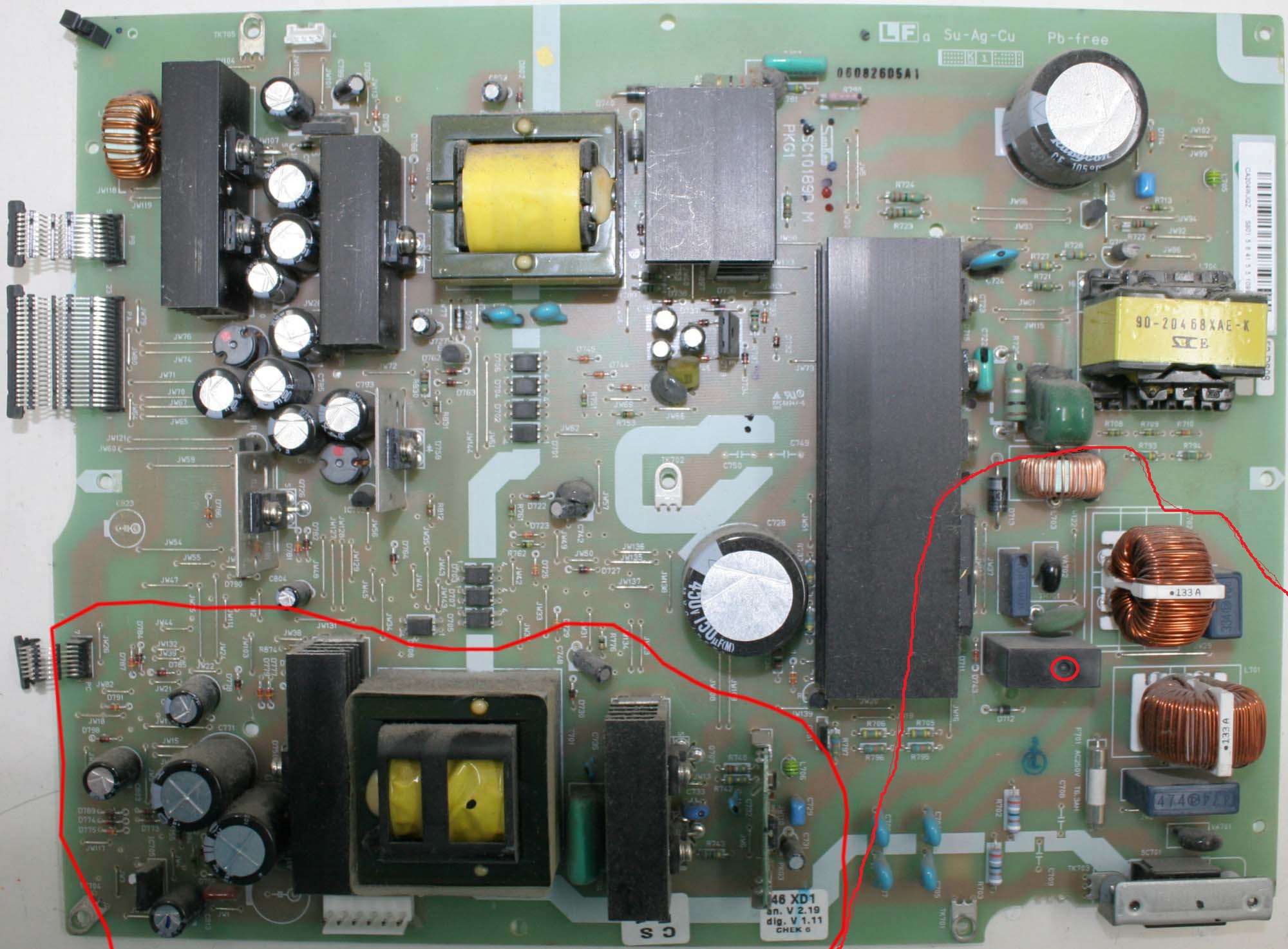

              Yes I've tried Alastair's solution but unfortunately the sharp does not turn up. on check the attached picture that i took, I think the problem is with the board if you check the picture above that i have uploaded you will see the area with the red lines are the one having problems

                There could be many reasons why this is not working.
                You need to do things methodically. Check that PSU board where the leads go to the Mainboard.
                One or two of those leads will be marked, 5V
                Is that 5V present?
                The Mainboard makes the PSU Turn On,--But only if the ever present 5V is actually supplied to the Mainboard in the first place!
                I can make NO sense of your picture or the 82V you speak of.....

                  Yes the 5 volts are present but the problem is with those 2 capacitor marked with "red circles on the picture" 1 capacitor have 100v but when they are active they releasing only 82v!
                    Re: LC46XD1E repair
                    That is only a voltage rating that the component is designed to withstand. Theyc can use put less than 100V across them.
