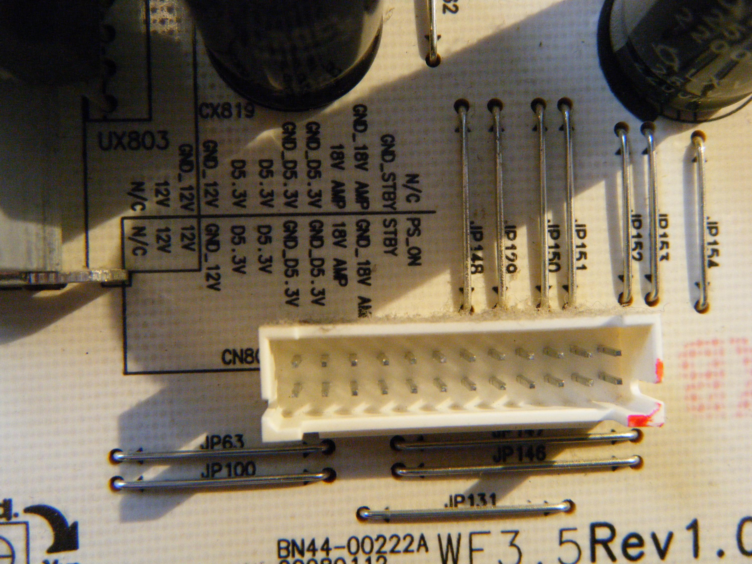

    Hi Guys,
    Sorry I am a little confused, I have attached a close up pic of the connector on the PSU. I measured the voltages on the bottom right pin, looking at the markings close to the connector that pin is PS_ON. Which pin should I be checking?

      Hi Guys,
      Have I taken the picture of the correct connector?
      • PowerAmpFreak
        • 982
        • Sweden
        Re: Samsung PS50A656T1F clicking
        Looks right.
        Easily verified checking neighbour pin should carry standbyvoltage (+5V)
          Hi Andy check the pin next to ps-on the stby you should have 5v/5.3. To check the supply is working you can test as follows. if you pull all the plugs from the board but leave the mains in connected , then check stby pin for 5v, if that is there put the ps-on pin to ground (I solder a lead to next socket to the left of this one ,on the under side of the ps-on pin, and put a crocodile clip on the other end to clip to ground)the relay should now click in, you will now see the smaller voltages come up on the board , if this is working then you need to make the Vs-on high (stby 5v though a 500-1K ohm resistor to Vs-on pin) this will bring in the high volt Vs/Va that can be read on the test points. Hope this is of help Flocko

                                  OK with only the mains coming into the PSU and nothing else connected on CN801 I have:
                                  PS/ON 4.55V (right hand pin on bottom row of connector CN801)
                                  STBY 5.24V ( second pin in from bottom right hand of bottom row of CN801)
