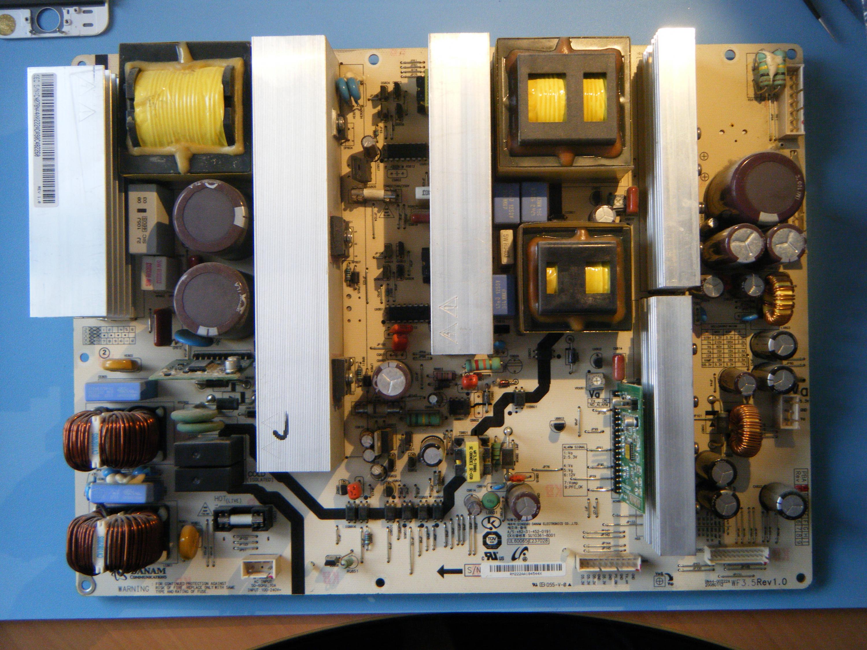

    Hi Guys,
    Just taken in a Samsung PS50A656T1F, you give it power and you hear the PSU click to switch on, most of the time it does not come on and occasionally it does switch on and you can watch it.
    I have just been trying it and it has switched on 5 times no problem, I cannot see an bulging or leaking caps on the PSU.
    Any ideas

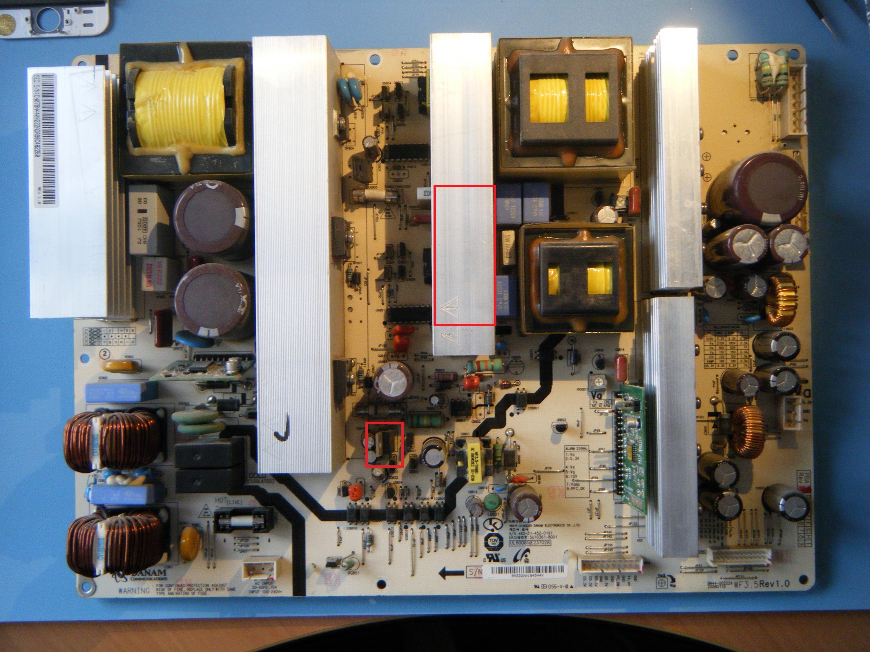

    Check if PSU has 7815 regulator (common fault solder joints)
    Also, check the two TO220 transistors (on the primary side in the smaller of the two LLC converters) on the heatsink for bad solder (veeery common)
    It's little hard to see, which PSU it is, but I think it's the one.

      Hi, Thank you for the info, please see pic of the PSU, can you please help with the location of the components you mentioned.
      The PSU number is BN44-00222A, 20080112, WF3.5 REV1.0
      Thank you

        See areas within red boxes

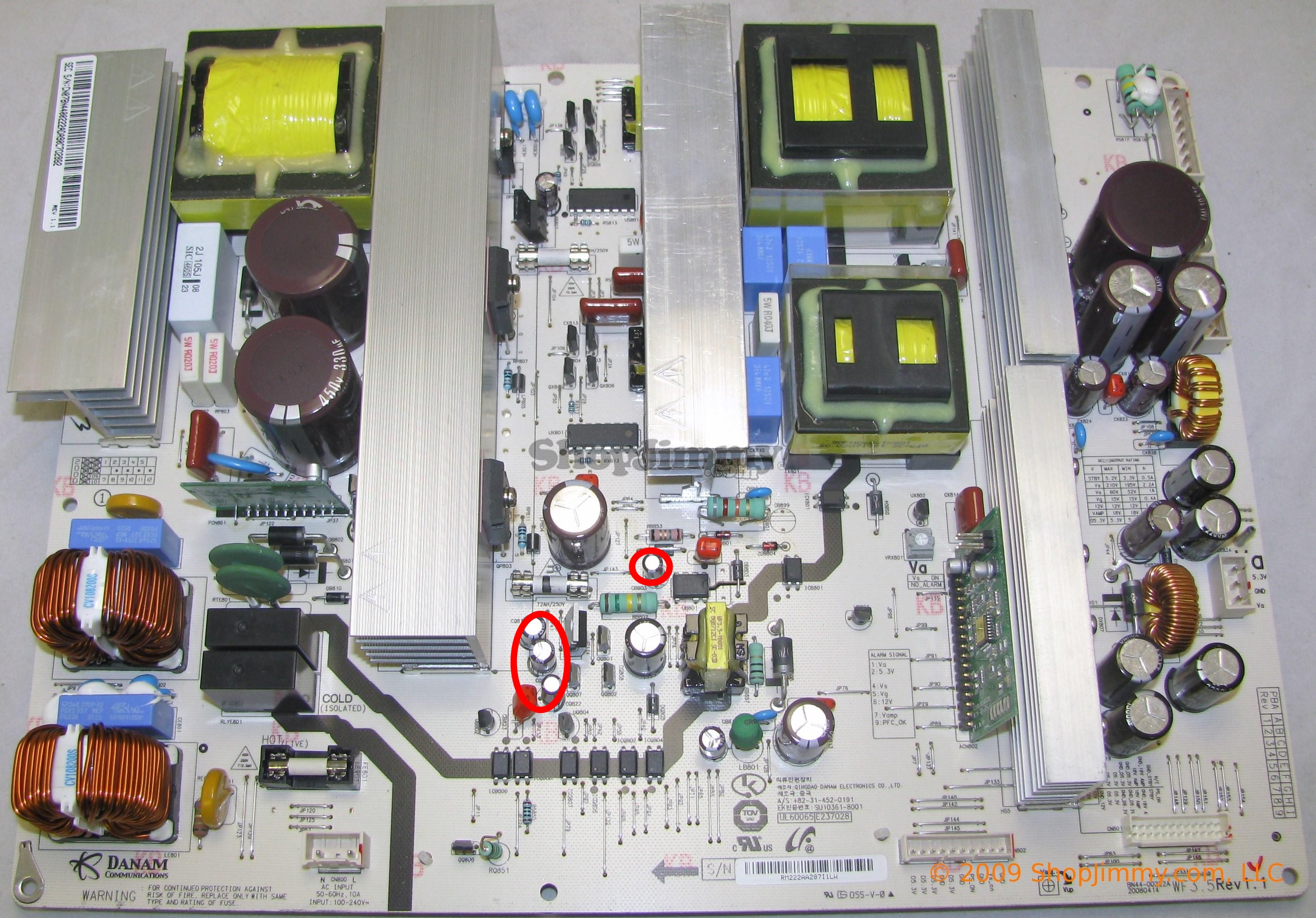

                          Re: Samsung PS50A656T1F clicking
                          Are you saying the 5V STBY is going up and down?
                          You should check the two small startup-running, filter caps (4 small LYTICS caps) next to that TO-220 Power MOSFET (in red box) for that standby power supply.
                          And do not touch any heat sinks since some of then will be have line voltage on it.

                                Hi BUDM, How do I measure the caps as you cannot get to the legs as under the PCB?
                                  You need to remove the caps and check the capacitance and the ESR.
                                  Try heating that area with hair dryer to see if the 5VSTBY becomes stable, it it does then I would just replace the caps.
