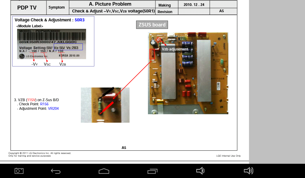

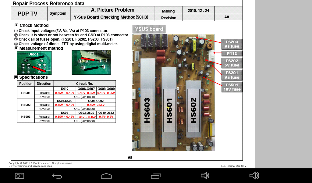

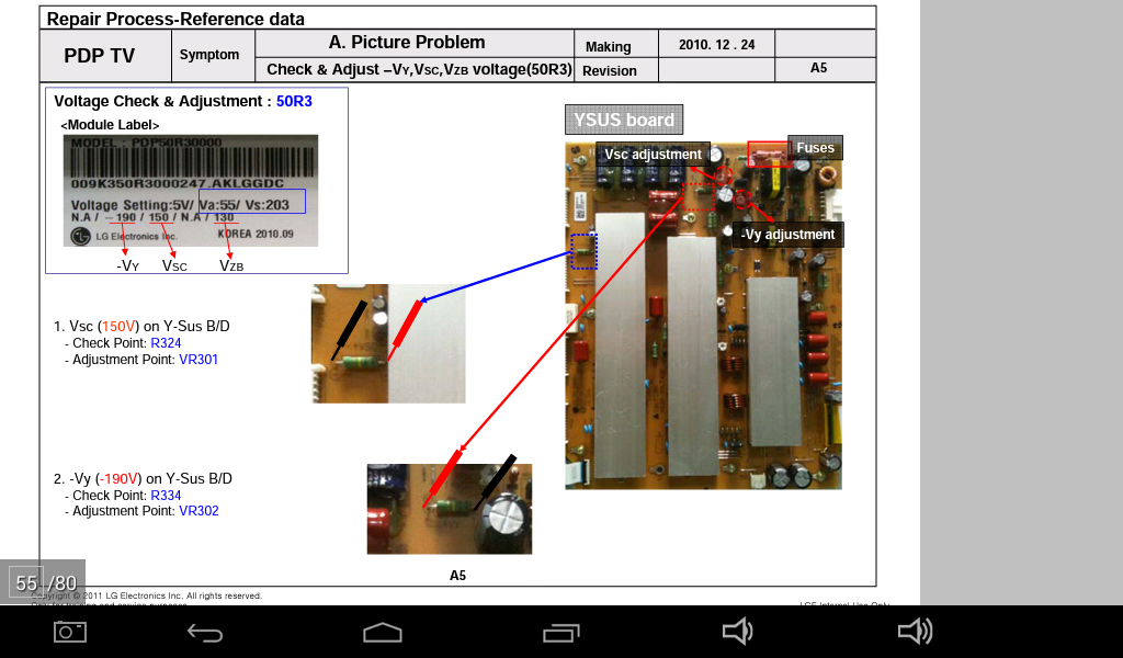

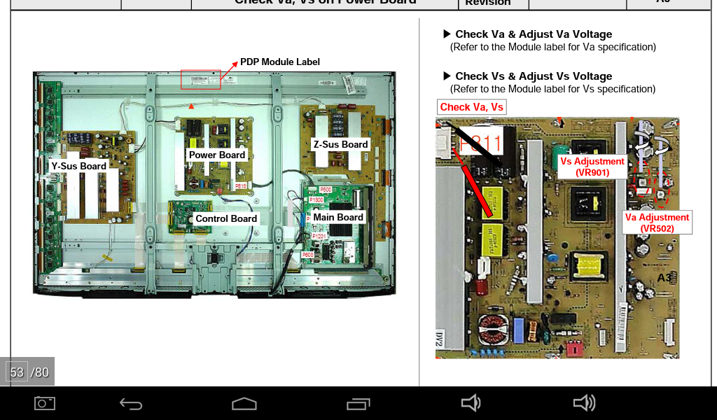

        Re: Lg 50pz570t (correction)
        My apologies for not getting back to you sooner but here are some pics from the manual hoping they will be of help ...thanks

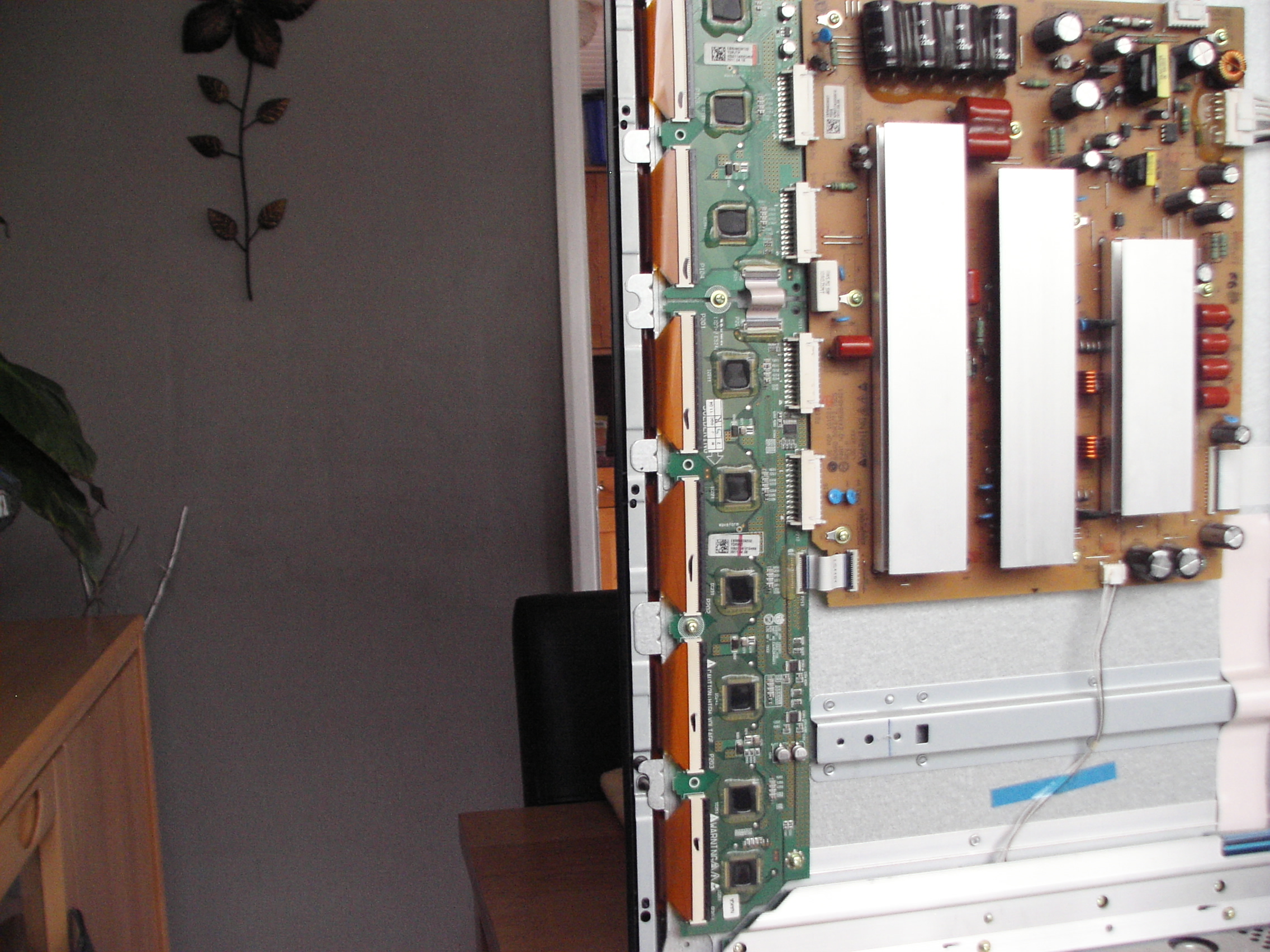

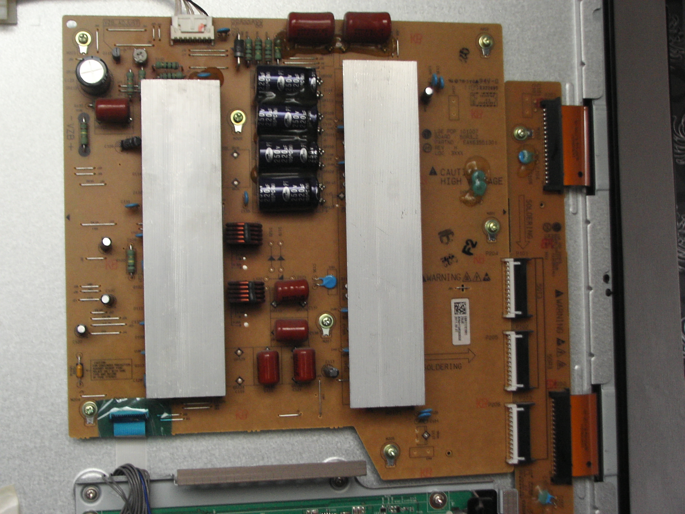

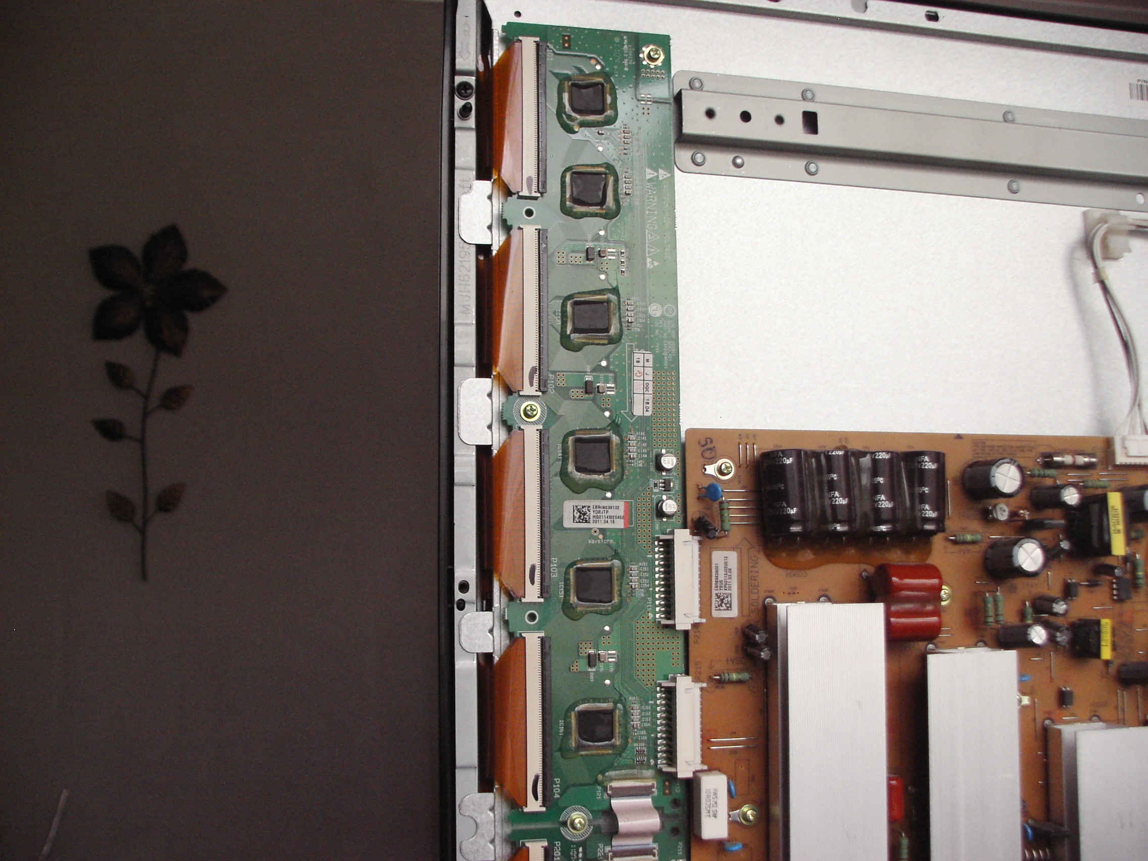

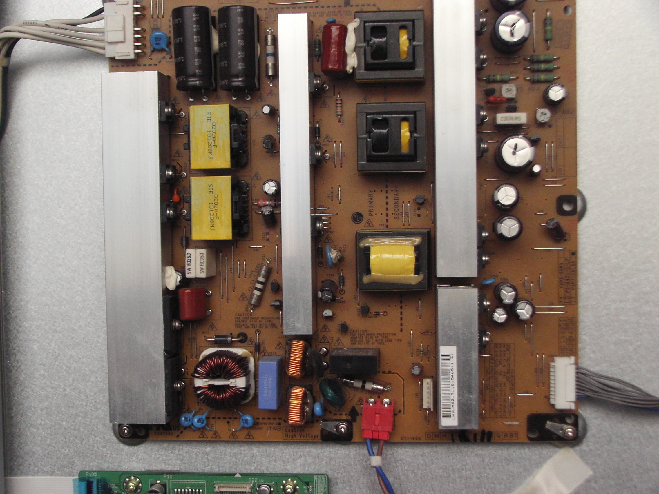

          Re: Lg 50pz560t
          Can you not supply pictures of your boards? The reason is, we can see some signs of damage/overheating, and sometimes manufacturers change boards mid-production.

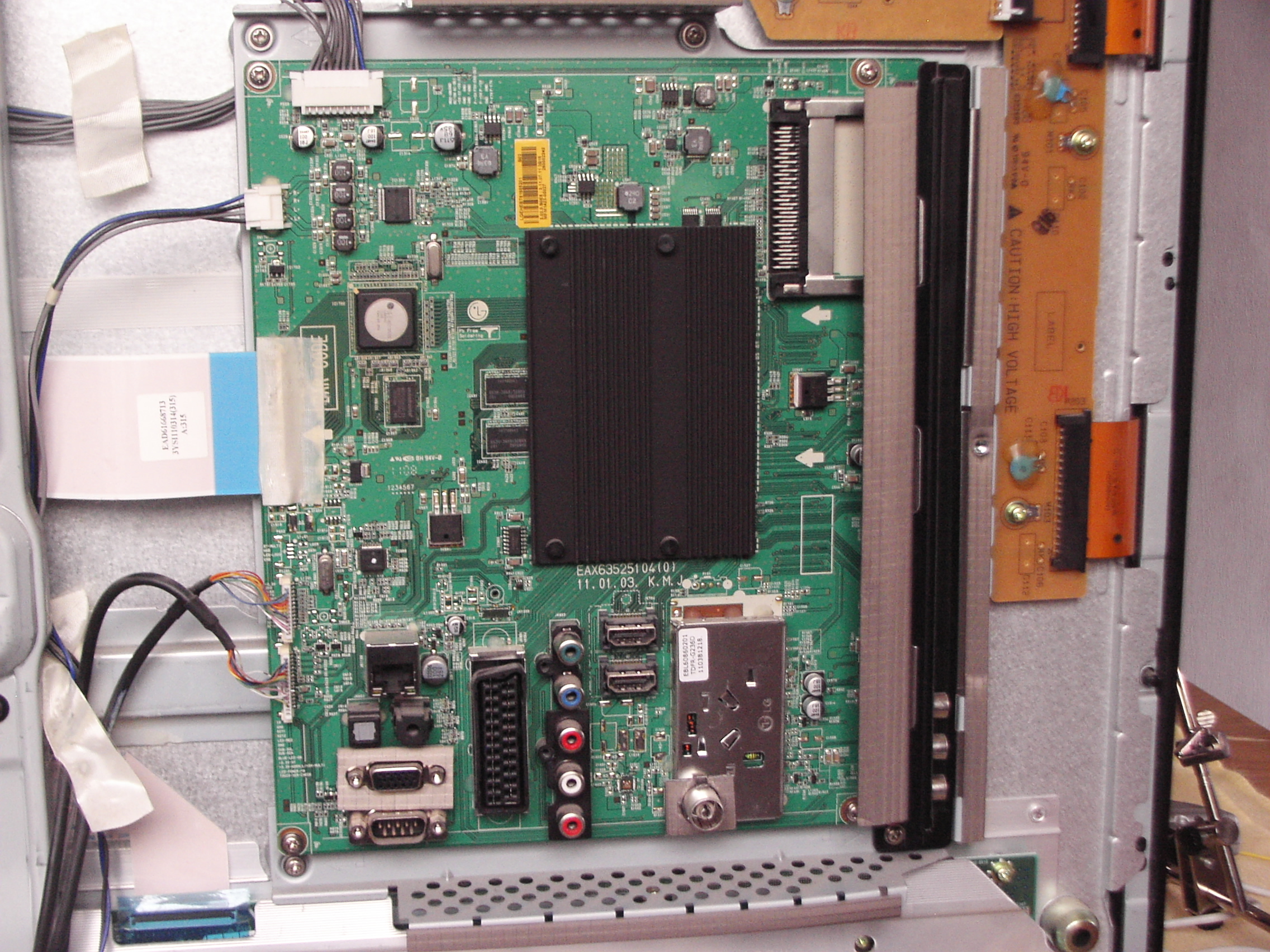

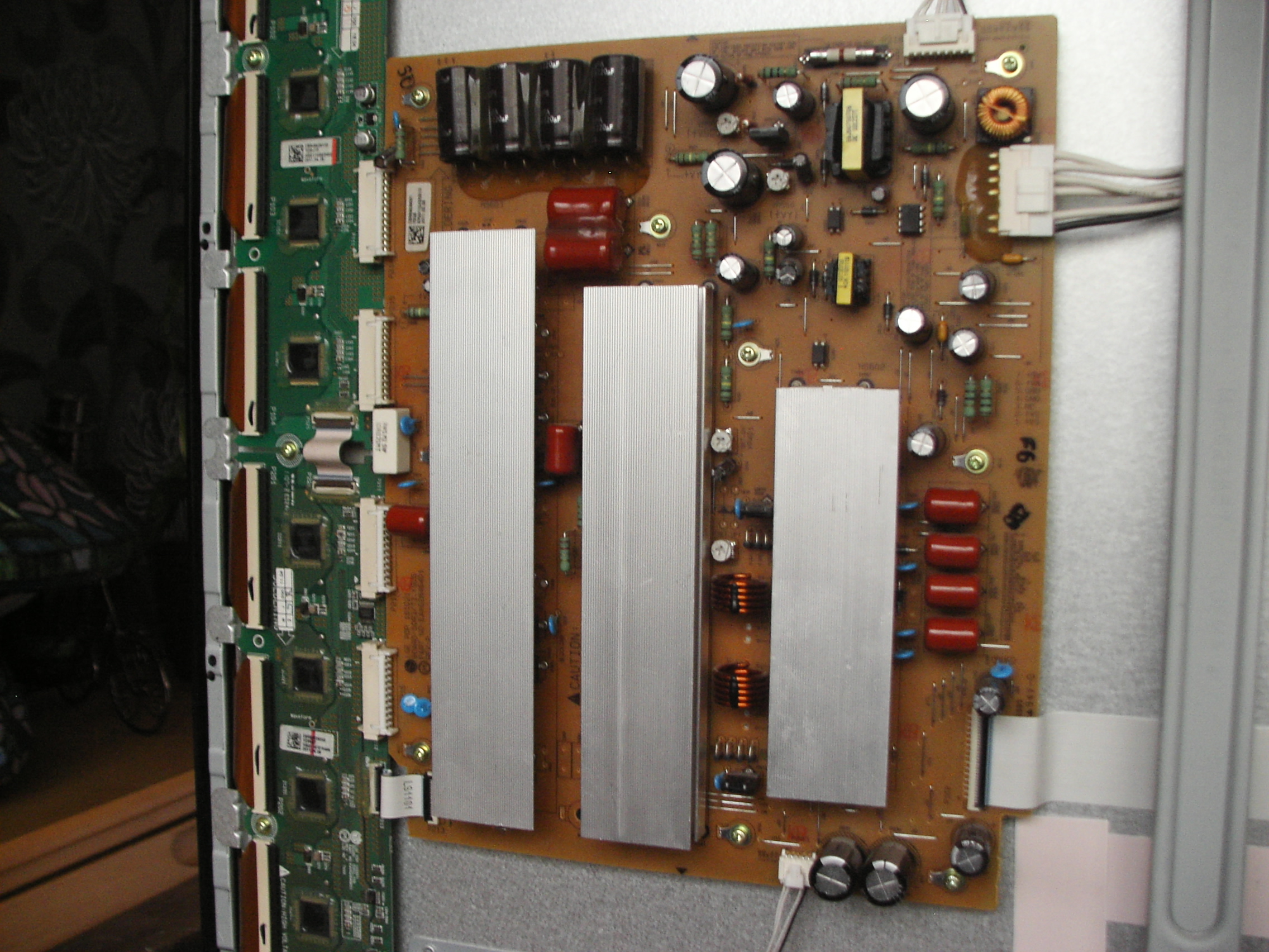

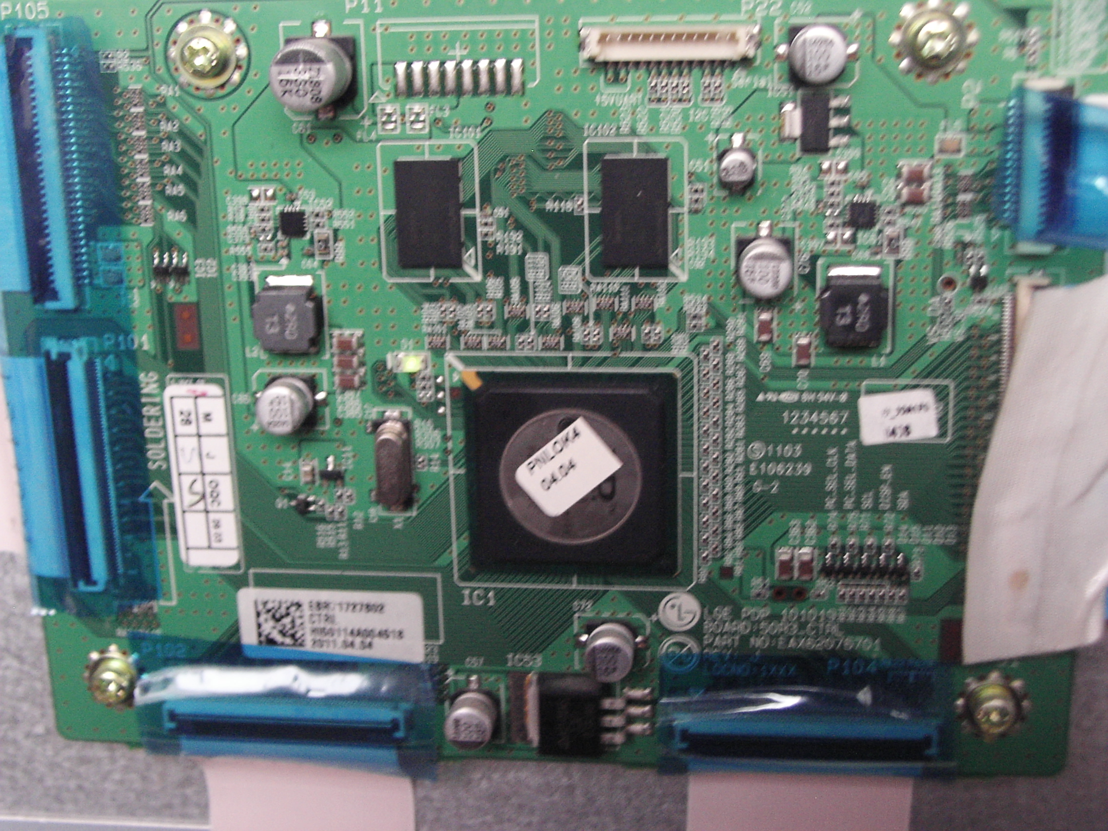

              Re: Lg 50pz560t
              These are the best pics I can get. If you require the rear of the boards I will have to strip them down later. The green led on the control board flashes but doesn't seem to follow a set pattern. As I said previous all the voltages on each board tally with the manual.

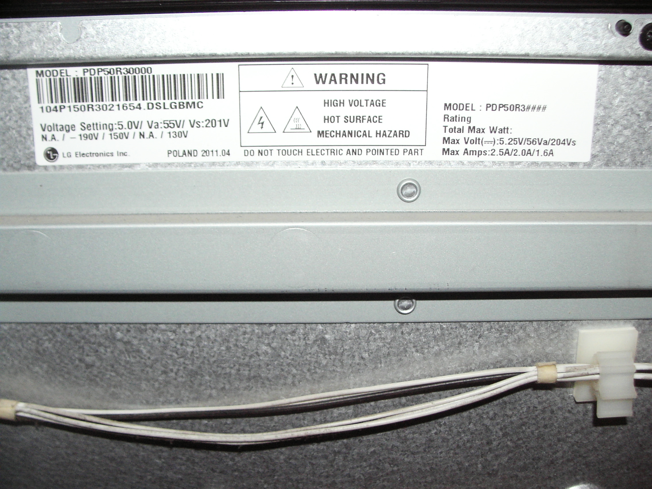

                Re: Lg 50pz560t
                Can you get a picture of the sticker that has the internal plasma panel model number on it, e.g. "PDP50L9#####", will be marked, e.g. "LG Electronics Made in Poland". Note, this is NOT the back label with "50PZ560T" on it...

                  Re: Lg 50pz560t
                  Thanks for your patience Tom. Here's the picture of the panel label.
                    Re: Lg 50pz560t
                    Ok, see page 139-149.
                    Follow steps on pg 143 & 148 to measure -Vy, Vsc and Vzbias.
                    DO NOT ADJUST ANYTHING YET. You do not need to use white wash as set is non functional and we just need a quick reading.
                    • bevaloid
                      • Mar 2015
                      • 13
                      • England
                      Re: Lg 50pz560t
                      The vsc reads 149.8, the vzb 124.9 and the vy 190.2v minus in reverse
                        Re: Lg 50pz560t
                        Make the room as dark as possible (curtains closed, ligths off) - any glow from the screen, even slightly?

                            Re: Lg 50pz560t
                            This board: https://www.badcaps.net/forum/attach...9&d=1426254676
                            There are two holes next to R54, R53, place a wire jumper between them and disconnect right most ribbon cable going to the main board.
                            Plug the set in.... what happens, any test patterns, display light, etc?

                              Re: Lg 50pz560t
                              White, red, green, blue, grey then half screen horizontally moves across then vertically.
                                Re: Lg 50pz560t
                                Good, provided screens look OK then main board is bad. Sigh, another bad LG plasma main board.
                                (This is the board with HDMI inputs, etc. on it.)
