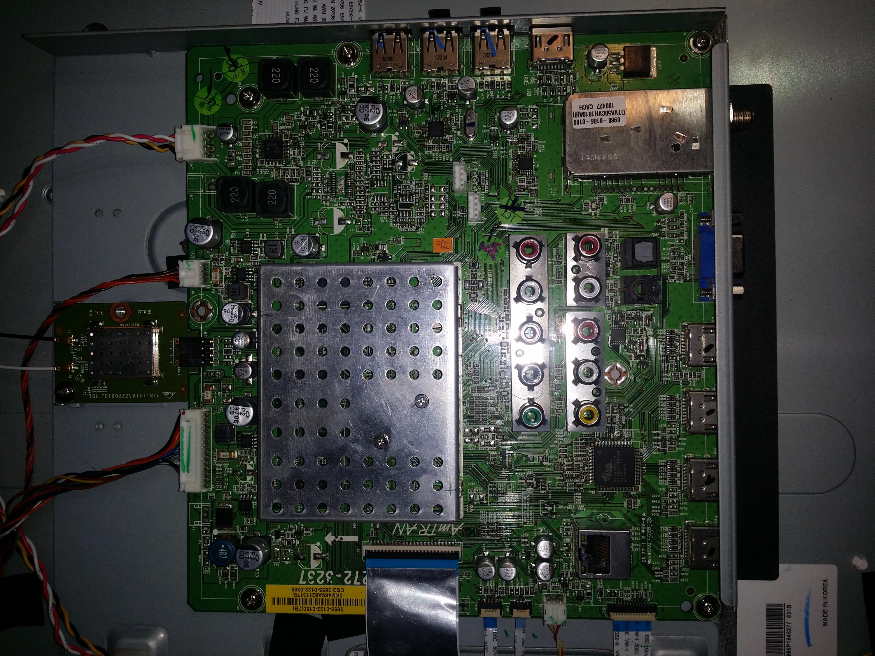

    The tv vizio xvt553sv appears to be getting stand by power because the vizio light is on. It will not respond to the remote or the power button.
    I have reviewed some the threads for the same model so I tested power on the mainboard fuses and got the following results.
    F1 = 5.5v
    F3 = -3.1v
    F8 = 11.3v
    Not sure what to do next.
