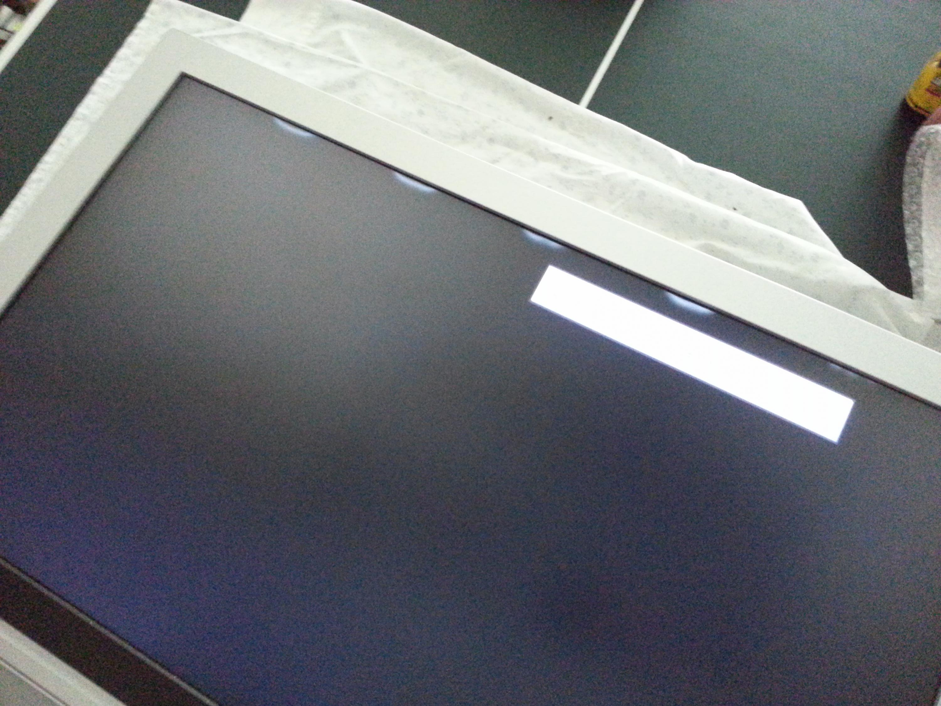

              There is one other question I have though. After the unit has been on for a short period of time, five bright spots begin to appear at the very top of the screen and eventually become more pronounced after a couple of minutes. They are most obvious when the screen is dark. I know this thing was sitting in the previous owner's garage on the floor (resting with all its weight on its speakers ) for quite some time (possibly over cold winters) before I got it and it may have been improperly handled at some point.
              Any ideas as to what could have caused this or if there's anything that can be done about it? Do I risk damaging it further by leaving it on?
