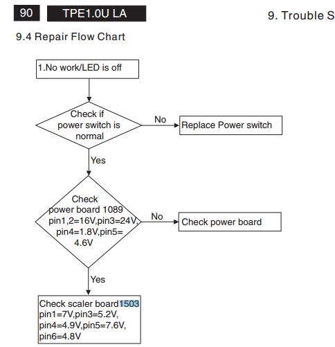

      Test results
      Sounds like the 5V STBY is there. You have a DMM to check voltages?
      How it works: 5V STBY is always on at the PSU. That goes to the main board. Once you press the power button it will send the PSon signal back to the PSU, turning on all of the voltage rails. If you can verify that you got 5V STBY and nothing on the PSon pin (both on the PSU), then you can "force" the PSU on without the mainboard and verify all voltage rails. At that point you know if the main board or the PSU is bad.
      I went ahead and downloaded a copy of the service guide and was unable to find how to test the PSOn signal, but I did find a little chart with (poorly translated, but workable) suggestions on how to troubleshoot no power situations, highlighted in the picture. I found that while the voltages for pins 1-3 on the 1089 look okay, the voltages for 4 and 5 (which are supposed to be 1.8 and 4.6 volt) are registering little to no voltage. Does this mean I'm stuck with having to buy a whole new power supply or are there some other tests or repairs that can be done?

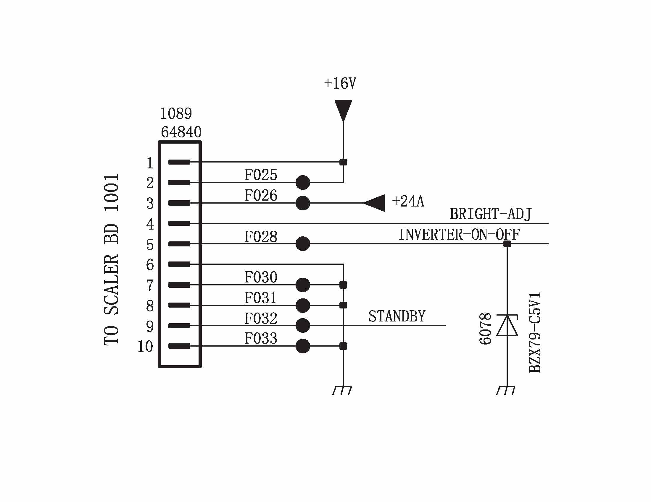

            can you see a pin out on that connector?

              Pin
              On the board itself?

                Re: Magnavox 42MF531D/37 - no power
                yes... I can't see any... I am on my tablet....

                  A closer look
                  I can't either. I don't think there is one printed directly on the board. I only see pin numbers.
                    That is a bummer. Can't tell what pin does what, in order to force the power supply on. So all we can do is having a WAG at it or trace. Can you check the plug that goes from the PSU to the main board and verify that there is 5V? If there is 5V, and there is no reaction at all from the TV while pressing the on button, I would put my moneys on to the main board.
                      Power supply pin out.

                        Supply
                        So, pin5 would be the PSOn pin I need to trigger to force the power supply on?

                          Clarification request
                          Would I just short that pin 5 to ground momentarily then or would that be going about it the wrong way?
                            Err--No.
                            Way I do it is this--
                            Check if the mainboard (M.B.) is turning the PSU on by monitoring the Voltage at the PS-On pin of the PSU while the On button is pressed....
                            --Normally it should go from 0V (or thereabouts) to around 3-5V. so its PSU Active High. (Some Plasma sets use 'Active Low' for one/some of their functions ie, there's 5V when the PSU is 'Off' and grounding the PS-On/Vs-On brings the supply on, LCD is nearly Always Active High however)
                            IF there is NO change in the PS-On voltage--Then the M.B. Isnt Turning the PSU on. This could be a faulty M.B. or faulty PSU.
                            Check that the M.B. is getting 5V supply from the PSU, this should be present whenever the mains is connected and the vacation-switch, (If Fitted) is On. IF there is 5V supply to M.B. and no PS-On when button pressed, then M.B. is Likely faulty.....
                              Pin 9 (STANDBY) is the same as PS-ON.
                              I do not remember if this pin is ACTIVE HIGH (>2.5v = ON), or ACTIVE LOW (<1V = ON).
                              So check that pin 9 to see if it changes state or not when TV is turned on and off.
                              PIN5 is the INVERTER ON/OFF PIN which is the same as BL-ON.
