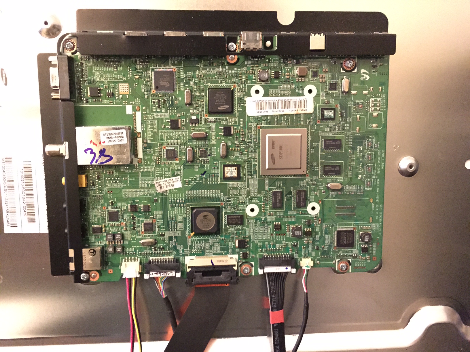

    Hello all! I'm glad to be apart of the group! I hope someone out there can help shed some light on an issue i'm having.
    I have a samsung un55d6900 that is not coming on. It will just click multiple times trying.
    Here is what I've tired so far:
    I've swapped out the power board with the same results, i've seen others say this fixes it but it doesn't for me.
    I've unplugged the cable going to the main board and it DOES power up the backlight only.
    Other than this i'm not sure what to do next, I would hate to buy another part just in trying to make it work.
    I thank you all in advance for your help with this.

    Posting pictures of the back of your tv showing the boards with clear pictures may help you more with fixing your problem

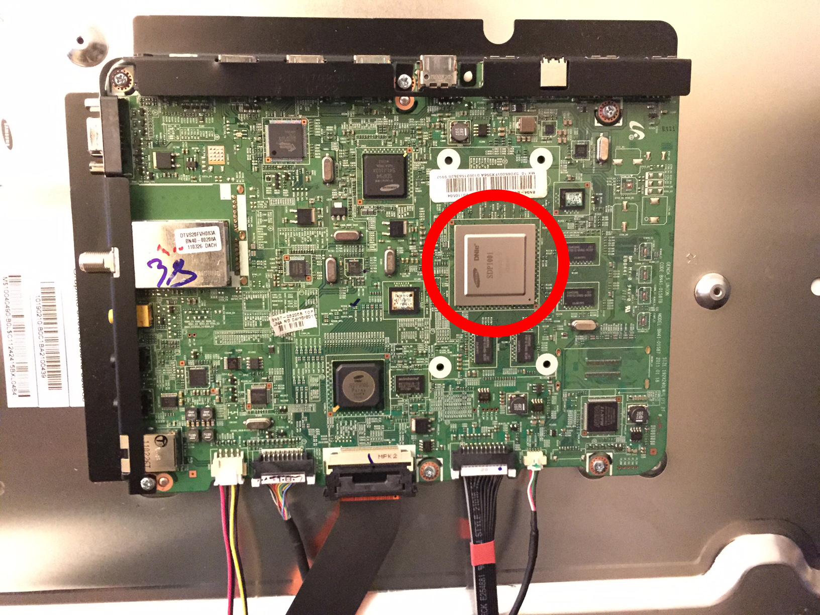

              He's already replaced the PSU and both fire the backlights when the ps-main cable is disconnected. That tells me the led's are working.
              Try putting a hair dryer all over the main board for about 30 seconds and see if the set comes on or if the symptoms change at all. Concentrate the heat on the main processor of the main board if general heating doesn't change anything.

                          Re: Samsung LCD TV clicking
                          Hello All! Thank you for your help. In the attachments I've tried to heat up the part circled in red with a heat gun. It did not come on just kept clicking the whole time. Let me know if this is what was suggested or am i mistaken.
                          Thanks,
                          Duane
                          • mmartell
                            • Oct 2013
                            • 3189
                            Yes that is correct. Try warming the whole board now and don't be afraid to use the dryer it will not harm the board. At least thirty seconds on full heat.
                            If you have a can of air you can turn it upside down and spray it on the same chip (after it gets back to room temp!) and this will cool the chip down. We are simply trying to see if you have an intermittent or bad solder connection.
                              I know it's been a bit but finally had a chance to get back to this. I have done what you suggested on warming the whole board with a heat gun with no improvement, the TV clicks away. Would replacing the main board be the fix that I need?
