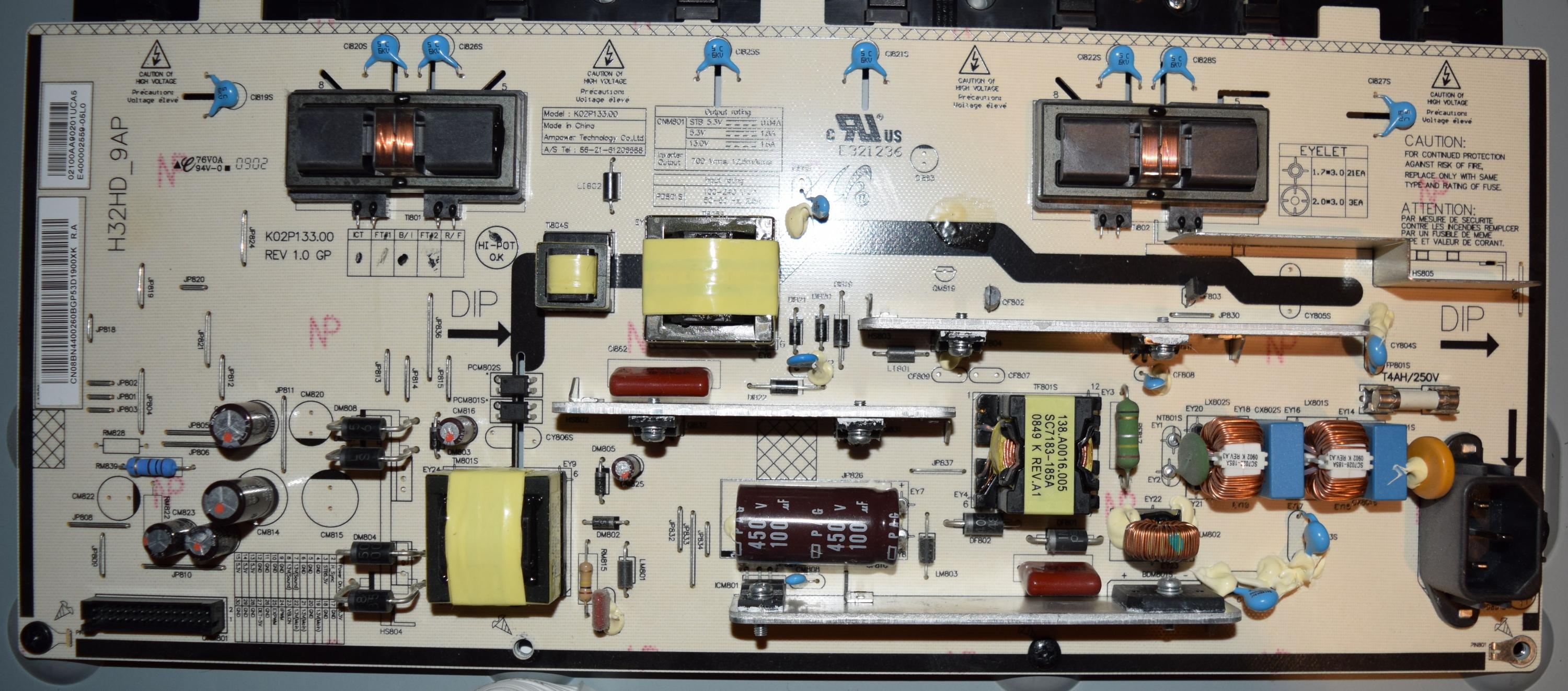

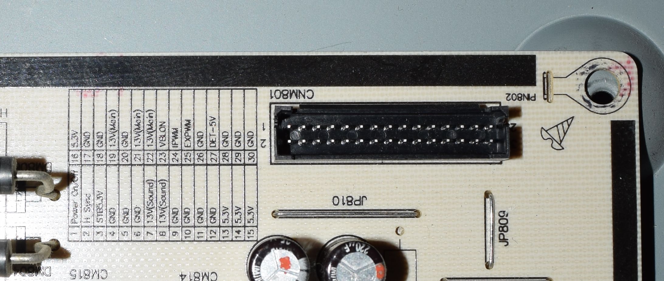

So I picked up this TV today thinking it would be a simple cap issue, but to my surprise when I opened it up all the caps looked fine. I busted out the multimeter and checked some of the pins at the top of the board for voltage and some of them read correctly but the bottom 3 (pins 13, 14 and 15) which should read 5.3v are reading nothing. Can you help me figure this out?

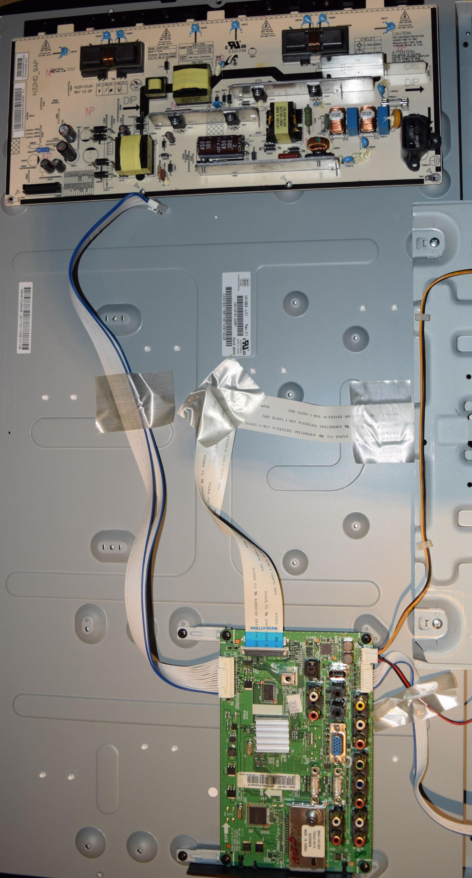

Also when unplugged from the main board the backlight comes on. When everything is normally plugged in the red light in front blinks and nothing else happens.

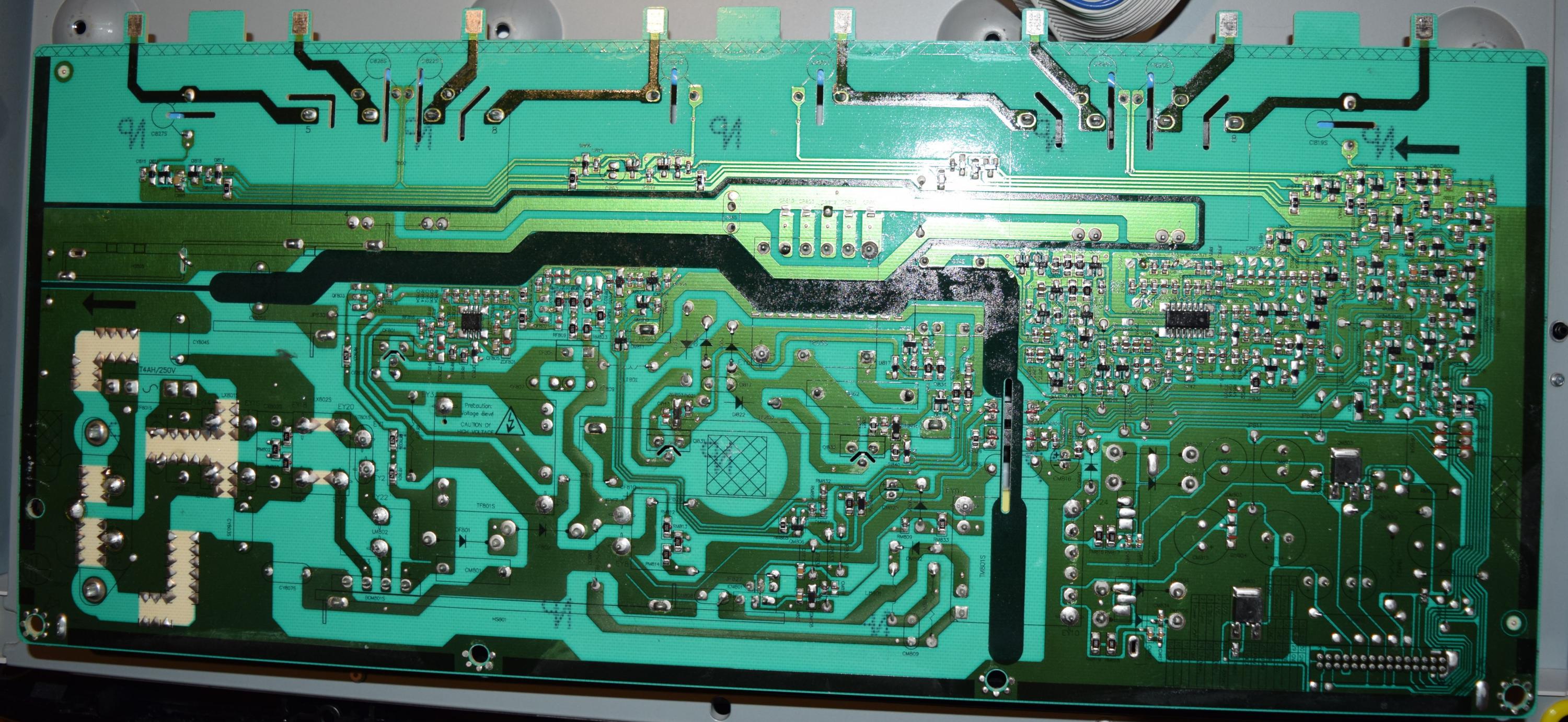

Here are super high res pics to help you out
