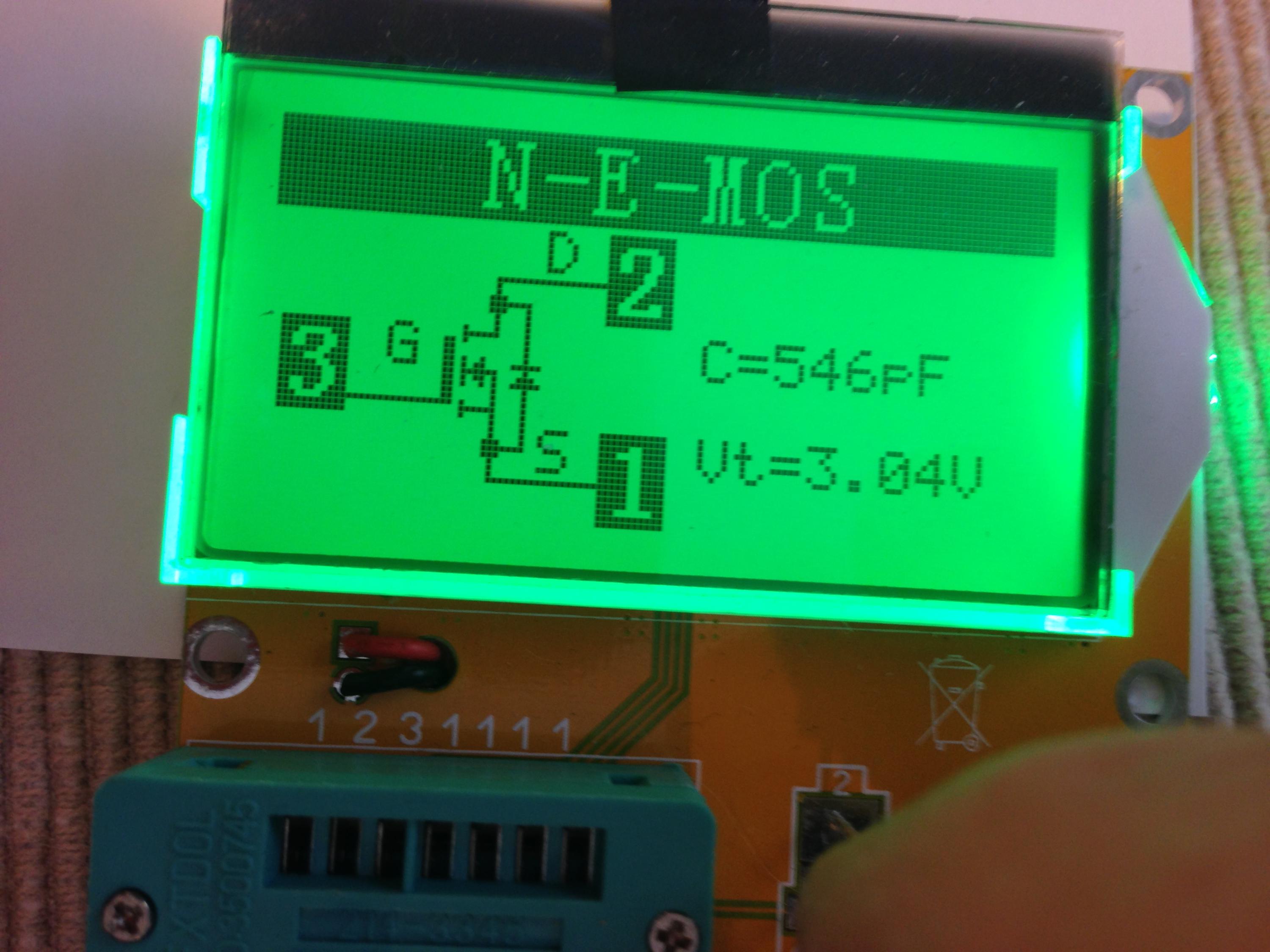

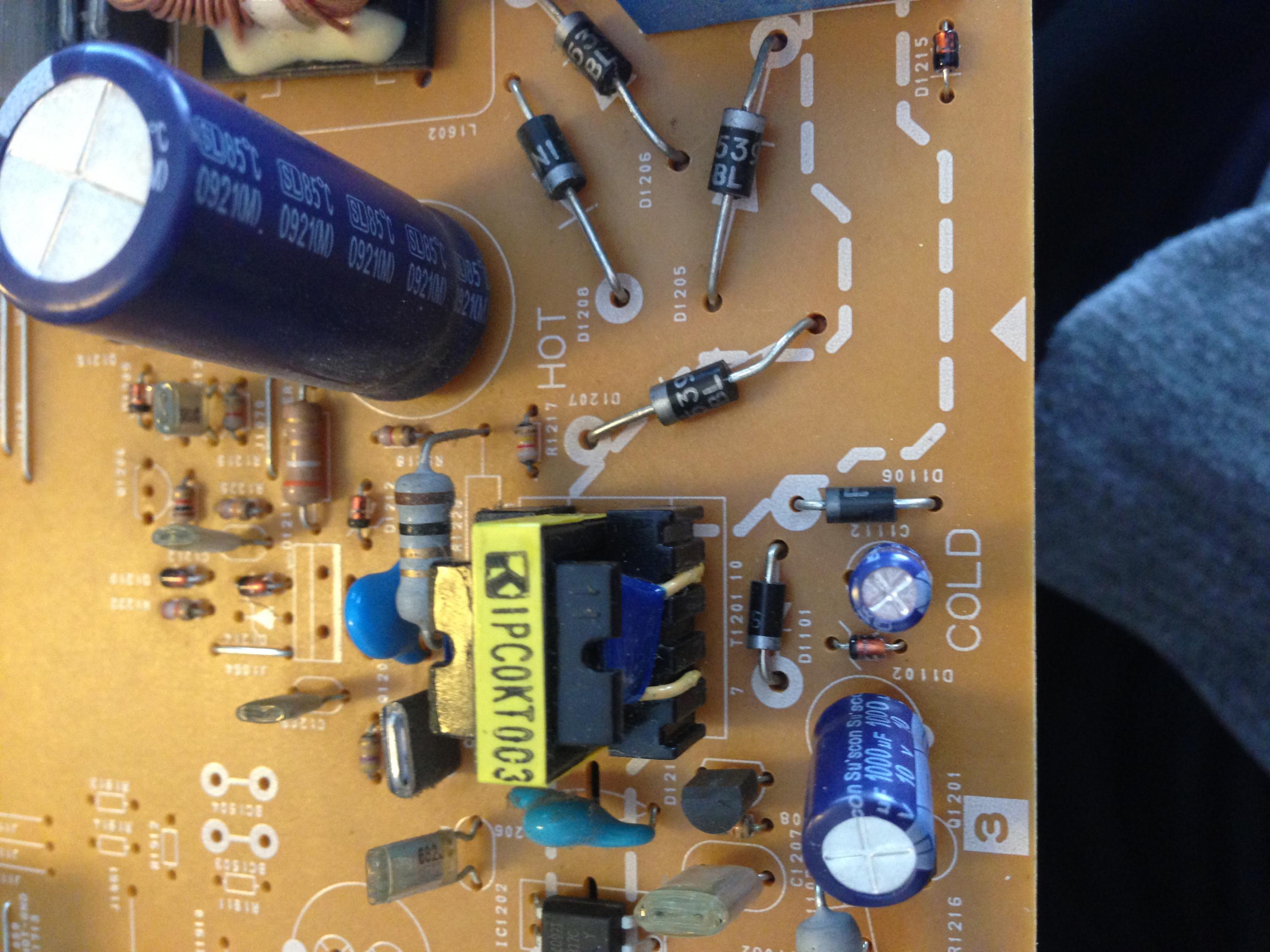

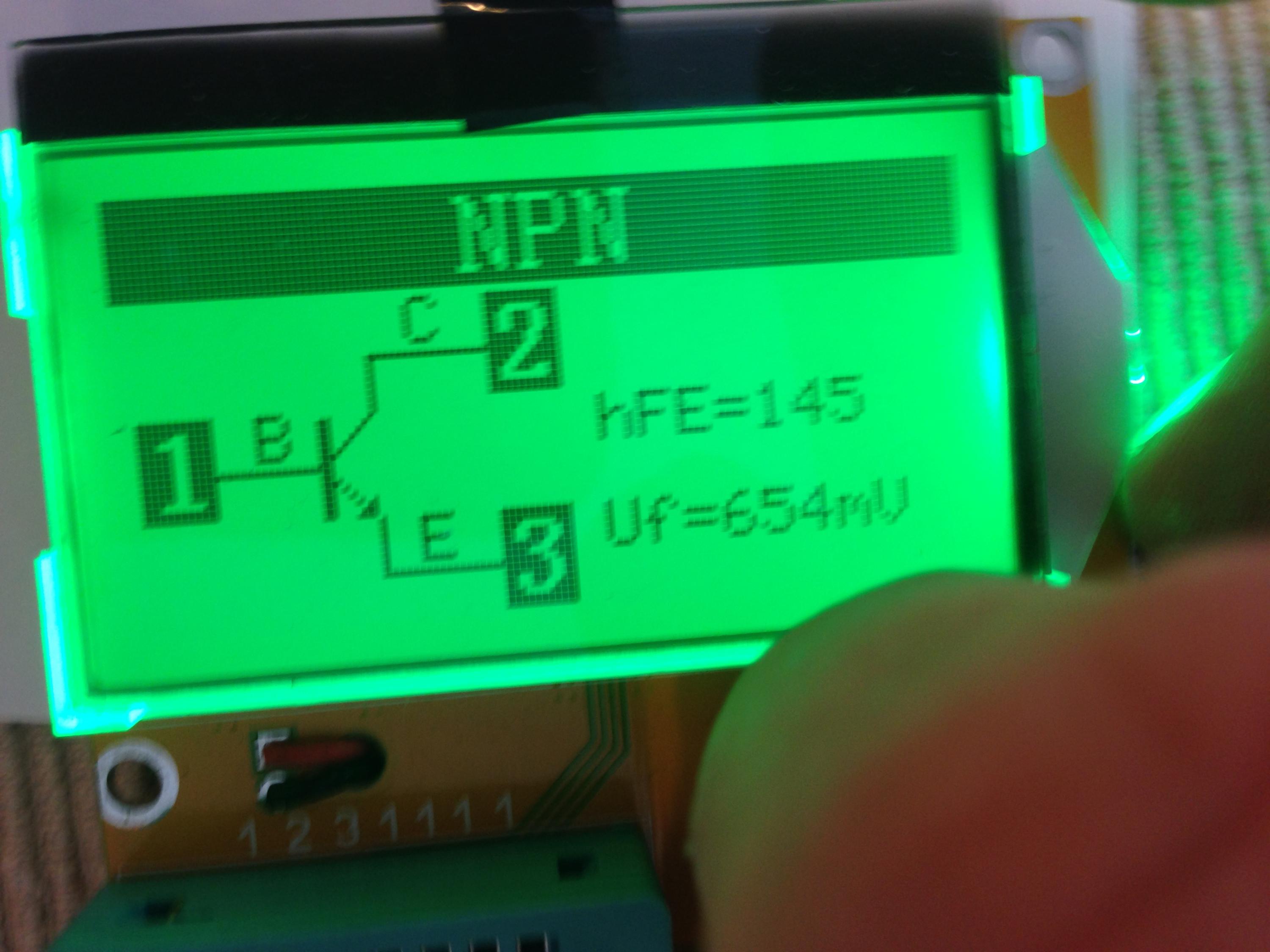

    I've taken all the diodes 1205-1208 out of circuit and tested them. They all tested fine. I checked C1205 via a $20 ebay circuit tester w/ LCD screen (LCR-T3 tester). It checked ok too. I finally pulled the Q1203 and Q1204 out and tested them with the same device; the problem is I don't know how to read those results. Here these are:
    Q1203 is a FET 2SK3757(Q) pic of it being tested attached below
    Q1204 is a Transistor KTC3199-GR-AT/P (says C2120 on part) pic of it being tested attached below
    Finally I have NO idea how to test the T1201: TRANS POWER 9705 LTT1PC0KT003

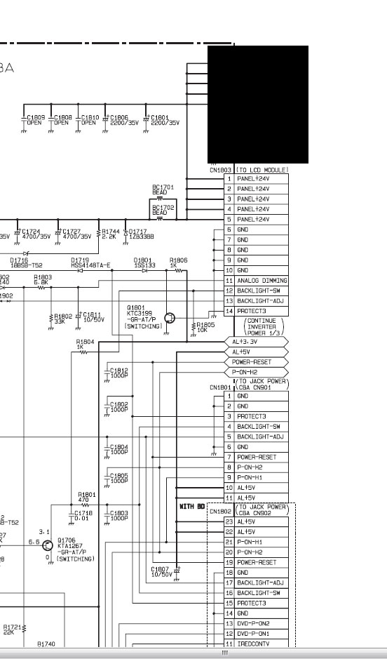

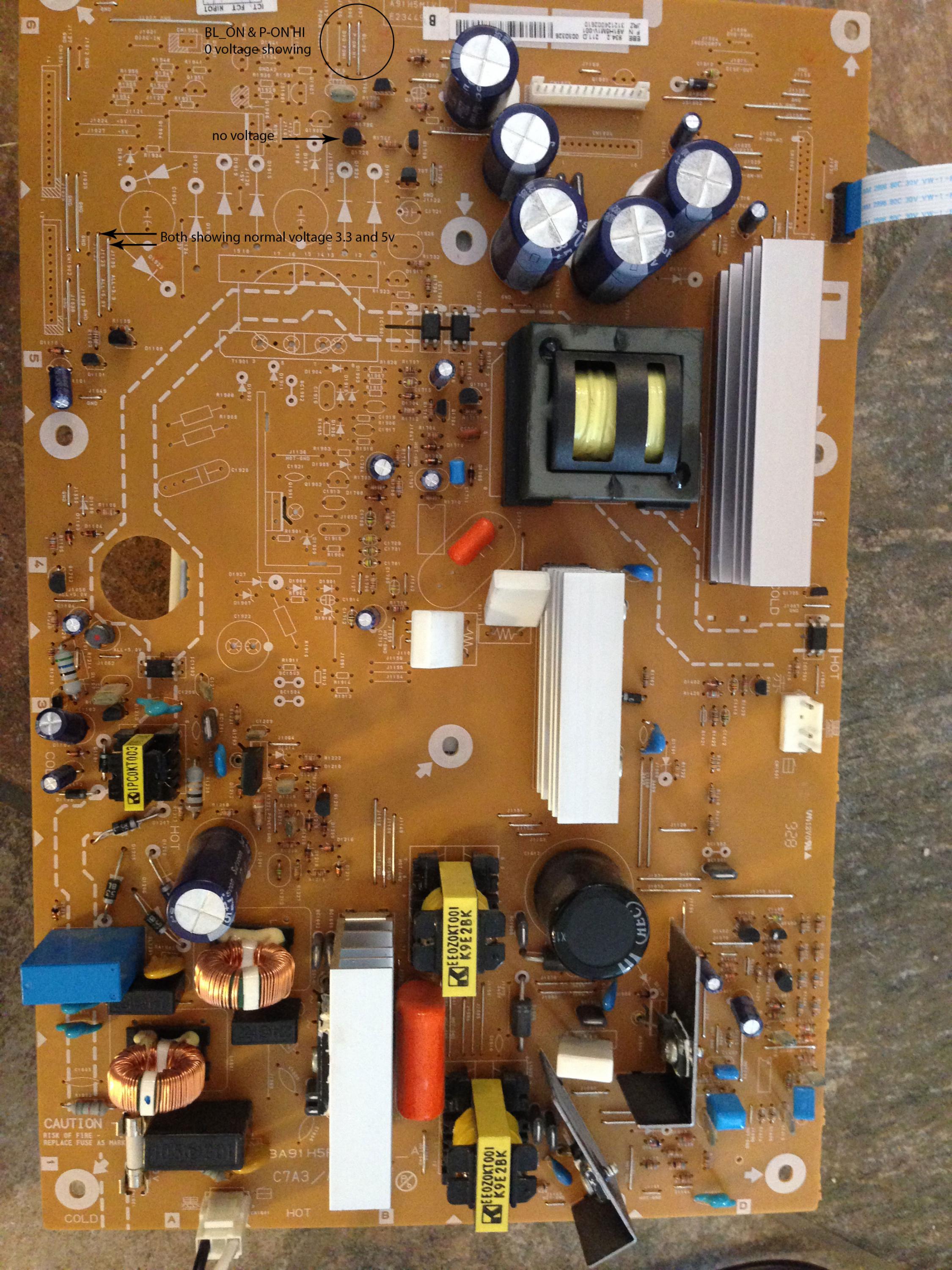

    Here is a full size picture of the board.. I tried to get it in focus. I made notes on here that you can see in black letters and arrows.
    If you look at the diagram I attached (I have the YA1A serial number), I'm getting NO VOLTAGE at the CN1803 white connector. I should be getting panel +24V on pings 1-5 and I'm not. Maybe someone can tell me where else to look now.

      Re: Phillips 42PFL3704D/F7 No Standby Power
      I hope all the parts are back in the power supply. Plug it in an take your DMM and check the DC voltage on the big filter cap.

        So I'm not familiar with the term "Big Filter Cap" but I assume you mean the big transformer T1201. All parts are back in the board and plugged in. I put my DMM common to a cold side ground and ran my red lead to all pins on the DC side from 9-16. I get NO DC voltage of any kind. Is that how I test this thing? Is it bad?
        part LTT1PC0KT003. If this is the thing that's bad I can't google a replacement part.

                    Ok. Yes I tested the voltage by placing negative lead on cap and positive lead on cap as well. I initially tested C1612 which gave no voltage DC
                    I tested C1201 in circuit and read 171 volts DC. It reads it should be 350V. Ill pull it out of circuit in a minute and test it with my LCD tester.

                      No need. That voltage is correct. 120AC gives you about 170V DC.
                      Now check C1103 and C1112.

                          Check the bridge rectifier D1601 and see if you get any DC out of it.
                          The 24V for the backlight wont come on until the power supply is turned on, and the backlight gets the BLon voltage (usually 5V). The STBY voltage is always on at the power supply and feeds the main board. Once you press the power button, that STBY voltage goes back to the power supply and turns on the rest of the power supply rails. So, I think the power supply is producing the STBY voltage, but there might be something going on at the main board not turning on the rest of the power supply. So verify that the STBY voltage reaches the main board. Maybe you find a blown fuse on the main board.
                          If you connect the main board and the standby disappears, you got a short. If it stays on and no reaction from the main board, something is open or the main chip is fried.
                          Have a look at page 12-1, 9-5 or 9-6 (depends on your serial number) and 9-7.
