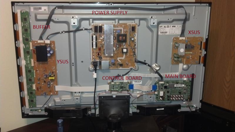

    Posting pictures of the back of your tv showing the boards with clear pictures may help you more with fixing your problem

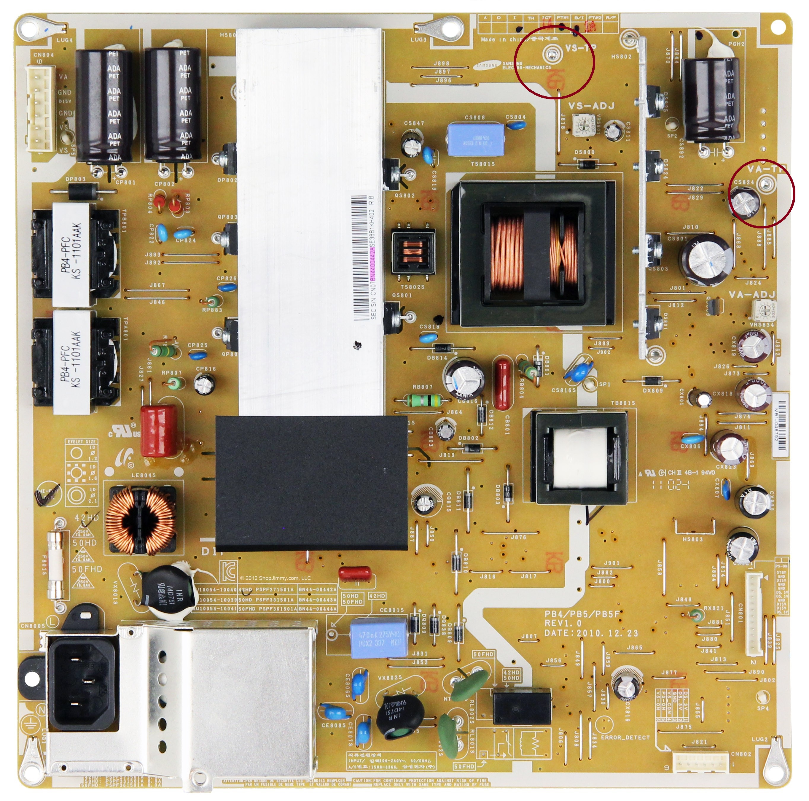

      if you have a digital multimeter, you can test the power supply board, as always be careful working with power supply, HIGH VOLTAGE, on primary side can be deadly.
        Re: Samsung PN43D450A2D help needed
        I'd check Vs/Va on power board.
        From the sounds of it, the picture goes out when it gets bright... have you tried the on board test pattern (under "Help" menu)

          you need to do some voltage checks are you still getting vs Voltage out of the power supply when the picture goes out. You claim that you can hear the boards working so vs may still be there however the big clincher is that you say you cannot turn the TV off. since you still have audio the power supply is sending signal to the main board to keep it on. when the picture goes out can you see a glow from the panel still? so without video feed do you have a no signal on the screen or anything to that note can you hit the menu button and see anything come up on the screen like the menu?

            I am a tech savvy person, but my handiness admittedly isn't electronics. I have a standard analog meter, but I'd be lying if I told you I know how to use it. I'm not afraid to dig in and I'm not going to complain about having to repair it, but I will need some help. What does Vs/Via mean? And when it comes to a Primary aide of a board, I don't know which is which.

                    heres the test points on your power supply VS/VA you can test in the meantime
                    you also have a VS/VA sticker rating on your panel that must match up

                      And finally here the multimeter I'm using. If someone can tell me which setting to keep it on and which unit to read, I can get some info.
                      Also, I know the X Board, but when you tell me the boards you mean, can you tell me which picture they are, so I can associate them with their proper title? Thank you.

                        Picture of what the boards are

                          Awesome thank you! I hear people mention.PCU and TCon, which are these?
                          • sordids999
                            • May 2013
                            • 2155
                            • uk
                            PSU=power supply T-Con=control board

                                  Thank you, and thanks for the tip! Any suggestions with which setting to use on the multimeter shown?

                                    DC 250v range. Black probe to chassis and red probe to any of the two VS outputs on the power supply that feeds the left and right boards. leave the voltmeter connected and run the TV and when the picture goes out see if the needle stays steady

                                      Alright, set at 250DC the VS before the "trip" is off the scale, and reads about 45 since tripped. The VA goes from the 160 mark to nothing, or next to nothing.
                                        The problem with an analog meter is it's prone to mechanical overshoot, if the needle moves too quickly. Can you get a hold of a digital one for this test?
