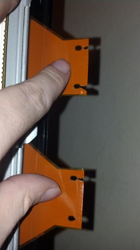

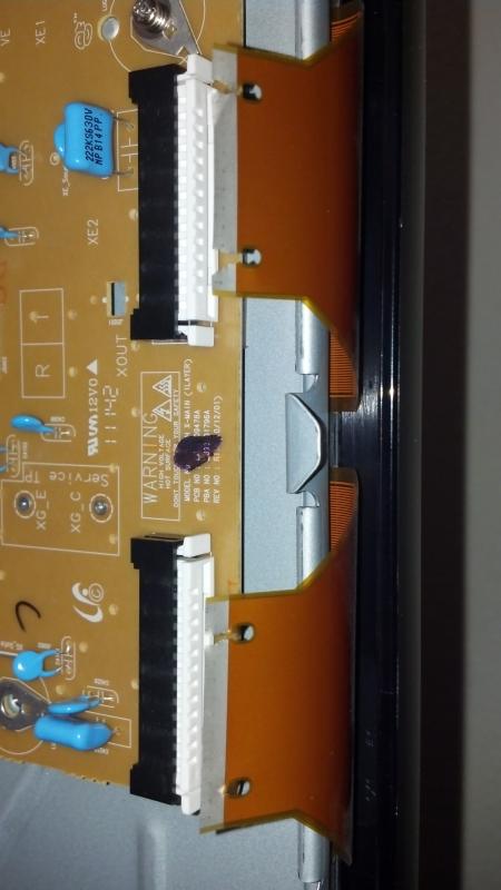

                          I did notice this: the two strips that plug into the X board have small tears in them. Would this affect it? How easy are they to replace? I noticed if I unplug one of them and hit the Media P button on the remote, I get a bright blue screen for had a second then the issue happens again, but it seems like it's more than I've seen before.

                            Well, I would be willing to bet that is your problem. Did you just rip those out or did you actually pull them out correctly because it looks like those were ripped out as those holes are supposed to be the locks to keep them in place inside the connector.

                              This is how they looked when I released them. My guess is the previous owner is responsible for this. How can I fix this? And what are they called?

                                Well, those ribbons are permanently attached and glued to the glass panel I don't know how you can fix other than cutting them back but I would like to hear with Tom or someone with more experience as a first.

                                        Can you get a picture of the other side, the metal side, of each ribbon?

                                          If you need a better picture let me know.
