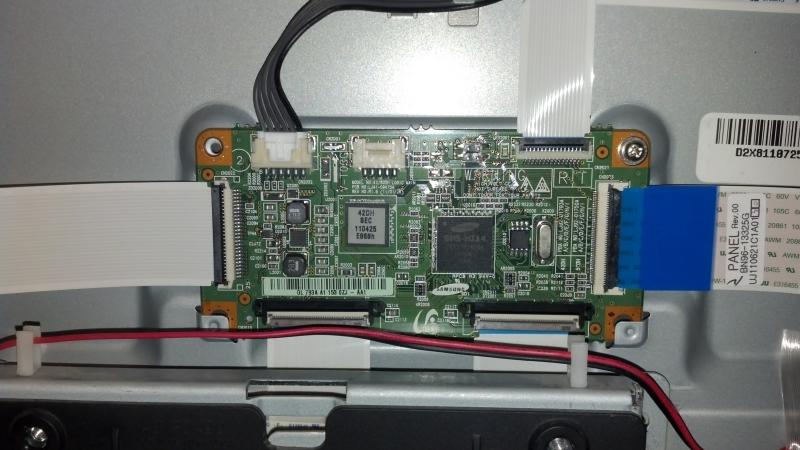

                Seems main voltages are there. Below the power board there's a small green board (logic/ctrl) which should have an LED on it. How often does the LED blink? Once/twice a second, or longer, around 5-7 seconds? Also, does the flashing change after it faults?

                  When it's running normal, the flashing is about once or twice every second. After the fault, it switches to one flash lasting five seconds, with about two or three seconds between flashes.

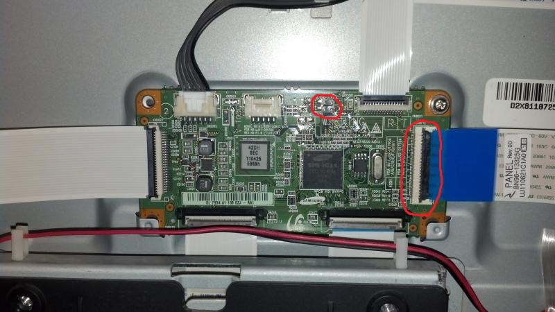

                    Ok, looks like a protection fault is being triggered somehow.
                    Could you upload the photo of your control board from that thread here? I'm on lunch break at work, but imgur/photobucket/etc are blocked here.

                      Re: Samsung PN43D450A2D help needed
                      I think I figured this attachment thing out.
                        #31
                        Ok... see attached
                        Start with TV off and unplugged.
                        Place a jumper across pins 3 & 4 of the highlighted 4 pin connector (you can use jumper used on hard drives, or a piece of wire.) Pins should be marked on the board.
                        Disconnect the right hand LVDS cable: to do this lift the latch up and carefully remove the cable.
                        Plug in the TV. Do you get cycling test patterns on the display? Are they steady?
                        • Krenzy
                          • Feb 2015

                              Ok so I have a jumper wire across the 3 and 4 prongs, and when I turn the TV on, the boards buzz like normal, I get a small glow that almost immediately disappears, along with that buzzing. The control board is doing the blinking pattern noted above during the fault.
                                #35
                                Can you check and see if you get a very brief white flash? The fault symptoms are pointing to an issue with the power board or one of the sustain boards.

                                  The glow I mention I guess I could describe as a flash. It isn't blindingly bright, however, but it is instant and fades immediately.
