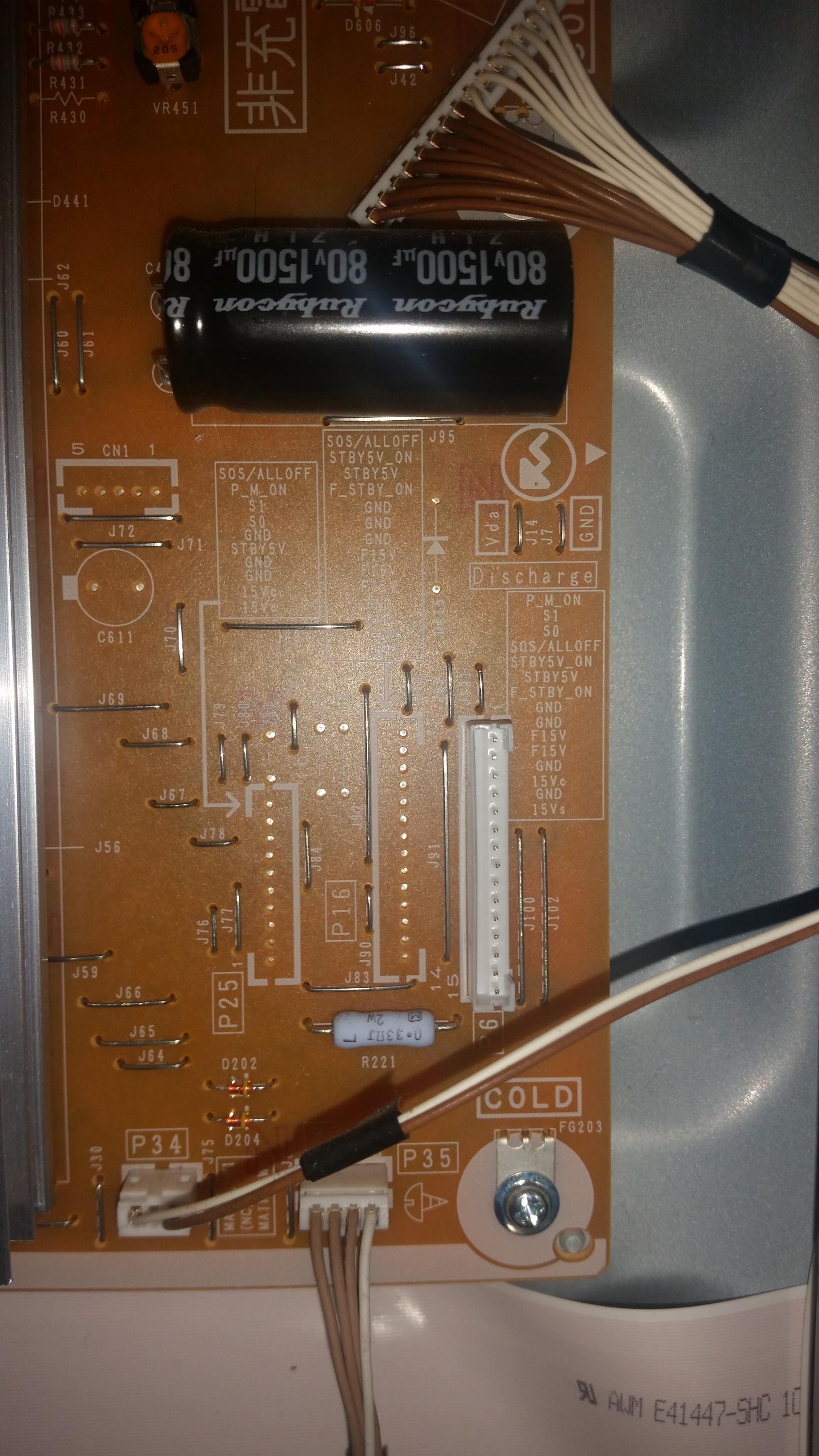

    Recently got hold of the above set, Upon plugging in I hear a series of relay clicks and standby LED blinks 5 - 6 times (Too quick to tell)

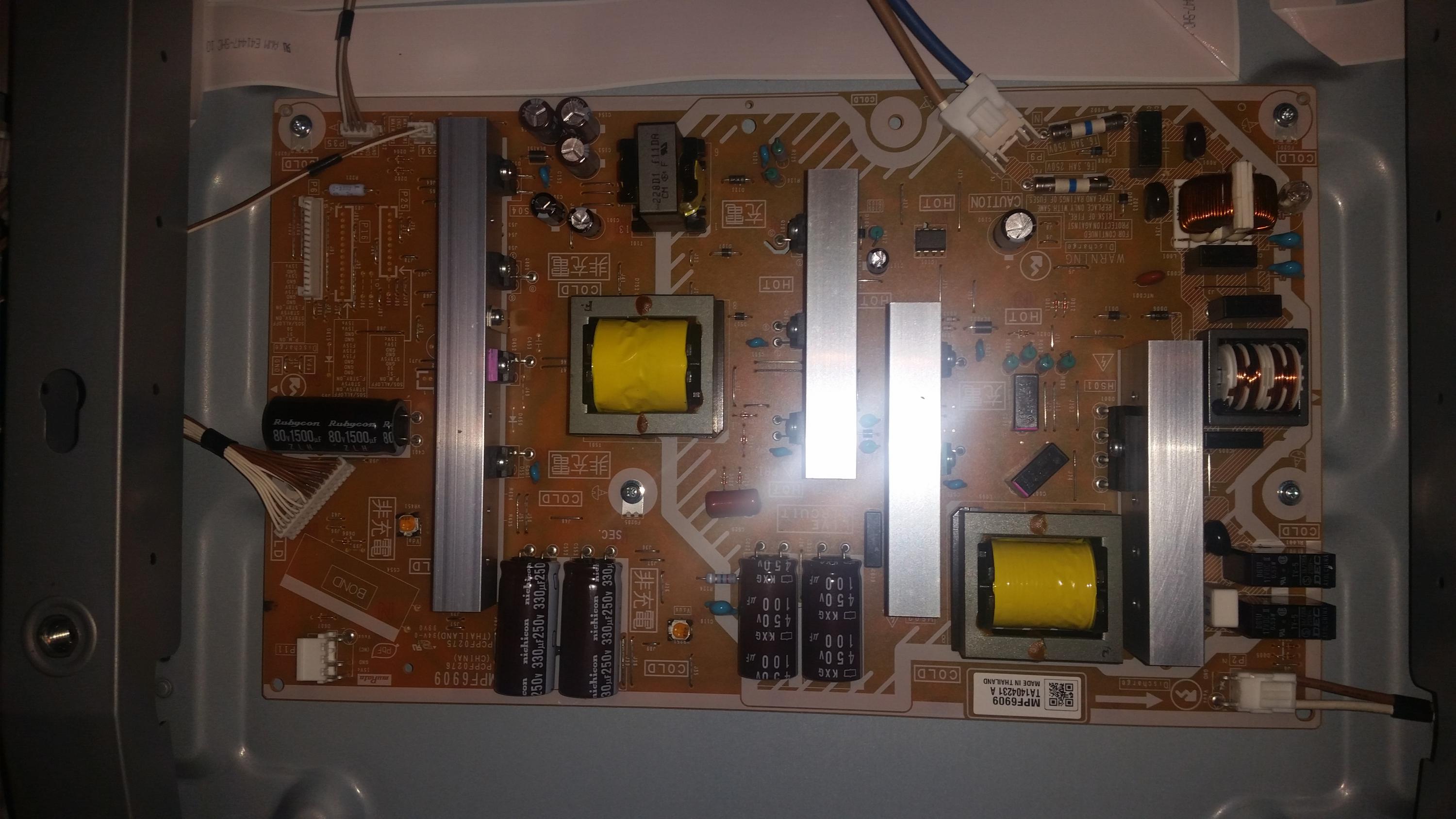

    PSU Checks out fine and is giving all correct voltages.

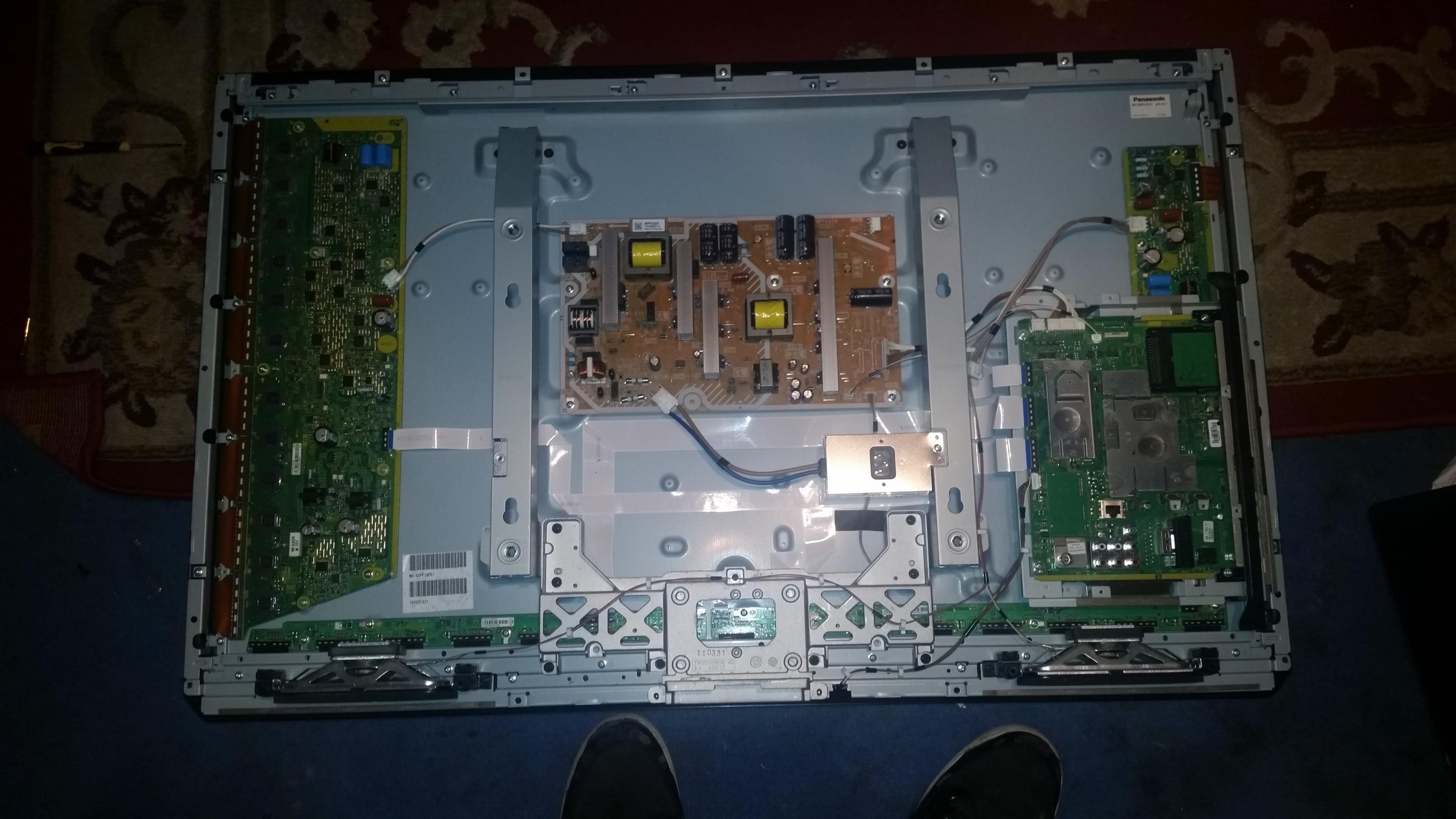

    I will upload pics shortly of the boards and chassis.
    I am not too familiar with Plasma sets but have done one with a buffer replace and sustain VR bank replacments. Due to this I am not familiar with the layout of the set as it looks very different to the older plasma I repaired last year.
    So little help with what is what and any idea will be great.
    Taking pictures now

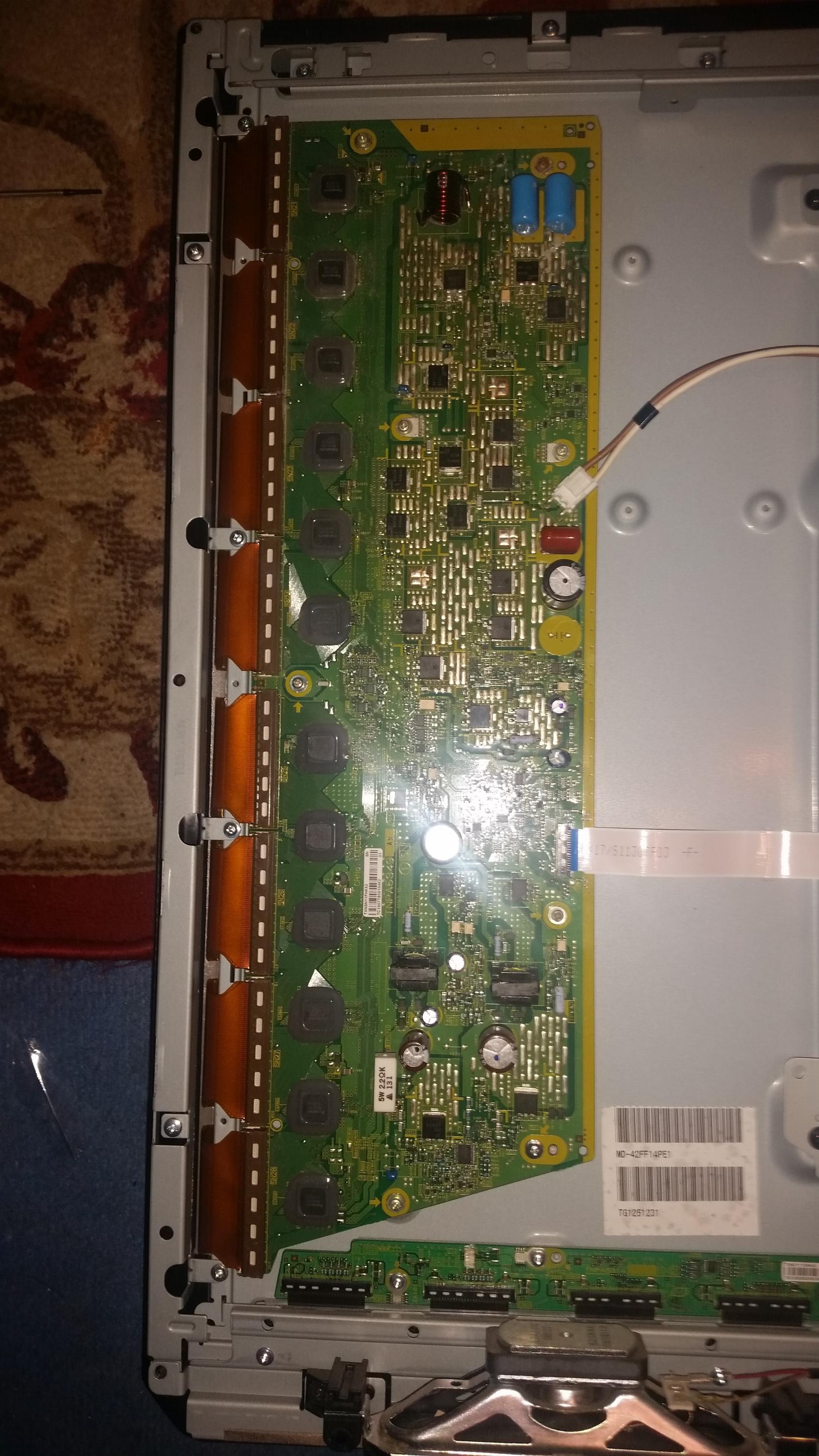

    Re: Panasonic tx-p42s31b
    Pics

      to get an idea of where to start , an accurate count of the sos blinks would be helpful. they do pause and repeat so you should be able to figure it out. I'm expecting 6 or 7 indicating SN board as that is a more common one. Also, with the mounting screws on that SN board especially where the earth points are, are they all the same type or look like they've been replaced?
      look for shorted transistors on the SN board especially the surface mounted.

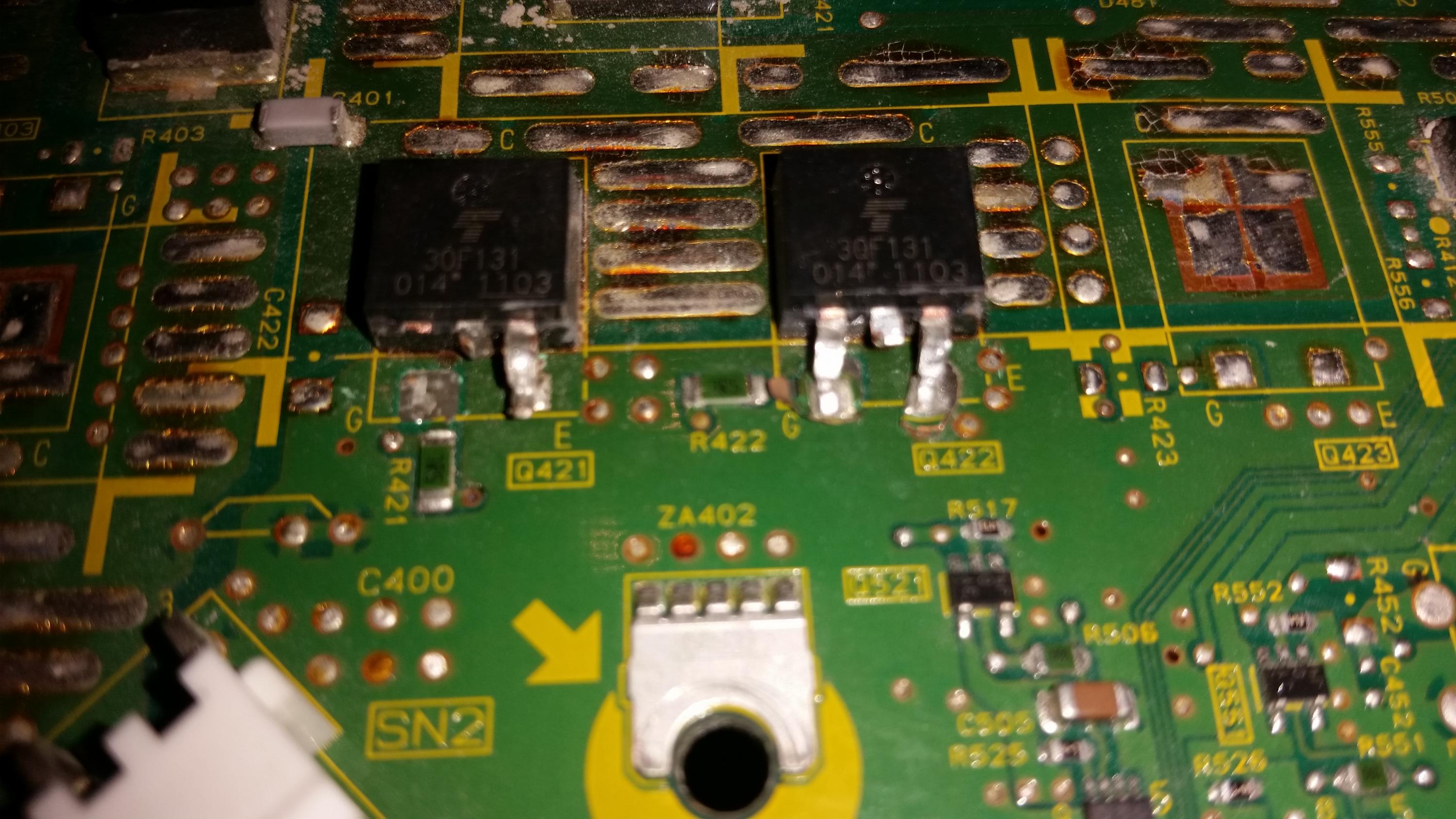

              Oh wow! Let me get a pic of this!
                Probably shorted SN. Do you have Vsus? It will cause flashing green then dead or lit LED.
                • newtothis
                  • Mar 2013
                  • 1556
                  • england
                  I don't know how the hell I didn't spot this straight off! The history of the TV was that it went to a TV repair shop with a 7 RED blink and came back with a 5 green blink and a quote of £90 to repair it.
                  That damage is certainly done by somebody and not a failure! I will test the transistors and if they are fine I will retrack the board and see what it does.
                    Forgot to add pic
                    • tw2005
                      • Oct 2011
                      • 6458
                      Originally posted by newtothis
                      Forgot to add pic
                      Yeah that's funny. Obviously they've tried to remove the short on the SN board and who knows what but would have to wonder if a professional shop would do that. I would ignore the 5 blinks and focus on getting a new board or a kit to repair it.
                      I did a board for a 50S30 and only 4 x 30f131 were required but it's not always that simple. search the board number and see what's in the kits for an idea.
                        I recall 5 blinks occuring on these if the 15V is short/low which could happen if gate driver IC is shorted...
