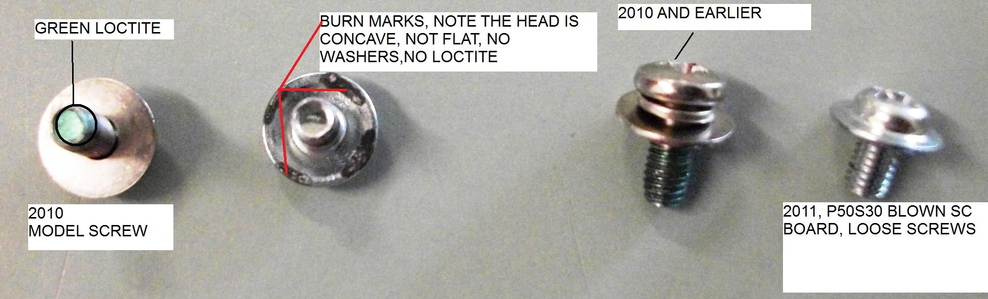

              The schematics are hopeless in these later manuals, however go to the block diagram and you will see the pins of significance. pg43. I can assure that pin 1 SU and pin 9 SD are tied to Vfg , have a look. If there is no short from the ground plates on the buffers to the output pins at the panel side then they are good. If you're worried about them being connected to the SC for a tes, you can leave them unplugged and not earthed(4 bolts removed) jumper the SC50 pins, and turn the TV on. If it stays on without a shutdown error blink then SC passed, only do it long enough to confirm. (30sec max)
              I don't know how else you are going to check if the board has been repaired correctly or not unless you know how to fix them yourself.
              Did you get new screws or the correct ones because part of the issue with these is the bolts used work loose and the board then has a bad earth and blows up.

                He sent a new screw set. Whether they're the correct screws, I can only hope. They're gold in color like brass. I'm going to use Loctite Purple with them to ensure they don't back out unless I back them out. Purple is low set strength.
                I have Loctite red and my wife asked why I don't use it instead. Had to explain to her I wasn't ready to torch it. Yet....
