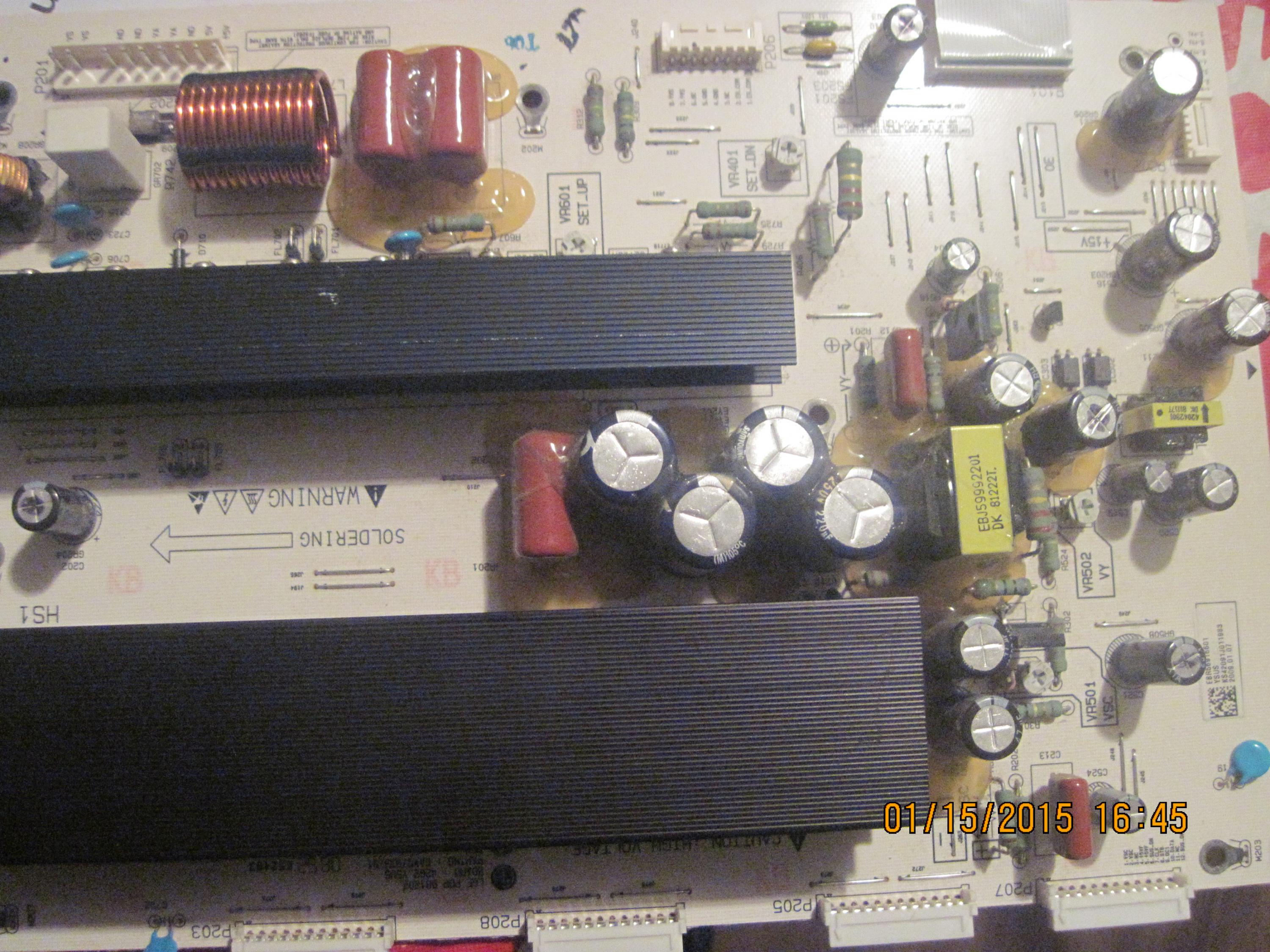

    Hello all, I have LG plasma tv with no picture. What I've found so far is that the 5v going into the control board was not present. I suspect the y board is bad but wanting to know if can be trace to a component.
    Re: LG 42PQ30 no picture
    Have you checked for Vs, Va, Vsc, -Vy and Vzbias?

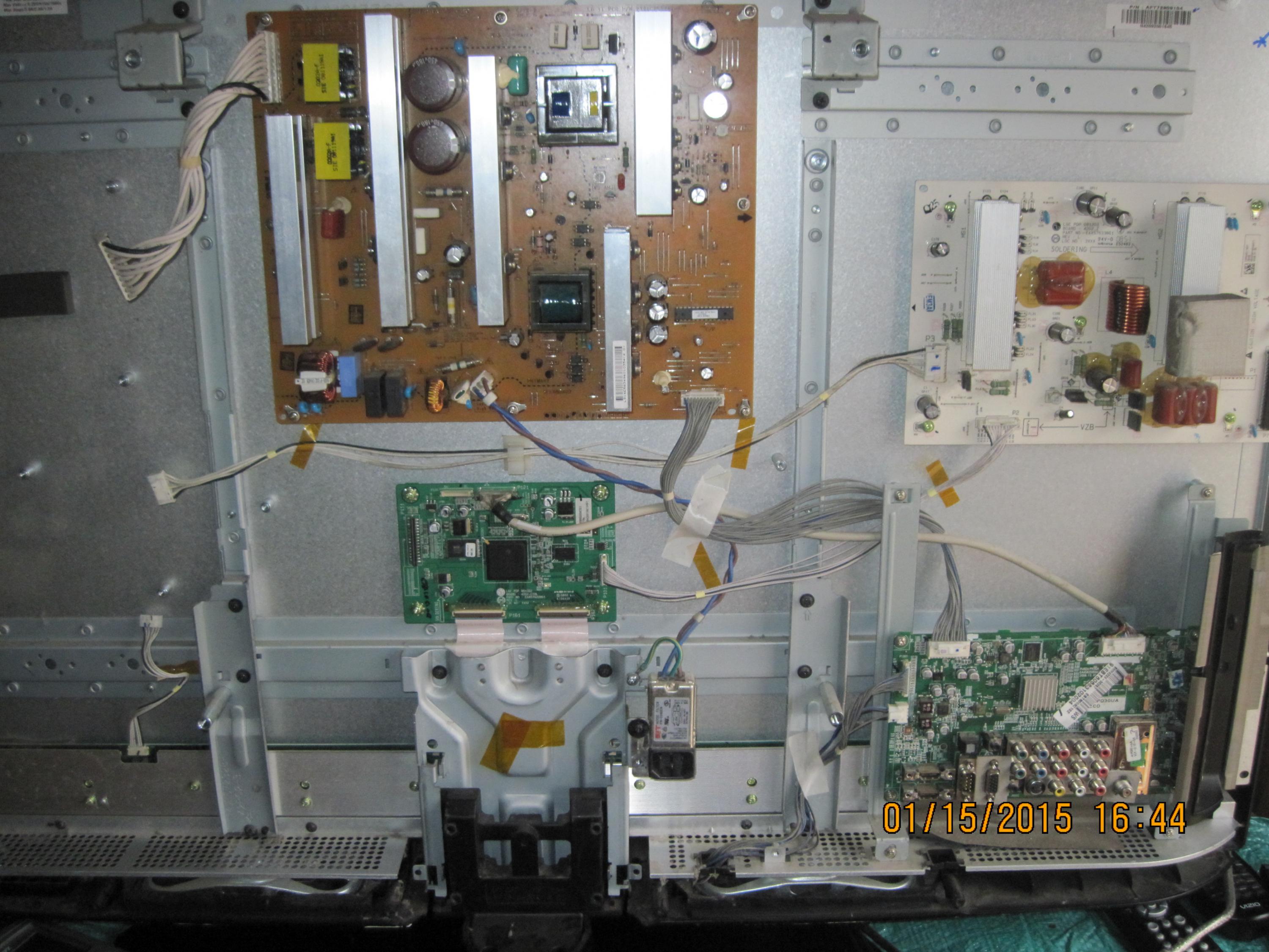

      Yes all the voltage reads correct. I did find the 5v going to the control board. I did notice the led d201 was not blinking or lite on the control board. Control board???
        What you think Tom?
          If all the voltages are there then the control board should be working so yes it could be a control board fault.
            Ok will order one and give you some feedback.
