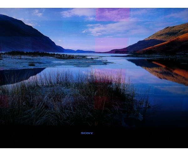

    Hi
    I have this TV, where I now can see some horizontal lines, containing pink squares.
    I'm attaching a picture. Maybe you could help me in finding the problem?
  • anmol
    • Mar 2012
    • 73
    • India
    Re: Sony KDL-46X4500 - Horizontal lines - Pink squares
    check lvds cable and cable from tcon board to panel.
