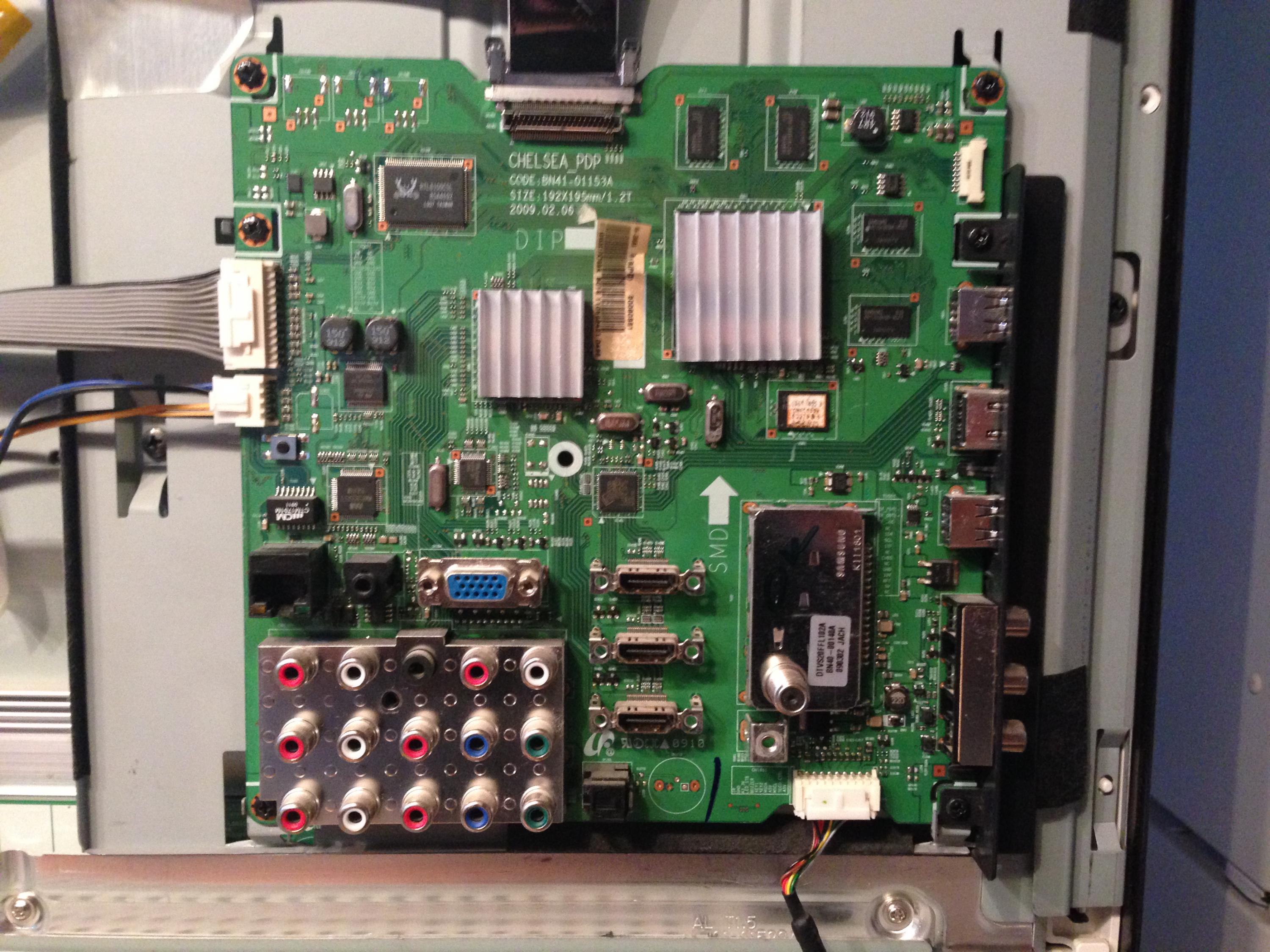

    1. I disconnected each wire harness connected to the Power Supply one at a time, then plugged the TV back into the wall. If the TV continued to click power cycle, I would re-attach the wire harness I just unplugged and unplug the next and repeat.
    - I found with the above test, the Main Board (tuner board) would stop the TV from clicking.

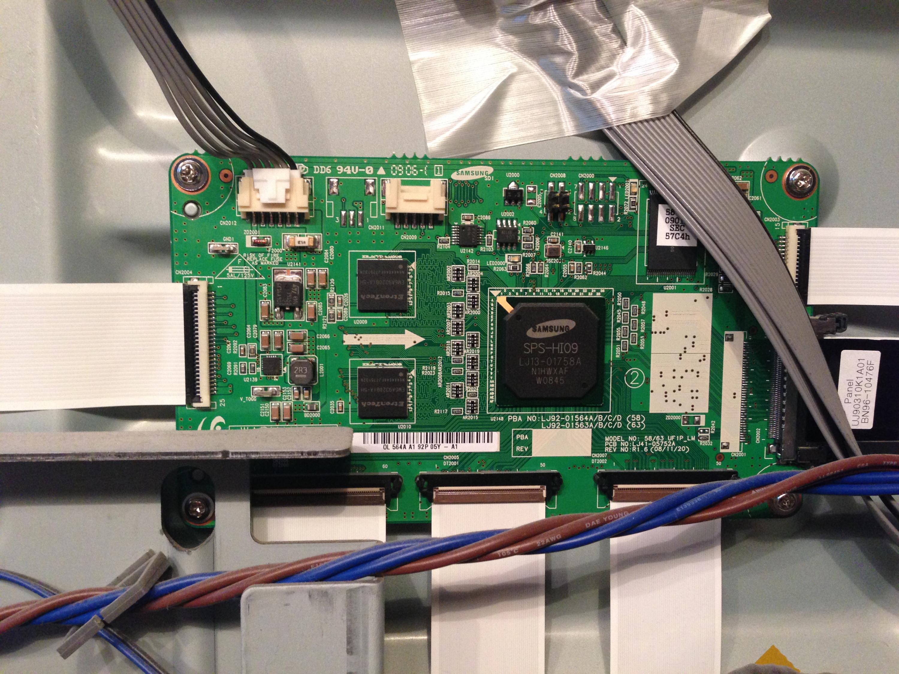

    2. While leaving the power cable going to the main board (tuner) disconnected, I jumped PS-ON to GND, VS-ON to 5V with 100 ohm resistors and disconnected the LVDS flat ribbon cable that leaves the top of the tuner board and connects to the tcon (logic board). I plugged the TV to the wall.
    - The normal power quick click would occur and the TV no longer power cycles as before.
    - The green logic board light now blinks slow and steady.

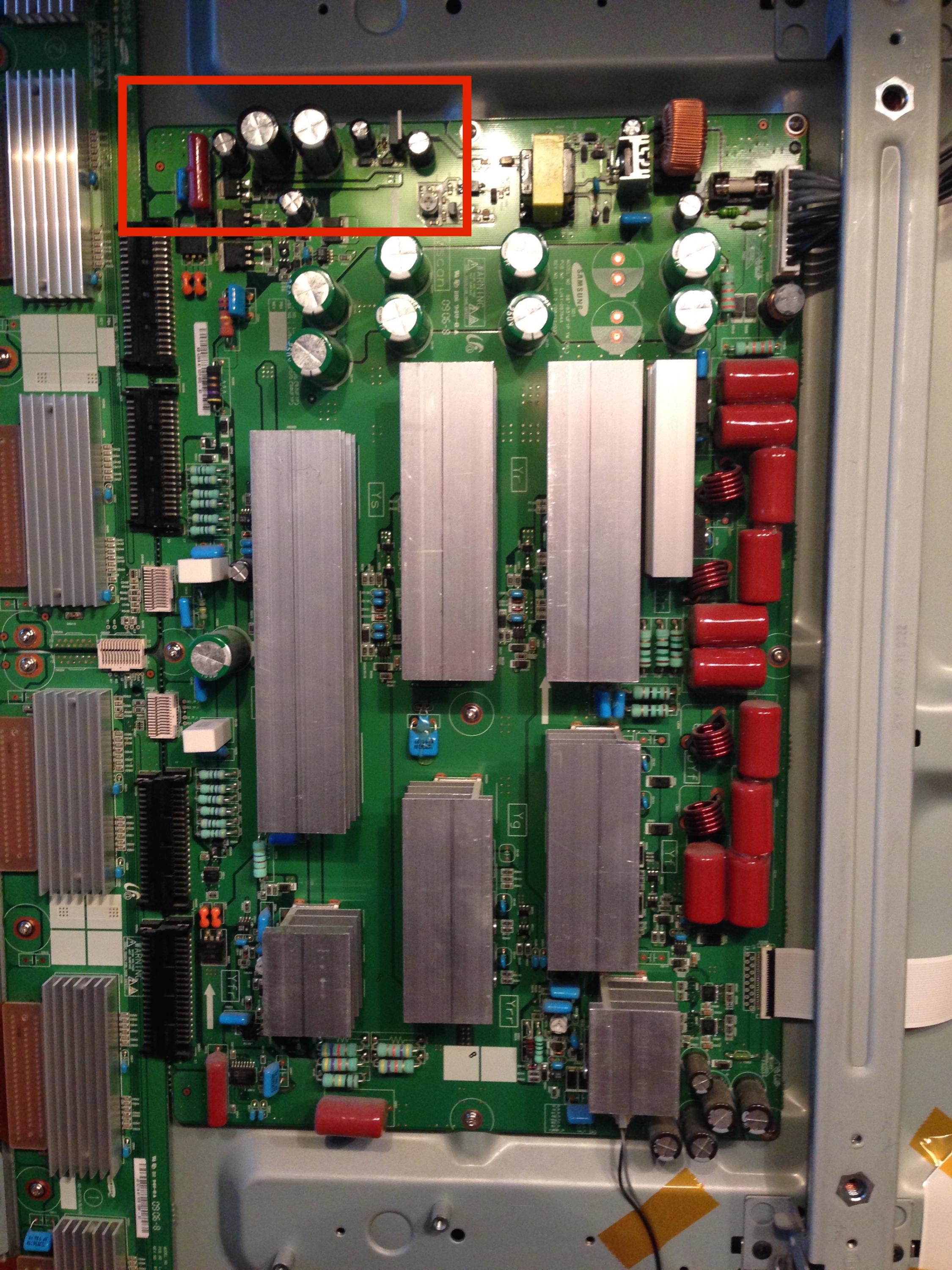

    With the above step, I noticed a melting plastic smell coming from the LEFT SIDE and saw a bit of smoke seeping out of the top left portion of the TV (behind the main metal shield and the plasma screen backing and directly above the left wall support. Although the smell seem to emanate from near the y-main board, I did not see smoke from the board itself. As soon as a smelled the plastic, I unplugged the TV. This definitely smelled like plastic and not electrical.

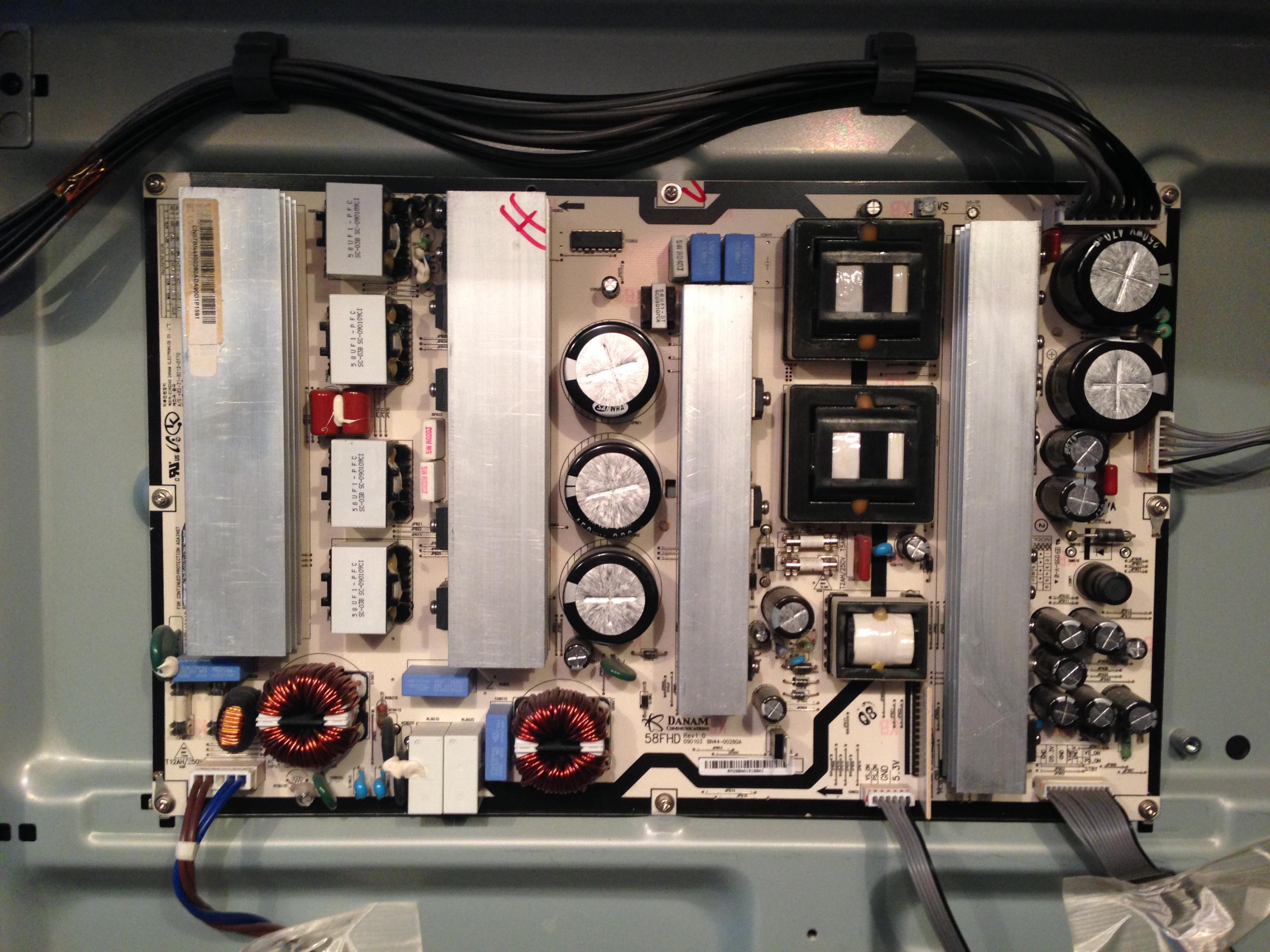

    3. To prevent any damage to the Y-Main and X-Main, I disconnected the power cable going to both and plugged the TV back into the wall so I could measure the power supply voltages.
    VS = 201 volts DC
    VA = 55 volts DC
    all other voltages check out, 15v, 5.3v etc.
    4. With the TV unplugged, I plugged both the y-main and x-main back to the power supply board, added the jumper to pins 3 and 4 (left set of pins on logic board). Since I was concerned with the melting smell, I quickly plugged in the tv to look for a test pattern.
    - Test pattern failed - no display or change.
    NOTE: I notice the normal hum coming from both y-main and x-main, but only the bottom left heat sink on the y-main seemed to get warm - all other heat sinks were cold.

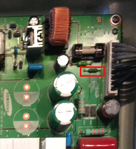

    5. I unplugged the TV and the power cable going to the y-main and checked for continuity across the green inline fuse (upper right hand corner for the y-main - looks like a resistor).
    - There is NO continuity (no tone) across the green fuse.
    NOTE: Checking for continuity across the green fuse on the x-main checked out (tone).
    6. I have checked all removable fuses for continuity and all have checked out.
    Based on my testing, I would think the y-main and Main Board is bad, however, I need to know if the green fuse should have continuity or if this is more like a diode, where I wouldn't hear a tone when testing with my meter.

    Nice pictures and good diagnosis for now. That fuse should test as a short. Can you try checking from each end of the fuse to the chassis for short circuits? Use the ohms range.

      Y-main Green fuse:
      ground -> right side of fuse :: 2k
      ground -> left side of fuse :: 30M (high resistance)
      X-main Green fuse (fuse is standing vertical on the board):
      ground -> right side (top) of fuse :: 11.5k
      ground -> left side (bottom) of fuse ::11.5k
      Since the caps seems to be taking a charge from the my meter, I held the probes in place for about a minute and waited for the reading to settle.
      Thanks again for your help. I really appreciate it.
        Re: Samsung Plasma PN58B650 Power Cycle
        Well, that is not showing a short. Could it be that you smelt a fuse failing? Maybe it's worth trying with another fuse. I'd like to see what the fault might be first, though. Any signs of burn marks or damage on other components? That fuse is probably for the 15V supply, which powers a lot of things.

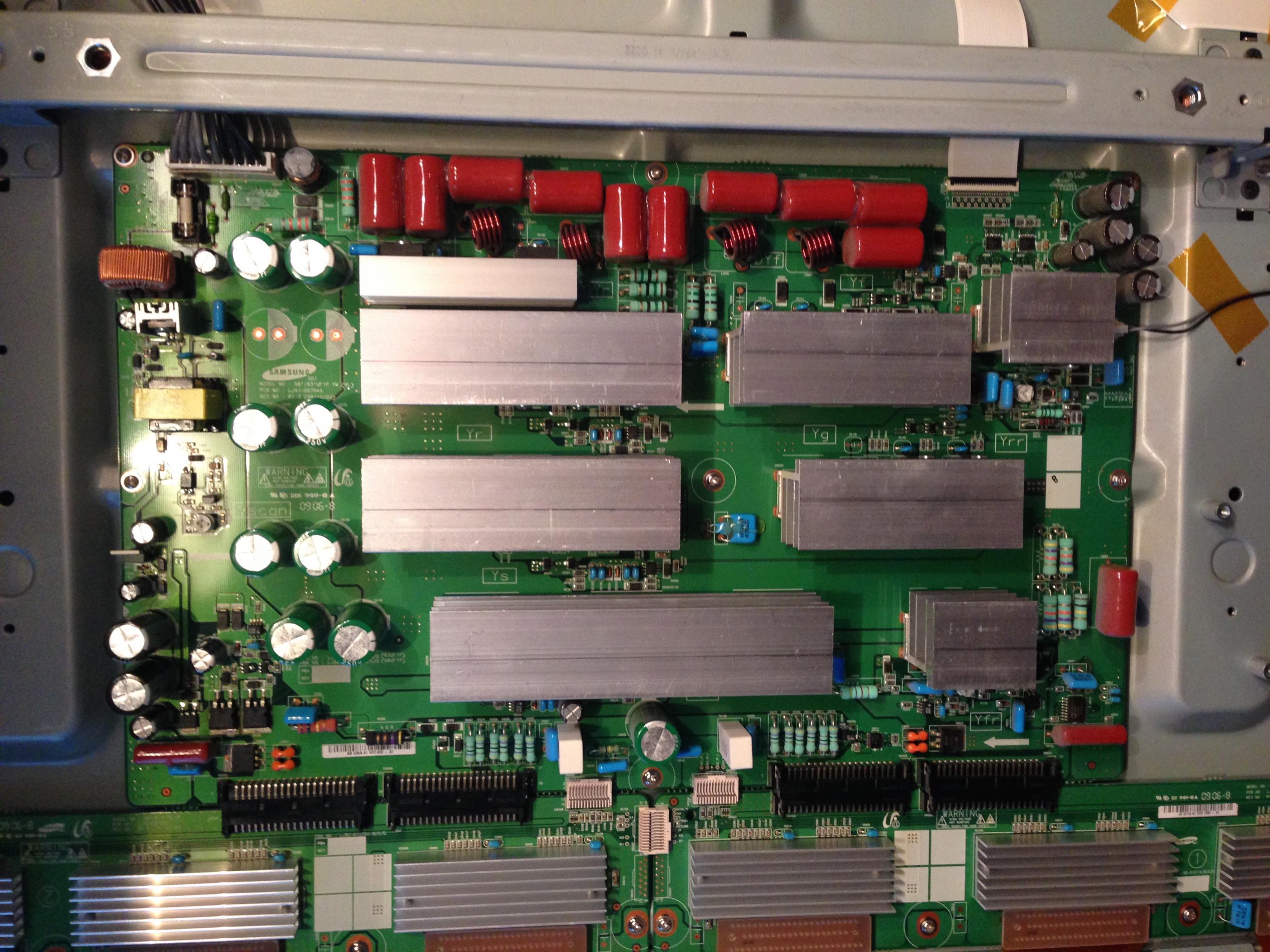

          I did remove the screws for the y-main and y-buffers so I could swing the board out and inspect the back. There are no visible signs of damage on the backside or front. As I stated before, the only time I saw smoke was after the first time I jumped the PS-ON to GND, VS-ON to 5V with 100 ohm resistors and plugged in the tv (30 seconds). Since then I've been caution leaving the TV on longer than 10 seconds while the y-main and x-main are plugged into the Power Supply. Further tests with the resistor jumpers in place would also produce the burning plastic smell near the upper left portion of the y-main capacitor (see attachment).
          As a quick test I used alligator clips to jump/bypass the green fuse on the y-main but used a small 100 ohm resistor in parallel and in place of a fuse. I know this is risky and I should use another fuse. Turning on the TV with the PS-ON to GND, VS-ON to 5V with 100 ohm resistors, this had no effect and the TV would not turn on or give me a test pattern with the pins 3-4 jumped on the Logic board.

              By performing the tests noted in my original post and by followingthis forum thread I determined the following components failed.
              - Y-Main
              - Y-Upper Buffer (upper long thin boards vertically aligned on the TVs back left edge)
              - Main Borad (tuner)
              I followed this youtube video to test my Y-Upper and Y-Lower Buffers and determined only the Y-Upper Buffer was bad or failed. After some research I found it was not uncommon for the Y-Main to blow/fail when one of the Y buffers blow/fail. Some people have stated you should replace both buffers (upper and lower) even if only one has failed. I did NOT replace both buffers and only the one that failed. Maybe it was a gamble, but trusted the Y-Lower Buffer was fine which in the end proved my judgment was right.
